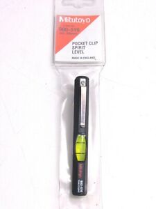

    What kinds of pocket levels do you guys like that are accurate and consistent? Preferably made in USA but I’m open to others.
    Like an idiot, I ordered a Starrett 135A pocket level from Amazon and the thing is shit. If you flip or rotate it, it shows it’s absolutely lack of consistency. It seems like it is built well…until you actually go to use it.
    I’m pretty much stuck with Amazon because most places won’t ship to APOs, even if they give the option during checkout.
    Note:
    I’m not looking to discuss the use of levels with/on rifles so let’s all just holster and place our hands on the table. 😂 Just looking for a quality pocket level to add to the toolbox.
    Had one of those off Amazon too, same issue, read differently in the two orientations, utter junk. Starrett weren't interested either they couldn't even be bothered to answer emails.
    I use the Stabila pocket level, have always found them 100% reliable and they are about quarter the price of the Starrett.

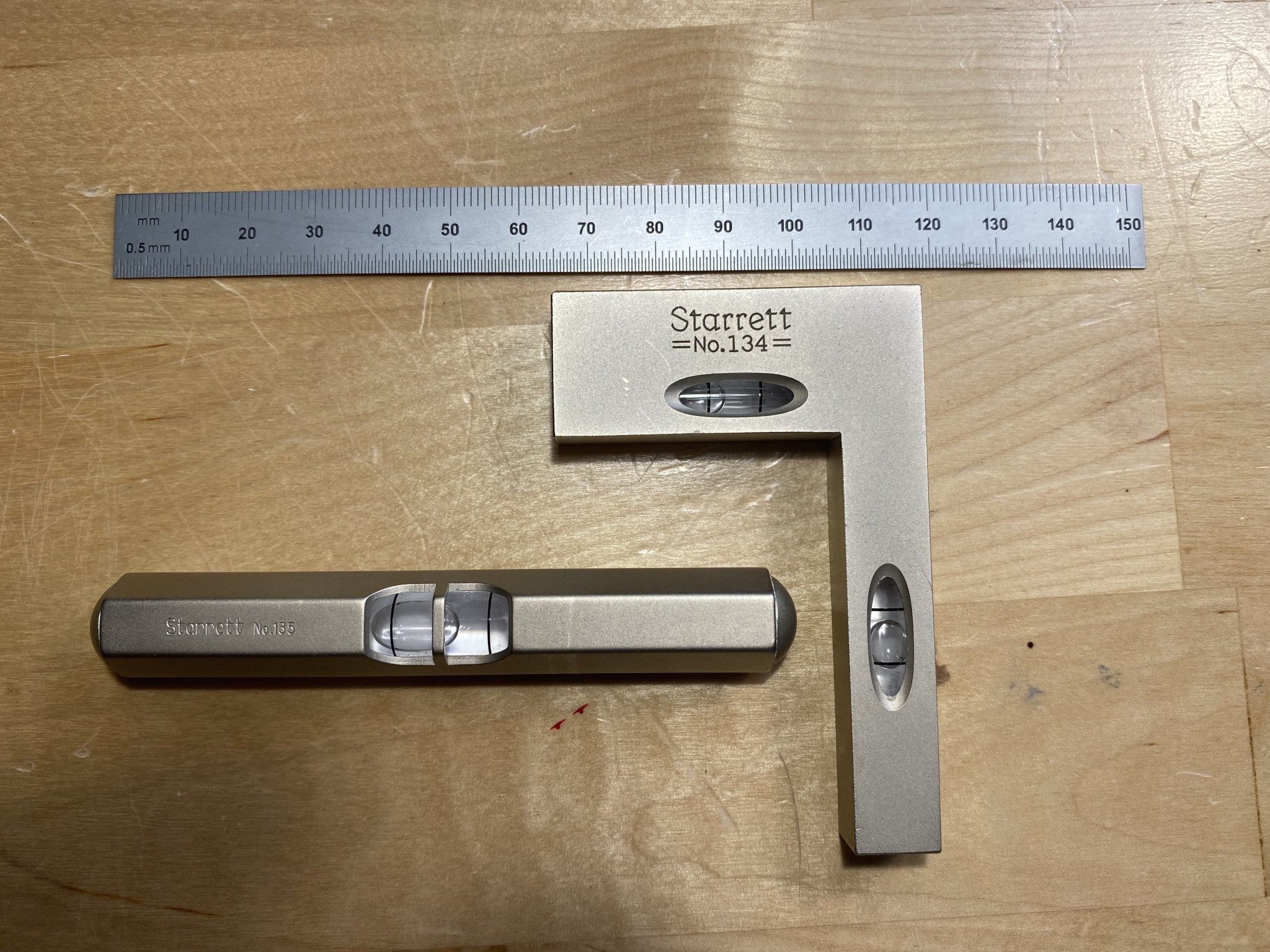

    I have the L shaped 136 by Starrett that works well but has to held on narrow surfaces . Wonder if your 135A is a knock off ?
    I need to get a straight one like that to replace an old Stanley I'm using now.
    Reactions: M8541Reaper
    Thanks, I’ll check em out. That’s a shame about the company not caring (I didn’t bother contacting them). A buddy just told me about the Milwaukee pocket level as well.
    It probably is a knock off. I just requested a replacement, so I’ll give em a second chance. If it’s trash, I’m going to do a refund. Regardless, I’m going to pick up the Stabila and Milwaukee PLs to try.
    I’m starting to get really frustrated with Amazon for this; a lot of their American branded tooling is knock off junk sold by the Chinese, and it’s getting very hard to figure out which is which until you get it in hand. (I know that a lot of American branded tooling is made in China now but I’m talking about the actual knock off stuff that’s even worse.)
    I had better luck just going to the hardware store and trying their levels until I found one that reads true. I think it’s a Stanley, maybe.

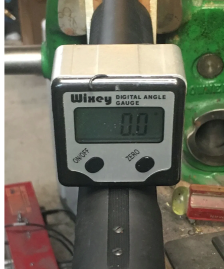

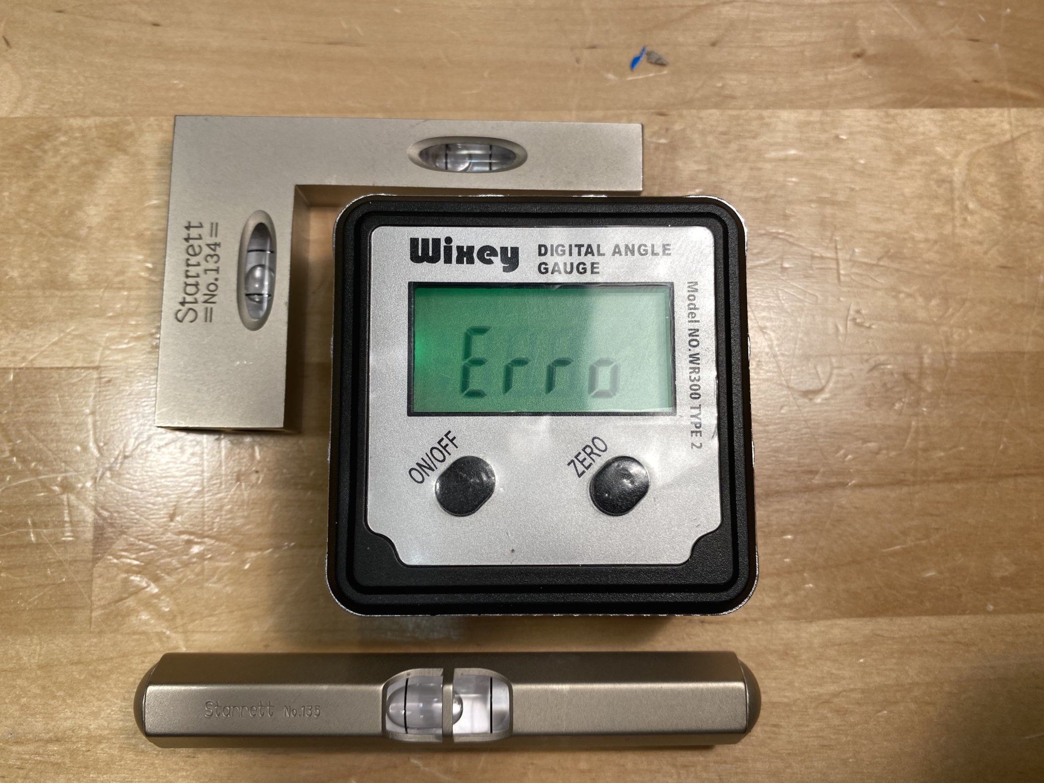

    I’ve also had decent results just using my iPhone; iMetal Toolbox is what I use. Verify it the same as you would a bubble, in my case it’s pretty satisfactory for a lot of jobs. I am a machinist so there are times when it’s not good enough, but most of the time it is. Hope that helps.

    I decided to add a couple of pictures showing how sensitive this level is. My torpedo level shows my work bench pretty much level. It better! I used it to level the bench when I installed it!
    Below are two pictures of the Starrett. The top image shows it laying on the bench and showing the bench a bit off quilter. But, how much is it off? Well for the bottom image I put a 4x6 index card under the Starrett's right edge and it went the other way. How sensitive is that? I pulled my calipers out. The card is .008 inches thick! I then pulled the index card off and it went back to the same as image one. This level seems to be on a whole other level! Pun intended :ROFLMAO:.

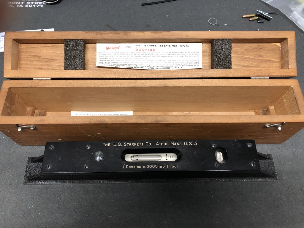

    The Starrett Master Precision Level is pricey. Picked mine up on ebay years ago for ~ $300; but overkill for most stuff. My go to levels for most things around the shop are SPI 360 and 3600 digital levels. They are almost pocket size. Looks like Mitutoyo may have bought them now as I see identical Mitutoyo 360 & 3600 levels.

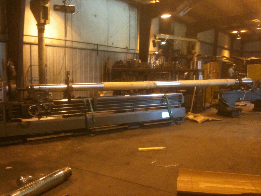

    But they are a God send for leveling machines. Had a project where I had to pull my lathe (Kingston HD 24x160) out and line up a 6 footer to hold an extra steady rest and had to get everything square and level the ram. Had to re-level when I pushed it back in place. I really wished I'd had something in the 300 inch range. Good times!

    As mentioned last evening I went ahead and took some flipping pics this morning. On another note I finally found a perfectly level surface in my house!! When we did the new kitchen we had an 8-foot island installed with a fancy stone top. IT'S PERFECTLY LEVEL!!! Yay!
    Here are the flipping pics. I took them on one of my kitchen cutting boards, which sits on top of my perfectly level island top. The cutting board is close to perfect level but no cigar. Flipping the level makes no difference in the result....
