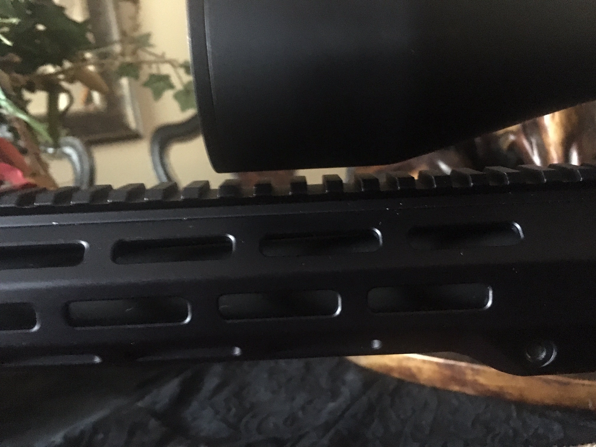

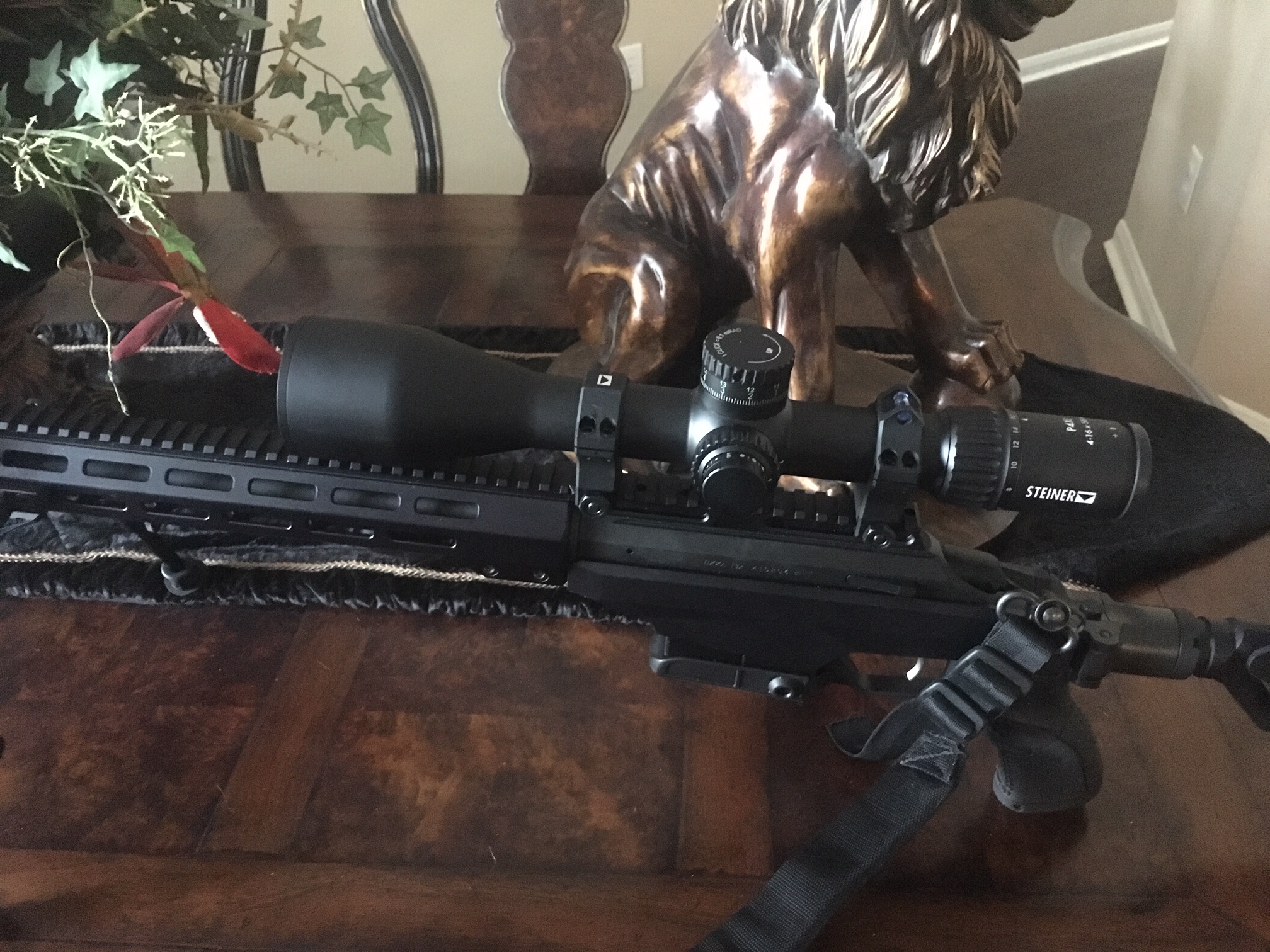

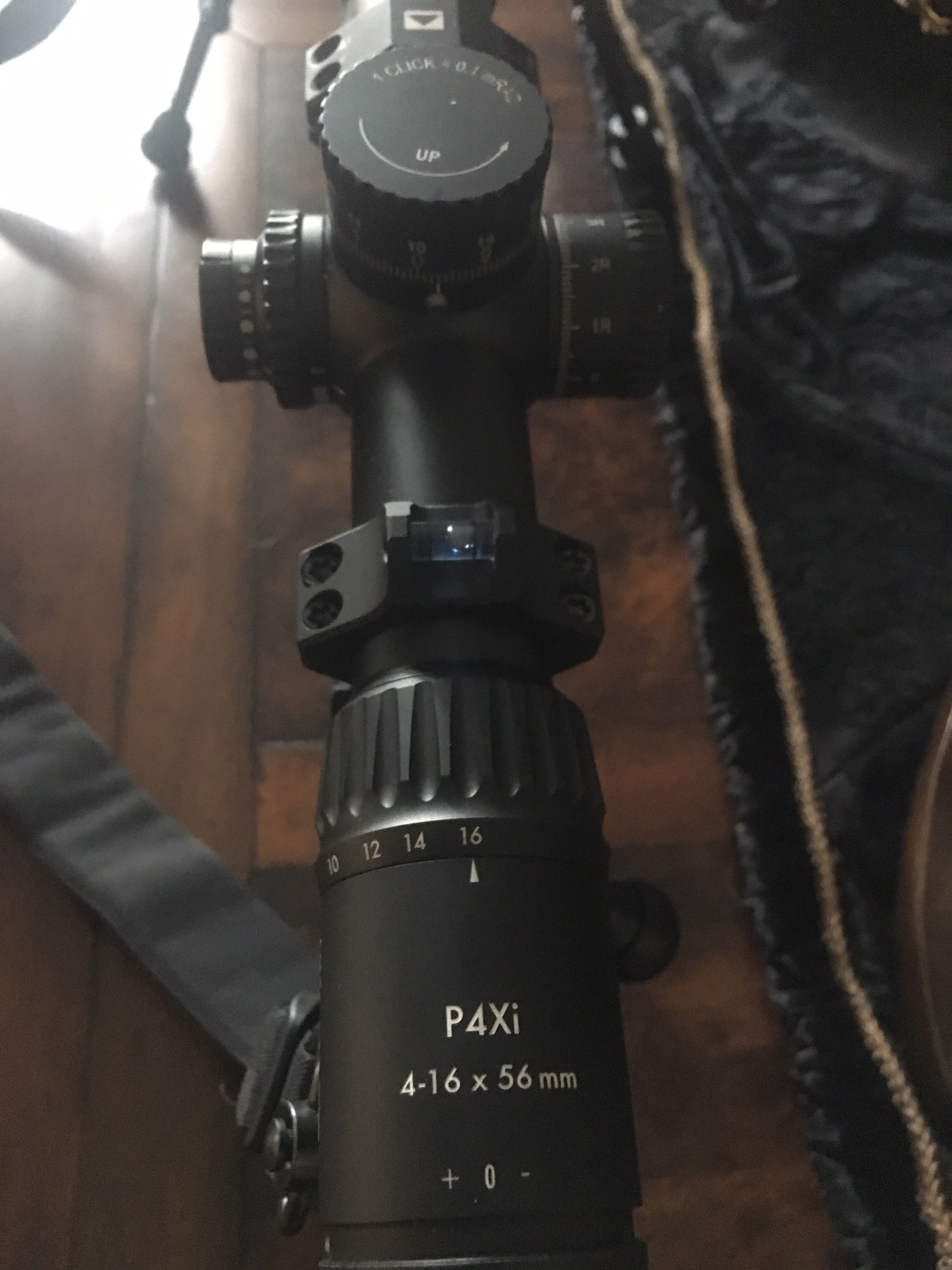

My Rings came in yesterday. Just got it mounted and torqued. I got the extra high 1.35" rings per Steiner. My Tikka does not have a 20 moa rail. I have not measured the clearance but a neoprene cover is tight... now off to the range eventually... Yes, the table is not level... I will be killed if I mention how I know....
