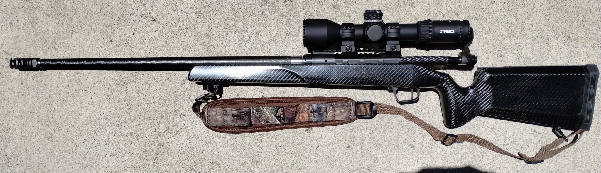

I tried and wanted to LOVE the NX8 2.5-20. It checked all the boxes for me. However, I think I had a dud out of the box. I couldn't get it to focus at distance. I thought it was me so I put my Kahles k318i next to it and did a direct comparison.
Ranged a few tress at different distances. Placed the diopter magnification to high on both to focus the reticle. Placed the mag on low and the parallax to it's lowest setting. Started with the NX8. Scoped the first tree that was 197yds. Kept turning the parallax till I reached infinity. It gradually got better as I dialed but still not sharp. Next up Kahles. Turned the parallax and while turning it cleared up to a crystal clear image. I looked at the parallax and like magic it was at 200. Scoped the next tree at 467 yds. NX8 never cleared up and the Kahles cleared up just before 500 on the parallax. Did the same test with my Vortex Razor HD Gen 2 4.5-27. Parallax was also spot on.
I will say I most likely had a dud but another thing I did not like about the NX8 was the push button illumination. Steiner offers a dial illumination. I went with the T6XI in 3-18x56 with the SCR2 reticle first before eventually settling with the T6XI 2.5-15x50 with the SCR reticle. I thought the Xmas tree on the SCR2 was a bit to busy for hunting. I generally NEVER take a shot passed 300 yds. The SCR reticle has no Xmas tree. Just hold over and windage. Also noticed very little difference in magnification on the top end between the 3-18 and the 2.5-15. Now if it came in red it would be my favorite scope at the $1500 price. Still getting used to the Green. Not bad by any means just used to Red.
As far as the glass goes it is crystal clear. No CA, edge to edge clarity is outstanding. My only gripe is the mirage at max magnification but all my scopes do that even the Kahles. I guess you have to go with ultra alpha glass "ZCO" to alleviate that but I do not have ultra alpha scope $$$
