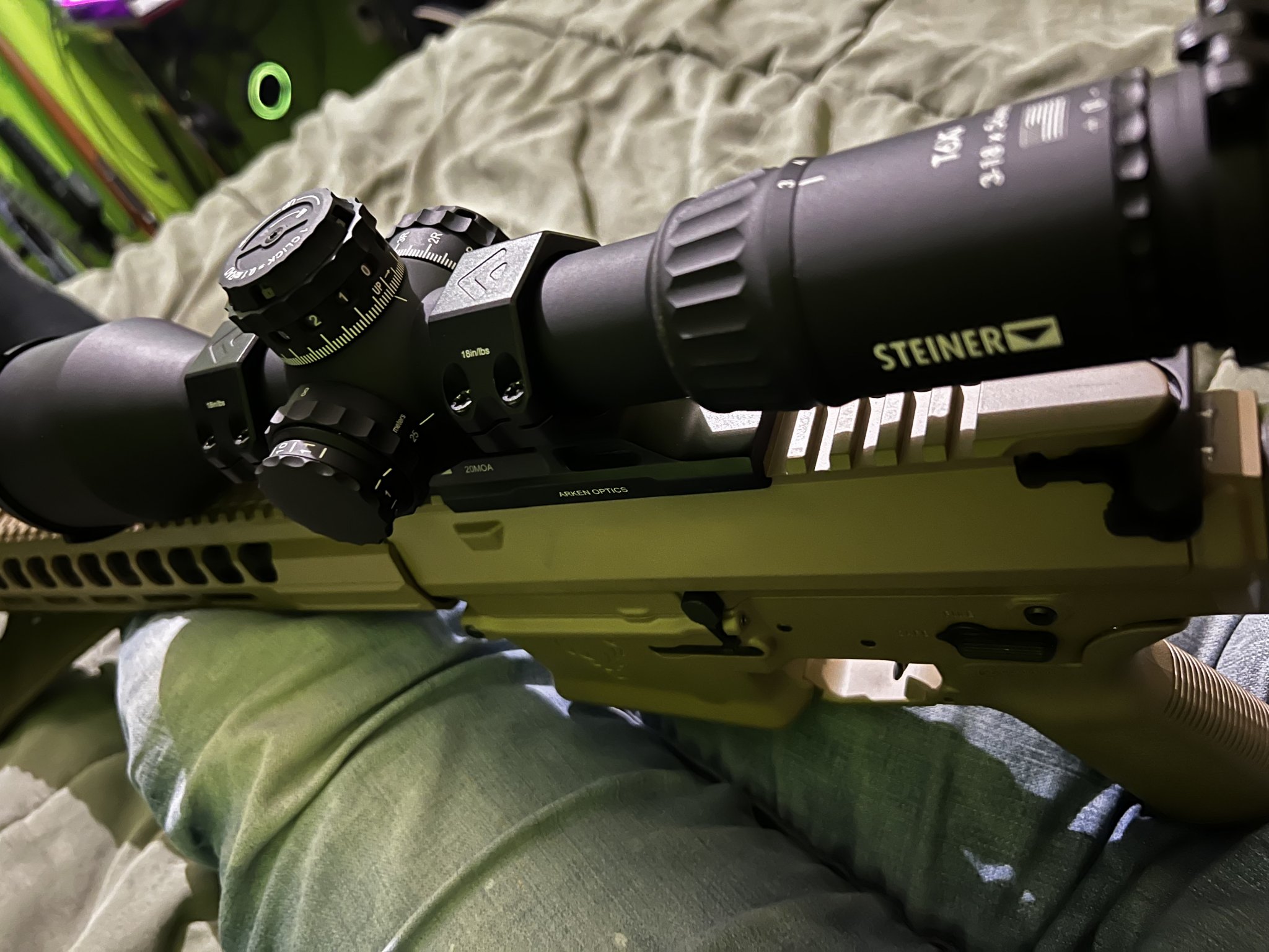

Just got it in the mail today. Overall I think these are really solid little scopes.

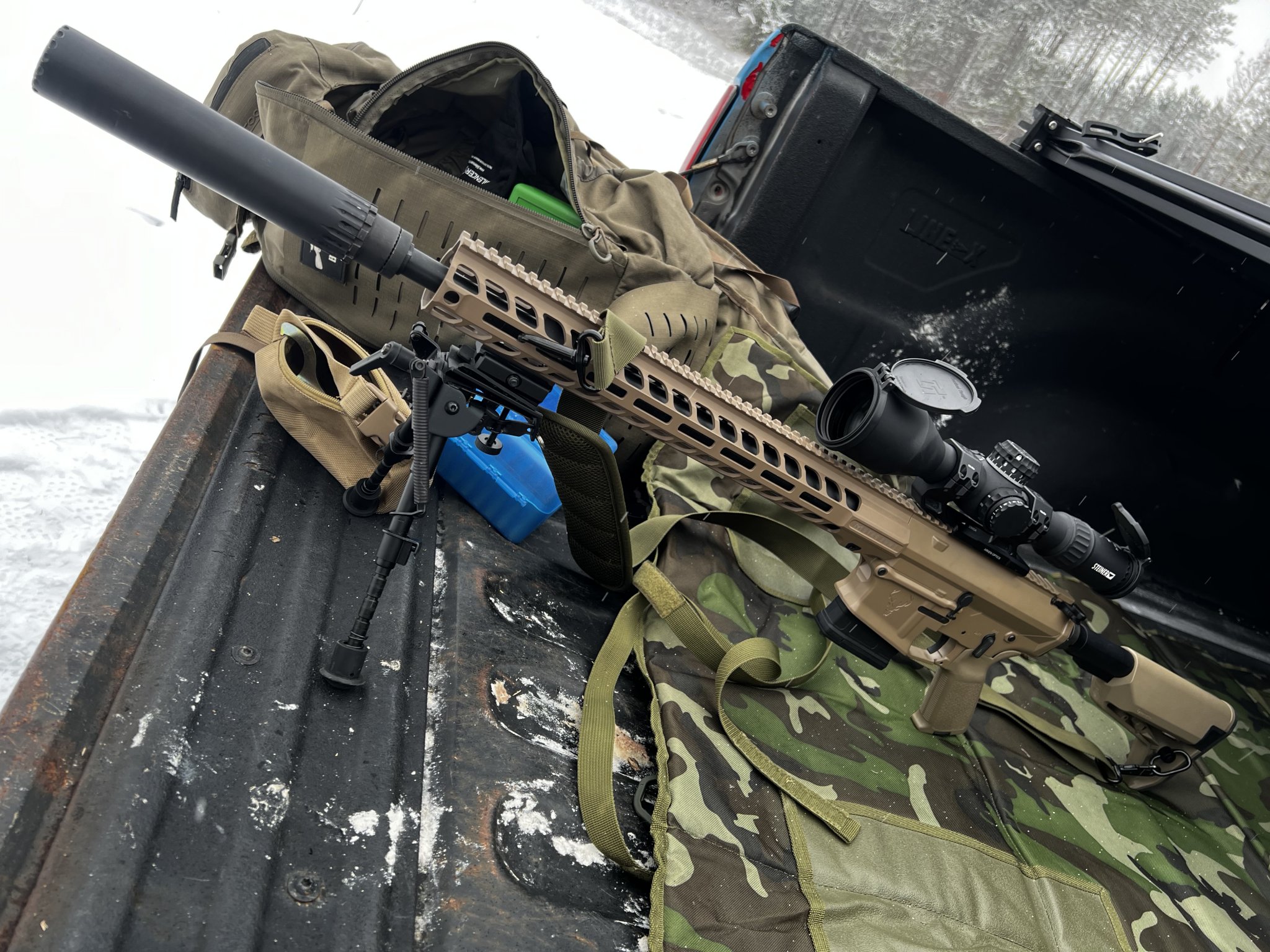

If anyone wants to try out a 1-6, I’ve got mine in the PX. As you can see in the pictures linked, the reticle easily daylight visible at min/max magnification.
