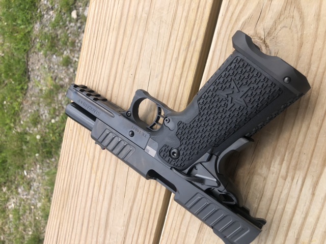

I caved 😂😂 it’s awesome.

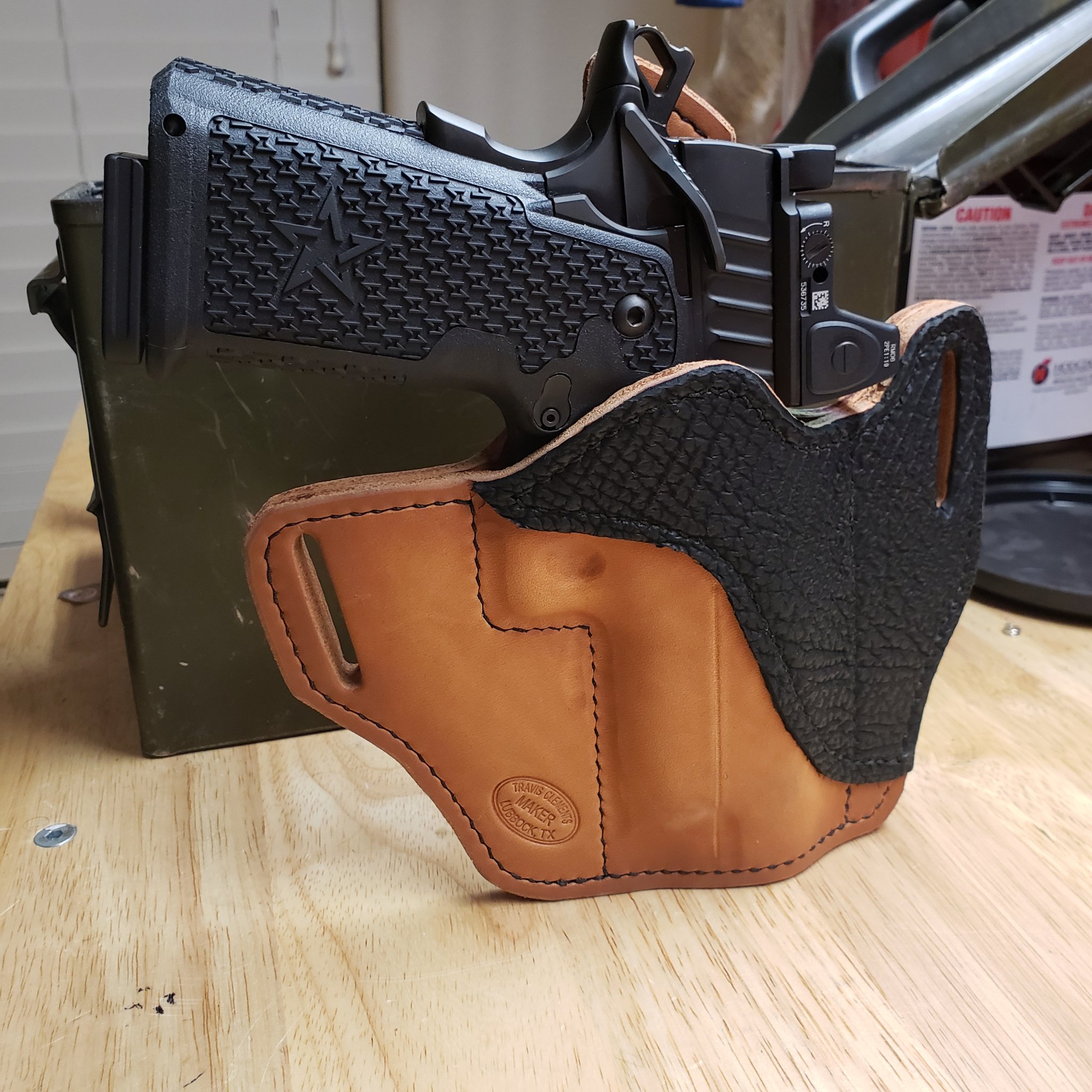

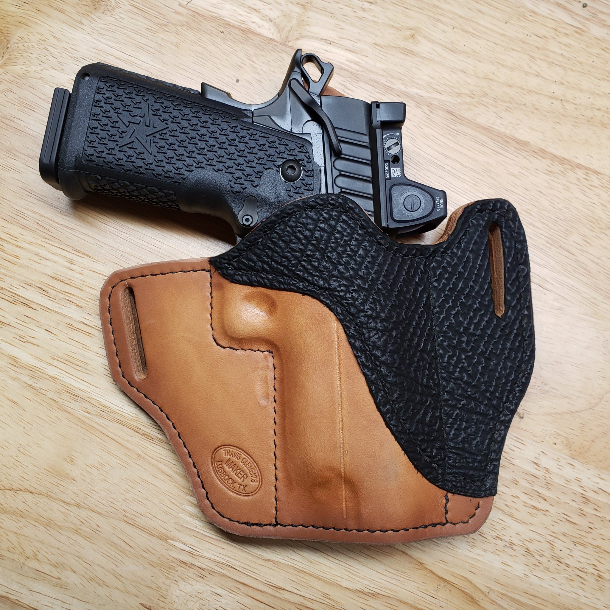

Here's the prototype holster in progress. Still need to clean up the edges and dye it black. It is 7oz Hermann Oak lined with 2oz Hermann Oak with a black shark skin stiffener. The molding is Busch League, but I'm happy with it overall.
Its sturdy
Look into W&C, Better leather, cheaper and A grade can be bought direct from factory in singles (HO requires 20). You can even buy backs. HO is not what it used to be.
Also, pick up one of Douglas's Stitching Groovers, will change your life: https://www.rmleathersupply.com/products/douglas-versa-groover-w-blade?variant=33334096131
Texas Custom Dies can also make you a belt punch that will make both look perfect. Both are money will spent.
I went down the leather route a few years ago and had a full leather shop in my house including Cowboy4500, 818, ect. Sold it all to buy more guns.

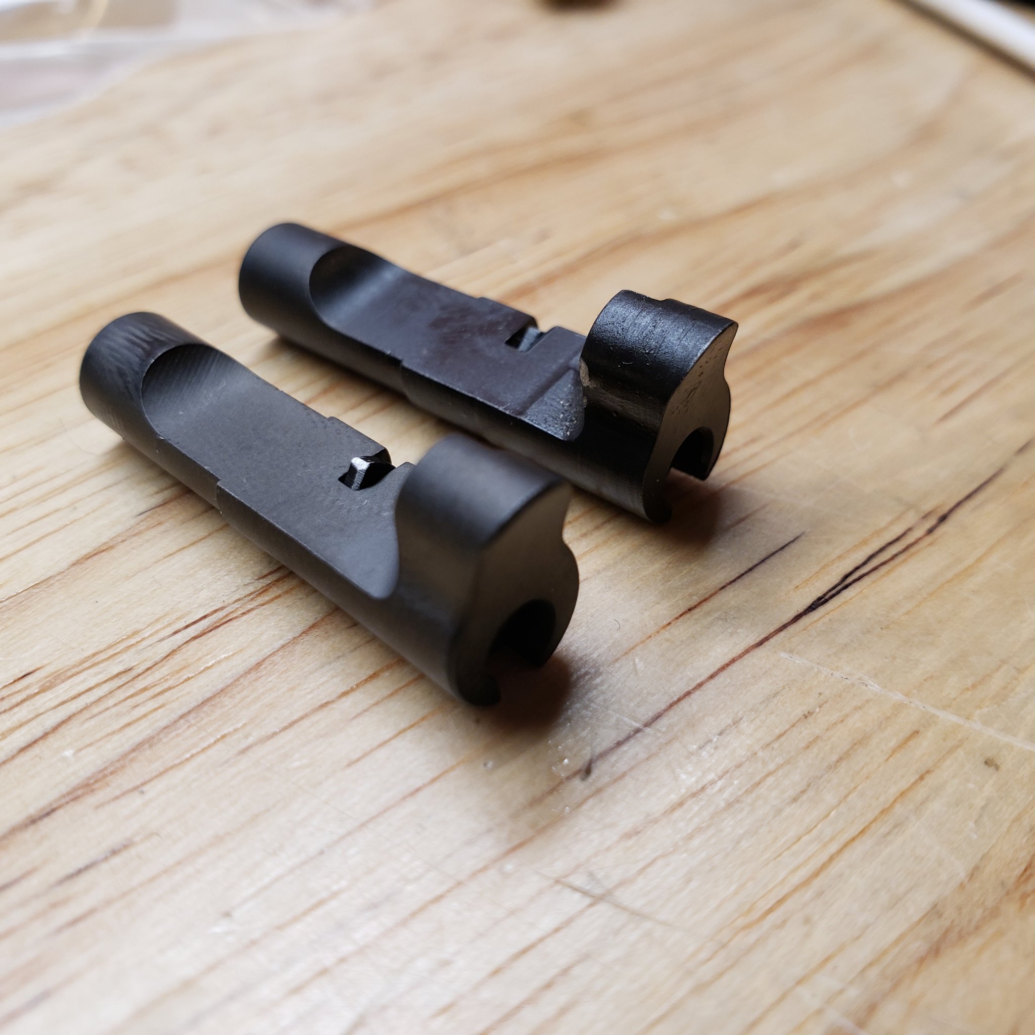

Got the new mag catch from STI yesterday. It is definitely different and the machining is cleaner. It will be a week or so before I get out to shoot.
New one is on the bottom
Almost seems like we are beta testing. I was going to pick up the C2 DUO that my shop has, but I think I'll wait a bit. Maybe Dawson will make a recoil system for it later.
He's already making them for the 4.4 and 4.1 inch guns. I've got his tooless guide rods in all my STIs. The main difference between the two mag catches is the little tap/paddle is slightly longer to grab the plastic a little better.

Can definitely see the paddle length difference in that last photo. Any noticeable differences on the exterior when installed? Trying to see if I should be expecting the same issue on mine

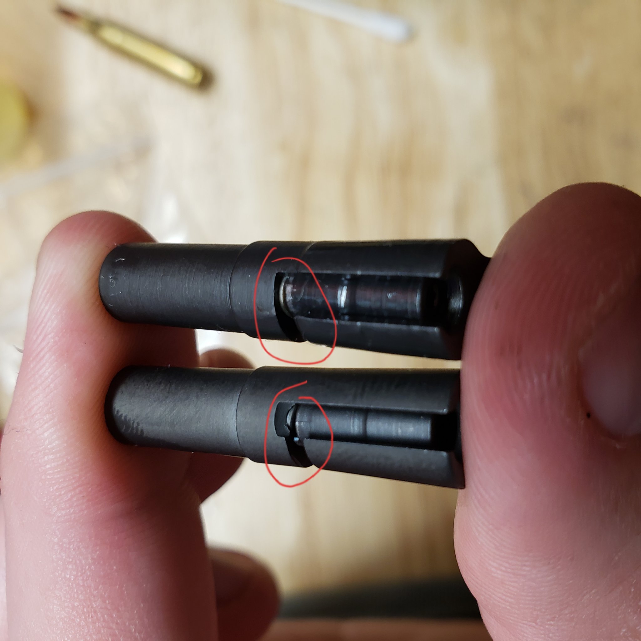

Yeah, I'm still not sure how that will prevent the hang up from happening again, but they say it will. There is also a relief cut that is circled in red, that is not on the old one. The machining on the old one is pretty rough in that area.

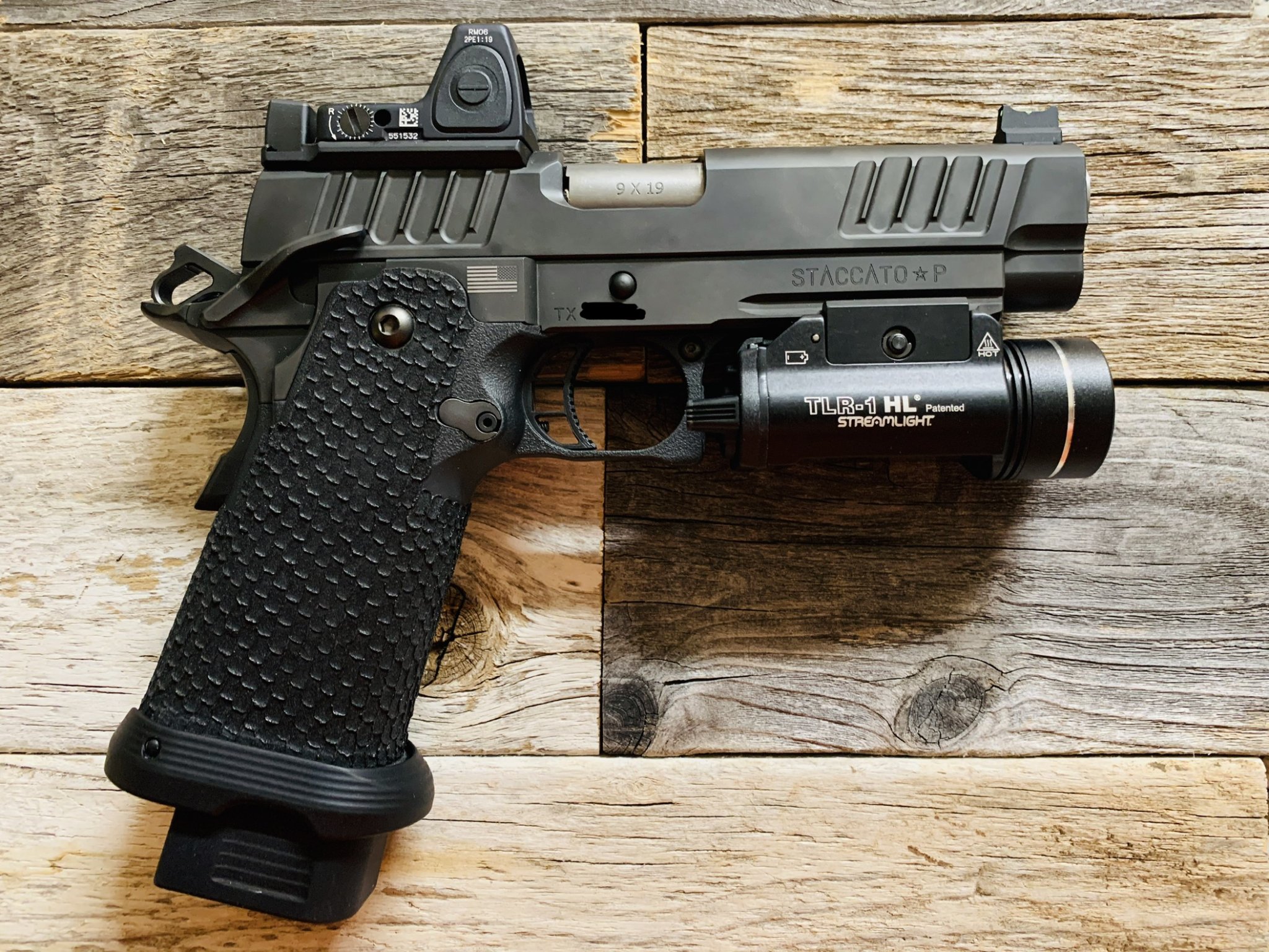

Sweet! How aggressive is the stippling? I carry mine IWB 90% of the time. Did you have them reduce it any?
It’s pretty aggressive. I wouldn’t want it rubbing up against my skin while carrying. I typically wear an undershirt when carrying in winter which is what I plan for this. Can’t really get away with it in the summer unfortunately.

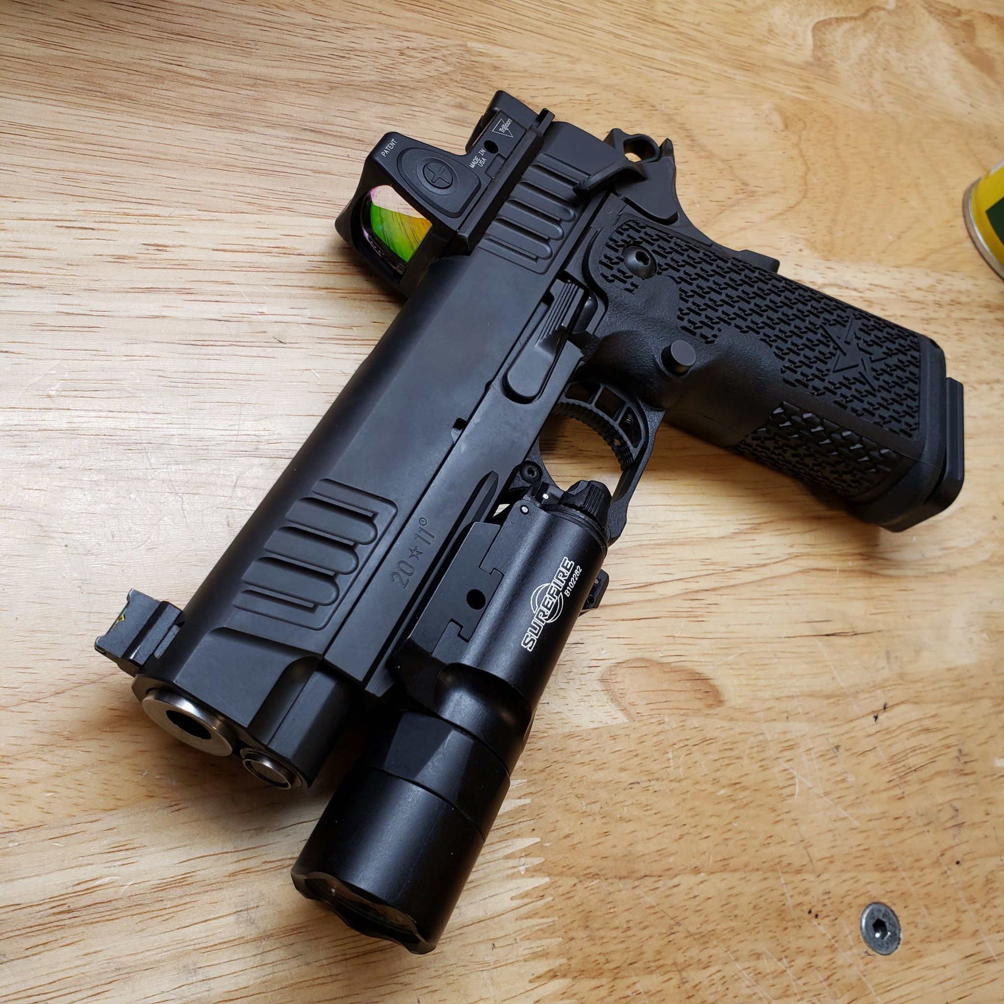

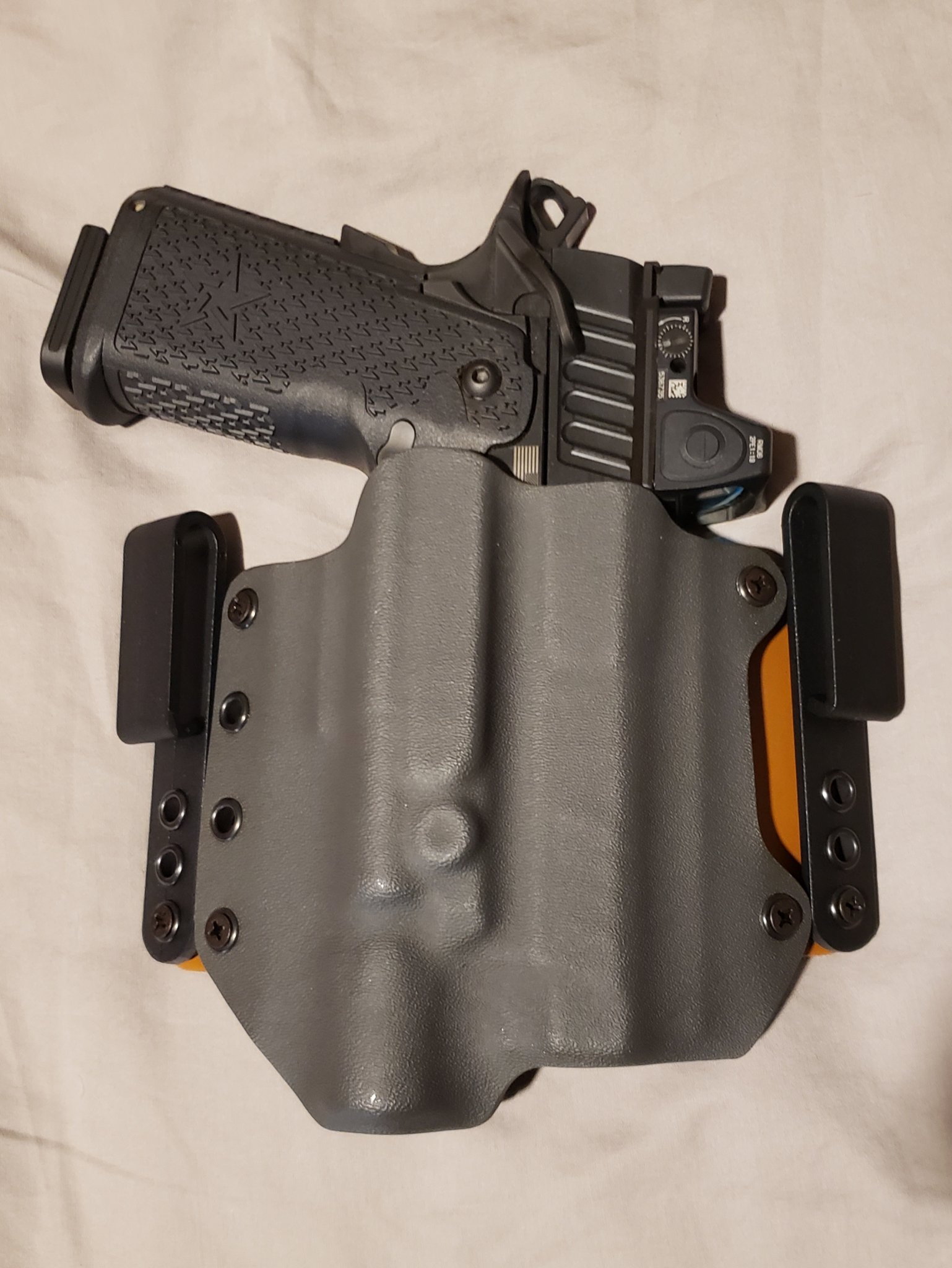

Got out and put a couple hundred through it with the new mag release without issue. Added some light to it and ordered a Black Point Tactical Mini Wing that will fit the x300. I've mainly been carrying in a LAS Concealment Shogun, but the Mini Wing looks a little less bulky.

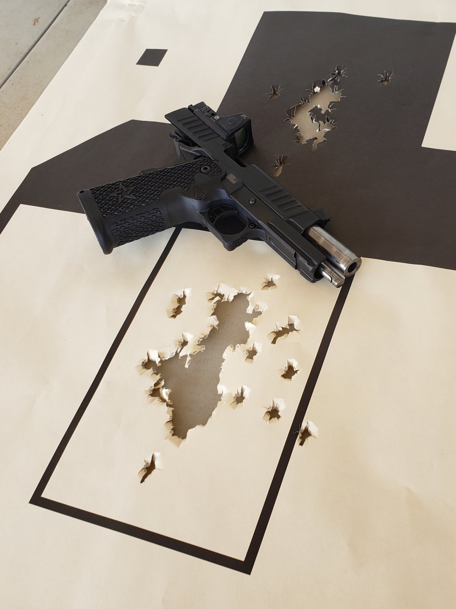

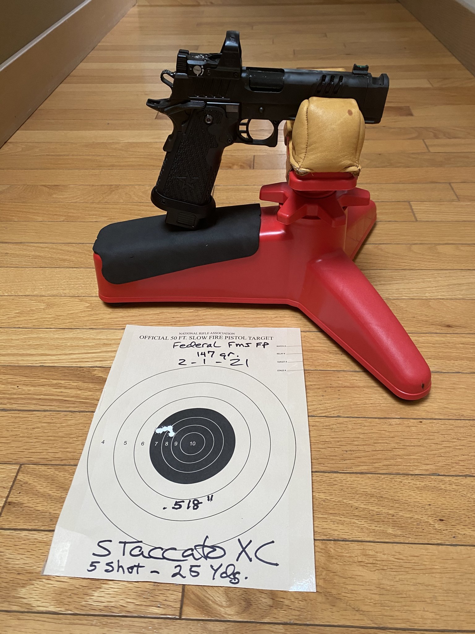

I liked the P duo so much I called up Dawson Precision and ordered an XC. When I finally got some more ammo and had a chance to shoot the XC I was pleasantly surprised, again. What’s not to be liked.View attachment 7545065
