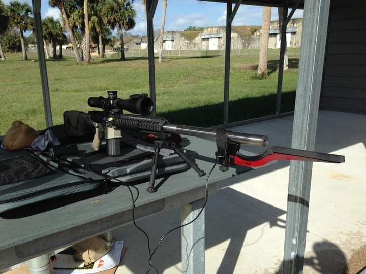

I don’t remember the exact shifts but I want to say it was around 1/4 ish moa and my other at was 1/2moa roughly.
That was with firm shoulder pressure vs light shoulder pressure.
Also firm grip over the hand guard onto a bag slightly influenced it as well.
Here is a picture of the finished product.

Man that is some serious eye candy!😍 Has me reconsidering wanting to go with a longer barrel!
