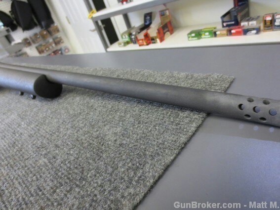

what barrel contour?

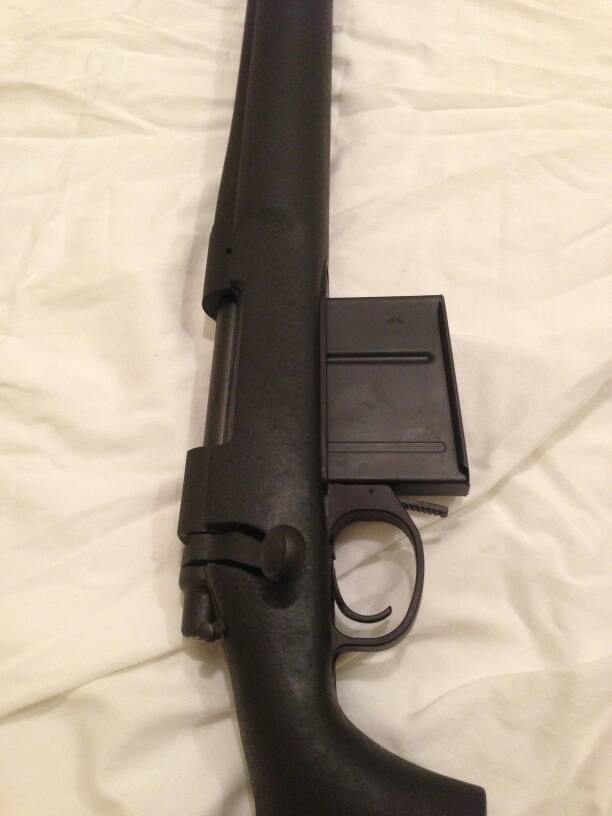

The floor metal is the standard one that came with the rifle from remington... heres a pic of it as well as the barrel.

The McMillan A-5 and the H-S Precision PST-026 stock both have different feels to them (I owned both). I have had both. While it is best bed the A-5 it is not an absolute requirement; I still recommend bedding it though. I did however shoot mine unbedded and achieved a sub 1/2 moa rifle. Now back to the differences in the stocks. H-S stock has a wider more rounded saddle style cheek rest with thumb wheel adjustment and length of pull adjustments with another thumb wheel. The McMillan you are looking at has a narrower more angled integral cheek rest that does not have a thumb wheel adjustment and only has a set screw, not sure how solid that is since my A-5 had the thumb wheel and 2 set screw hardware. Also the length of pull is setup using spacers. The H-S stock has a textured feel throughout the entire stock even on the saddle cheek rest. The McMillan is textured only in certain areas like the forearm and pistol grip. Other differences would be palm swell but both were solid stocks. Also, if you are using the regular BDL bottom metal both stocks fit just fine.
