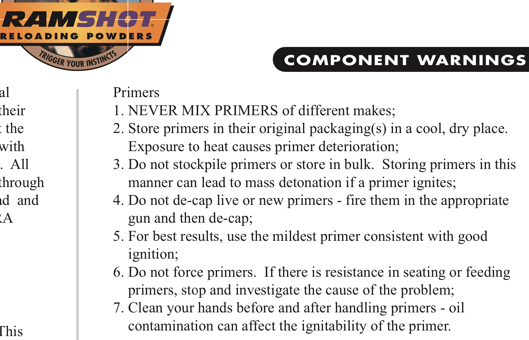

So I was looking at the website for Ramshot Powders and noticed this lengthy info blurb on primers.
Most of us have seen similar before, but it made me ask myself a few questions.
- what data sets were used to come to these conclusions? And where could one find them if interested?
- how much of this is lore and from old information or is this supported with current scientific studies?
- for number 1., I’ve seen various conflicting opinions on the effects of changing primer types in a load. All CAPS seems to indicate that this is a critical detail, yet I’ve not personally seen anything more than perhaps minor changes to results by changing from one brand to another. And most of that difference could have been within the noise of standard deviation.
-number 5. Is a rule broken all of the time by competition shooters for various reasons with no ill effects that I’m aware of.
- number 7. Is for factories and the OCD among us.
I’m interested to hear what others think and also in any hard data relating to the above posted warnings.

Well you ask an interesting question. I give some information:
NFPA and DOT have requirements for the transportation and storage of primers.
#2 and #3 The packaging is designed and tested to prevent the mass detonation of the package if one were to go off. Residential storage per NFPA 495 is required to be in original containers and there are limits for transportation and storage.
#4 It should be obvious that it is possible to detonate a primer by recapping it if enough shock force is applied.
#5 Don't know where this is from but it seems reasonable and the Bench Rest community probably agrees.
#7 The older mercuric primers were subject to contamination and that includes oil and sweat (urea and salt) and the compound was friable and poisonous. The lead primers used today are a hazardous substance but basically inert.
So in a nutshell, most of that is just lawyer speak, though there are some reasonable and common sense points made, right?
What about NEVER mixing primer brands?
As for using the minimum primer to create ignition, many a competitor uses small magnum rifle primers in cartridges that normally use just regular SRP. Some claim that the get more consistent ignition and lower SD/ES numbers that way
In short, much of this is widely accepted reloading “knowledge” that may or may not be true. Just because something has a regulation controlling it does not necessarily mean it it supported by factual data.

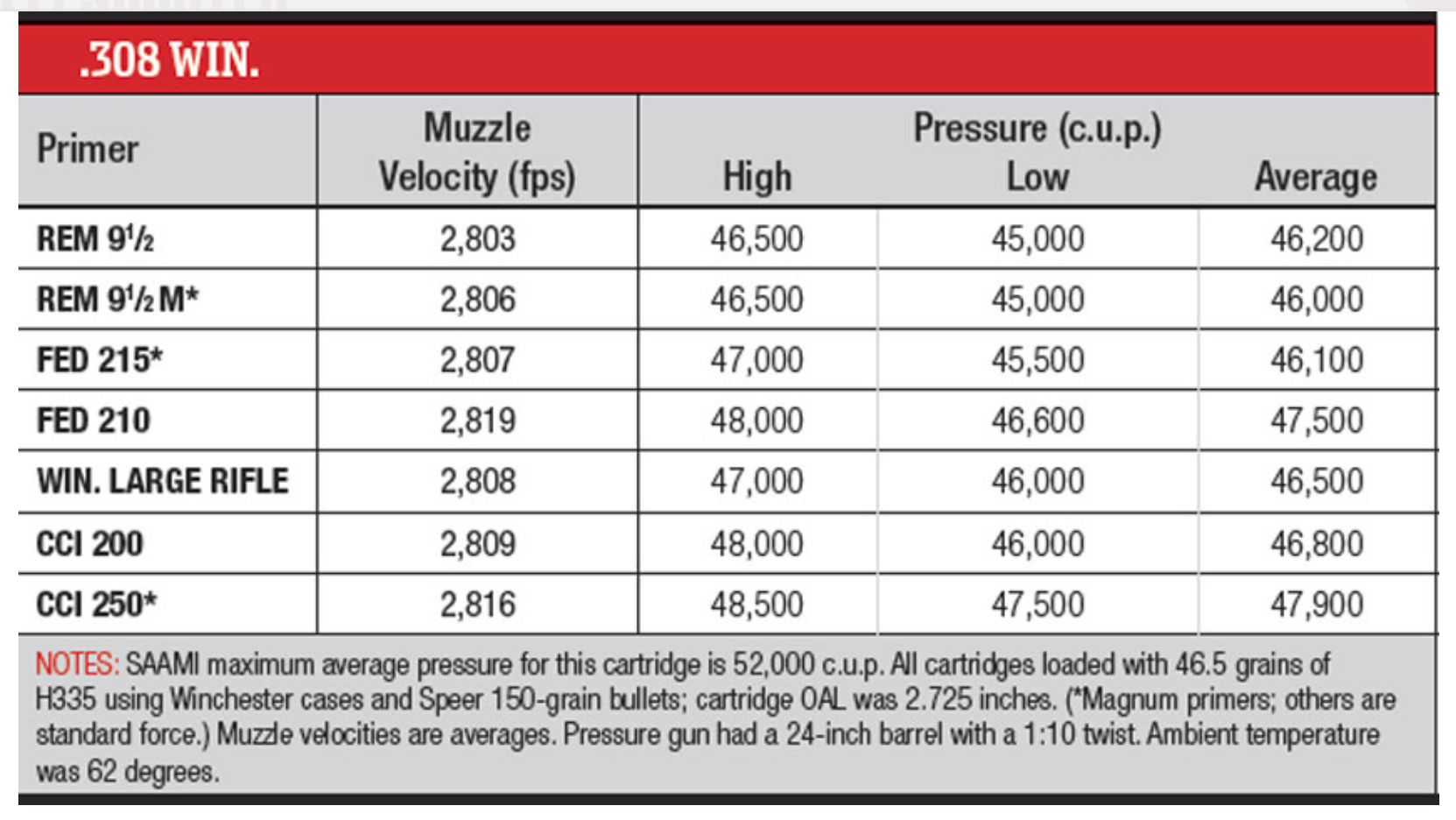

Okay, so let’s look for a minute at the chart they provided in that article.
A couple observations:
- note that the magnum primers resulted in lower or equal pressures in all except cci, which had a an increase of 500 c.u.p.
- the total maximum pressure variation between manufacturers is 1500 c.u.p., with all being well below SAAMI max pressure. - federal 210 and cci 200 were exactly the same.
Since this is one single load type and therefore a single data set, it is a start, but not conclusive. It is hardly scientifically supporting statements 1 and 5 conclusively.
I’m interested to see the data from the SRP test you saw.
