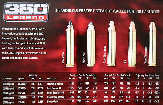

350 Legend. Created specifically for this purpose and designed to fit in a small frame AR.

Ohio is straight wall cartridges only also for deer rifles. .350 Legend and.450 Bushmaster are very popular in that role.
I wanted to hunt suppressed too, but couldn’t very well shoot a .35 or .45 bullet through my Sandman.
I built a suppressor on a form 1 for .450 Bushmaster, and had tax stamp in hand and can built before hunting season. Shot a doe with it on a 450BM and my daughter used it with a 350L on another doe.
