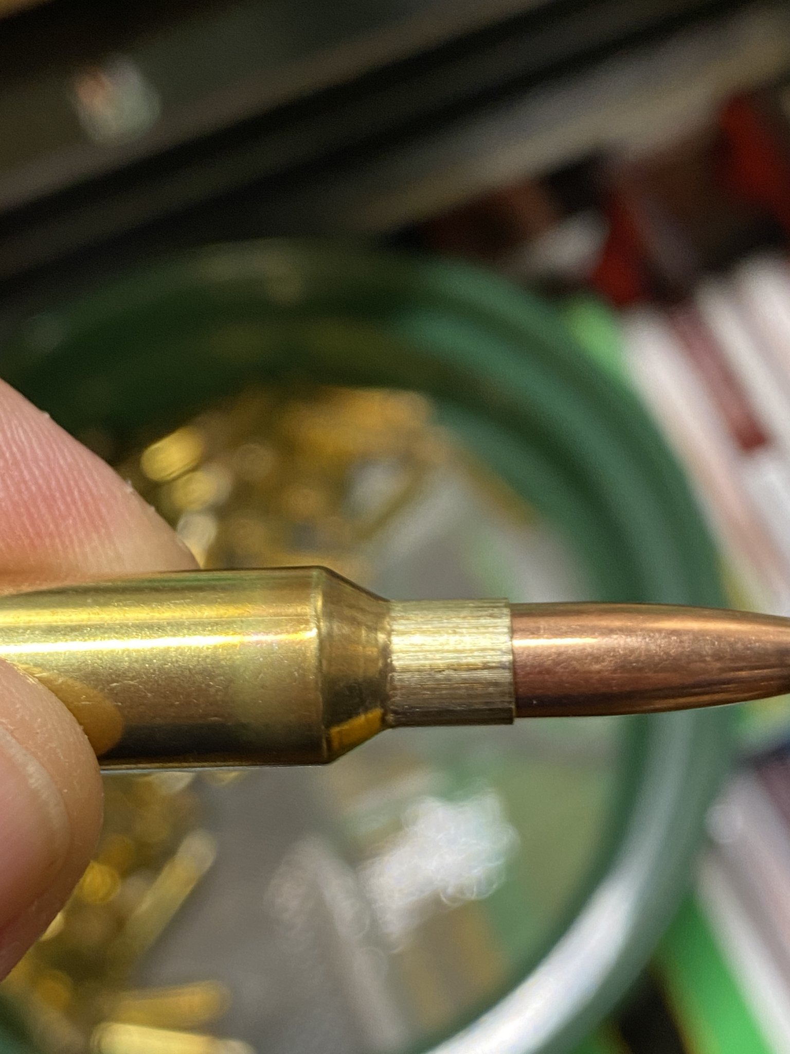

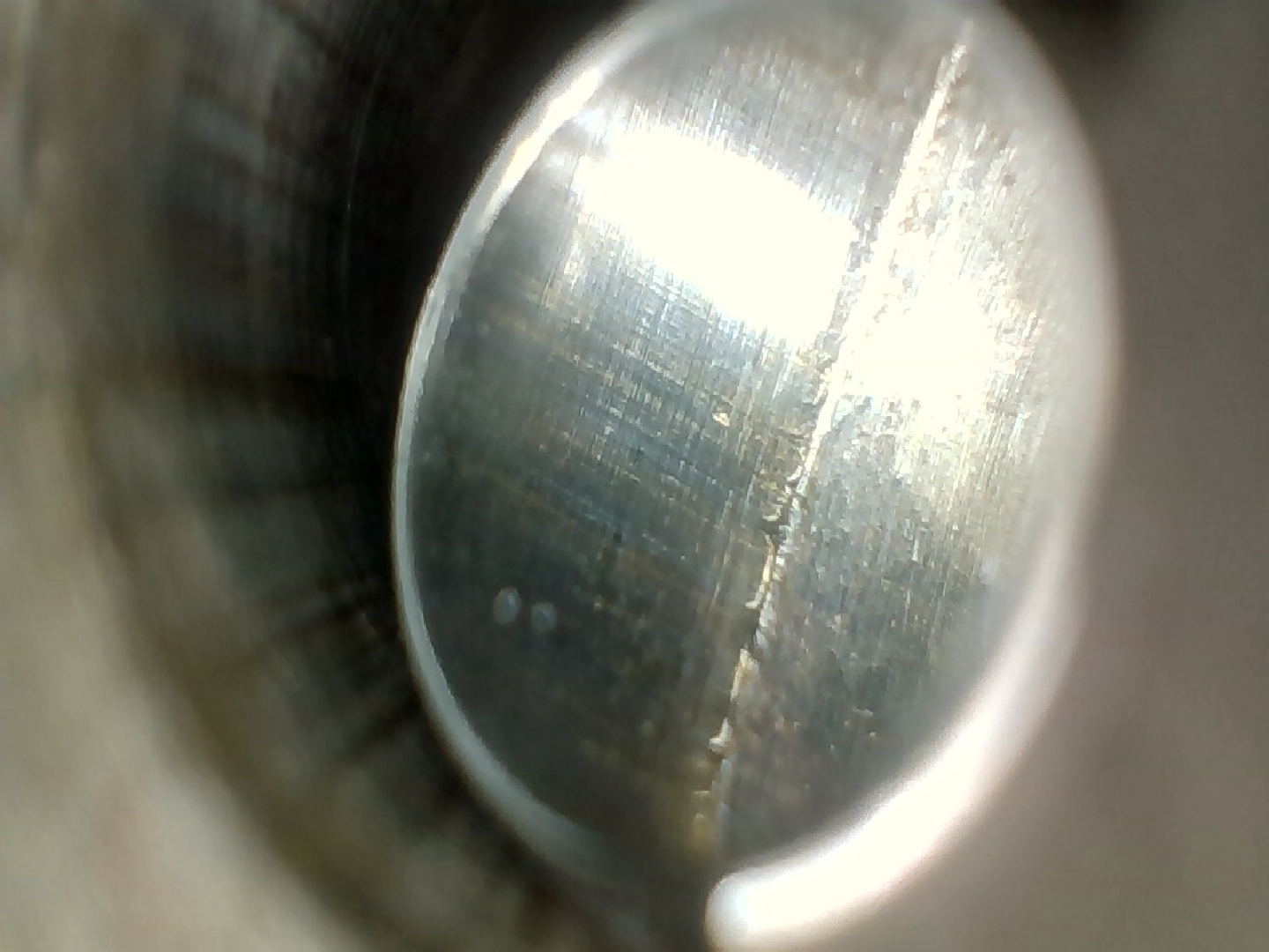

    I had some brass that needed to be cleaned up after being in annealed (sp?).
    I ran it through my Reading FL die, as truthfully we’re not doing a full resizing and I really didn’t think it mattered (as opposed to just using my neck sizer), and I started seeing this:
    Does anybody have any idea why this is happening?
    Funny you know I switched it out with an RCBS die just for giggles, and eventually started doing it as well.
    I have to take the guys out and inspect them but… Has anyone ever seen this before?

    I’ve seen it/had it happen to my brass. I neck size only (Oh, the horror :eek: ) and I’d get those marks if I annealed first. Now, I decap, clean, resize, anneal, then load. No more marks.
    Don’t know what caused the marks, other than the brass possibly/probably being softer from the annealing. The neck sizing button is smooth on the inside. Nothing there to polish out.
    Your brass is realllllly lean, like striated glutes in bodybuilding...

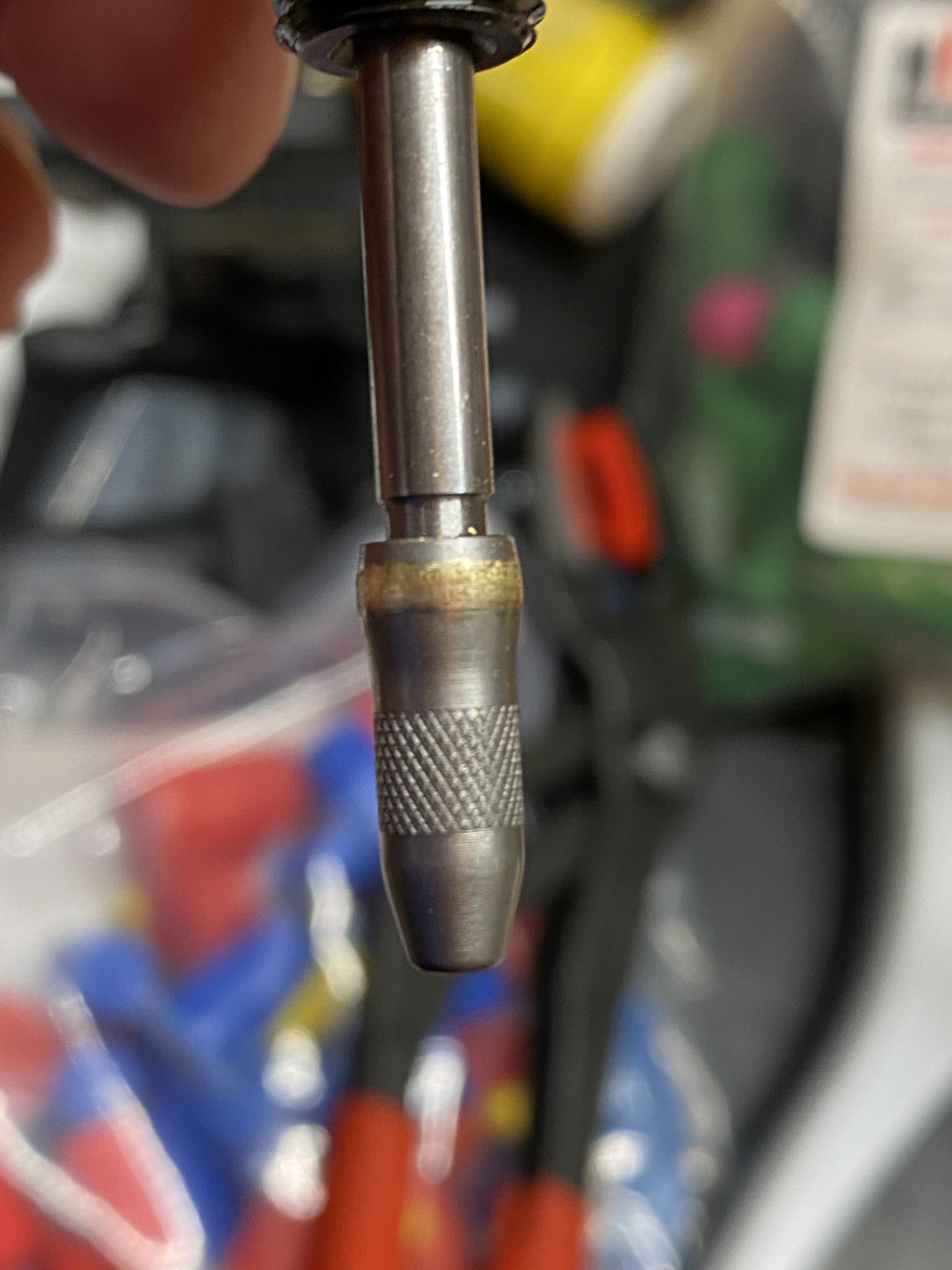

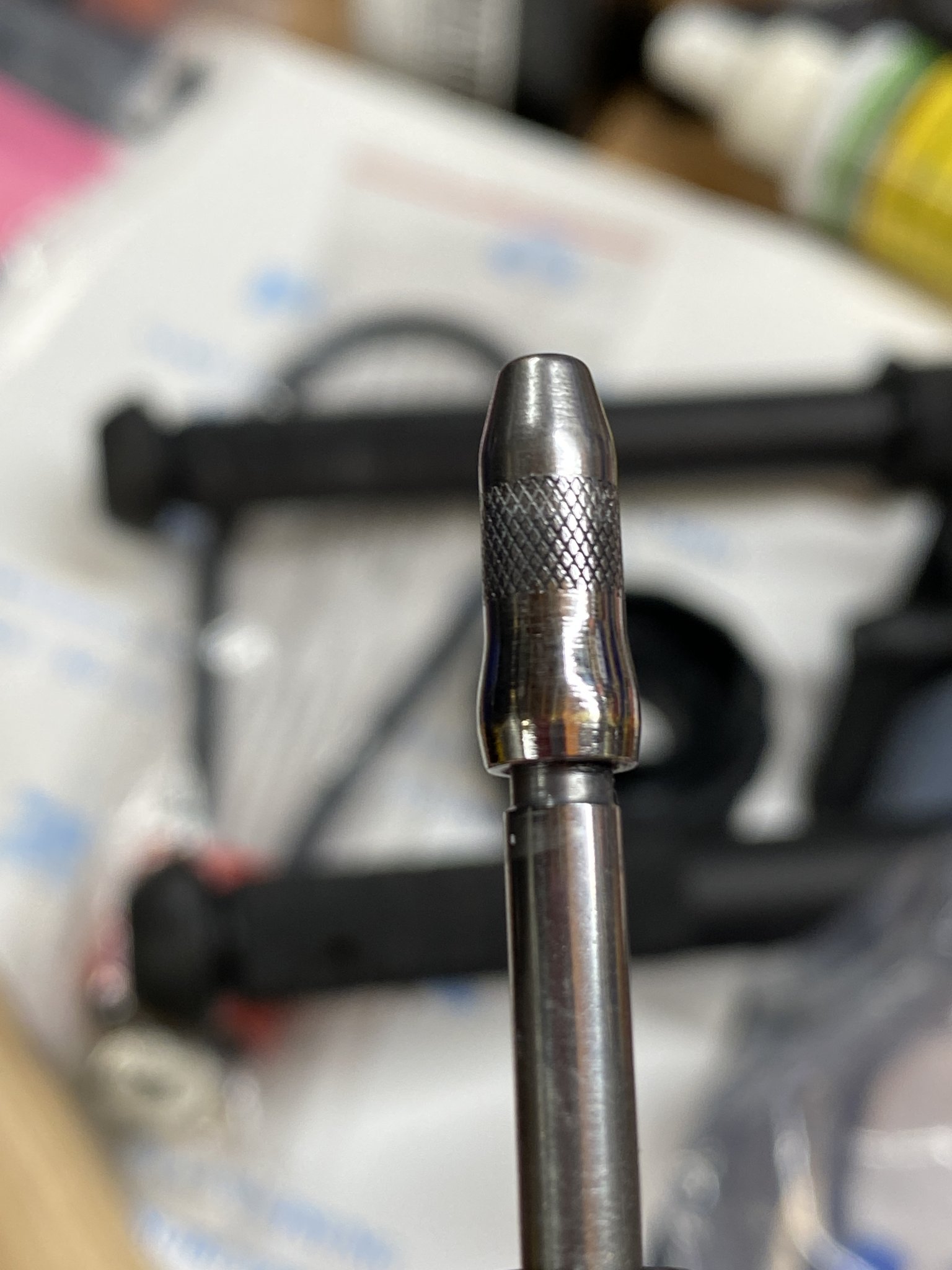

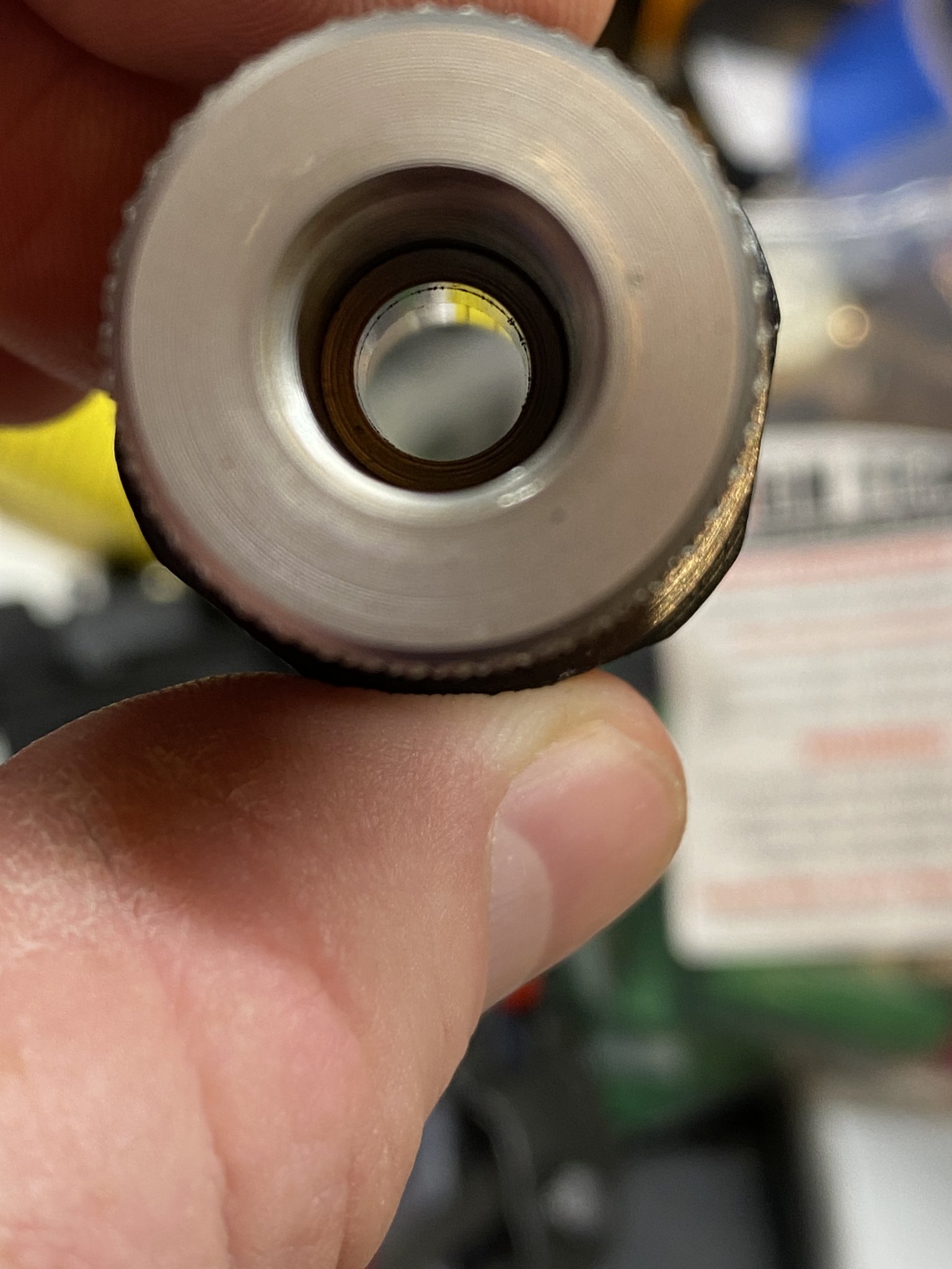

    The neck area of your die is trashed up, and it’s embedded in tight so cleaning it isn’t going to work by just carb cleaner and wiping. It’s going to need polished out with a drill or Dremel. Forster dies like to do this much faster than other brands in my experience.
    Interesting ... I struggle a bit with that logic. Annealing is specifically used to make the brass more malleable and flexible during resizing. If you're not going to anneal to improve the brass' chemical properties prior to resizing ... then what's the value of post-resize annealing. Not criticizing ... just saying that annealing "after" sizing is exactly the opposite of virtually everything I've read and seen on this topic.
    So... ahhh... brass in the neck sizing area...
    Yes, I'm bad... I tried to neck a few of them without lube. I guess that's it... I've been using the Redding neck bushing dies for so long, and never had this issue... that I just didn't consider it with normal dies.
    I blame all of you for buying all the redding neck sizing dies and creating a backlog on the button inserts! ;)
    Thanks folks!
    I'll get out the dremel with the buffing wheel and clean it... but I'll take the bore scope to them first and post it here.

    I have seen this, but just not this bad with tumbled brass. The edge of the case neck gets peened over when tumbled then when you resize the brass
    the die shaves some of the brass and it gets between the case neck and the die causing marks like you have.
    Chamfering the brass before sizing it helps prevent this.
    If you have a borescope check the dies neck area especially the shoulder/neck edge for brass particles.
    Had the same problem. Something is gaulded up in your die. I cleaned and cleaned mine no change. I ended up calling reading they told me to send it to them they cleaned and polished it free of charge. It was when the pandemic first started so it took forever to get it back i know they were shut down for awhile last year. Haven't had an issue since.
    I had the same thing occur. This actually seems to be a common question in the reloading depot. Maybe we can get a sticky made about it.
    Polish up your die to remove the galled brass and it should correct the problem.

    So I go downstairs I disassemble one of the dies and I find brass caked on the expander mandrel:
    I put a little bit of flitz on my Dremel tool and I proceed to start buffing..,
    It doesn’t get off all of the brass because it’s on there good:
    It’s hard to tell how badly caked up the diet is but I can’t find anything small enough to get in there at a high speed and buffed it out:
    You know... I kinda wonder if using the ultrasonic with some copper remover wont work? hummmmmmm
    I’d try the copper remover by itself first. Think of it this way, we don’t ever feel the need to put barrels in an ultrasonic, we just use copper remover and it works eventually. Plus, I’ve heard too many horror stories about folks ruining their ultrasonics. Usually with CLR, grantee, but I wouldn’t be surprised if an aggressive copper remover also had some corrosivity.
    Does CLR dissolve copper / brass?
    I've got a stainless ultrasound...
    I actually don’t know if it does, it might but I figured copper remover had a better chance so I started there.
    The stainless ones are the ones I’ve heard of being ruined; pretty sure TBAC had one of the horror stories. @TBACRAY, any chance you can confirm I’m remembering this right, that you guys lost a stainless ultrasonic to CLR?
    Ive got a redding 223 die basic die that does the same thing. Its just the outside of the neck and it doesnt effect how the rifle shoots.

    Is there a possibility of too much lube getting on the outside of the neck?
    I had some necks look like that on the outside and cleaned the die with carb cleaner, gone.
    Came back a couple dozen rounds later. Cleaned and gone.
    Noticed I was accidentally getting sizing wax on the neck (in a hurry) and slowed my roll paying attention to my lubing of the case.
    No problems with same die since.

    Boretech eliminator should remove brass. I shoot brass solids sometimes and it seems to grab it from the barrel on patches. Have to cover my brass jags in masking tape first otherwise it discolors the patches right away.
    If you have a carbide die/expander you can use this stuff https://www.delphiglass.com/solderi...atina-for-lead-and-solder-8-oz?source=froogle
    I drop a TBSP in a glass and swirl it around with the carbide ball submerged. After a minute or two all the brass will dissolve

    Take a bore brush, dip it in copper solvent, run it/out of the die until it cleans the shit out. Spin it in a drill if you have to. It’s a small amount of brass and will come out easily if you use a good copper solvent.
    Reactions: Steel head
    it happens, use a high grit abrasive and run it thru till it cleans up or send back to the Die manufacture and they will usually clean it up for free.
    Get a cotton mop normally used for cleaning barrels, use a tight fitting one and iosso or similar product. It works great if you have to clean the die or bushings.

    Not enough lube or burr on case mouth being rolled in between case neck and die is the two most common causes. I’ve noticed Hornady brass seems to be the most problematic me for some reason.
    I’ve had that same thing happen to me and the above solved it.
    I haven’t had it happen since but I’m a lot more meticulous with the lube now.
    You really couldn’t see it or feel it easily but the galled brass was stuck in the neck and did a number on the necks.
    It looks like shit but it won't hurt anything.
    People tend to obsess over how their brass looks, but if it doesn't change the performance, then why stress about it?
    I don't understand some people's fascination with making brass look brand new after every firing.
    Those scratches shouldn't hurt anything.
