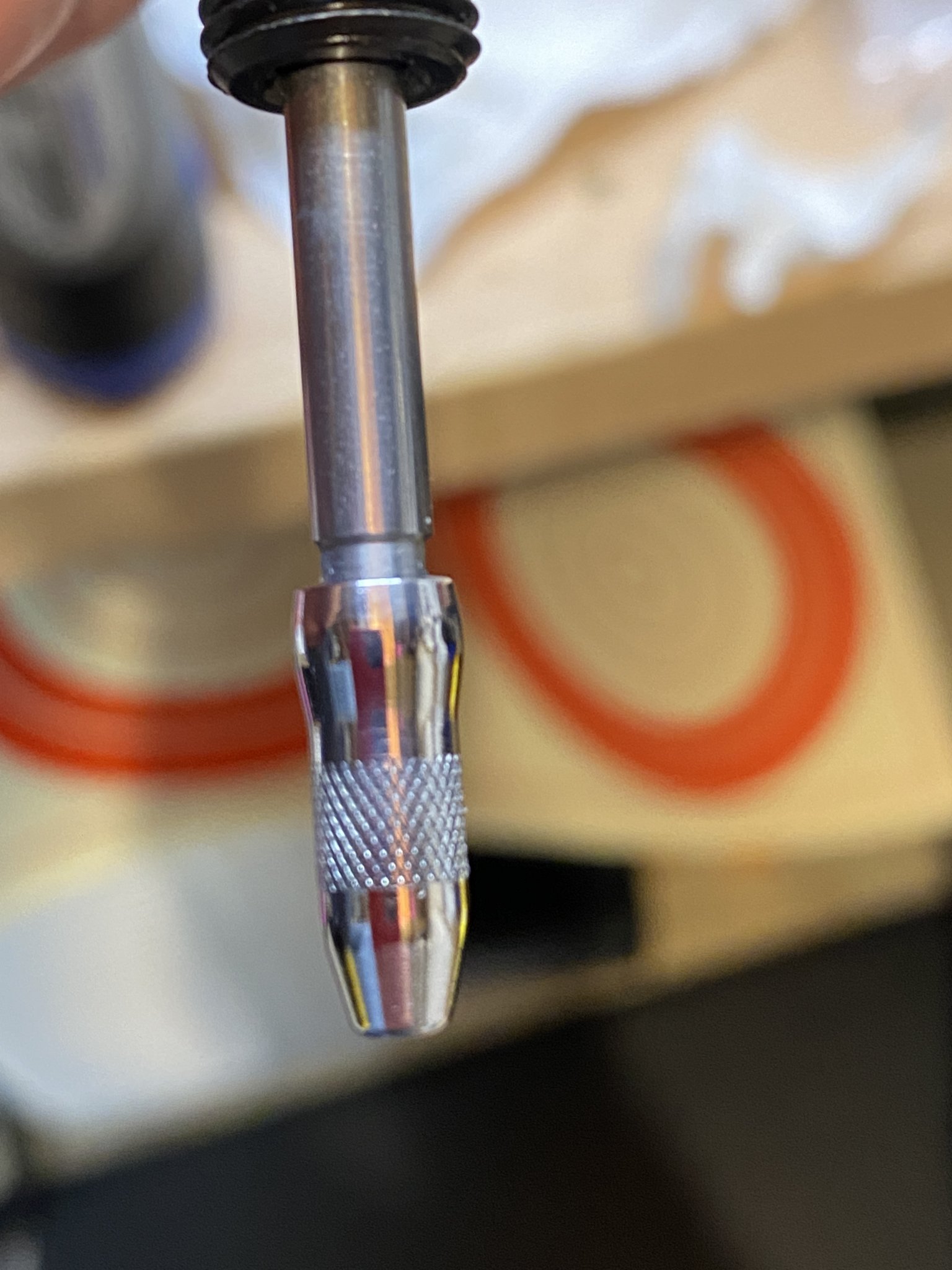

Striations on brass after neck sizing - WHY?

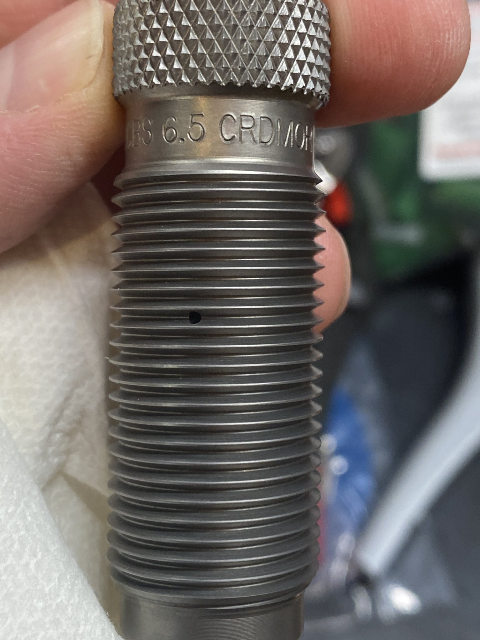

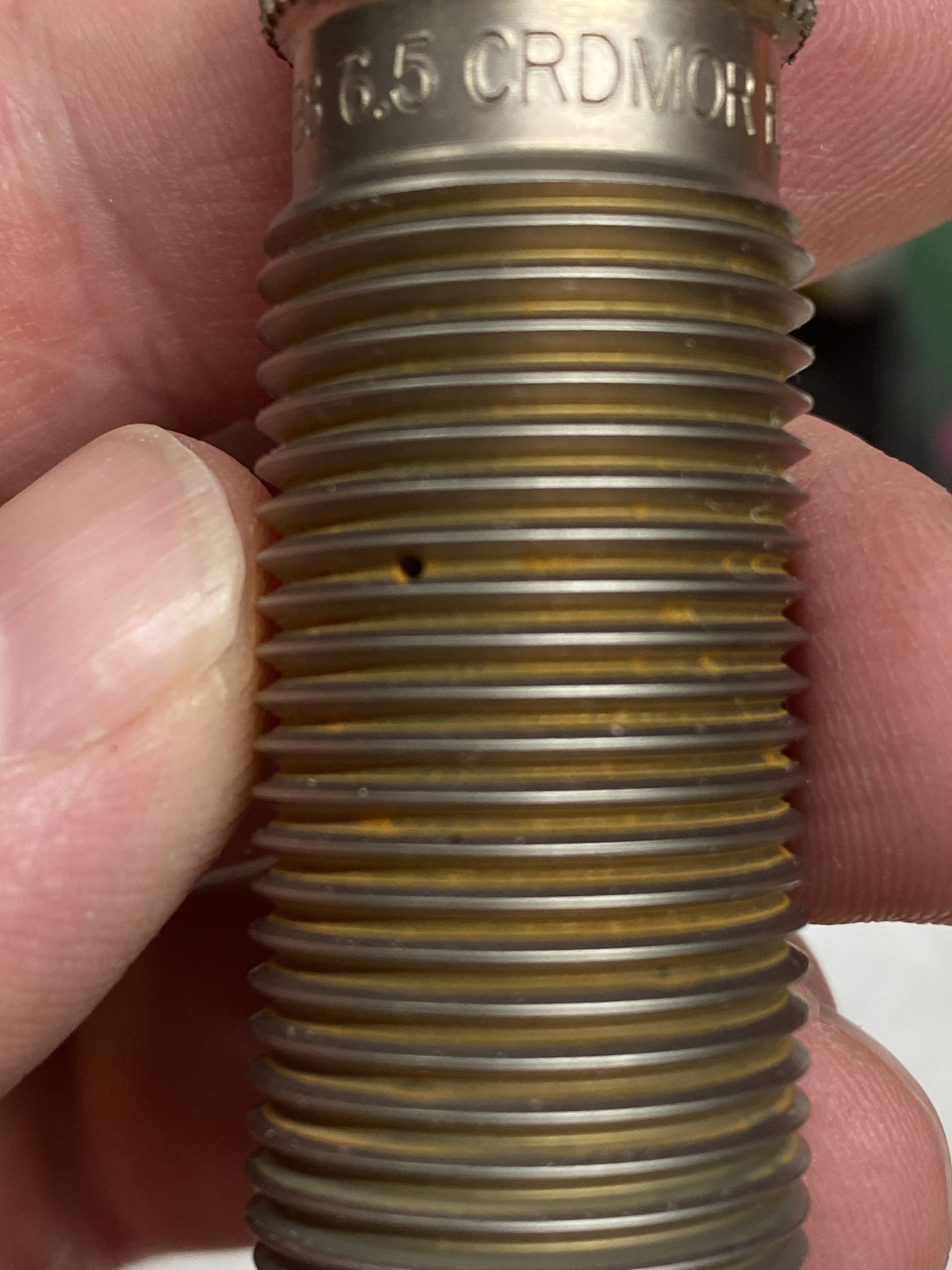

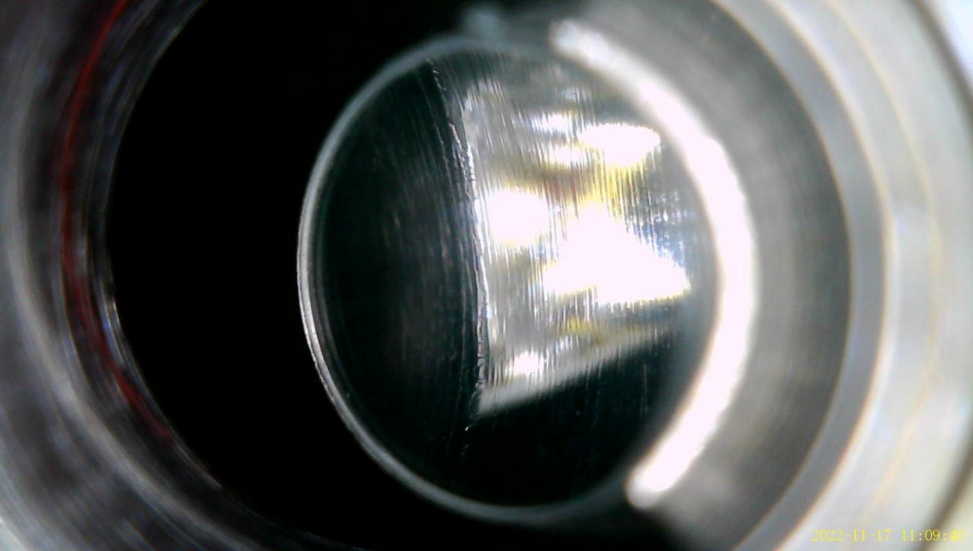

So I ended up putting one of the dies in boretech copper remover... and let it sit overnight.
This was apparently not the best of ideas:
I then proceeded to buff the living shit out of everything to see if the remaining brass would come off the die:
And I have to be honest polishing the living shit out of that definitely worked...
However now I had all sorts of surface rust on the outside of that guy which was really pissing me off:
Ta freaking Da
I have experienced the striations issue with various dies, especially neck sizing bushings and pistol dies. Regular cleaning with qtips and solvents typically doesn't get it all, even if they look clean to the naked eye and work better with less striations after such efforts. I thought just solvents would work. Then I looked at the entry area of the dies and bushings with a stereo microscope. Debris buildup, hard caked, remained. Invisible to the naked eye, but easy to see with magnification. Rotating the offending part in a wood lathe chuck and holding steel wool against that area works. A little bit of lube on the steel wool, and a little dowel to bear against the inside make it easy. Problem solved. Took me some decades and a stereo microscope to figure out what was going on.
Reactions: GBMaryland
I have a couple older carbide sets and never had an issue.
Use Barnes bullets CR-10 bore cleaner or ammonia to get rid of brass. I replace mandrels on a regular basis. Neck size 5x then full length 1x. Use hornady spray lube for neck and FL. Spray on Q-tip do inside of neck. Been reloading for 48 years never annealed a case. Use mainly starline and lapua brass now and get incredible case life

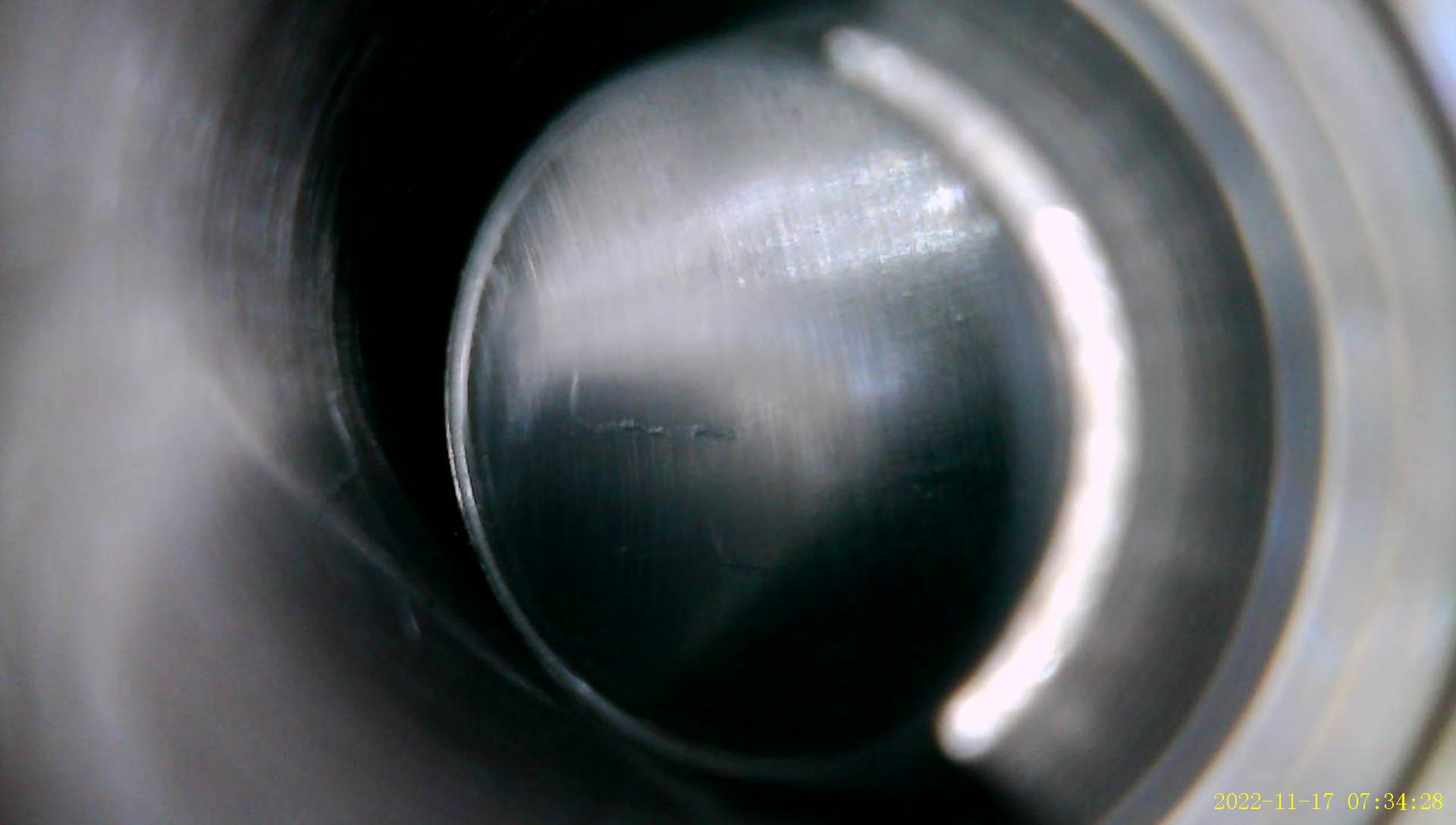

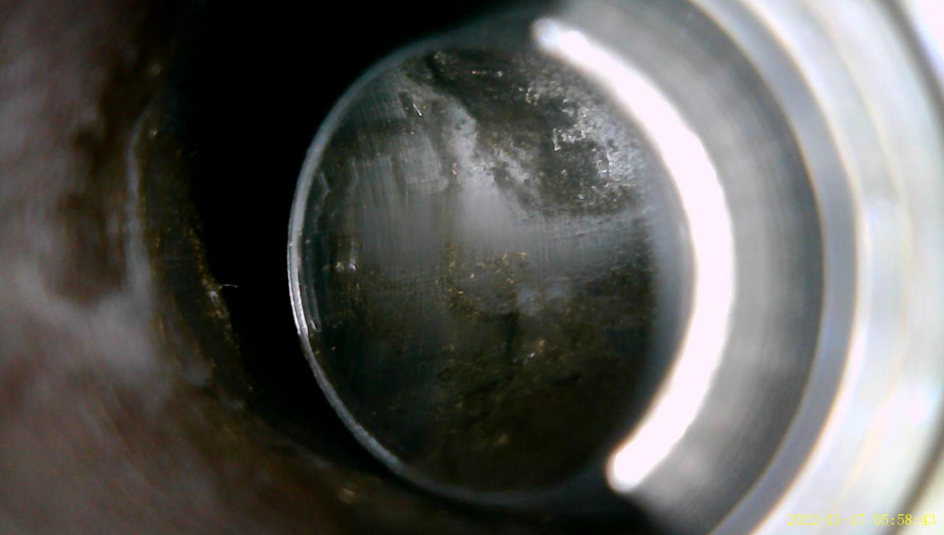

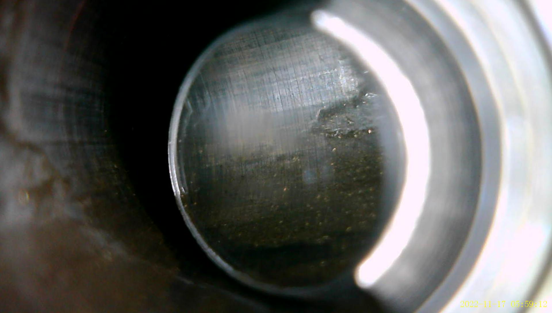

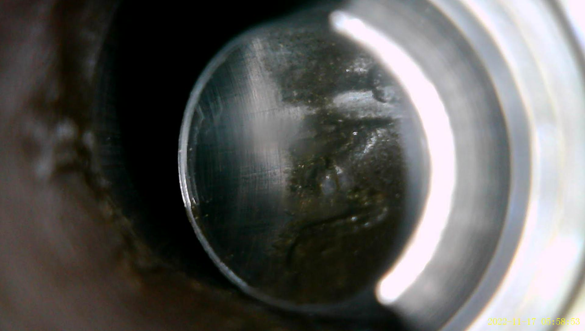

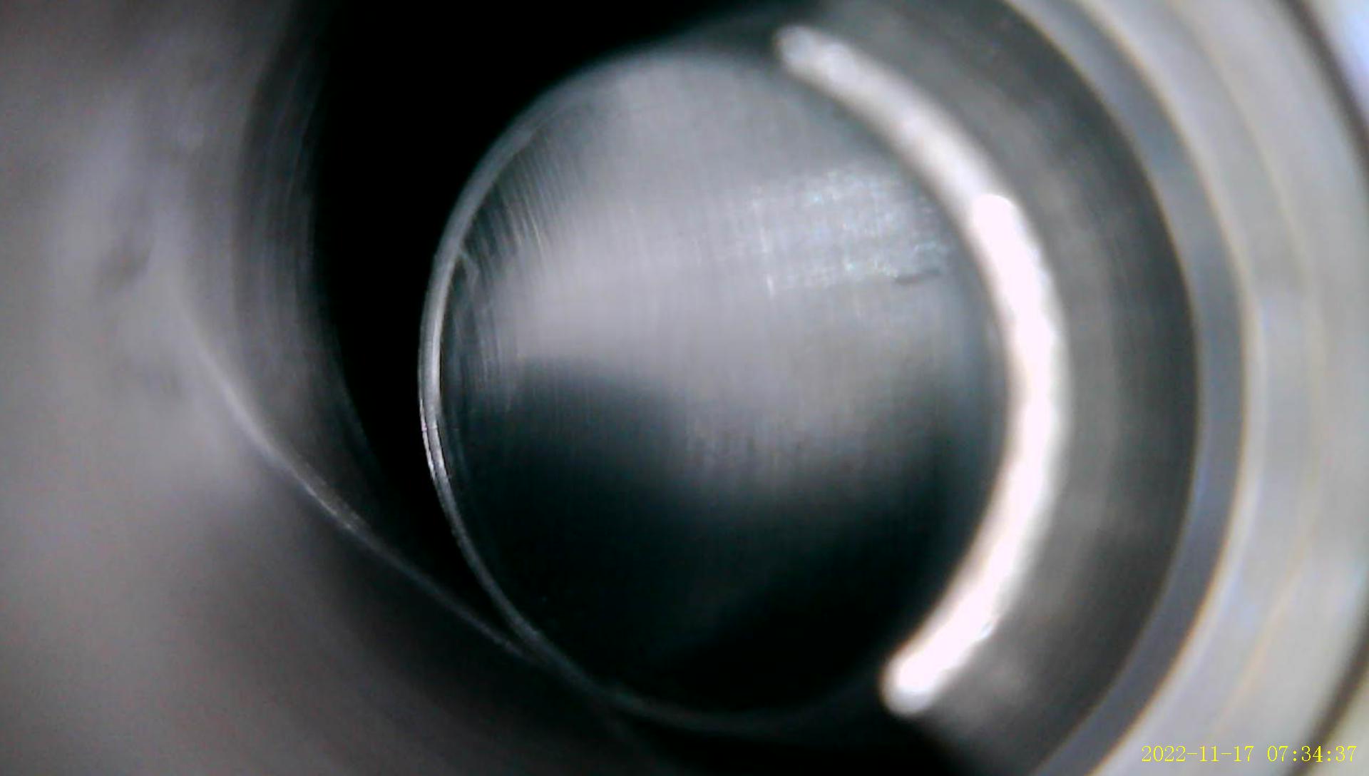

Ok, was going to start a new thread on "Neck Striations" and decided to be a good SH'er and use the search function. I not only found this thread about the very same issue I'm having, started by my very good friend @GBMaryland, I note that I even posted to it! :rolleyes: But WTF, I'm 70 and it was a year and a half ago....sigh. ;)
I too use Redding FL dies (I blame GBMaryland for getting me into this whole metallic reloading quagmire ;)) and have been reloading 6.5 CM in Hornady brass recovered from shooting factory ammo. I have never seen this on the Hornady brass thru a few reloadings on them so far. And I just looked again....nada striations. However, I have not been annealing the Hornady cases which may be a differentiating factor.
Fast forward a bit, and I now have a boat load of Laupa 6.5 CM brass, again recovered from shooting Berger factory ammo. I have a newish Bartlien 400MODBB 5R barrel and decided I'm going to prep and use this Lapua brass in it.
I did anneal this Lapua brass in an AMP (yes, @GBMaryland 's unit...since he got me into this tar pit, I feel guilt free borrowing his stuff! ;) haha)
I also decided that I wanted to control neck tension (yes, @spife7980 my friend...interference fit ;) haha) better so I also bought a 21st Century mandrel set/die. Hey, a good obsession is really just something to do with retired time on your hands. haha
So, I removed the entire decapping and expansion ball assembly and cleaned up the die with solvent. And yes, having just reread this thread, I do now understand that that is not sufficient if you pick up any brass in there.
For lube, I use Hornady One Shot Case Lube and no...its not Imperial "stroke your cases with lube" wax...but its easy to apply and I have had zero issues with cases being hard to size much less getting stuck.

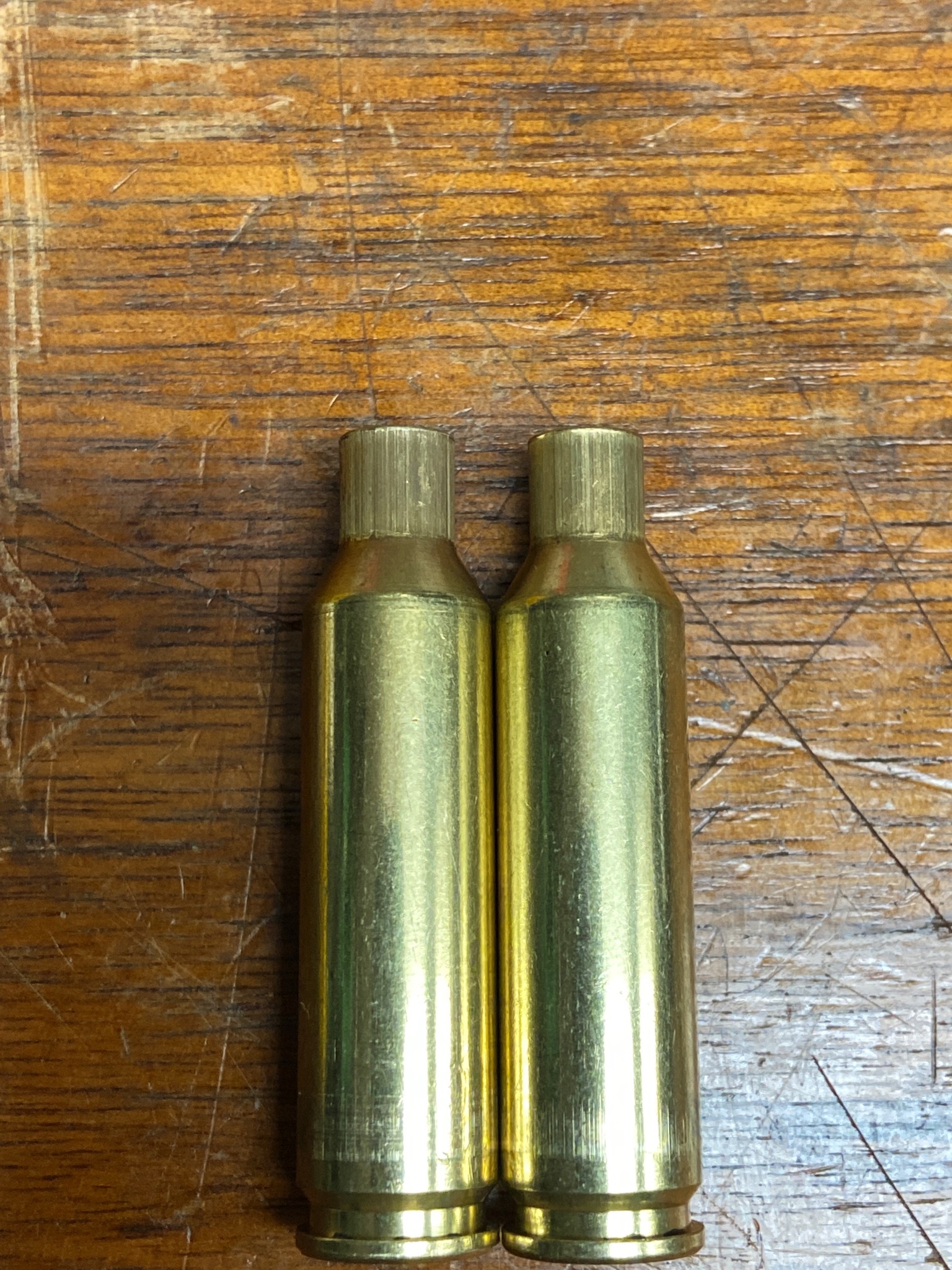

So, I resized 400 cases and never noticed the striations in the neck (cause I'm an unobservant vegetable, apparently) until I went to mandrel them back open...and saw this!!
But, I'm going with @spife7980, @308pirate and others that this will not make a tinker's damn as to how they shoot. The inside of the necks are just fine and they do chamber and extract smoothly so I'm over the panic (oh my god!!...400 case!! LOL)

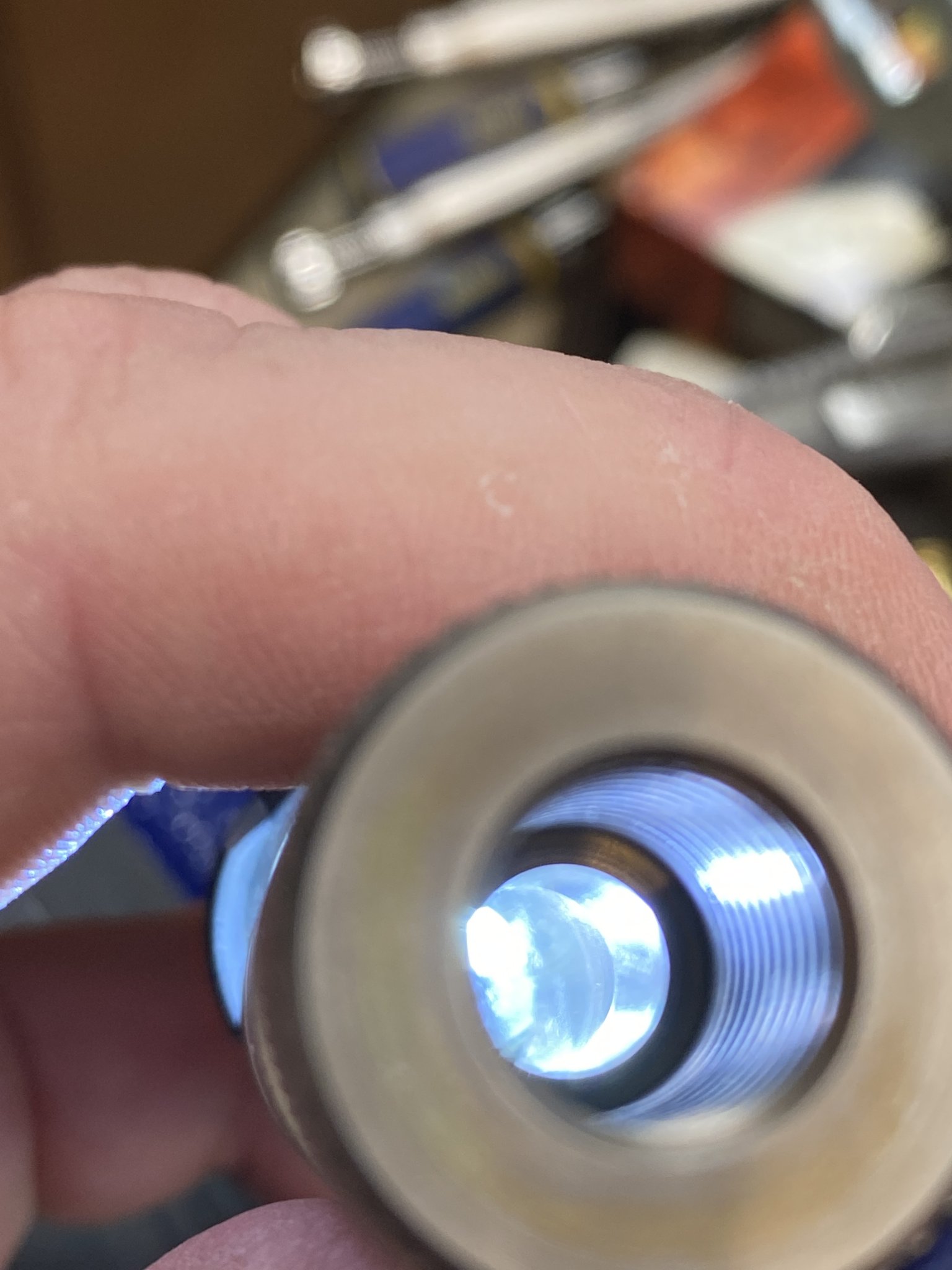

And yes, I do have a borescope so I just took a look at the inside of the neck area of the die....and I'm sort of embarrassed that I didn't notice this earlier because its not just a little bit of brass in there. Just didn't occur to me as it has NEVER happened with the Hornady stuff (thinner brass, not annealed, maybe?) And I don't believe that this accumulation just occurred from the Lapua brass as even the very first ones I sized have these striations. Or maybe it was the very first one...WTF knows.
I do have chamber brushes and mops and I was actually thinking about using Semichrome in there as I have in the garage from the past when polishing chrome on the Softail was the obsession of the day. Maybe I'll start with BoreTech Copper Remover on a mop and see how that works? Or maybe I need to get some of those 6 mm wool polishing brushes from @GBMaryland as there must be someway to blame him for all of this!;) 🤣
Why didn't I just stick with just reloading shotshell....sigh.
For those of you as bored as I am who read this drivel, thank you. And yes, I am utterly open to comments, constructive or...since this is the Hide...otherwise. :)
View attachment 8001263View attachment 8001264View attachment 8001265

Wow, I was going to wrap a patch around a nylon brush and use either 40x or Semichrome but decided to first put a bore mop with BoreTech Copper Remover and….in 15 minutes it was all gone. (note, what looks like a scratch is just a bit of thread from the patch)
Looking down the die, it appears that the neck area is very smooth but the borescope and magnified pics show roughness...I assume tooling marks when they were bored out. So, I'm still considering Semichrome on a patch/brush combo to maybe polish up a bit more. That's very fine polish and I've seen it used to polish injection molds for visual plastic products (motocross face masks, tear aways, and that sort of thing). So, I don't think I can hurt the die?
View attachment 8001342View attachment 8001346

I did just put a nylon brush, chucked in a drill, with a patch around it and a bit of Semichrome polish. I was wowed out a bit taking the pics with the borescope as the neck compression area of the die was now so shiny all I could see on the little monitor was glare. Loaded them up to a laptop and view on a larger screen and yes, the circular tool marks are still there. I absolutely expected that as all I wanted to do was polish a bit and not ream the damn thing out. I'm not sure what Redding would do if I sent it back to them but I suspect it would be similar to what I have just done.
This is my nice shiny neck area of my FL die
This pic shows the margin where the polished neck area meets the shoulder/body area to give a bit of contrast. And no, I did not put those circular tool marks in there....they are just showing up more clearly now that its polished that they did in the pics in the earlier post.

This does seem like a long thread about something so straightforward.
- It's not "striations", it's galling, meaning bits of brass sticking to the die due to a lack of lubrication. Galling is cumulative; it picks up a little more brass every time you run another case in there. The guys who just ignore it must not realize this.
- The solution is adequate lube on the necks, and making sure the die is smooth inside. Note "smooth", not necessarily polished. If you're still seeing evidence of galling, one of those two things, or both, is the issue.
- An effective way to remove the galling from the die, and smooth it out at the same time, is to wrap fine steel wool on a copper brush so that it's a tight fit in the die. Then soak the steel wool in Kroil, mount the brush to a short section of cleaning rod, and spin it in a cordless drill inside the die, moving in and out like you're trying to create a cross-hatch pattern inside. (It won't make cross hatching, but the change in angle is more effective at removing galling.) The steel wool pulls on the bits of brass, cleaning out the steel die and also burnishing minor roughness in the die at the same time. It will not scratch the die or remove any material; the die is much harder. If you want to finish it with a Flitz/Simichrome patch over the steel wool, have at it, but usually not necessary.
Lube your brass, and carry on.
Sigh….in each and every instance of someone talking about “striations” the individual has lubed their brass…and the die.
The process is indeed galling but the resulting effect is vertical striations in the neck.
I found BT Copper Remover took the brass out of the die in just a few minutes and I found that easier than trying any mechanical removal like steel wool.
Personally, I just thought to try the semichrome as the die was clean, I think a polished surface is less likely to cause galling than a rough one, and I had nothing to lose as it wouldn’t hurt the die.
