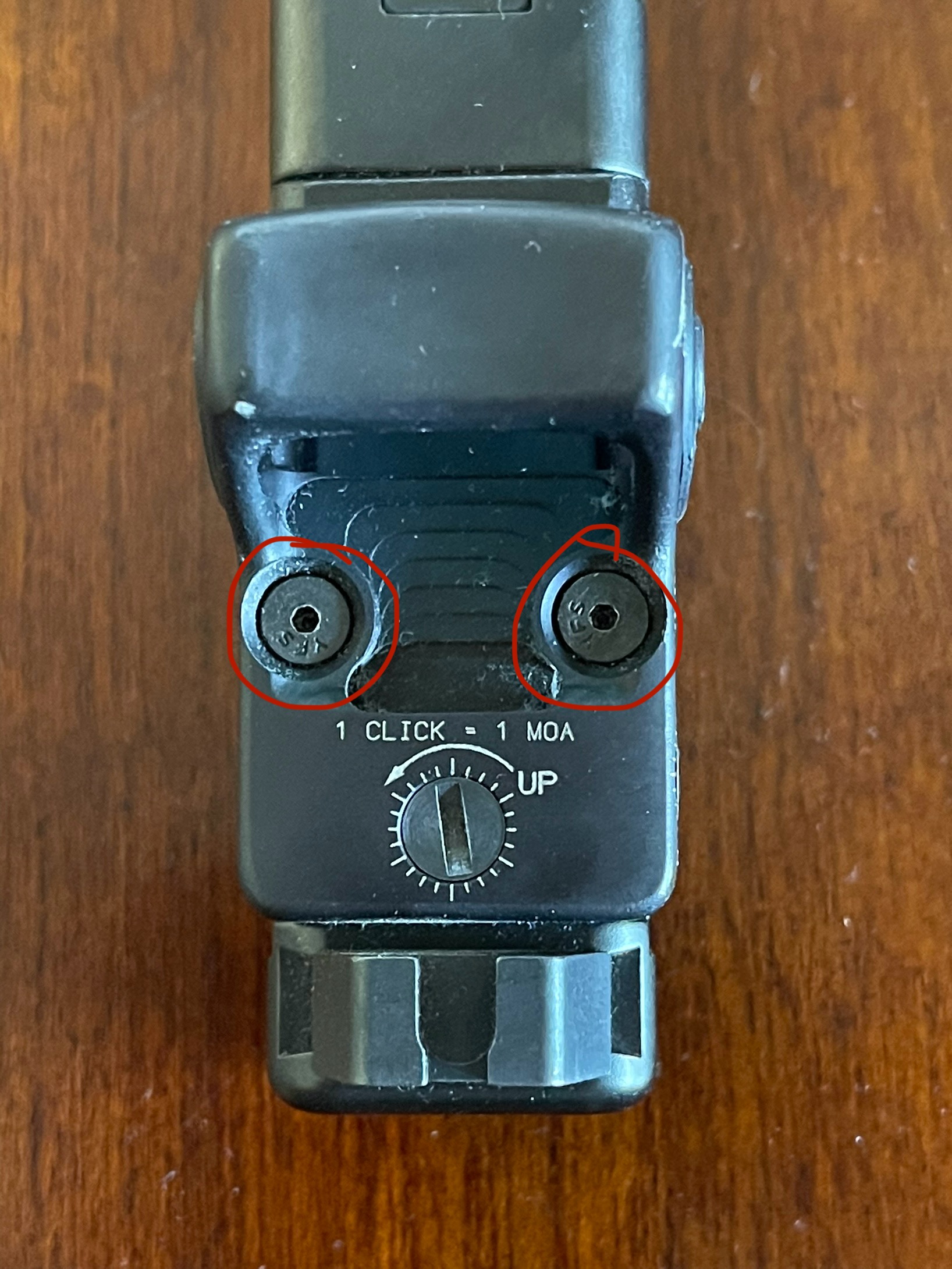

Time to change the batteries and these little screws are being stubborn. Was thinking about applying some heat with a solder iron or throwing the in deep freeze for a bit but didn’t want to damage any electronics.
Thanks in advance for any help.
Soldering iron trick usually works just don’t heat it up too much. Also try putting a bit in it and tapping it with a small hammer or punch.
If it’s on a mounting plate try the soldering iron on the side of the plate first and do one side at a time. Tap your bit with the hammer first.

They’re not stripped. Optic is on a C+H plate. Still have good bite with the Allen key, they just won’t budge. I’ll try some heat with the solder pen first. If that doesn’t work, I’ll just take it somewhere. I’d like to get some torx screws to replace these stupid Allen heads.

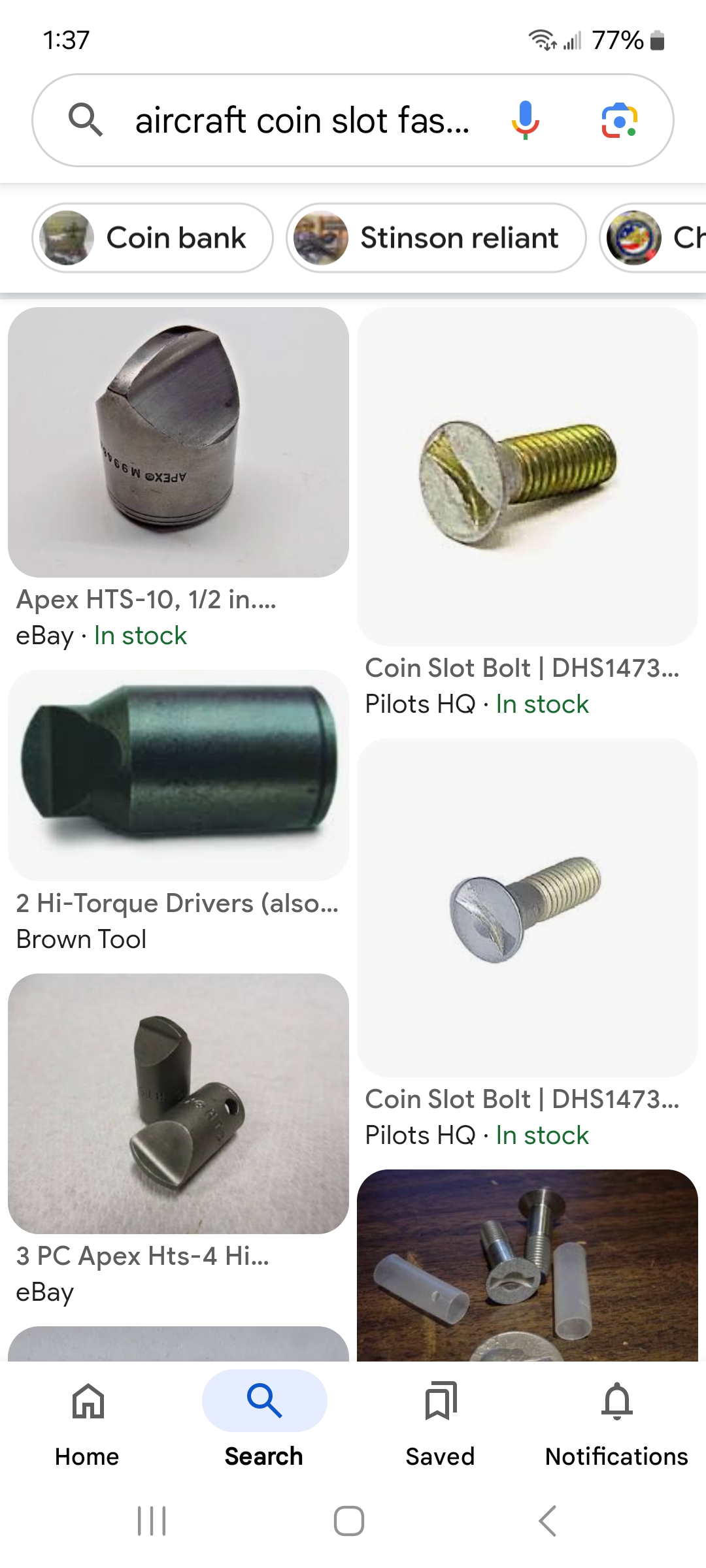

Try turning the little screws INWARD, just enough to detect movement.
Then they should spin right out.
We had to use this technique on aircraft skin/panel fasteners that were stubborn.
They usually had a bit of corrosion on them and the inward movement preserved the contact points on the fastener where the bit would grab.
If you've ever dealt with coin slot or aircraft style torx (not the same as the gun style) you'll understand why we used to turn them in first.
If you've ever dealt with coin slot or aircraft style torx (not the same as the gun style) you'll understand why we used to turn them in first.View attachment 8673523

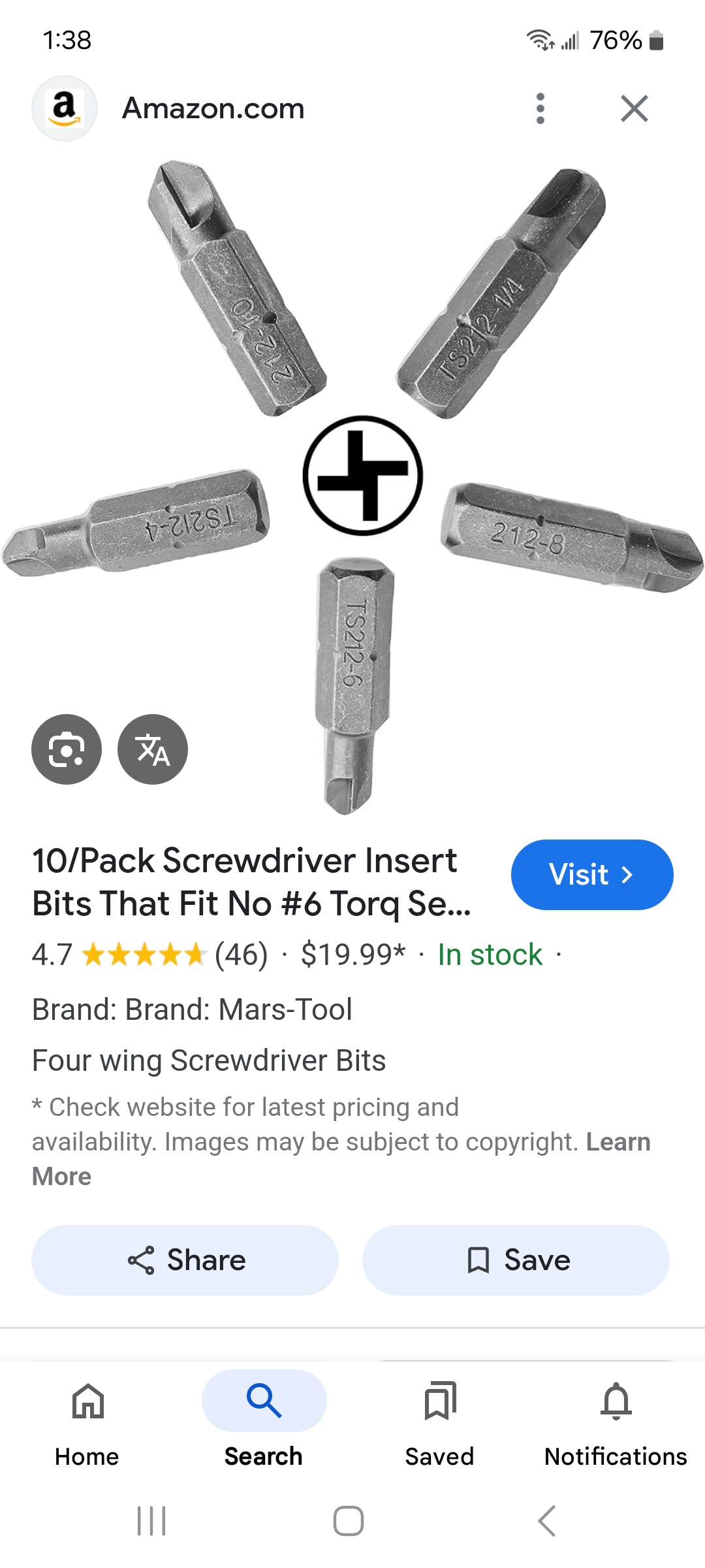

........I use the coin bit style for sight adjustments
After having used those bits to remove and install tens of thousands of screws, if I found one in my tool box, I would grind the bit completely away.
Then, I would take it to the shore line and bury it in the sand so the salt water could rust it back into nature.
That's how much I hate those things.
OBTW, using it for old style turrets is a great idea.

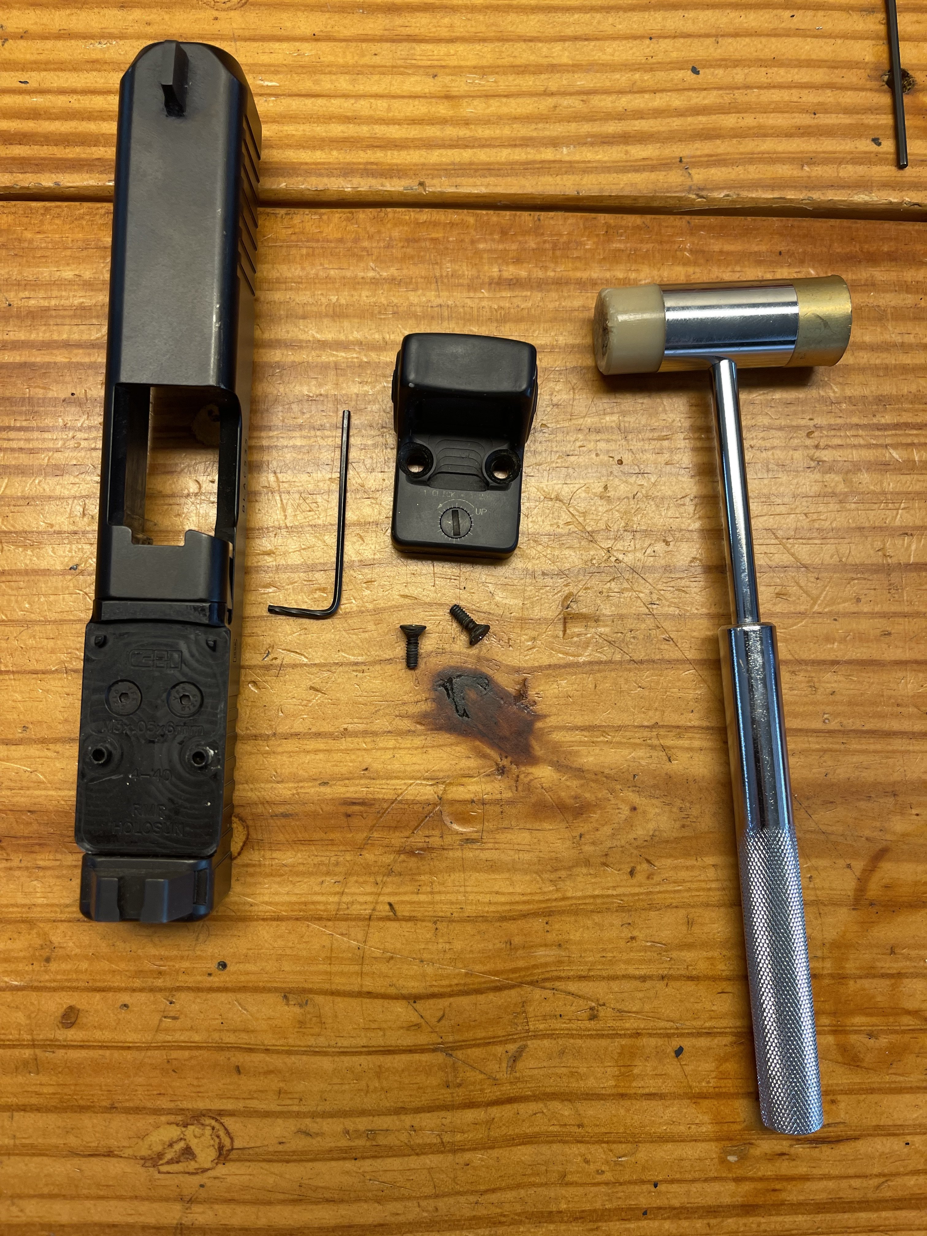

Thanks for the help guys.. 200ish light taps and some ugga dugga got these things out. You can see the twist in the Allen key. Forward controls plate will be purchased tonight. Is there such a thing as 6-40 torx or Phillips screws? This plate might get used on another pistol
Reactions: BurtG
Thanks for the help guys.. 200ish light taps and some ugga dugga got these things out. You can see the twist in the Allen key. Forward controls plate will be purchased tonight. Is there such a thing as 6-40 torx or Phillips screws? This plate might get used on another pistol View attachment 8675179
Geez man. Glad you got them out. Get a decent hex bit set, driver, and t-handle. I would have never tried that with a regular allen key.
