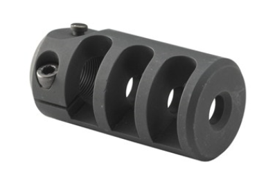

If you don't want it to ever freeze on, then you could select a split ring muzzle brake like the Cadex MX1.
There's no way it can freeze on.
I'm sure there must be others who manufacture split ring brakes like the MX1 if you prefer something smaller.
