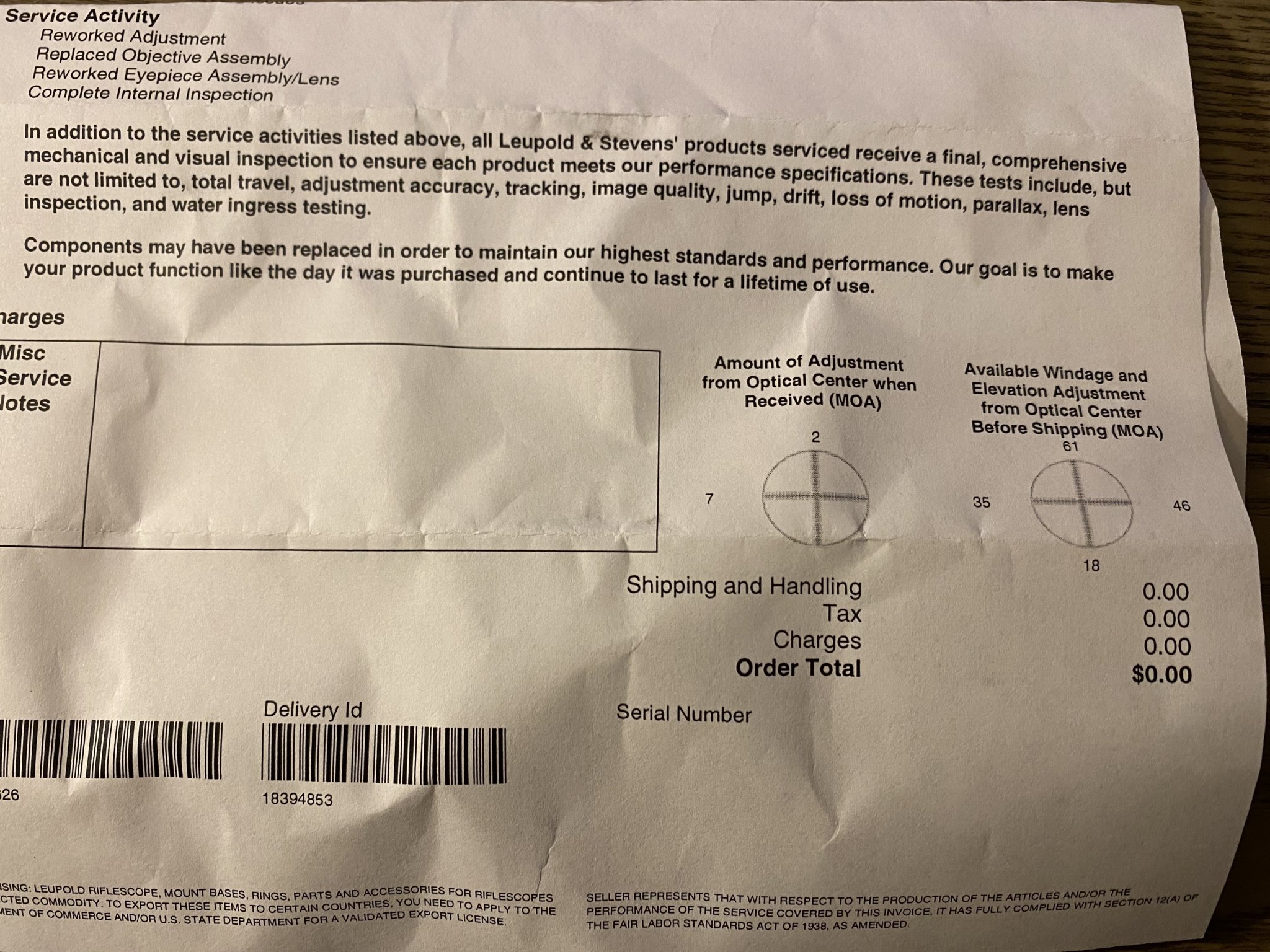

Shipped it to Leupold. Tried a totally different base (Old EGW 0moa), with different rings. Had some laughs, burned some ammo good times were had. Scope is on its way to Leupold. Its what almost 30 years old (96 model I believe), I figure, something has to be off in it. Not pissed off about it. Will post an update once Leupold gives it a going over. Thanks for the help fellas!

Sorry to bump my dead thread. Figured I would add some results. Got the scope back with a a new elevation knob. For m118LR
175 grain. They included the original knob as well. Hopefully take the rifle out next week or so and get it a try.
Looks like there was some binding in the erector assembly based on before and after numbers. I had similar issues with an older Vari-X III M3 and sent it to Leupold. Report showed before and after numbers were good. Turned out it was the rings (Smith Ent) that was the problem.
Check to see if the turrets are shimmed.
Also, it's hard to tell from the pic of it mounted, but the front mount looks awfully close to the scope tube/bell taper- perhaps move the scope forward 2-3 mils in the rings.
speaking of shims, I had to shim all of my handgun scopes on the XP-100's (rear shim) to get them on target. Once the shim was installed, never a worry.
