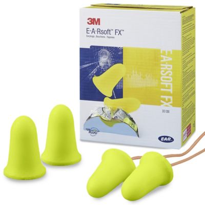

The highest rated (NRR) plugs are going to be some brands of foam. These from 3M are rated 33 db
Or these for a lot less
Amazon Mack's Ultra Soft
The absolute most...IME...you will get out of electronic or custom molded silicon plugs is about 27 db
If you really don't want to hear anything...good foam plugs are the way to go, IMO.

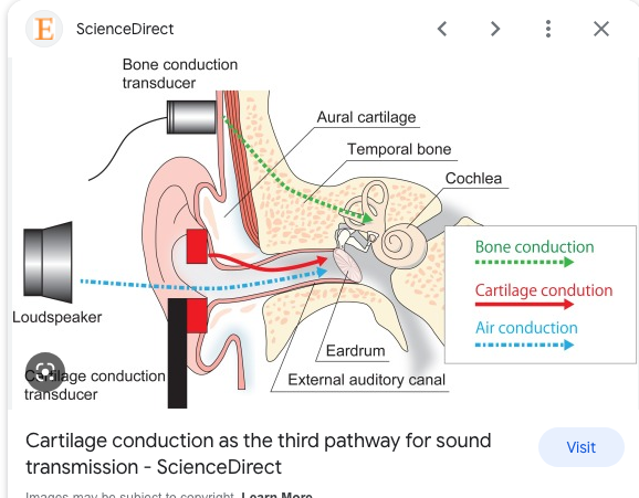

Sound smacking your skull still transfers to the ear canal without going though the ear canal.
It’s why so many recommend doubling up.
Spife has it exactly correct.
Our hearing is multi-conductive, bone thru our mastoid air-filled bone behind the ear you can feel its prominence, and thru-the-ear canal where sound energy which is transmitted via some membranes and small bones; both sound energy amplitudes impact the auditory section of your brain for interpretation. Simplistically, wearing muffs (electronic filtered or not) diminishes the bone conduction component of sound energy impact, the foam plugs or electronic filters protect the ear canal sound impact.

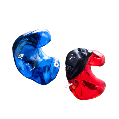

Recently I was fitted with custom ear mold Starkey Phantoms. Very expensive, retail is $1,600. But I paid about half price thru my audiologist. They come with a 30 day trial period. I'm debating returning them...
My experience has not been what I hoped. They are adequate if you are on an active outdoor range and not shooting. When shooting, pressure from the cheek rest, at least in my case, changes the shape of my ear canal and allows more sound into my right ear. I ended up removing the Phantom from my right ear and used a good foam earplug.
When shooting 9mm pistols on an outdoor range that had concrete walls on both the right and left side of the range, I had to double up and used the Phantoms with a set of electronic ear muffs. There was so much concussion bouncing off the concrete walls that the Phantoms alone were simply not enough.
I think that this will always be the case when using custom ear molds that have a rigid shell. The 3M Peltors with the Skull Screws are less expensive and probably seal better than a custom ear mold.

Custom-molded ear plugs
  • I have a pair of custom-molded solid plugs made by a guy whose work was popular with a lot of the special forces people at Fort Bragg (he retired). They are all-day comfortable and so effective that the only time I double up with muffs is on an indoor range with low ceilings. They are NOT dislodged by any cheek weld I've ever done on rifle or shotgun. Given that a favorite pastime along with the shooting sports is my ridiculously expensive stereo located in a dedicated music room, I don't cut corners on protecting my hearing.
  • An earlier post mentioned "EAR Customized Hearing Protection" with a link to find local providers. Since my "guy" has retired, if I had to find someone to make a new pair, I'd probably start there.
  • I know a few people who ordered kits online to mix the goo, stick it in the ear, and let it set up to make their own custom plugs. Every one of them said it was a futile exercise; some of them said they tried multiple kits to get it right and still failed. Fwiw.
  • I rather envy people who can use Peltor and other factory-made plugs, even the top tier ones. My ear canals are so narrow that my first visit with any doctor has always elicited a comment: "I've never seen ear canals that constricted." I've got a pair of Peltor electronic ones purchased from a guy who occasionally sells them here. I use them for rimfire events. No matter which of the selection of rubber or foam inserts I use, the seal fails in pretty short order and is never sufficient that I would use them around anything other than a .22 rifle.
BOTTOM LINE: Custom-molded ear plugs, if made properly, will NOT break seal with rifle or shotgun cheek welds, and I personally have never felt the need to use muffs atop them except on a very close-quarters indoor range.

I prefer the orange, radian brand, foam ear plugs and a suppressor.
For PRS, where shooting braked rifles under a metal roof and through concrete culverts ranges from an expectation to the norm, I add over ear protection.
I’ve never found flanged ear plugs to seal as well as foam ear plugs.
I had a pair of custom molded ear plugs made and liked them quite well, though I eventually lost them. And, I really didn’t think they were as effective as the orange foam plugs. But, they were easier to put in.
The foam plugs are cheap and effective. I can jam a handful in my pockets, leave a trail at the range like Hansel and Grettle, protect my hearing, and not be out but a couple of dollars.
