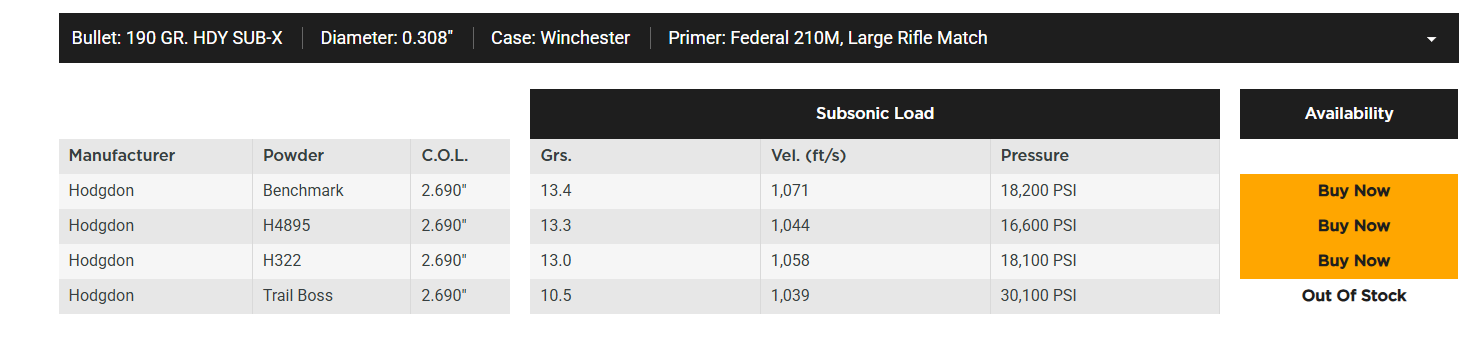

There is a section for subsonic reloading on the 308 WIN page on the Hodgdon web site.
It doesn't show all powders, just the ones under their brands, but they have several powders shown that you can still find.
I'll clip in a sample.
https://hodgdonreloading.com/rldc/

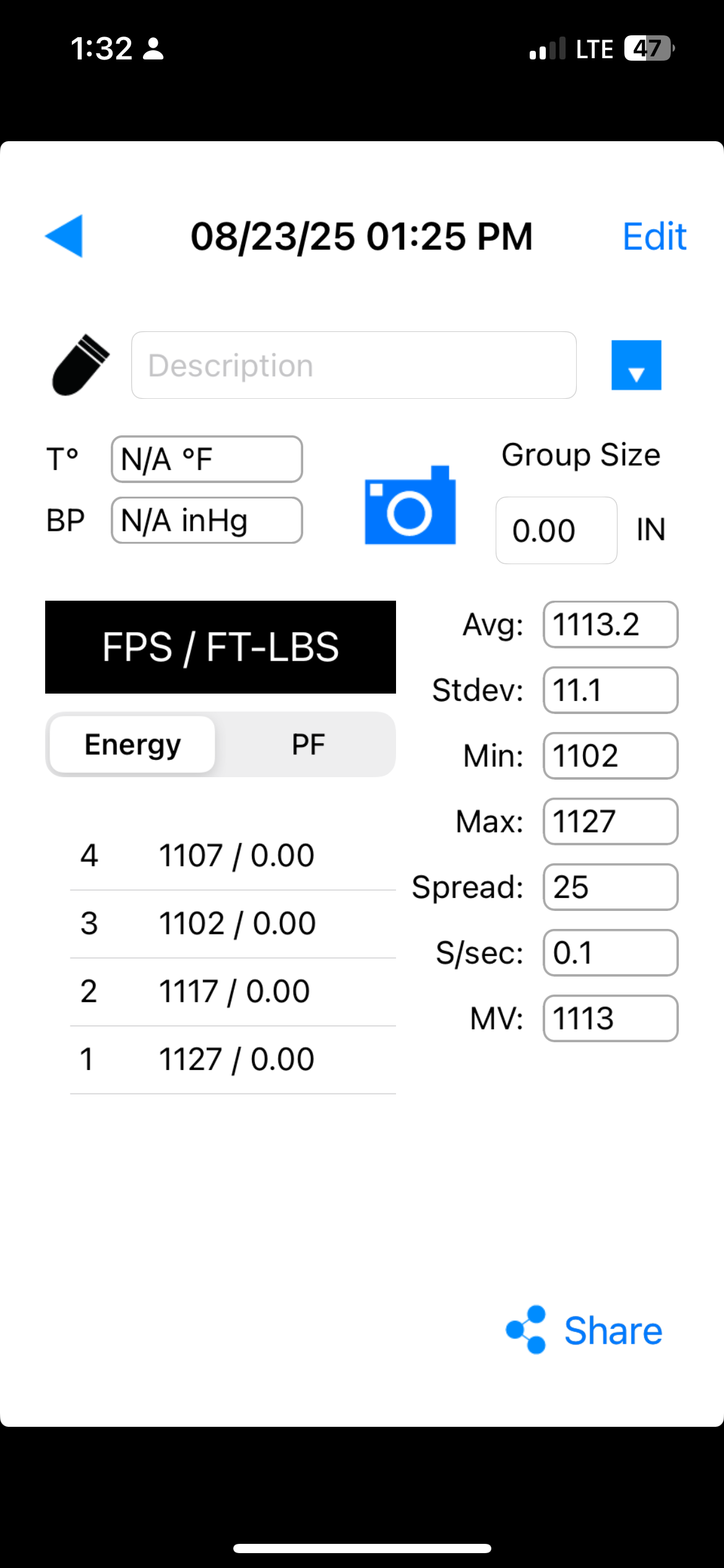

For anyone interested I loaded 9.2gr Green Dot in LC case with a 210m primer and a 190 sub X at 2.7oal
Velocity was 1120 average.
Out of a 16" 1-11 twist SS barrel.
