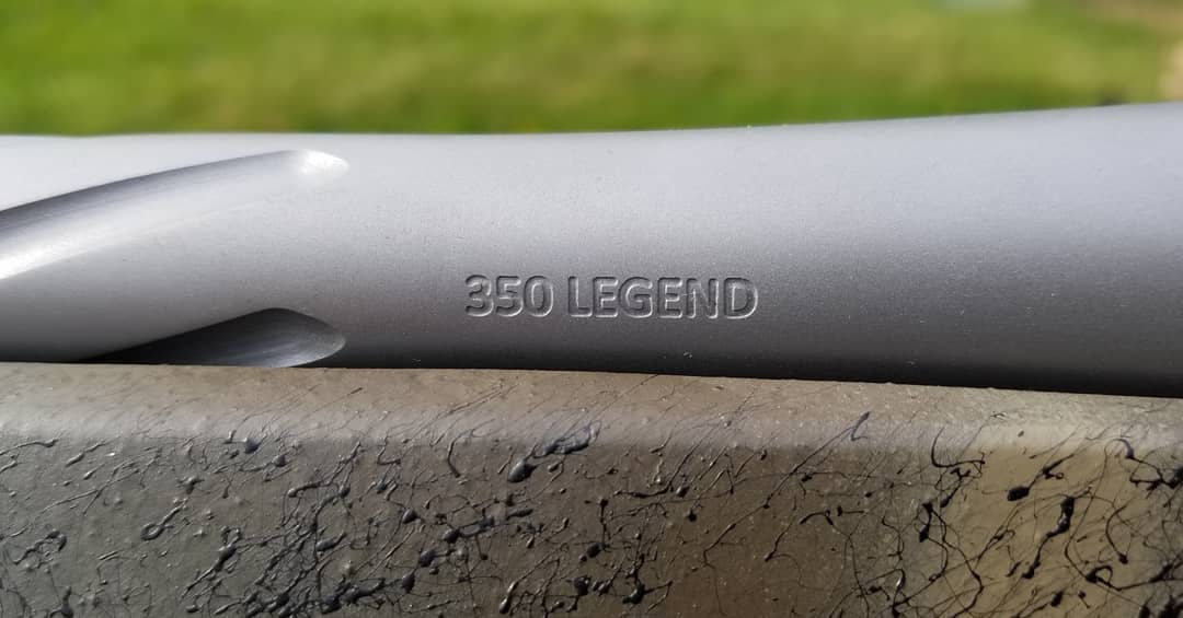

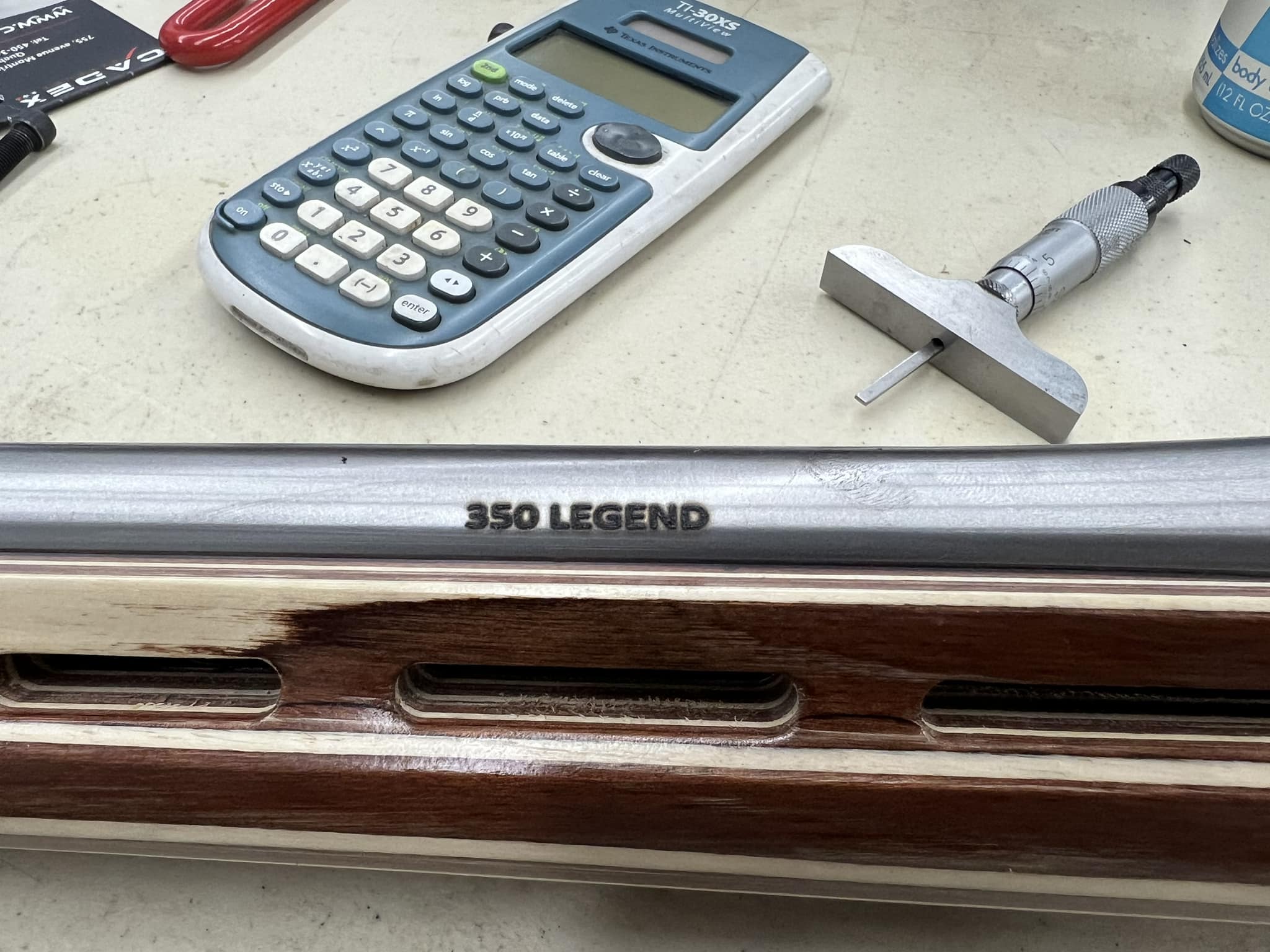

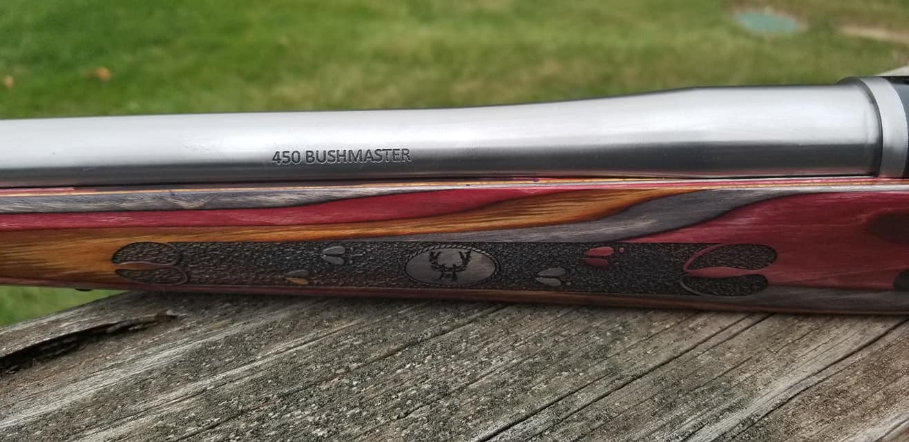

The first two are markings are made with a chemical etch by Marking Methods . That works well but takes some practice to get perfect results . The last picture is one of my first using a 50 watt laser machine for engraving . Laser it much easier to change font and get repeatable results although the investment is much higher .

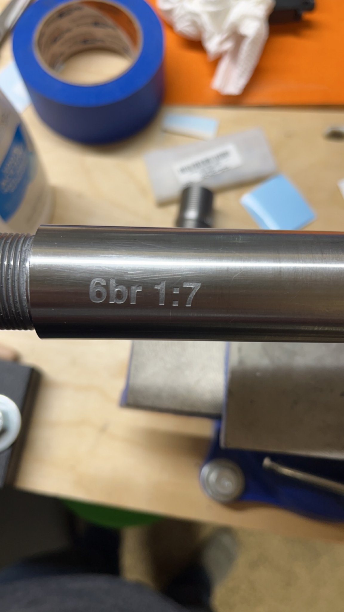

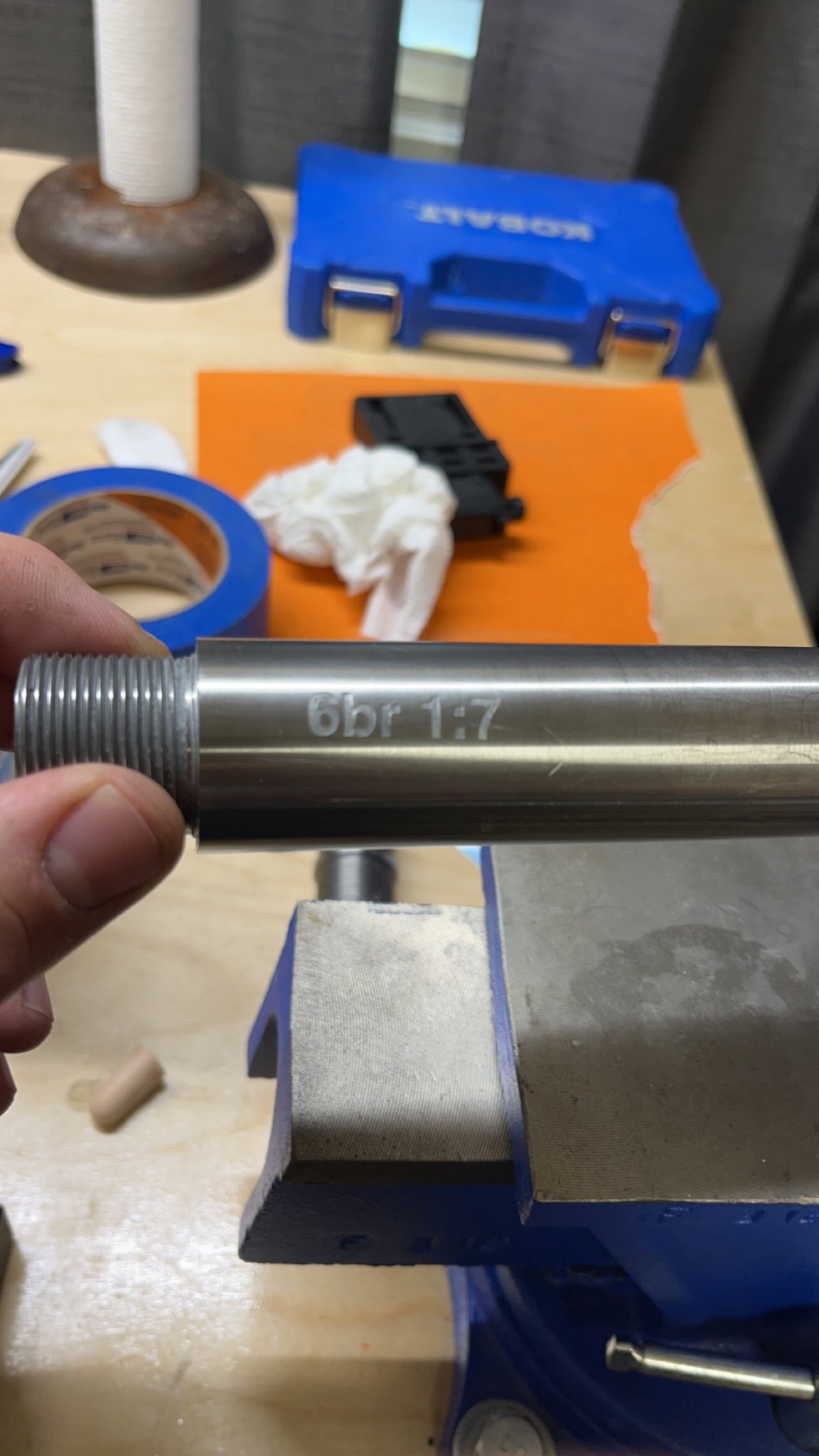

Got my first one done using the battery charger I appreciate the help and tips!
Short markings like that are hard to get straight at least for me . One way to get them straight is to screw the barrel in the action , drop it in the stock and draw a sharpie line along the forearm . When you cut your stencil make sure the letters are parallel with the bottom of the sticker so you can follow the sharpie line .

This may be a stupid question and sorry to keep bringing it up, all of our battery chargers are “smart” chargers and are giving me very inconsistent results because I have to push the start button about 100 times on a caliber marking, is there any reason I couldn’t use a 12v car battery instead of the charger?
Reactions: Threadcutter308
Should not be any reason at all. You may actually see better results. "May" being the watchword...
