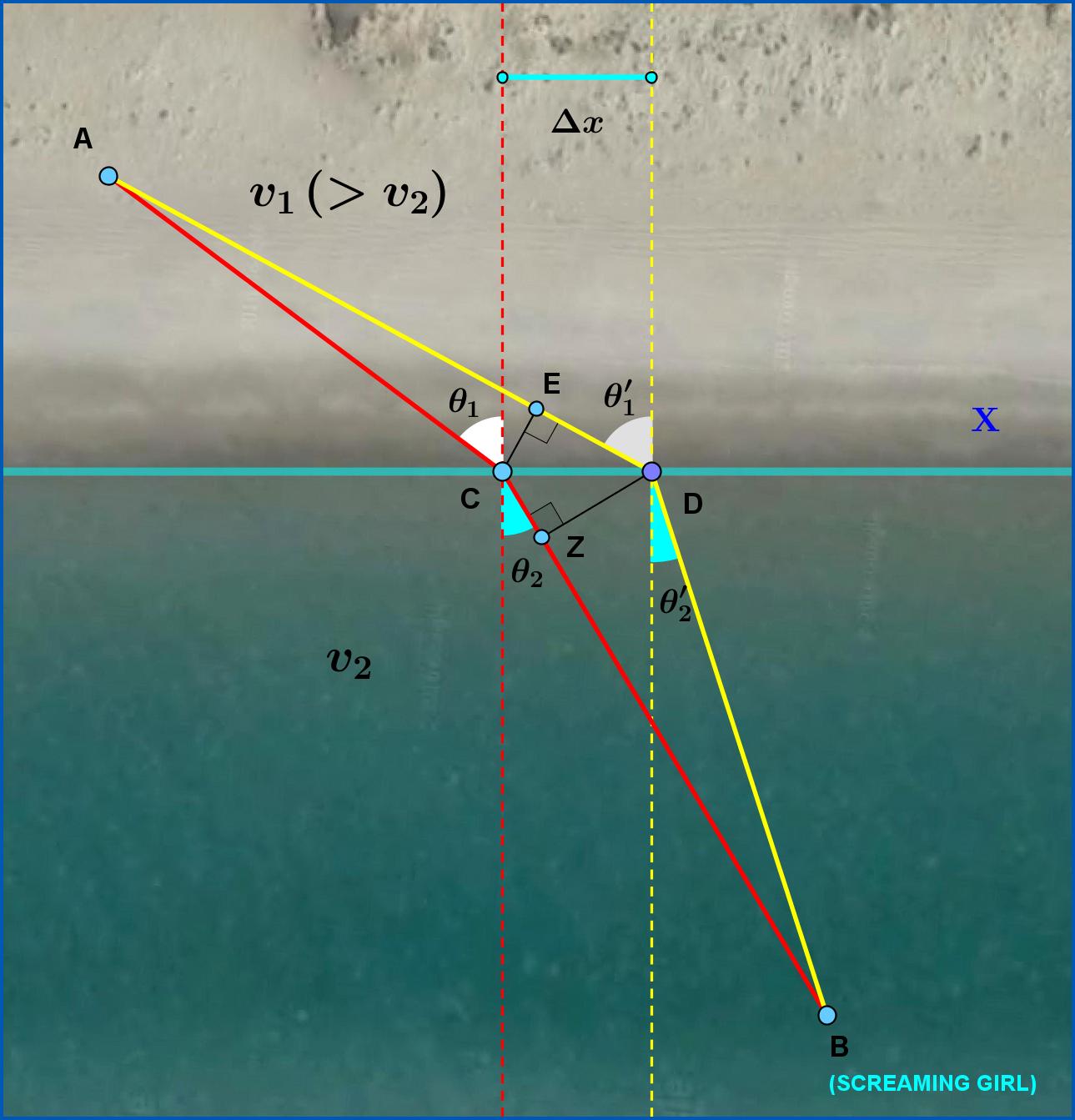

Don't know about the video, The effect is present even with parallax dialed out.
I just watched the video and read all the above discussion about sunny vs overcast. The video does not seem to demonstrate a change of sight picture with sudden light changes from clouds moving in front of the sun. There are several frames of the video that show overcast conditions and the sight picture did not change drastically. It does appear to be something like a scope heating up gradually and shifting internals.
Snells Law ...
