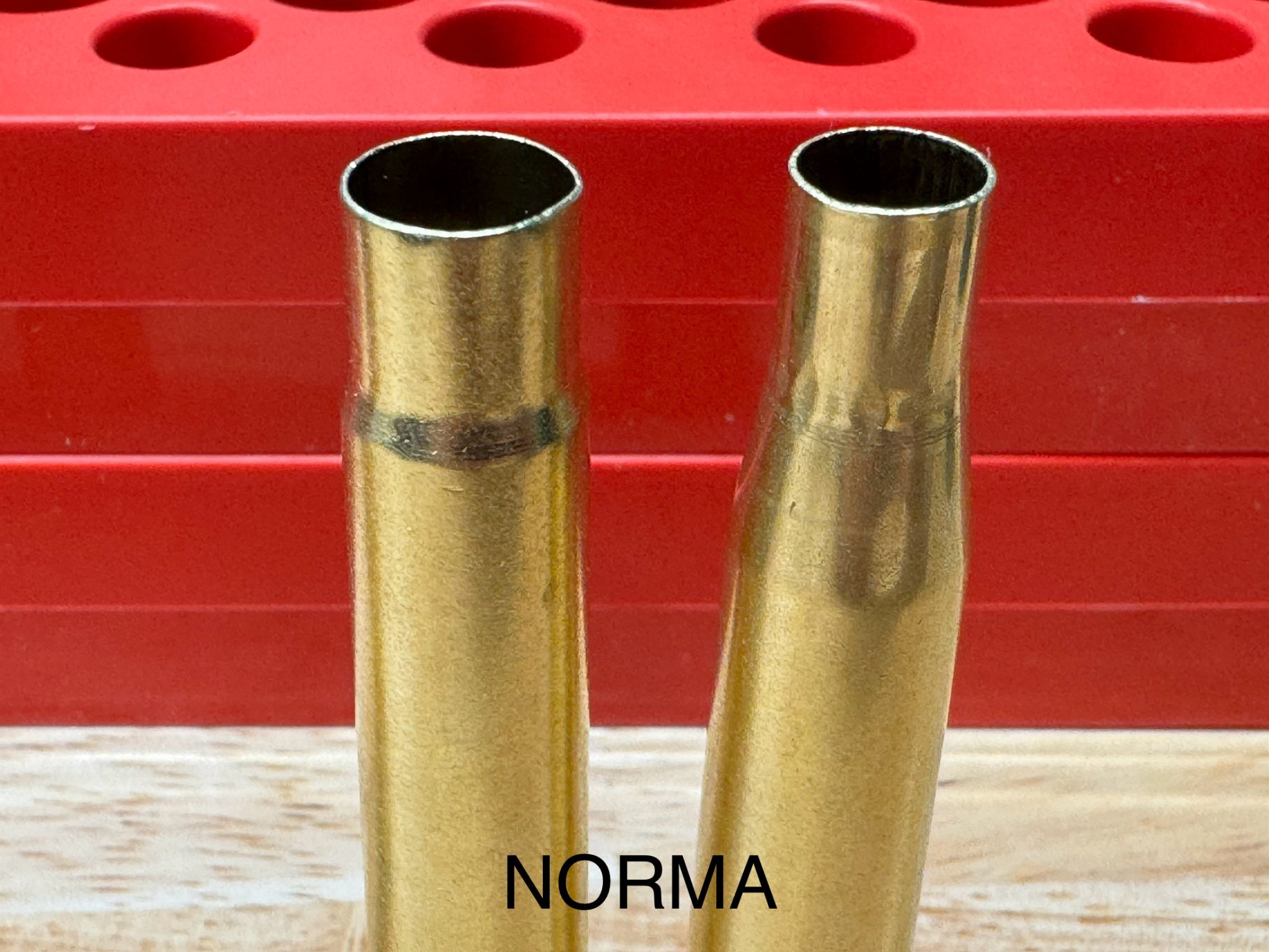

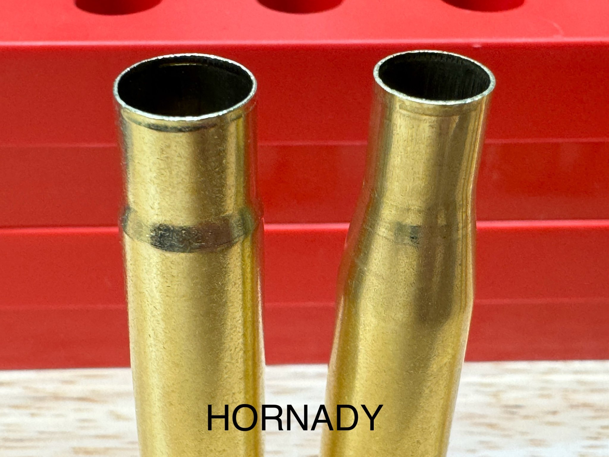

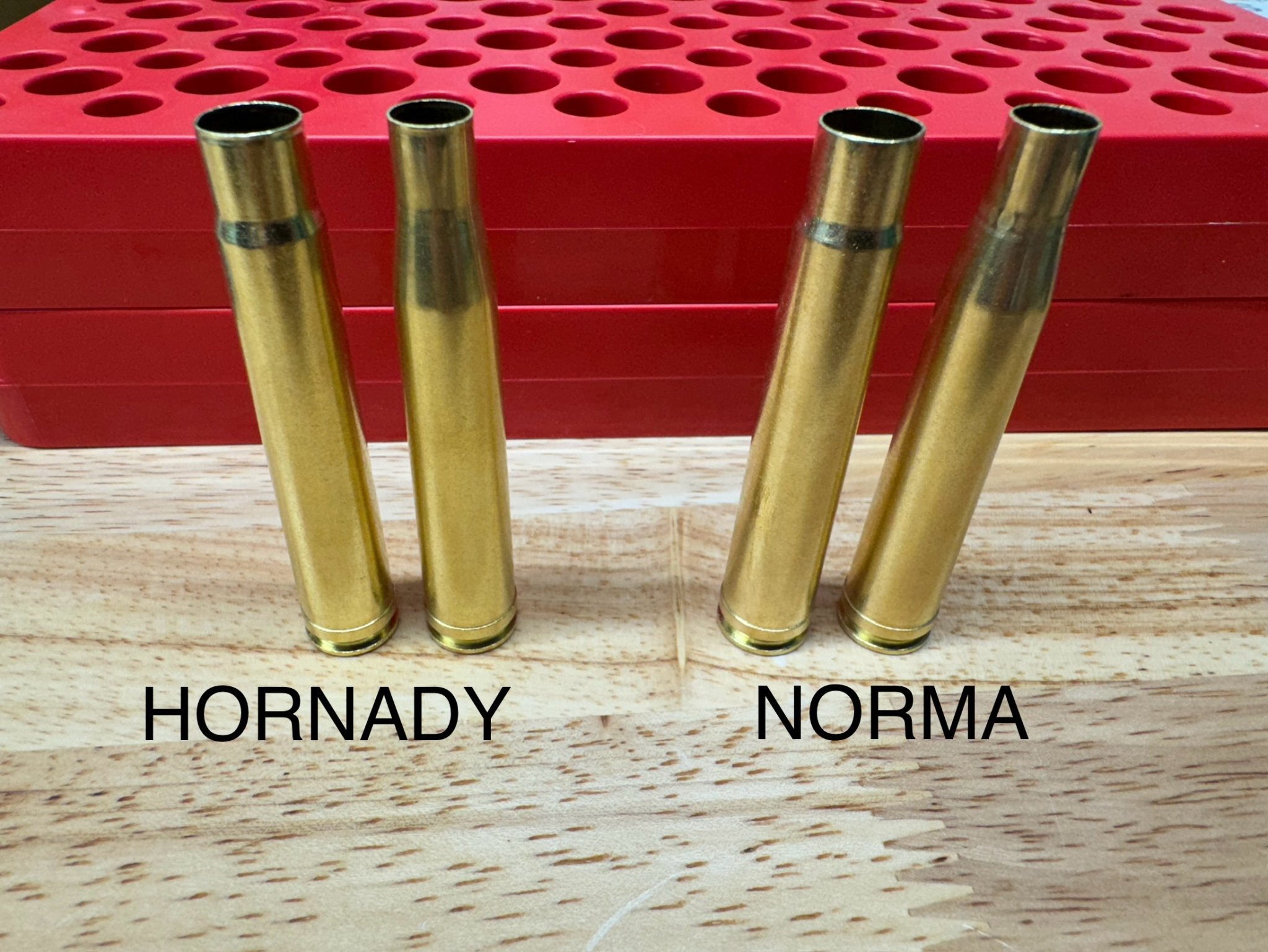

Just cleaned my .300 H&H dies, and began a test reforming of once-fired .375 H&H brass to .300 H&H in this new Redding Form & Trim die (followed by a pass through the FL die).
Wondering if I’m using too much case lube, as I appear to have small hydraulic dents in my Norma test case, though strangely not in the Hornady case (same lube, same quantity; no lube on case neck/shoulder).
The neck wall thickness does not appear to be meaningfully affected on first reforming, but I will need to keep an eye on it. I don’t have an annealing setup yet, so this multi-stage process is what I can do…for now.
Yeah too much lube, those dents will shoot out. I find new Norma brass to be a bit soft, probably why they dented and not the hornady. Had a buddy that loved the 300 h&h in pre64 70’s, good luck with the project.

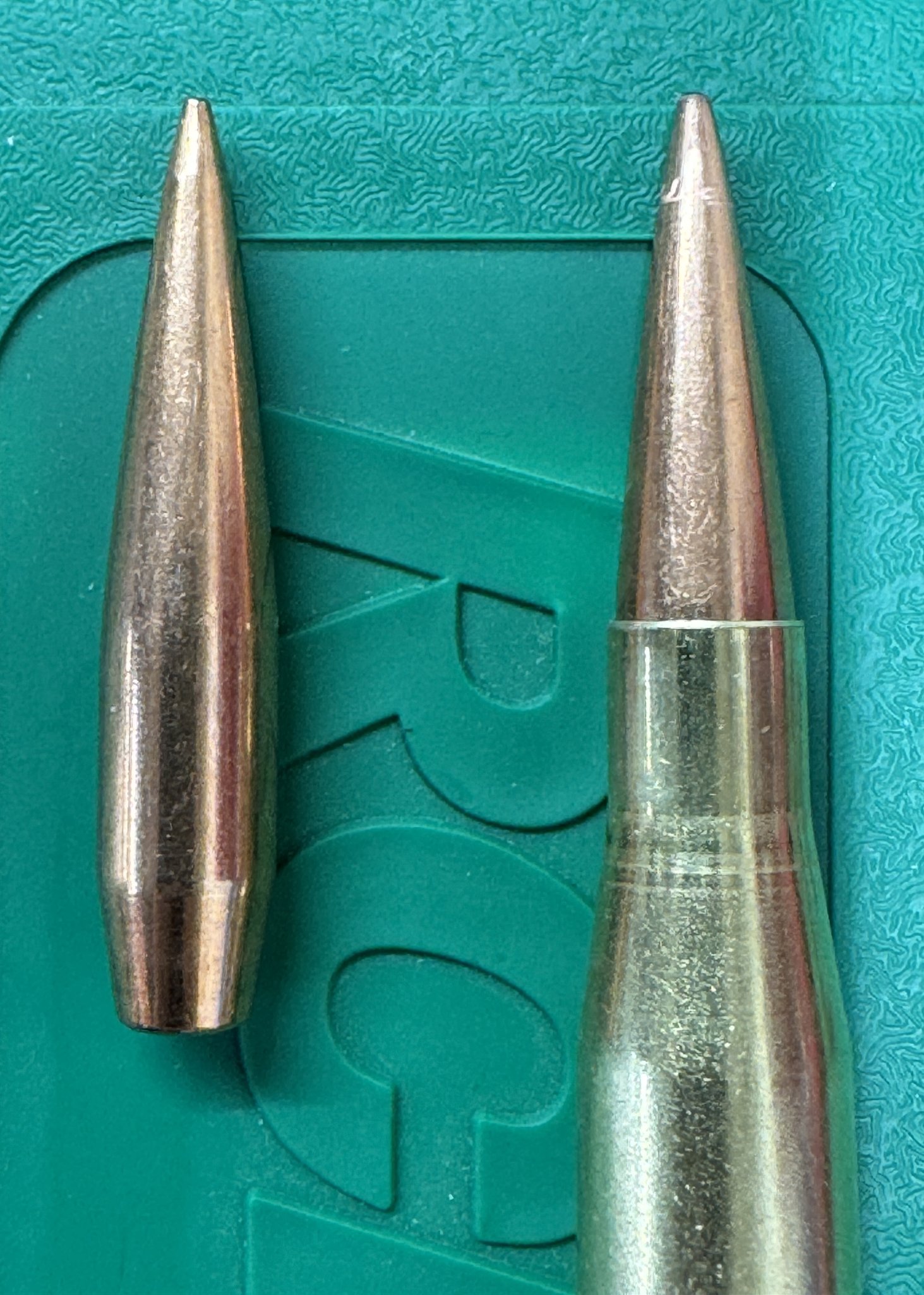

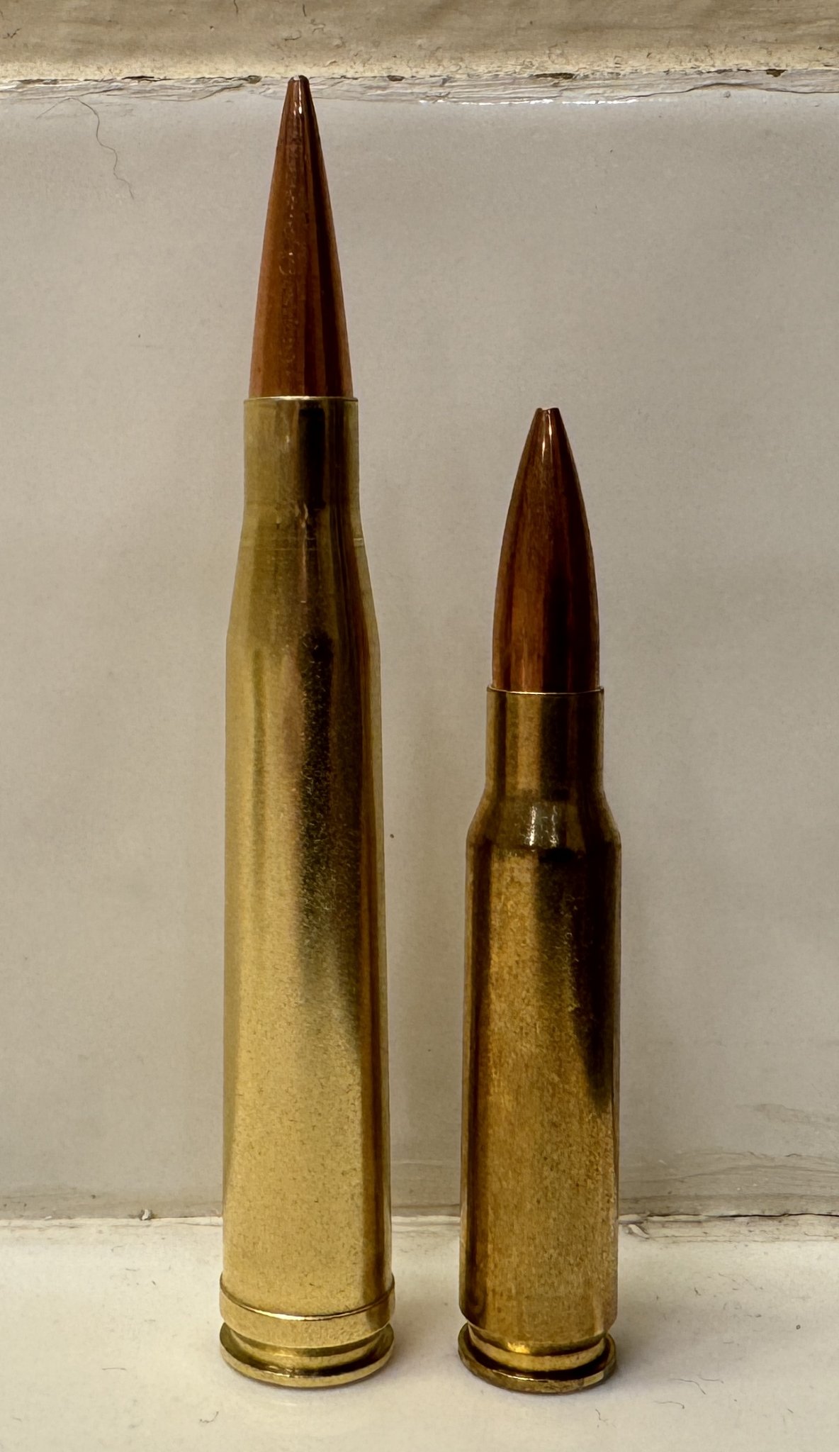

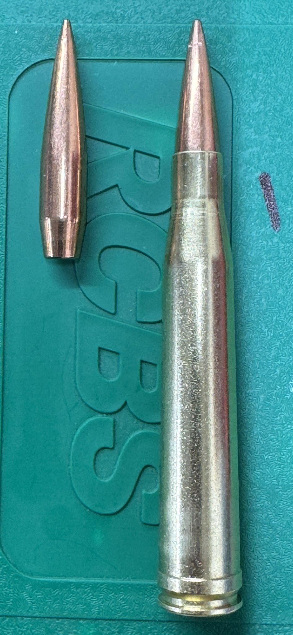

Yeah, I don’t know about this particular projectile (Sierra #2231) in the .300 H&H Magnum case. Trimmed & squared a Hornady dummy case and seated a bullet shallow at 3.740” COAL (SAAMI COAL for .300 H&H is 3.60”), and it looks really deep to my eye...though I'm no ballistician. Also, IIRC, the pre-'64 M70 action can’t eject an unfired round over 3.7”.
I also suspect I’d have to switch to a Hornady seating die with the 230/250gr A-Tip seating stem. This RCBS die is leaving a faintly tactile ring around the nose of the bullet. Not good. Regardless, I'll be using my Hornady Lock-N-Load OAL gauge when I actually start loading for the project rifle, to take out the guesswork and deal in actual measurements.
(Last photo is the dummy round next to a factory-loaded Federal .308 175gr SMK, just for a fun comparison.)

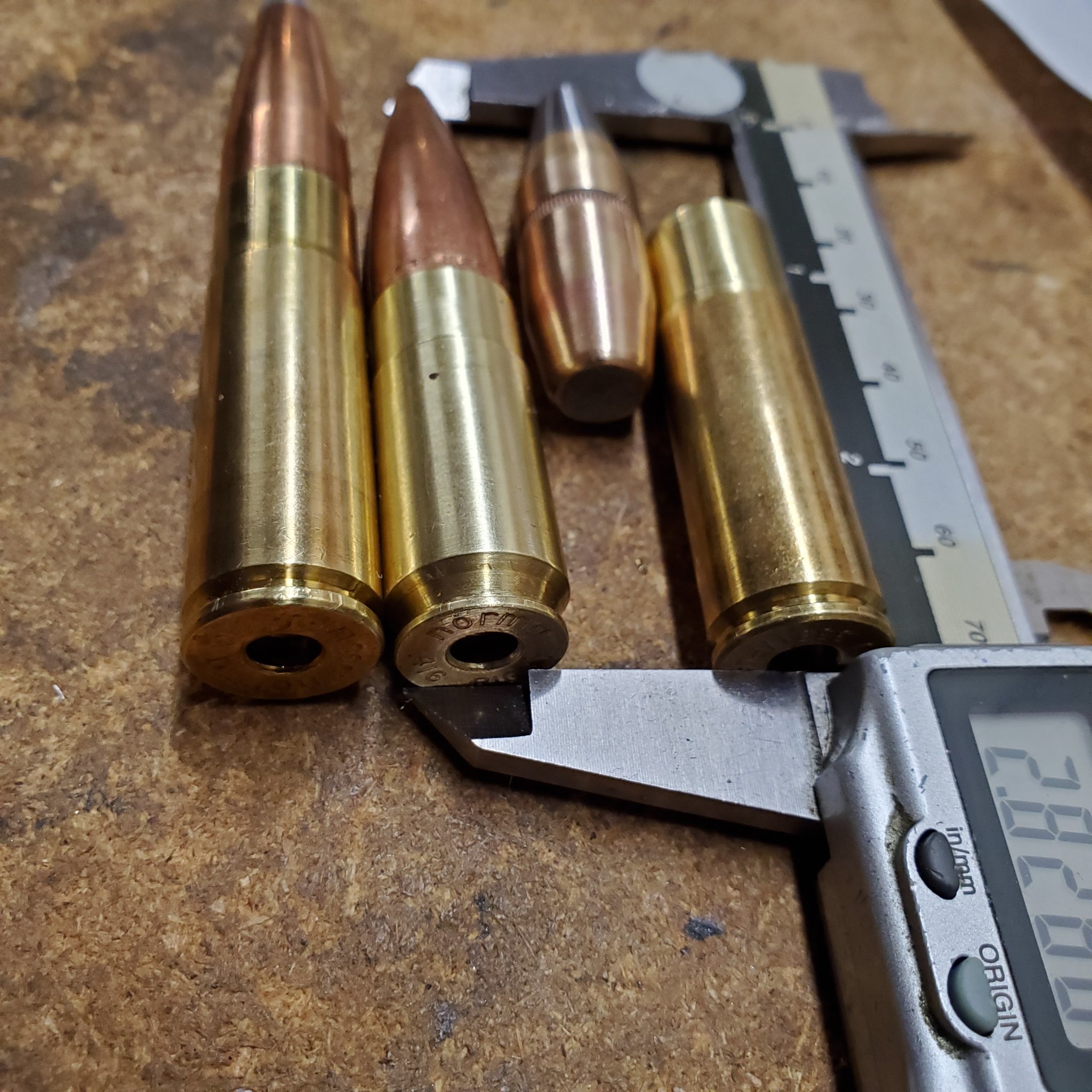

But you're forming a few cases...with no rifle.

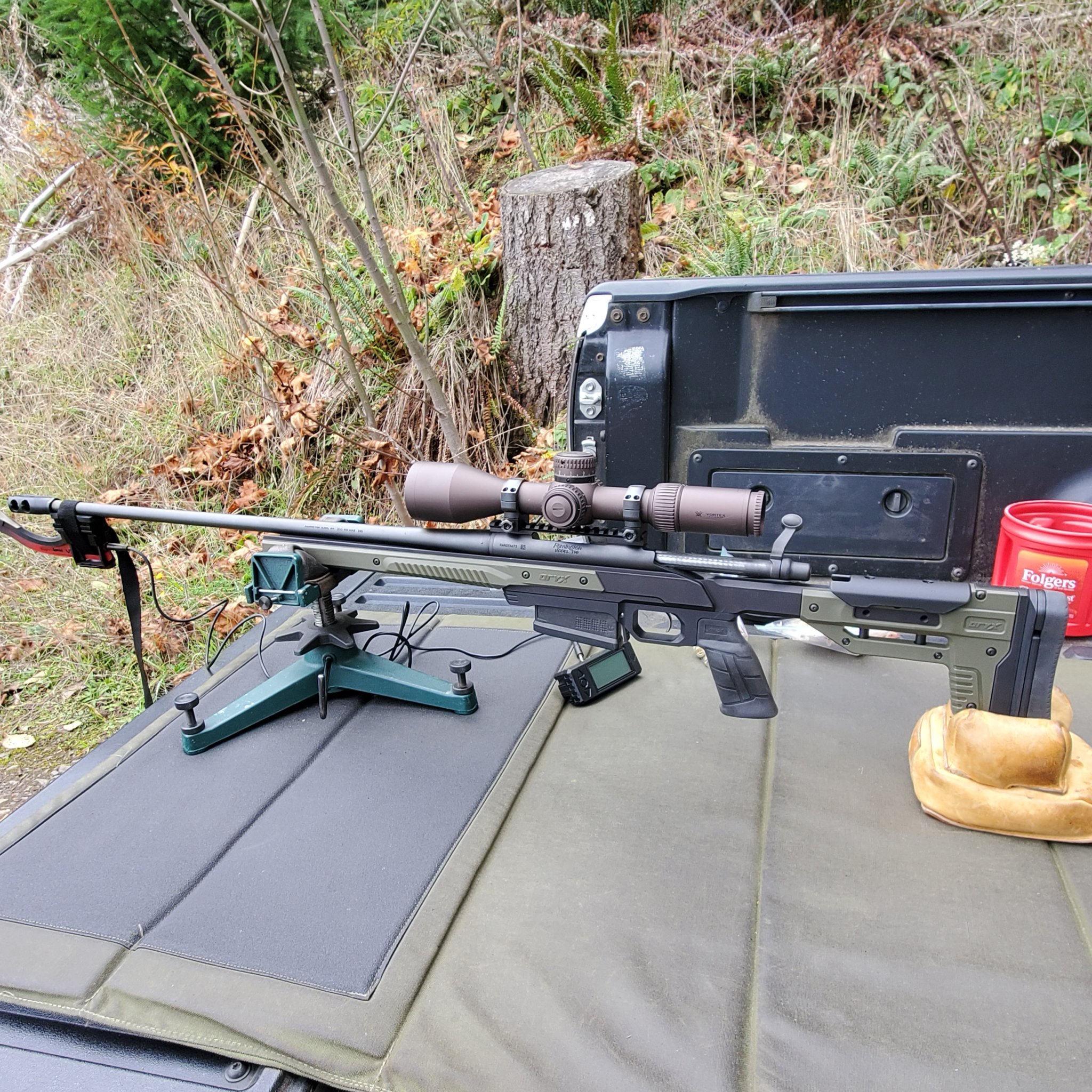

200 gr SMK I run them in 9 and 8 twist ...but purchased a $540 factory ADL in 300 Win Mag 10 twist for the action, just for the action and decided to shoot it first... it stablized them with .5" 5 shot groups at one hundred...but I'd still go for the 9 twist...my 8 twist likes them.
I took the new stock off and put the barreled action in a chassis, to feed 3.715" from MDT mag.
So the 30 Super can be made and 4.0" cartridges can feed out of the mag of a modified Rem action so it's probably possible with a Winchester action, but I never owned one, pre64 or post 64.
Brass can be made out of any belted .532" case, that is long enough.
The 375 H&H, 8 mm Rem mag, are long enough.
The 300 Weatherby is only .025" short but will grow close to long enough after forming, and easy to get, but probably a bit less capacity when compared to the orginial.
It headspaces of the belt so dents in the shoulder will be fireformed out...a benefit of the belted magnum.

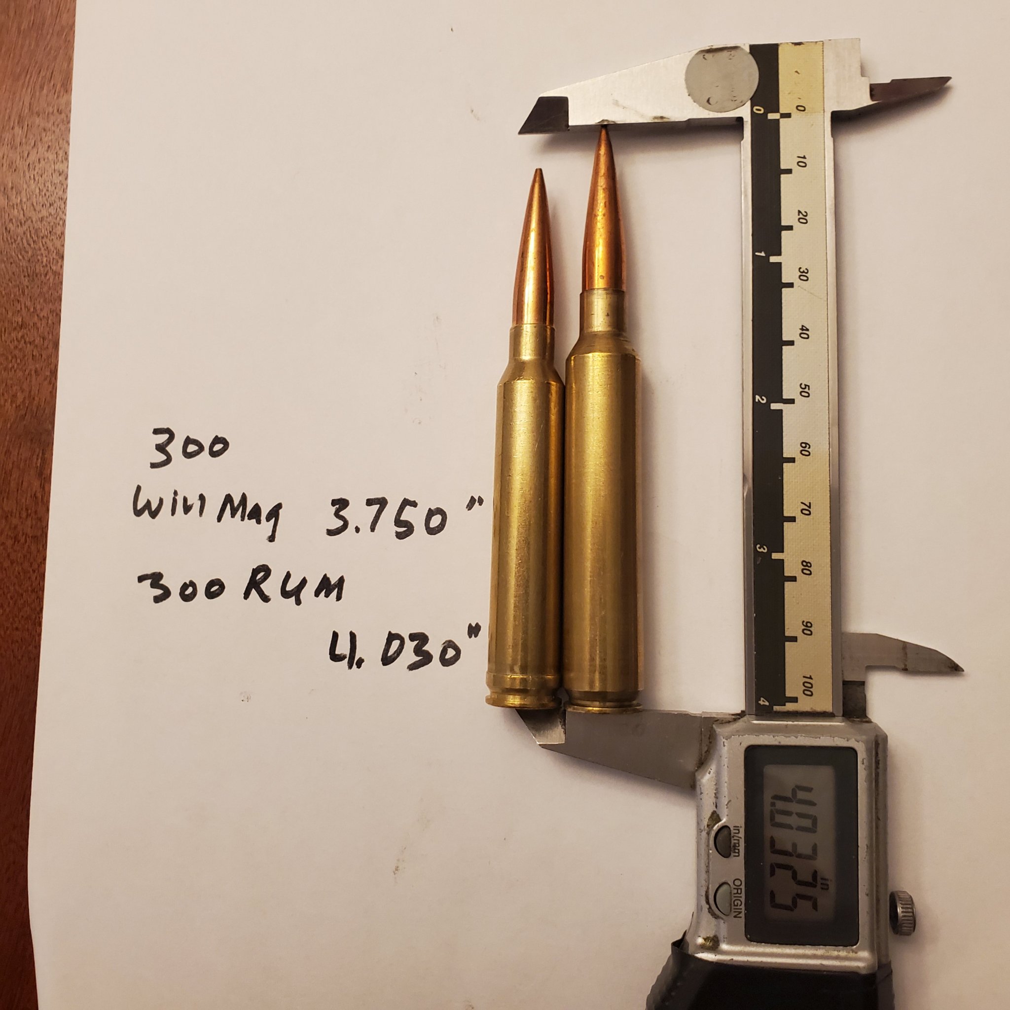

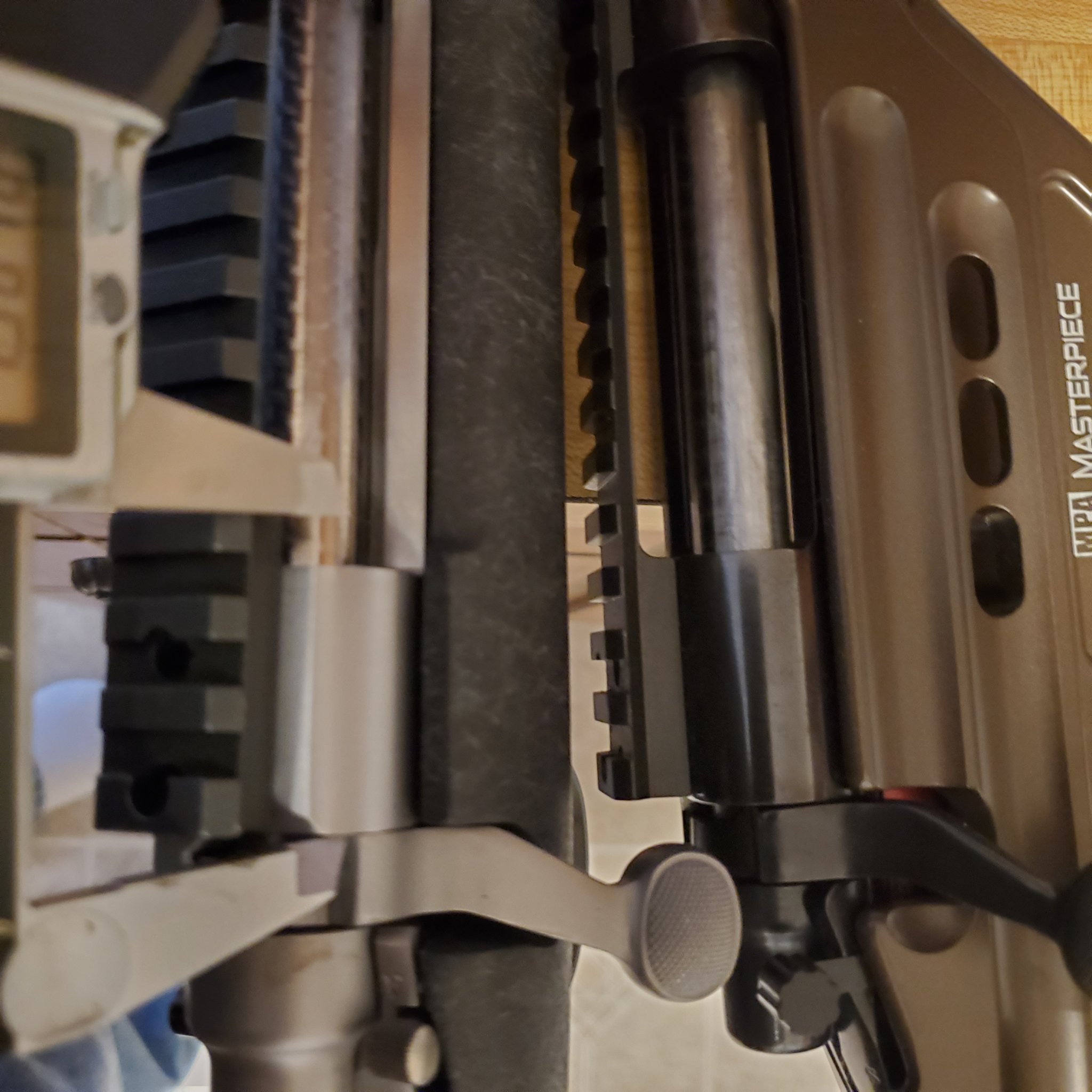

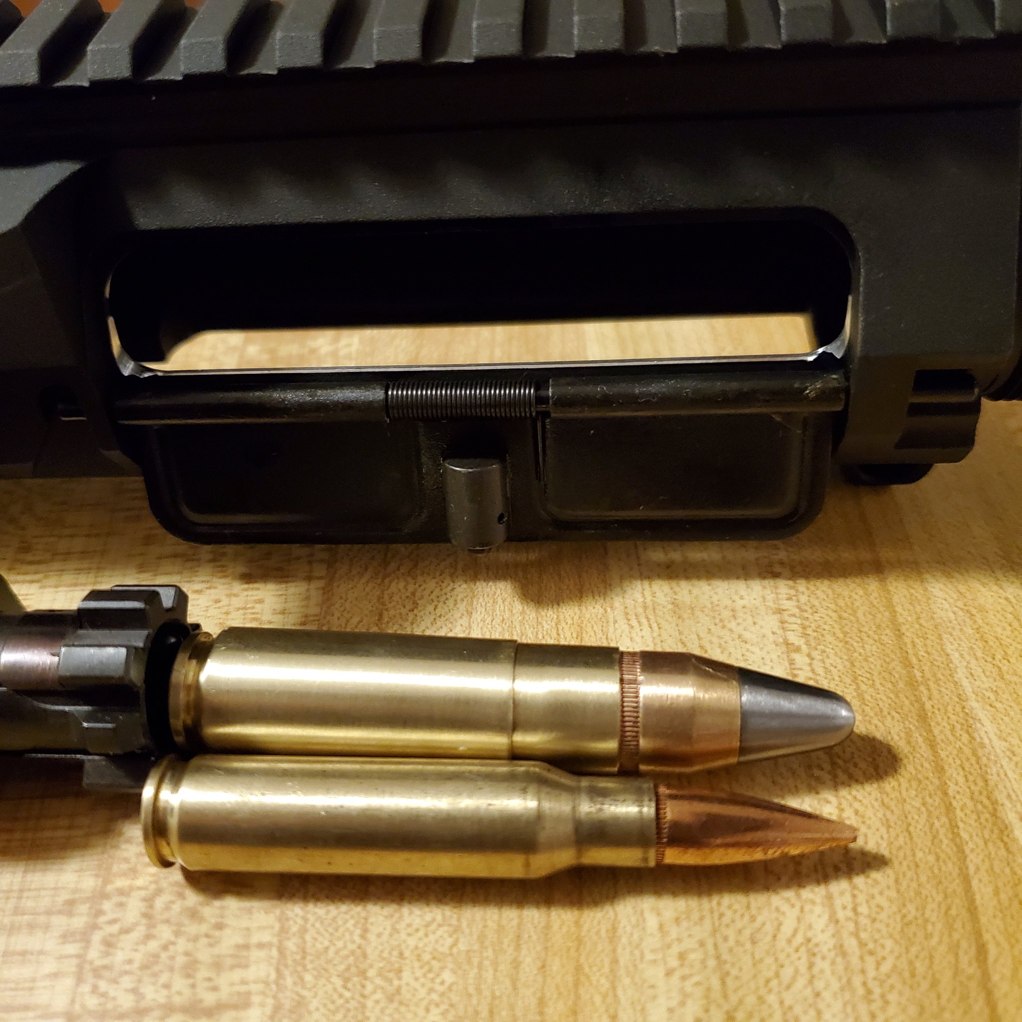

Want 4.00" cartridges to feed out of the mag?...Picture rear bridge milled this much plus a bit of milling to fit the box...not for the average guy.
These are 300 Win Mag and 300 RUM over length cartridges the will feed out of mags.

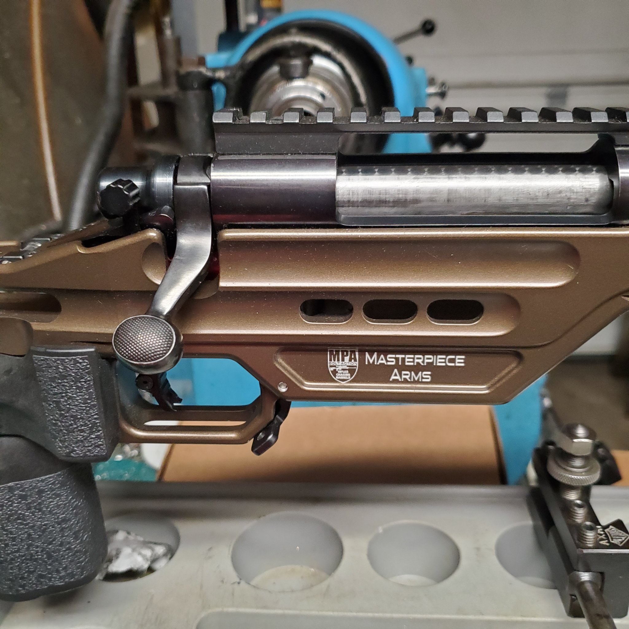

I'm kinda guru of obsolete, weird, off the wall...and what if?
Is 5000 fps in a commercial case possible?
Like a .510 cal AR 10....everything has to be made to fit. Brass and bullets machined, rebated rims, extractor groove recut in shortehed 338 Lapua cases.
How about a 30 RAR? No brass, no ARs chamber for it...so let's build one from scratch, profiling the barrel, turn gas journal, thread for barrel extension, and brake, chamber, and add gas port.
Too much fun...
Though about the .351WSL and .401 W self loading in the AR platform from the last century...1907 & 1910, got the dies...but Winchester came out with the 350 Legend, and later 400 Legend. Which is about the same cartridges they produced over 100 yrs ago.
The 351 WSL was one of many that killed Bonnie & Clyde

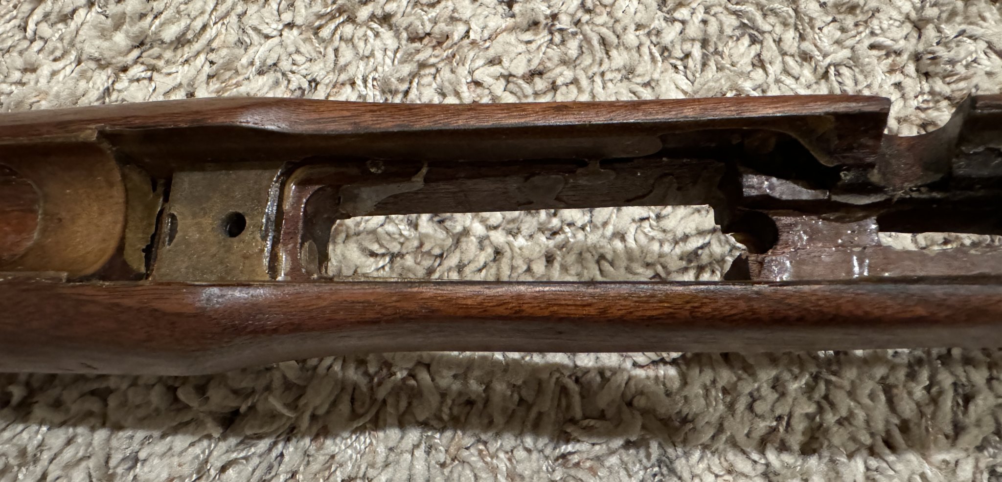

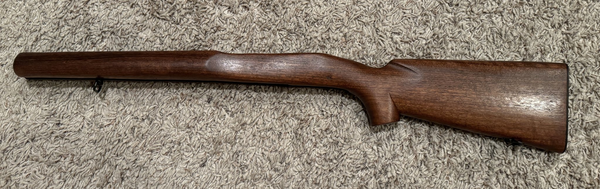

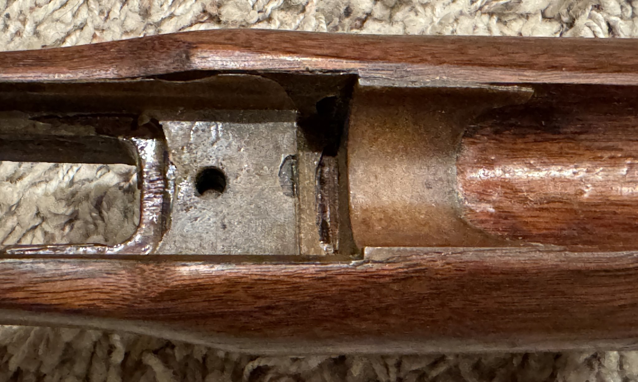

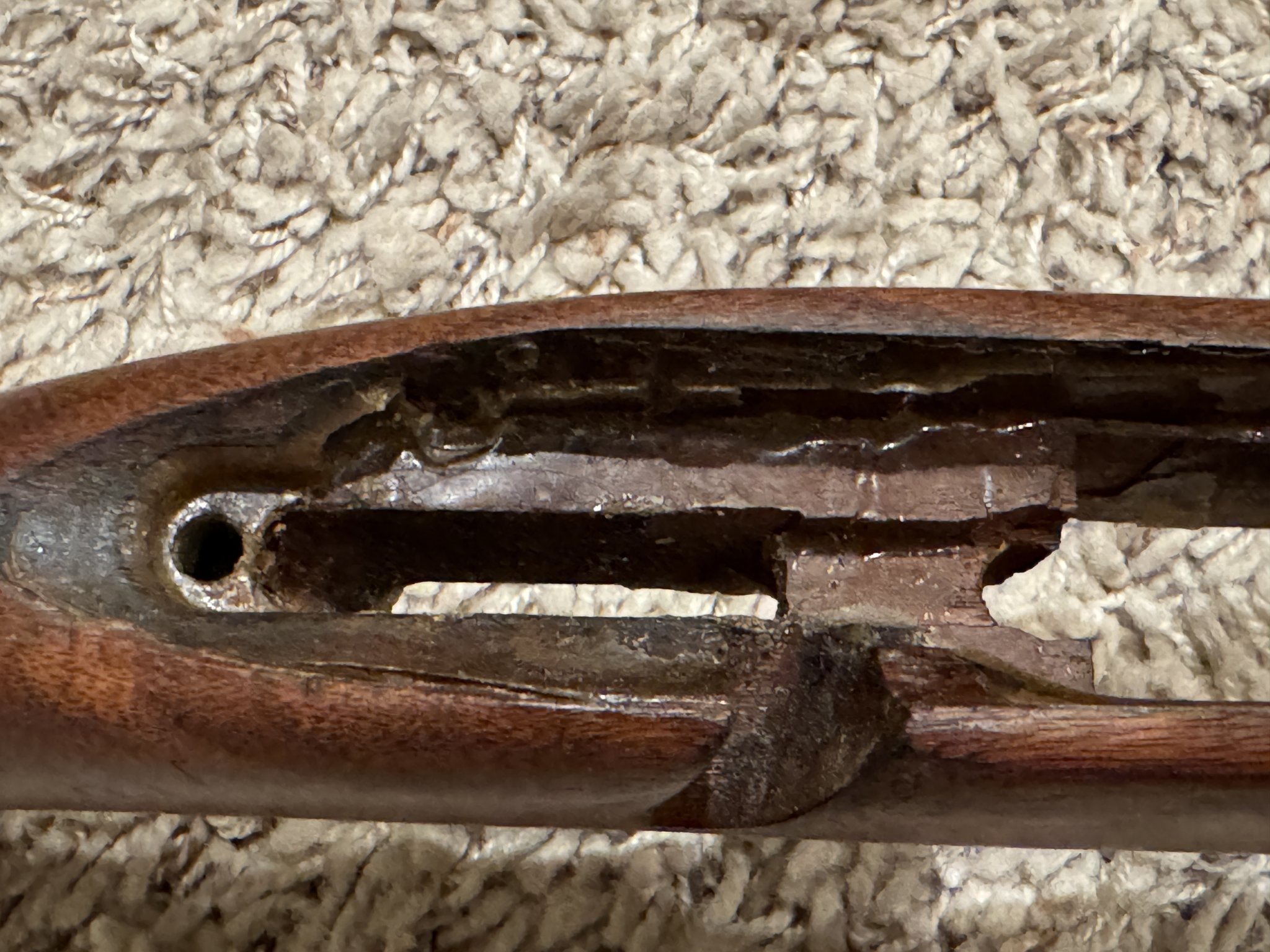

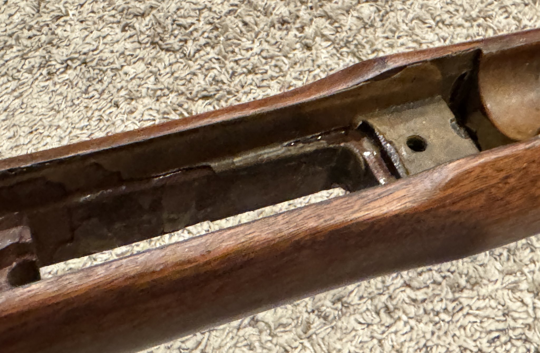

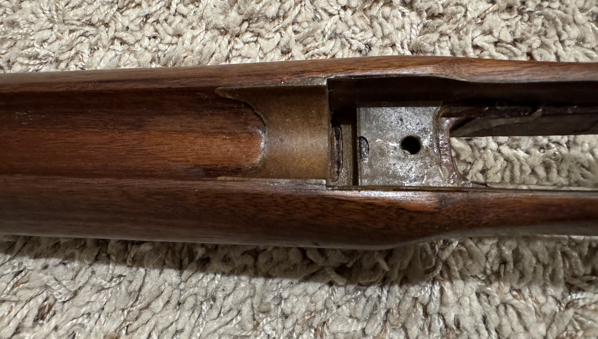

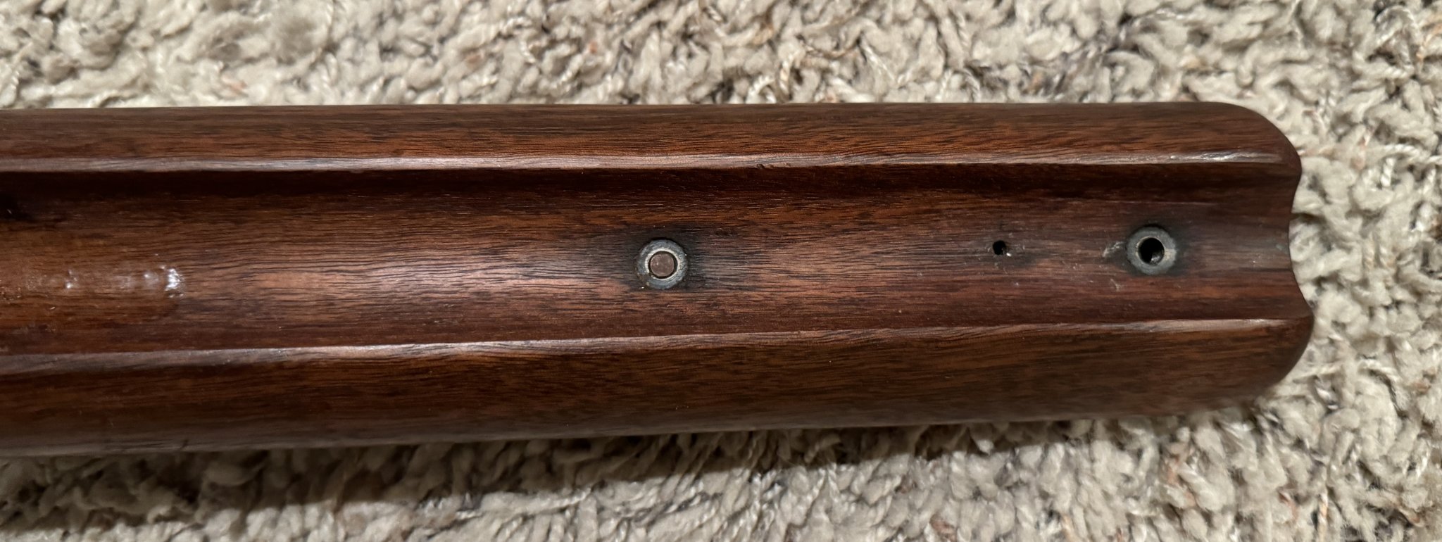

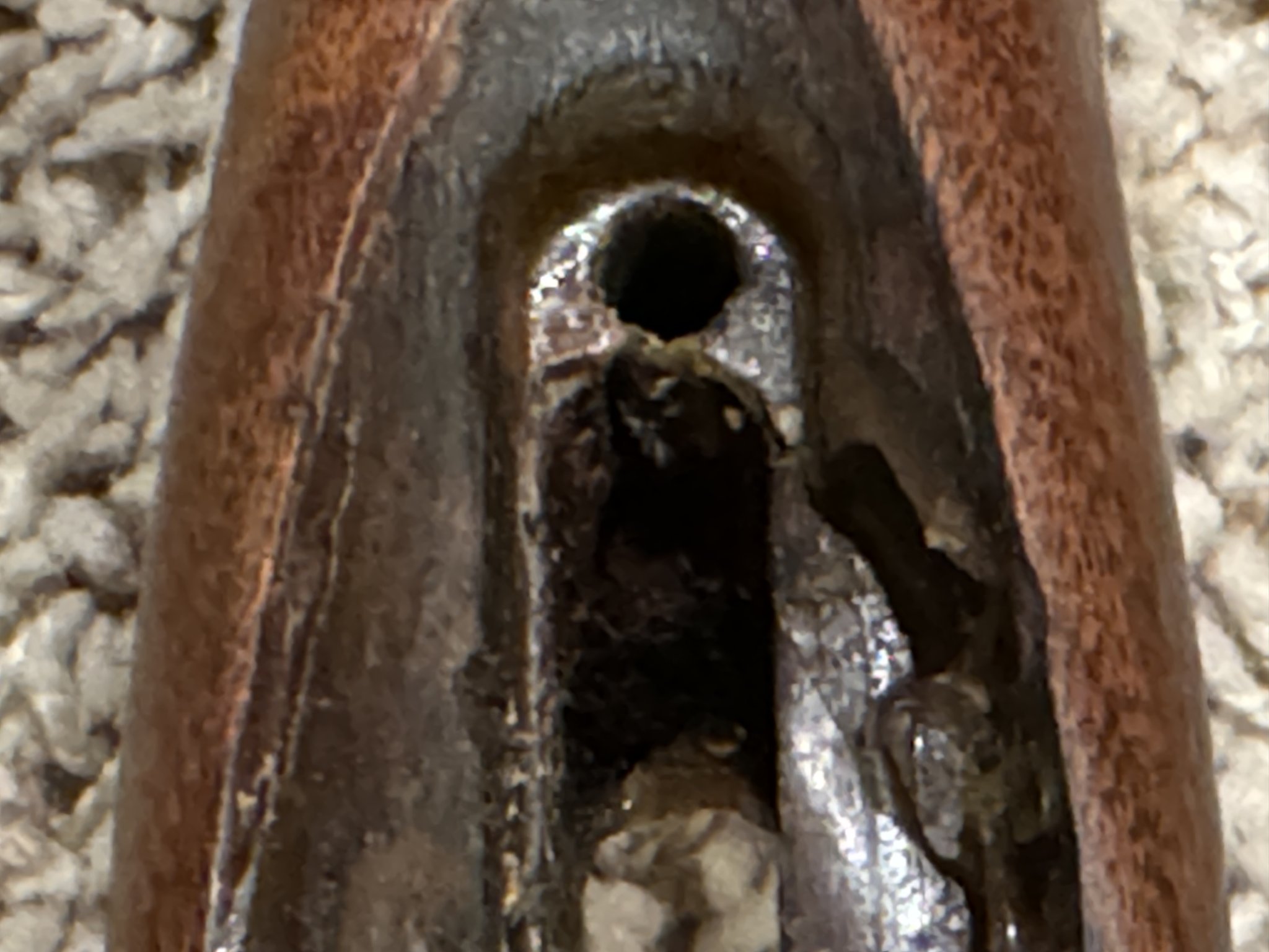

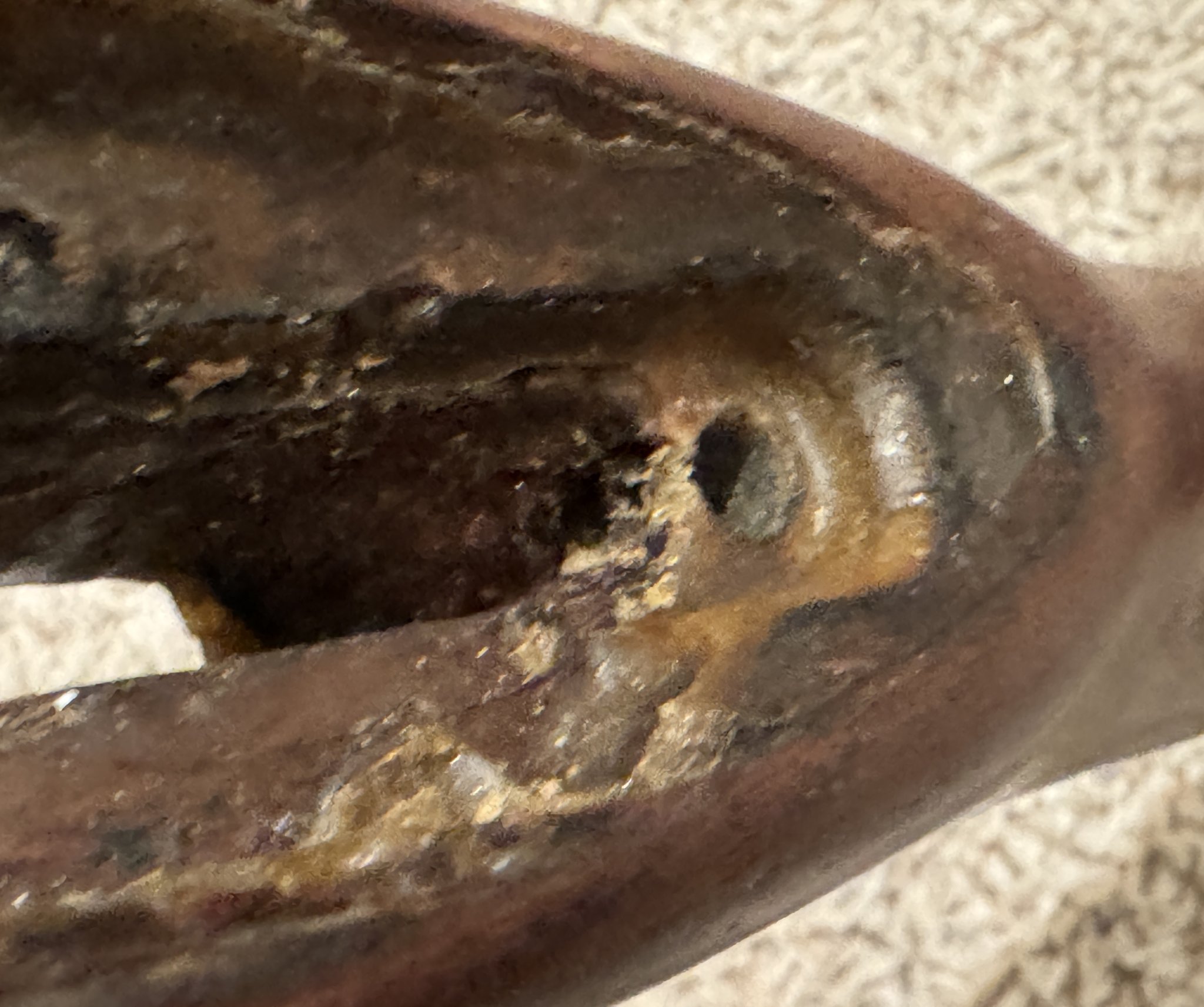

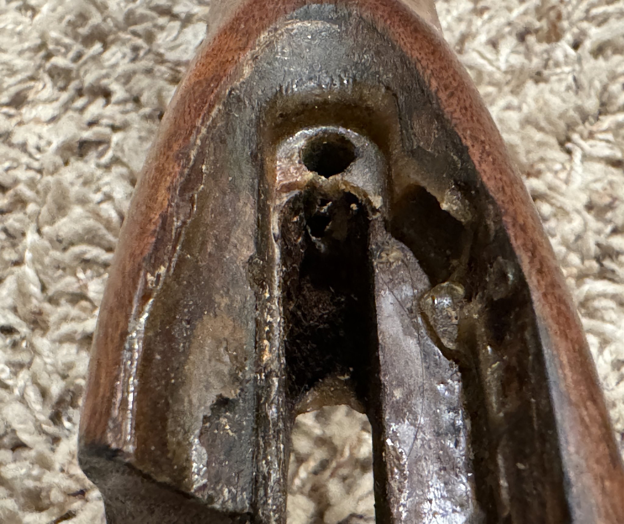

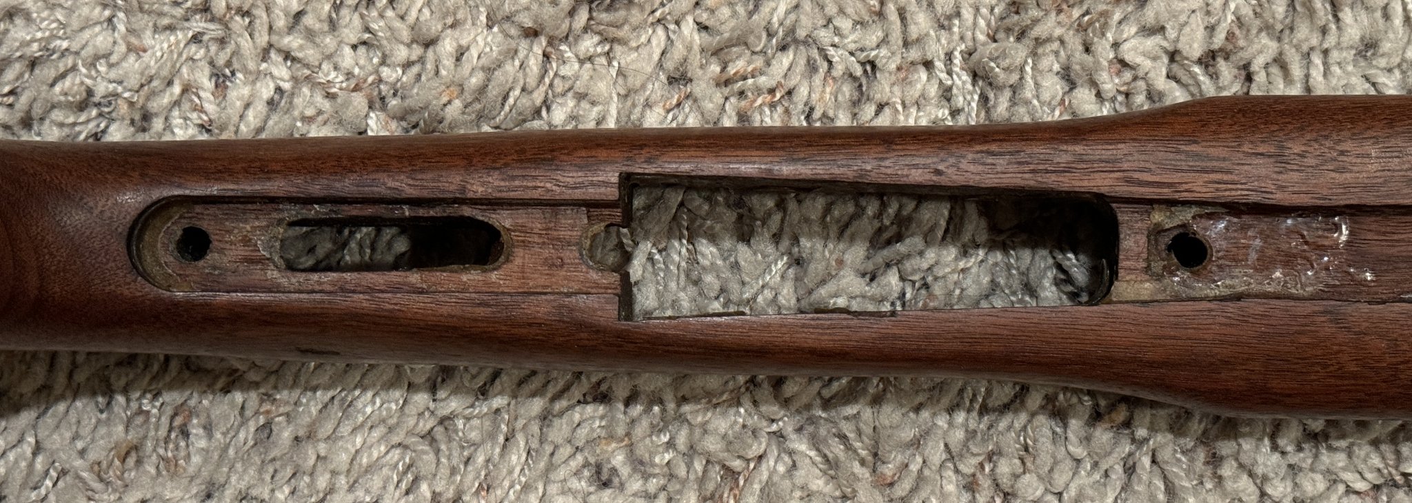

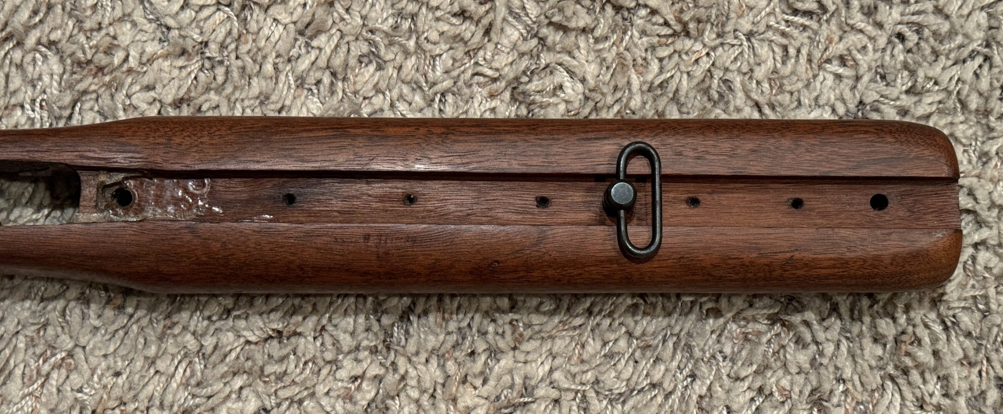

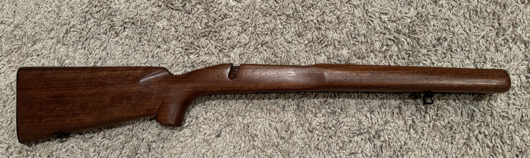

Welp, I managed to find an original pre-‘64 M70 target stock, but boy is it ever gonna need some love.
Looks to me like someone not only buggered an attempt to glass bed an action, they also modified the heck out of the bottom of the forend.
Everything else matches reference photos, including wood grain, except that funky bottom groove. Trying to figure out what that was all about.
My only real structural concern is that rear screw hole, aft of the trigger. That area looks like it’s missing some material. Good thing I know a great stock guy. We’ll see what he says…

I just looked on Guns International they have 4, 300H&H magnums pre 64 model 70 complete rifles for sale $1900 to $2600.
A bunch of 375 H&H, one looks new in box $1600 Alaskan model 2011 with controlled round feed. The barrel could be changed for a new 9 twist 5 R Bartlein, by a gunsmith, for an almost new rifle, wood and metal.
The stock you have can be machined easily by a stock duplication router, for a new stock out of the wood of your choice. Check with stock makers, like Stocky's...unless you want to do it yourself
I'd just go buy a complete rifle...get all Winchester pre 64 parts...for the purest.
Or for me the $1600, 375 H&H and rebarrel with a 9 twist Bartlein profile and length of choice, depending on use. But I actually like the 375 H&H cal too.
But I'm not building it... you are, so continue on your journey.

I just measured the channel, and it looks like D=0.691" to 0.720", while C=~0.263". Those values fall somewhere between the Anschutz and Freeland dimensions, so maybe it originally had a custom-machined rail? I'm going to have to get creative with this one.
On the reloading front, I just received 50rd of "blem" Nosler brass, and I'll be damned if I can find anything wrong with it. We'll see how it takes to reforming.
Not unheard of from stuff back in the day to have had some custom fittings performed for whatever material that they had access to.
Reactions: Super30
I was originally planning to shoot this rifle from bags rather than a bipod, but since the stock has already been modified for a bottom rail...maybe I could pick up an Anschutz 15" rail from Freeland Sports, have it machined to fit this channel, and also purchase Freeland's Harris-Anschutz bipod adapter? I'd be out only $26 in parts + machining costs + work to securely mount the new rail to the stock. 🤔
Should be doable based on the spec but I’d probably try to mill the stock to accept a standard spec part vs customizing the part into the stock.
Y'know, looking at the finish again, I'm starting to wonder if this stock was a special order (I have no idea if Winchester accommodated such things back in the day). The bottom channel doesn't appear to have been sanded/refinished; the finish and grain seem to match the rest of the stock. So it's either that, or it was refinished and they did a really good job of it.
