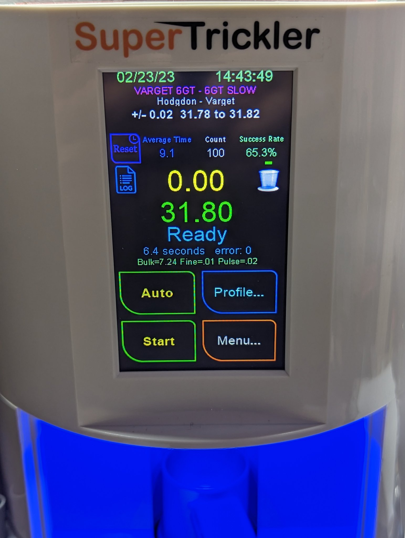

I can drop 31.8 gr Varget in 4-5 seconds with zero overthrows in a 2 day match prep (250 rounds).
Old video... This was out of the box before tuning.

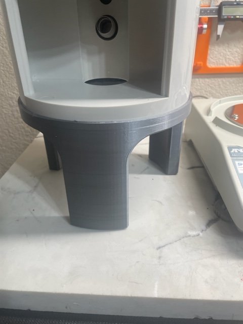

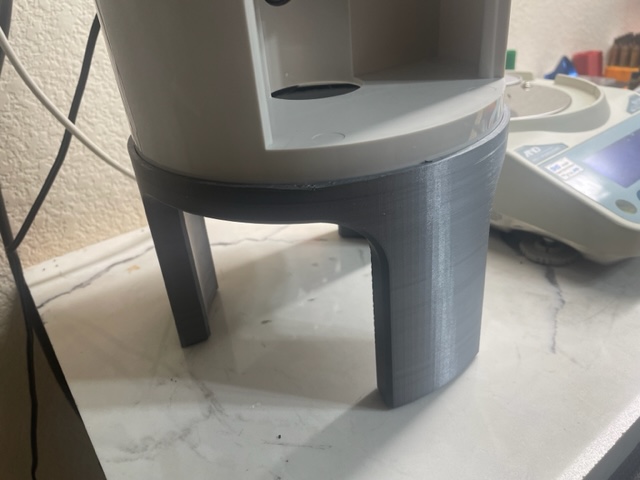

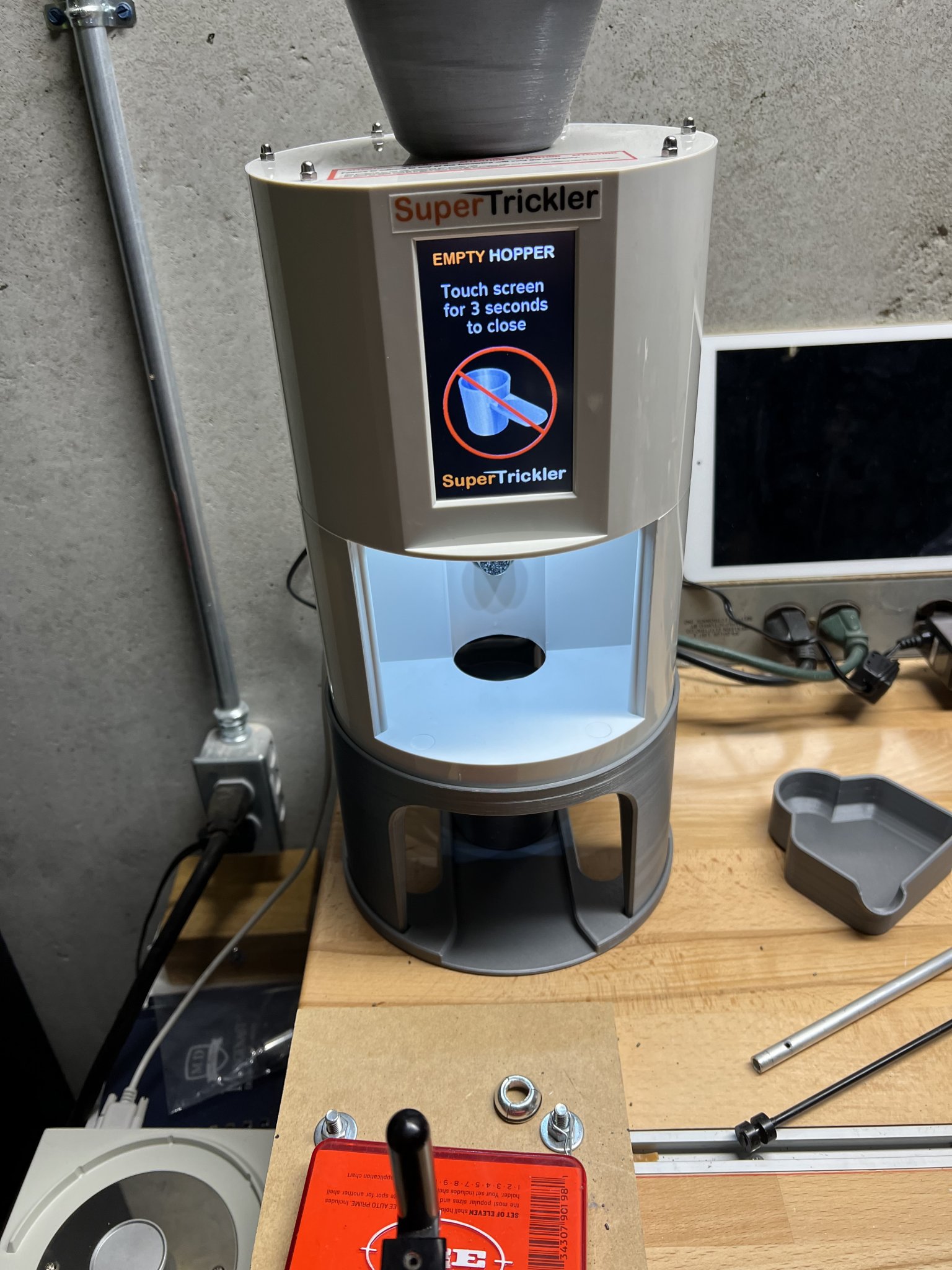

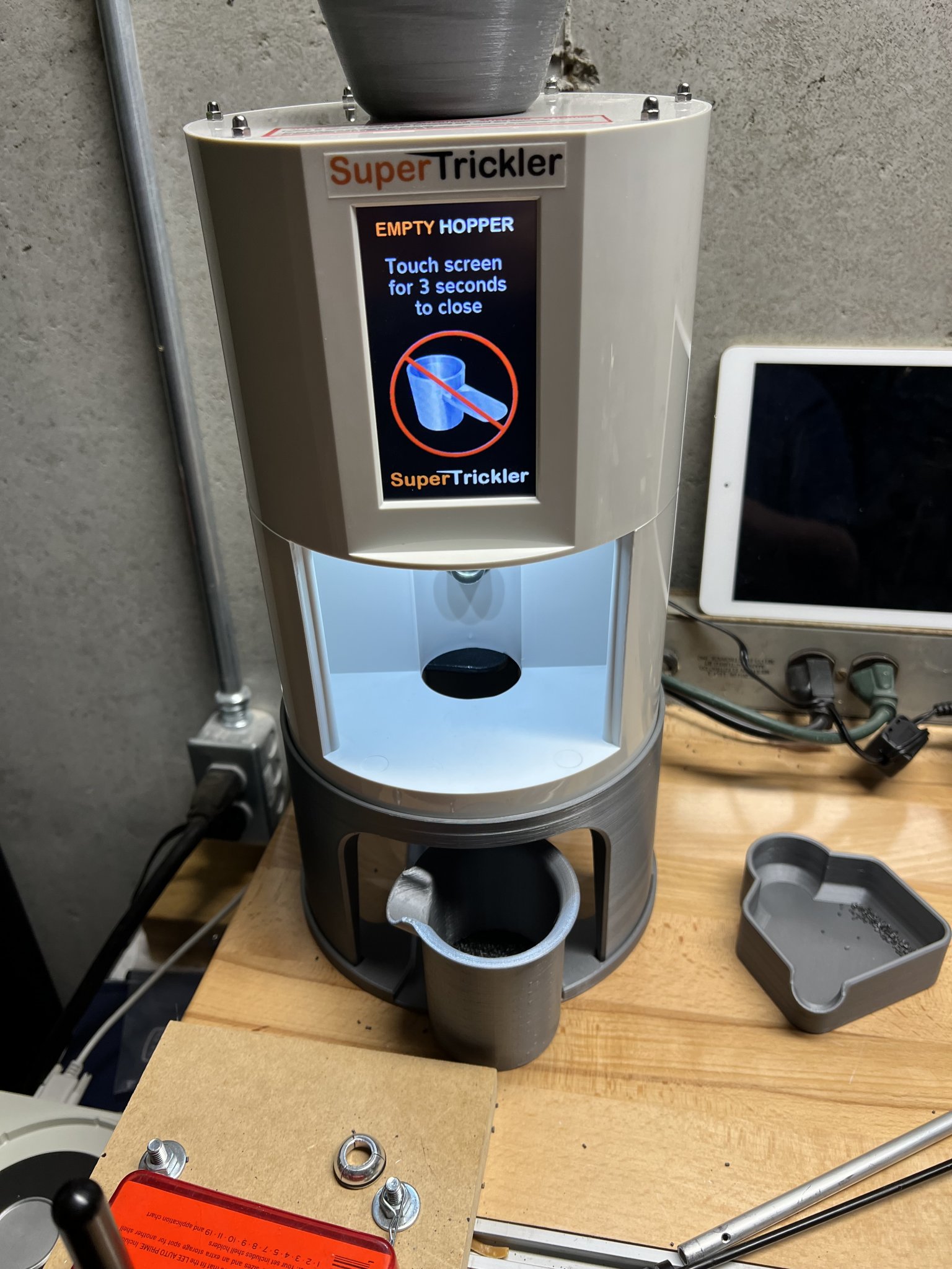

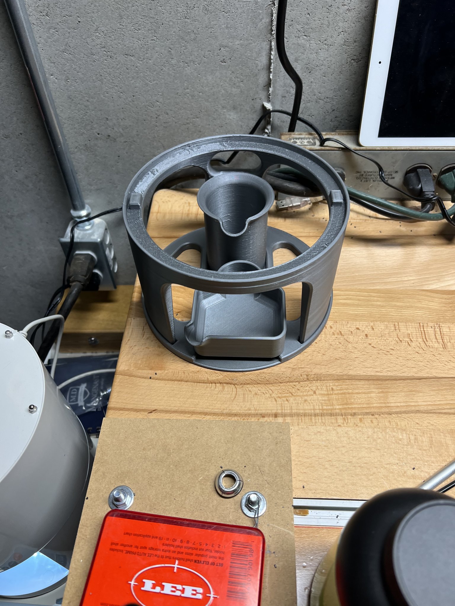

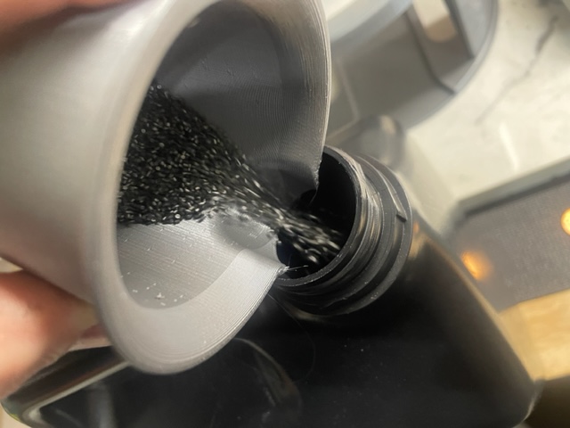

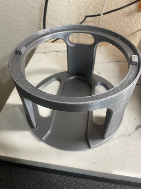

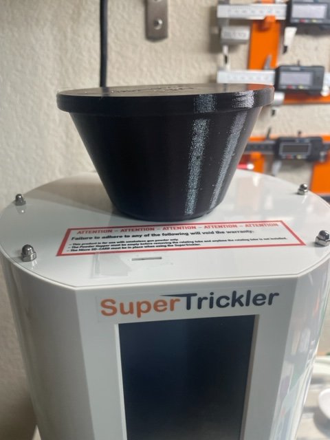

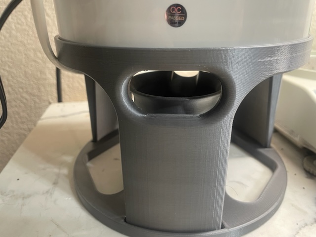

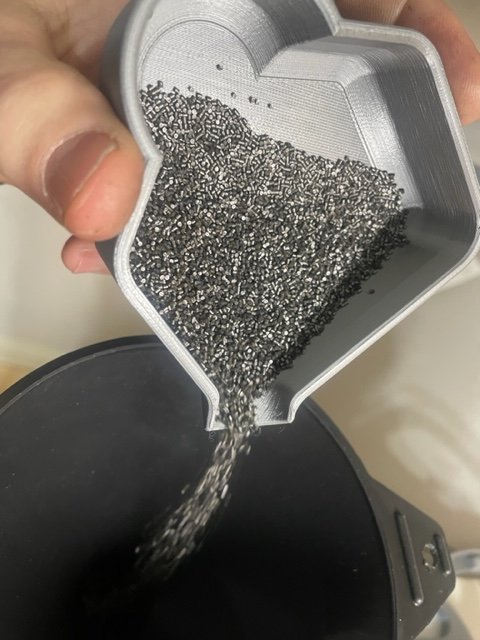

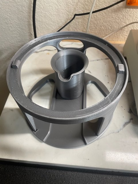

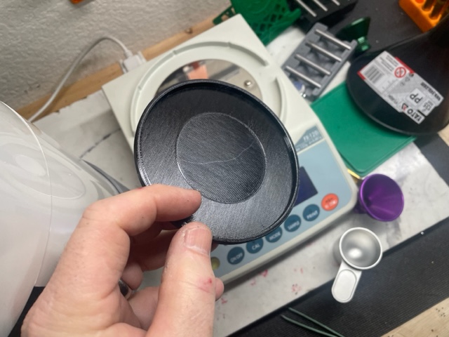

I got the powder dump from pfl338 yesterday. It works great. Everything was easy to reach and if you want to pick your unit up and tip it backwards or use the prime tube option to empty the tubes it work’s either way. I like It. Only thing I think I’m going to do is add a dab of superglue to the legs so I don’t knock it off the bottom plate. I don’t think it necessary but whereI have it set up on my bench I think it would be best.
Reactions: Jackomason
