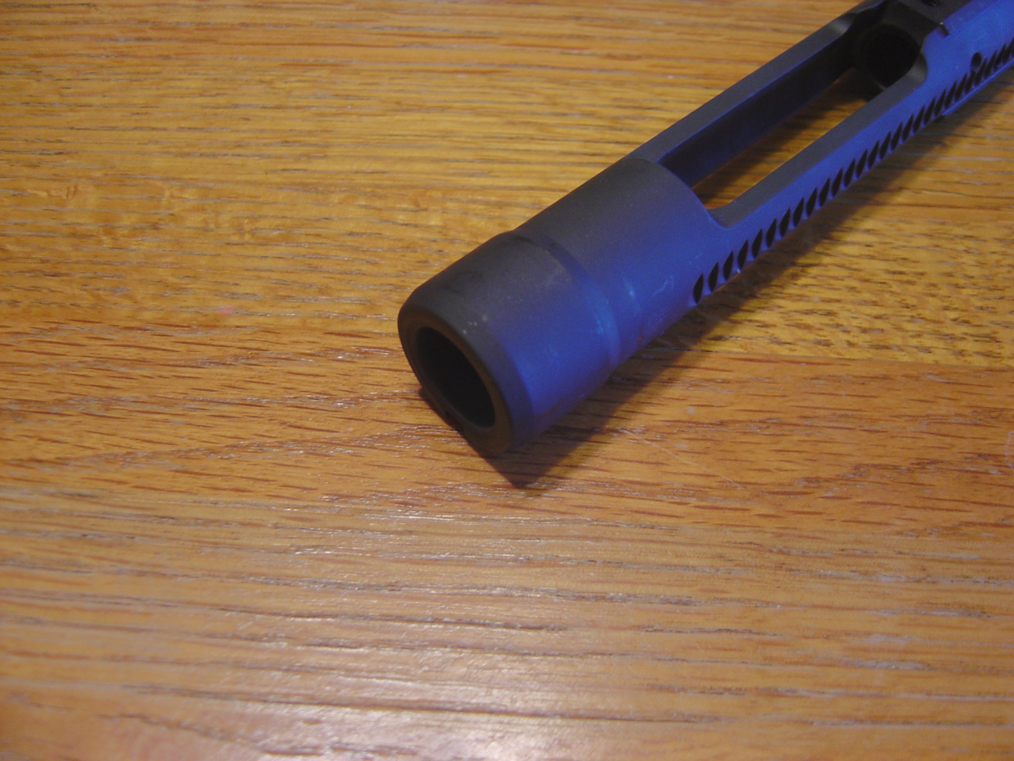

Is anyone using a "supported" bolt carrier group? For example the lantac enhanced BCG or CMC BCG with the larger flange at the end of the carrier that is supposed to aid in repeatability. Is this aiding in accuracy or is this market hype?
Reactions: HK-93
Is BCG tilt really a thing or just something that companies are making up to try and justify their high prices? Personally I think it's them trying to justify their high prices. But I could be wrong.
Oh wait, I heard BCG tilt is a massive issue that needs to be fixed and fixed right now. I heard it on the internet so it is true.

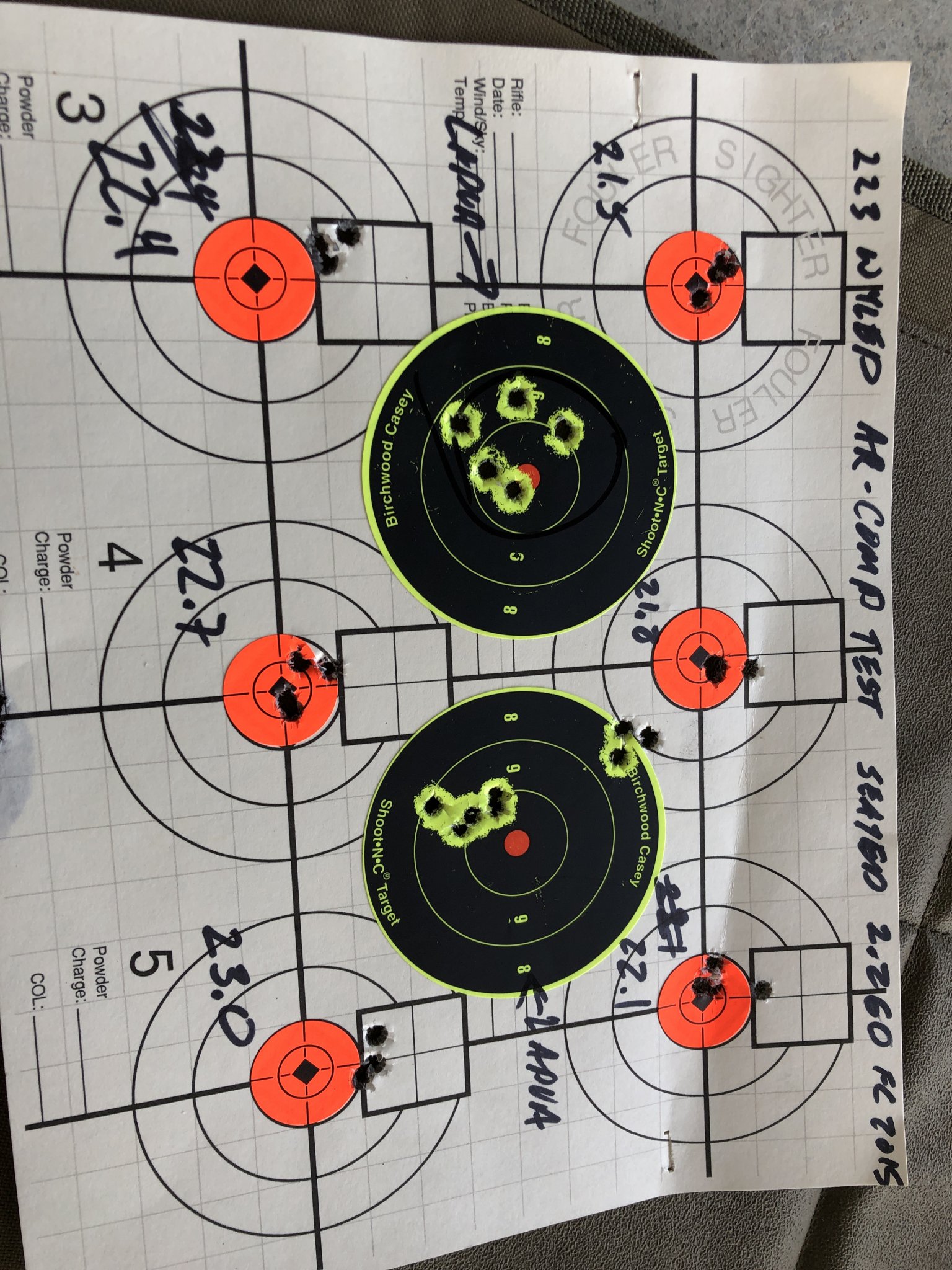

I'm not running one. Maybe that's why I can't reign the flyers in when doing load development. Six of these are four shot groups, the two center shoot-n-see are me burning up old ammo.
