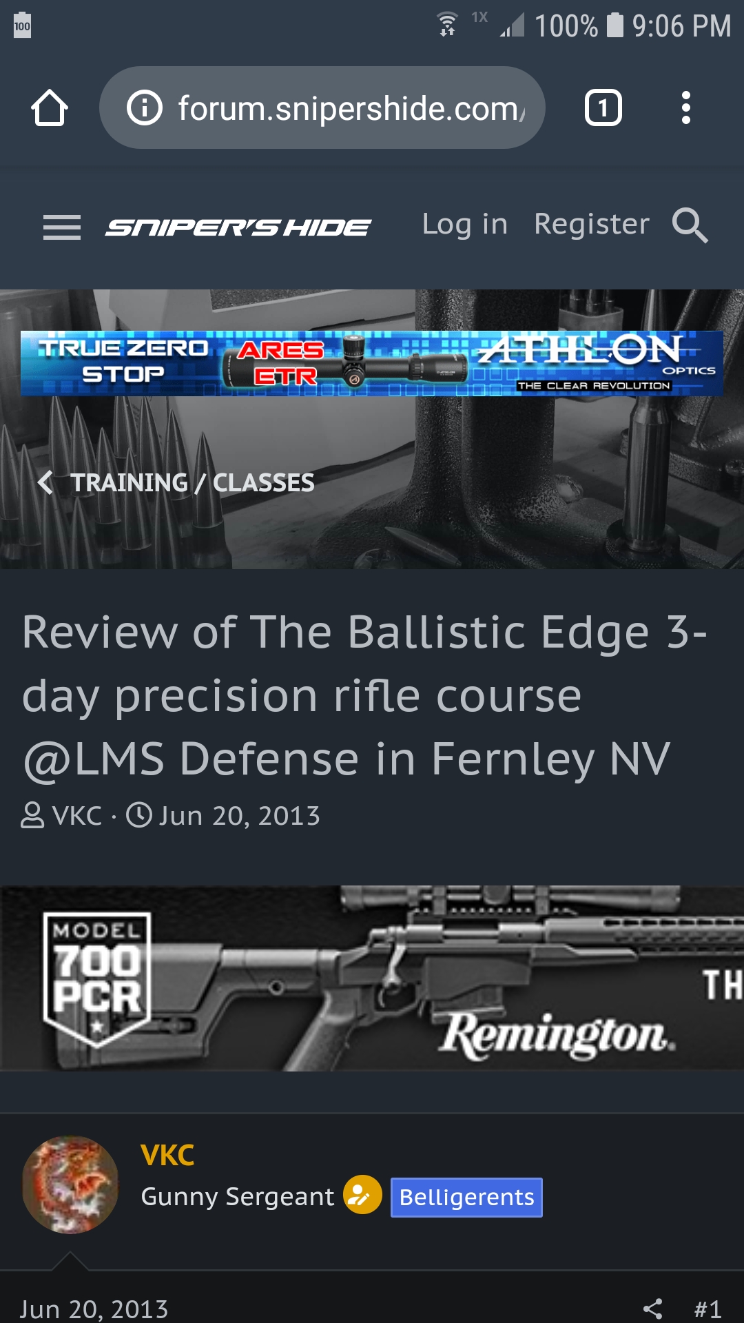

Below is a screen shot from an earlier training venue featuring Dan Flowers as an instructor, from 2013 Snipershide.
