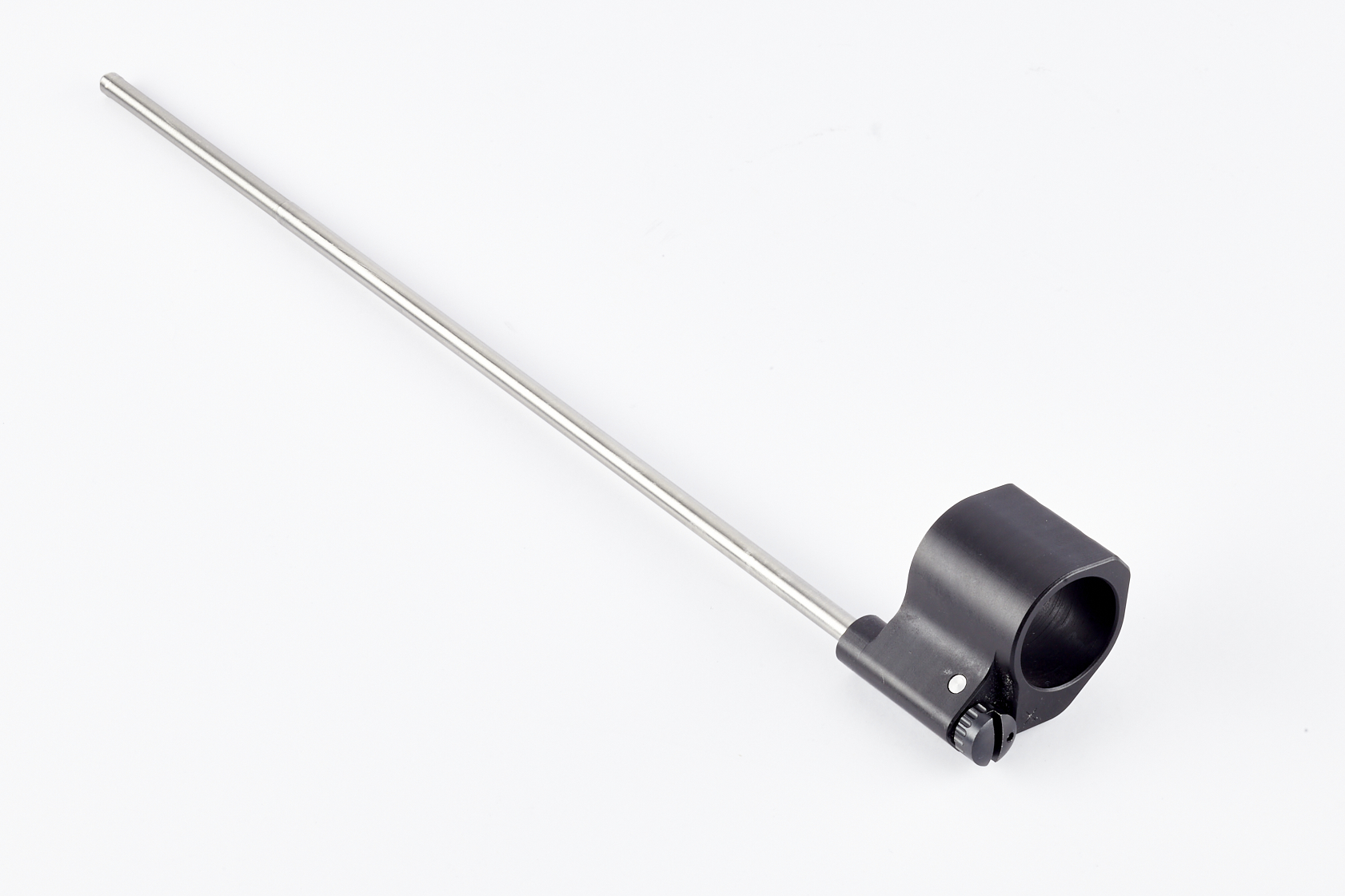

With all of the variables to consider (suppressor back pressure characteristics, variable powder loads, barrel lengths, buffer weights, BCG weights), I think the first thing one should consider is a tunable gas block if you are considering running a supperssor.
