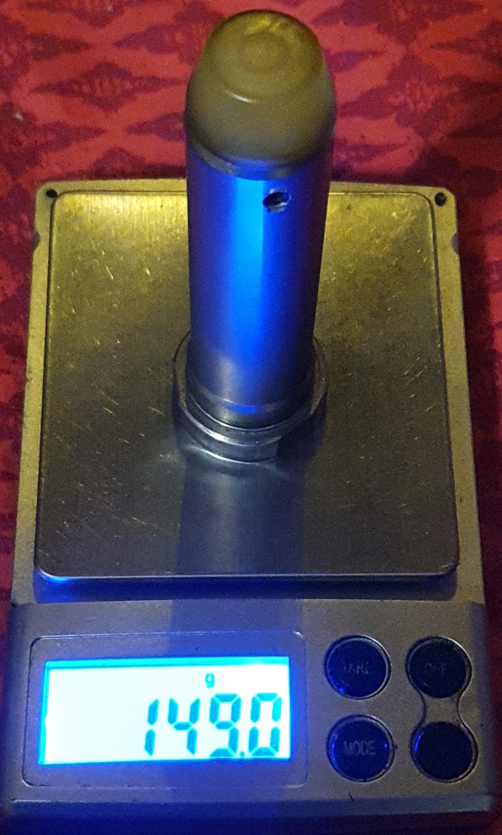

I have good weather now and my friend just bought a brand new LMT 16" for super cheap so a range trip is due. I try to lend a scale that I could take the whole weight of the buffer, I think it is quite interesting to see if it is the standard 5oz weight.
Ok,

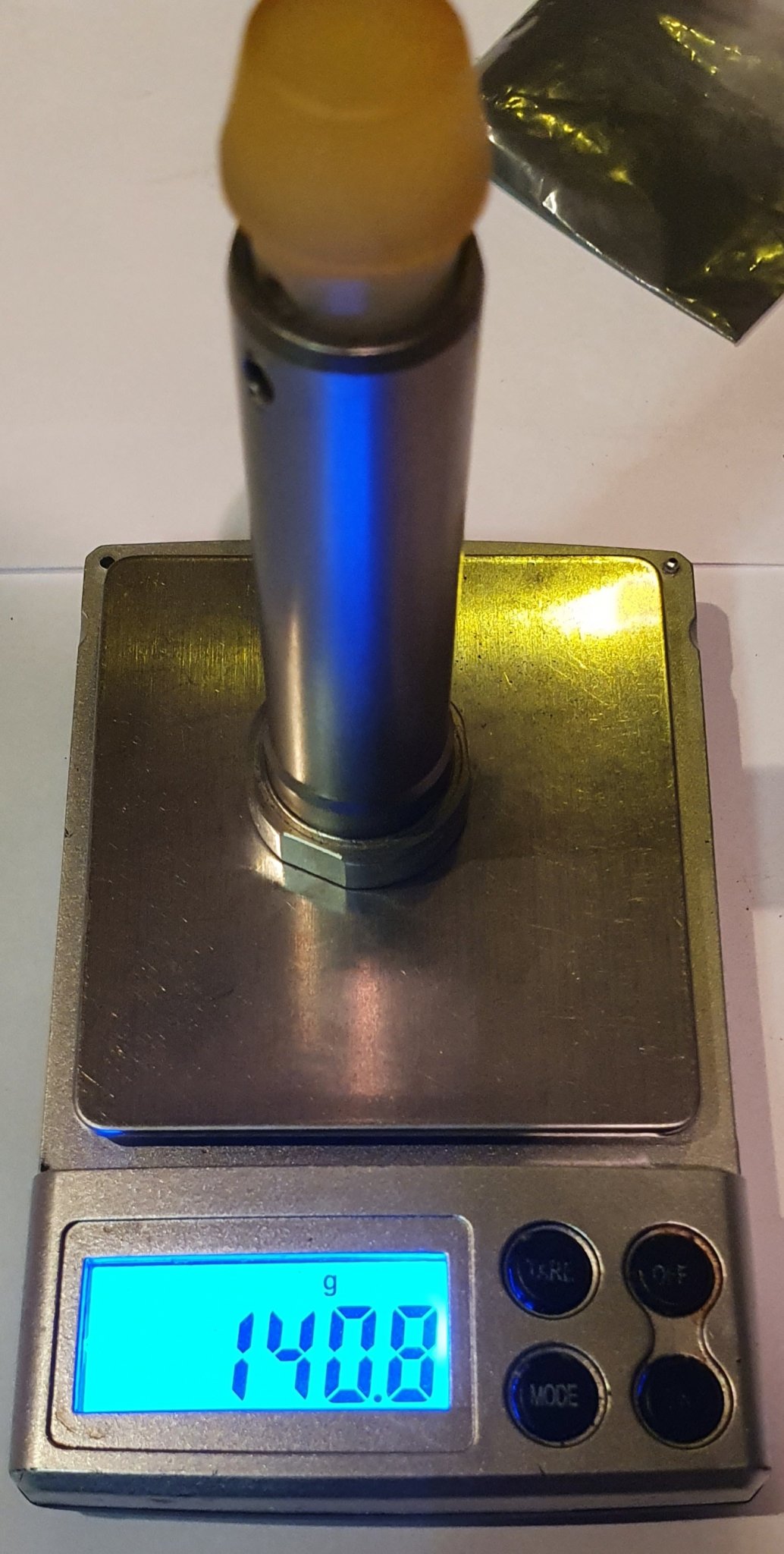

I used quite crappy scale but it showed the 50g test weight 50,1g so it is close enough for this job.
And so I have now changed the weight of buffer.
It weighted 149g / 5.26oz.

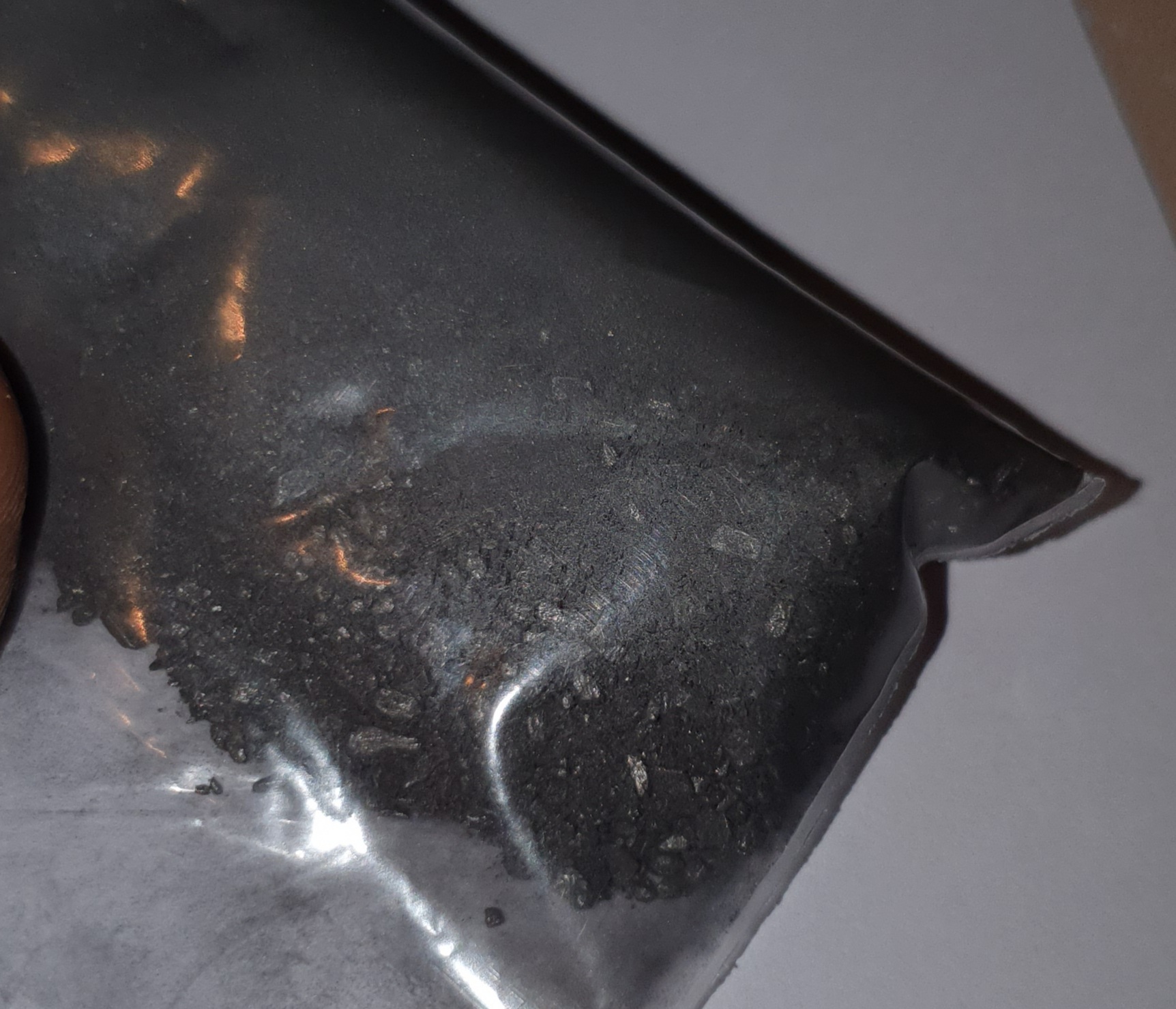

I took around 8g/123gr of tungsten powder away, the whole amount of the powder in the buffer weighted 117,2g / 4.13oz. It was mostly very small stuff with few bigger granules in it.
The buffer now weights around 141g / 4.97oz
