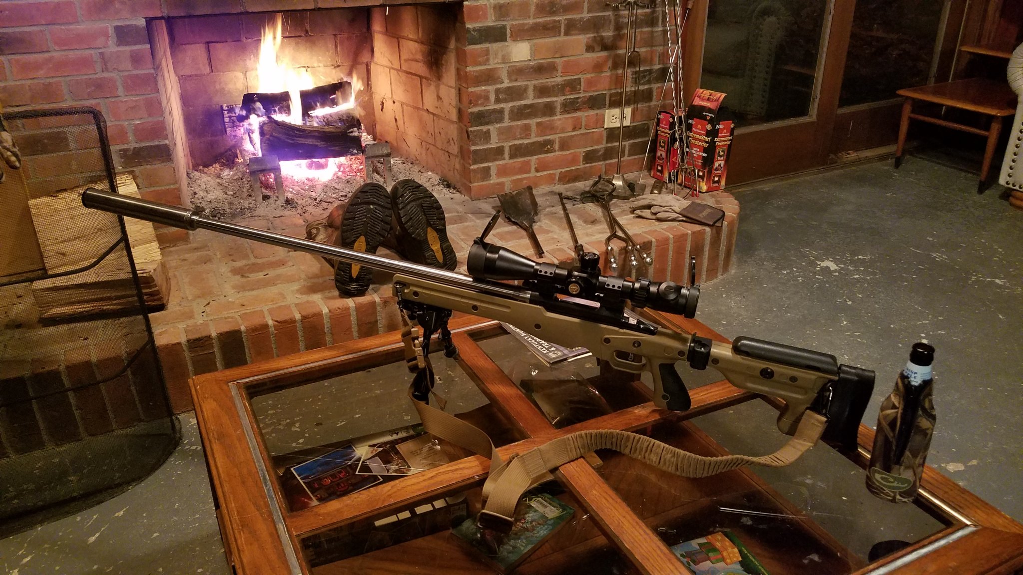

I may be the only idiot dumb enough to pack around a rifle with a 28" barrel and 10" suppressor, but i have a ton of confidence in the combination and I'm not changing until TBAC produces a can with better performance, same capability and smaller size than the 338 Ultra, not likely any time soon.
