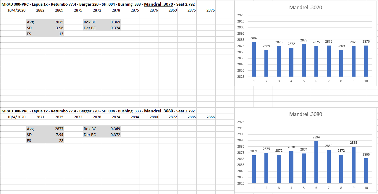

UPDATE ... (you're gonna want to read this)
So I got my Arbor Press with Force Pack and Dial Indicator today, along with the five caliber Inline Seater Dies that I ordered. HOLY CRAP ... was I surprised when I got to testing my standard loads.
Here's my advice to you guys ... the "feel" of the lever on a standard reloading press is IN NO WAY an accurate measure of seating force or neck tension. I started with my 6.5-CM load, which I've been refining so it "felt" like I was getting good neck tension ... vs. the greased slide feel when using the recommended size bushing and mandrel. I had started with that months ago and it just felt like there was "zero" force required to seat, so I've been ratcheting down the bushing and mandrel sizes to get some semblance of light pressure on the ram as I was seating bullets.
WRONG ANSWER !!!
I tried my current 6.5-CM load ... .284 bushing and .2610 mandrel ... that "felt" right when seating bullets on my single-stage press. When measured on my new arbor press, that load "started" to seat at 40 lbs of force, and on the high side the reading never registered because the press screws started to slide as I passed 100 lbs of force. I was stunned.
Decided to do all my measurements again ... .289 bushing and .2640 mandrel. Got a start force at 10 lbs and finish at around 15 lbs ... which was a little too light. Dialed down to a .288 bushing and a .2630 mandrel ... and got a perfect seating pressure start of about 15 lbs and a finish at about 25 lbs ... almost exactly where I wanted it (and thought it was before measuring properly).
Then I took this prepped case recipe (15 lbs / 25 lbs) over to my single-stage press that I've been using all along, and it felt like the bullet was sliding in unobstructed on greased skids.
Lessons learned:
  1. If you care about neck tension ... buy the tools to measure it accurately.
  2. Seating by "feel" on a regular press is a waste of time and supplies.
  3. You're way closer to proper neck tension with the standard numbers ... than by trying to "feel" it on a standard press.
This has truly been an eye-opening exercise ... and now I need to go retool my reference loads and test them all again with the proper neck tension ... vs. the "hammered in" force I've been unwittingly using.

So in the beginning you found that heavy neck tension shot better than light. But now the gauge maxes out so you are going lighter again?
If you read about the lee factory crimp die, the crimp acts like loading OAL to the lands and allows the pressure to rise some before letting the bullet go, giving a more even powder burn.
I dont know if it really works. Just reading what youv'e posted and thinking about what's going on.
What I'm doing now is reloading some tests with "reasonable" neck tension ... and shooting them for SD and Groups to compare with the ultra-heavy neck tension I've been inadvertently running. I'll see where it leads me next.
imho
dont go over 0.003' of 'neck tension' because 0.002' is 'theoretical' maximum. over that value you are deforming your brass with no additional tension, and your bullet jacket can be deforming. if this is true: https://bisonballistics.com/articles/case-neck-tension-a-stress-analysis
and ask producer of your press (K&M I suppose), if your values of force is comperable to other K&M presses. maybe they are, but maybe they are not!
is force the same at different speed? is force the same at different height?
and I think the force is NOT the same in your press and 21century hidraulic press...
so be careful when comparing your data to others!

OP UPDATE - 10/04/2022
Well ... a lot has gone on here since I started this thread. I've tested a LOT of stuff now that I have a means of knowing exact neck tension and seating force. It's all about swinging the right tool ... eh? This documents one result that surprised me. As I've gotten closer to what I consider the "perfect" neck tension with my Barrett MRAD 300-PRC, I decided to try a 10-round test, where the ONLY difference was that the first group used a .3070 Mandrel, and the second group opened the neck slightly more with a .3080 mandrel. The first had a much higher max seating force (almost 80 lbs), and the second had a much lighter max seating force (around 40 lbs). Both gave solid results, but the smaller neck tension provided a Standard Deviation of about "half" the larger mandrel. .3070 mandrel SD was 3.96 and the .3080 mandrel SD was 7.94 ... with the averages very close and the ES' following the SD's. Not a surprise that at 100 yards, both delivered very tight groups.
Is anyone else surprised by these results of almost "double" the SD for only a 1/1000th larger mandrel, with no statistical change in velocity?
I was a little surprised by this.
Like the guy on the Bolt Action Reloading YouTube says ... "In God we trust - All others bring data."
Next test is with a .3075 mandrel to see if it splits the difference, or delivers a surprise result.
