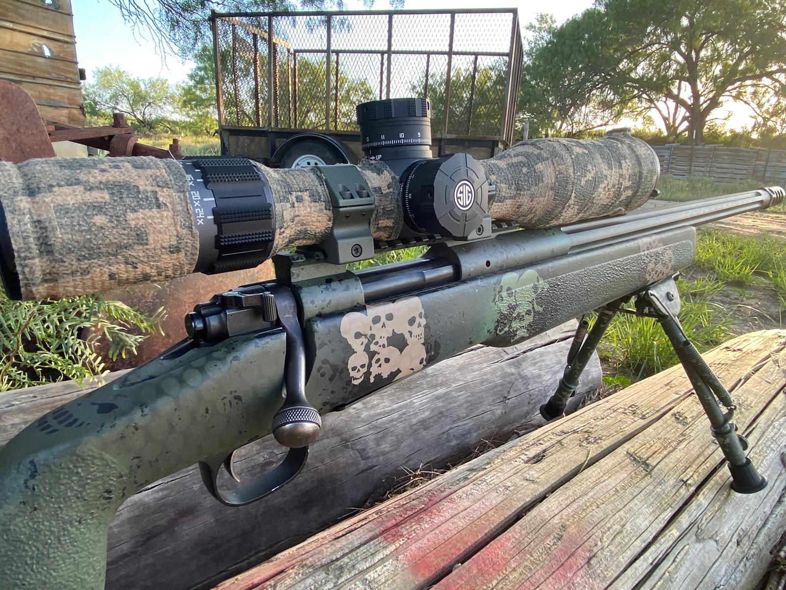

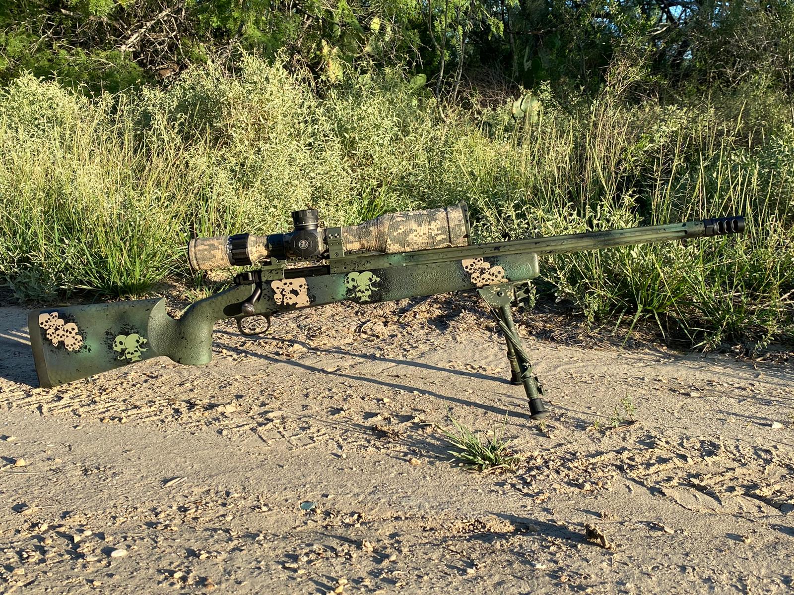

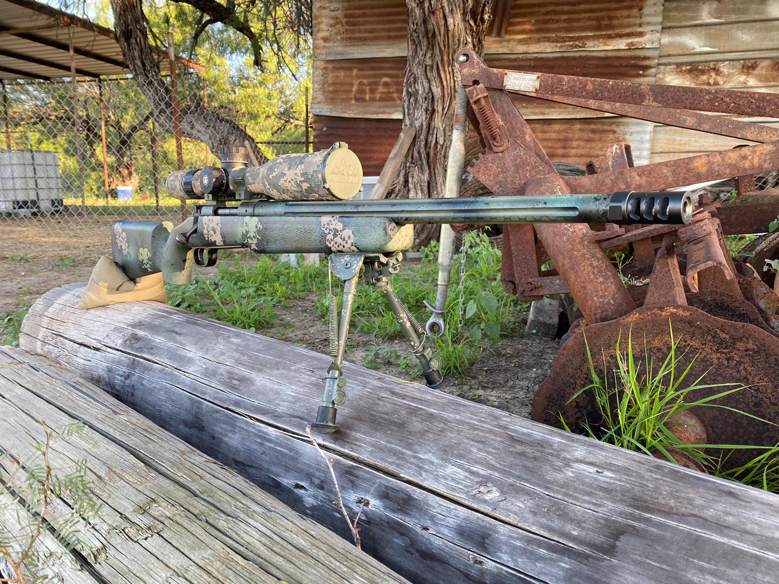

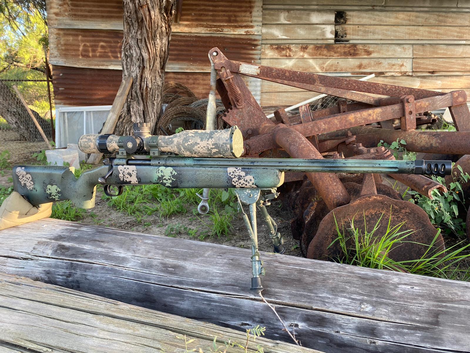

I ran into an issue with low 34mm rings the other day. Seekins .92 rings give me about a solid 1/16" or less clearance between the objective lens on my Bushnell DMR II and M24/40 contour barrel (replacement) on my FN SPR with factory 20 MOA Badger base. Hell, maybe it is 1/32" clearance...I can't get the bikini scope covers that came with the Bushy over the objective lens. I like a tight fit, so it doesn't bother me one bit.
I also have a set of Vortex precision matched .92 rings in 34mm from an older Burris XTR II 3-15x50 that sat on a different, factory barreled FN SPR. However I'm having that barrel replaced.
Anyway, I purchased a Burris XTR III 5.5-30x56 recently, and tried them on my M40 contoured SPR...I maybe had .003 - .004" clearance with the .92 rings...too close for comfort for me. It is literally like the barrel/cylinder gap on a good revolver. I'm now running the Vortex 1.1 rings, and I've got a good 1/4" clearance.
My point being: Maybe we aren't going to see a whole lot of 34mm rings lower than .92 because it can get you into clearance issues with heavy contoured barrels pretty quickly.
