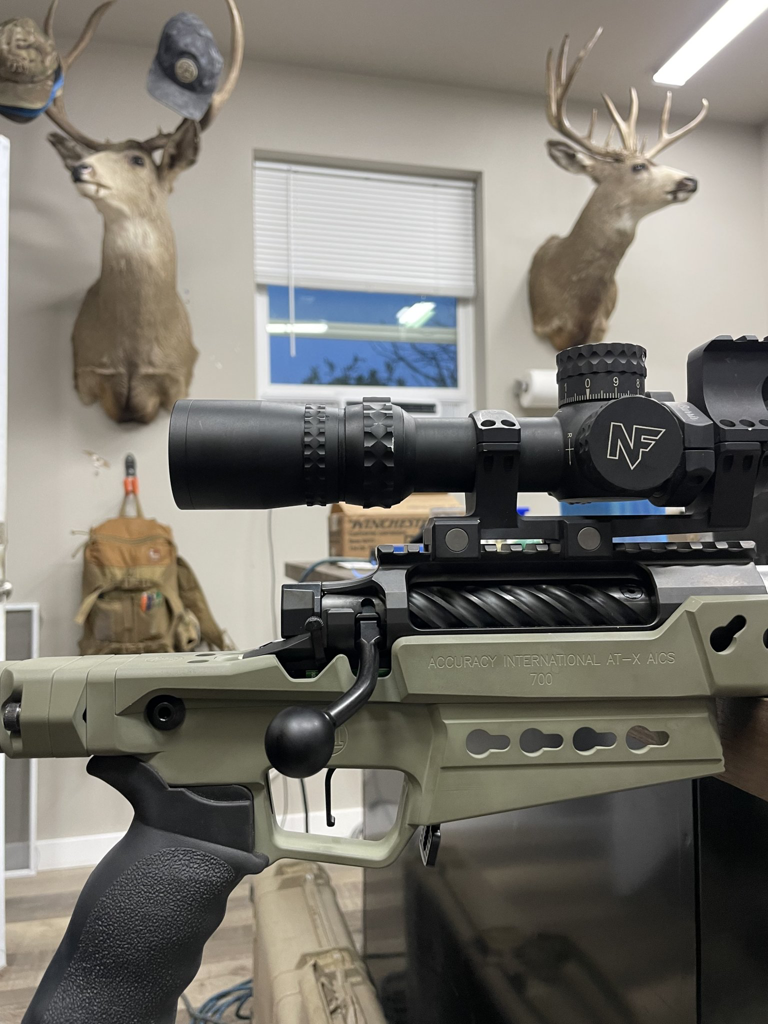

Was trying to keep all my rifles similar. Rem and Howa have swept handle. The AI has a "swept like" handle.

Realistically you can sweep any of them as others have said. A little heat and persuasion goes a long way.
This is the CDG that @JaredCO did:
Badger and Tempest were the OG swept ball handle 700 actions and very similar in feel to AI. They never really got super popular and are somewhat hard to find anymore, but they were/are both solid actions.
Tikka w/ Sterk handle is pretty close for a factory option. Probably one of the most popular options at this point other than AI.
