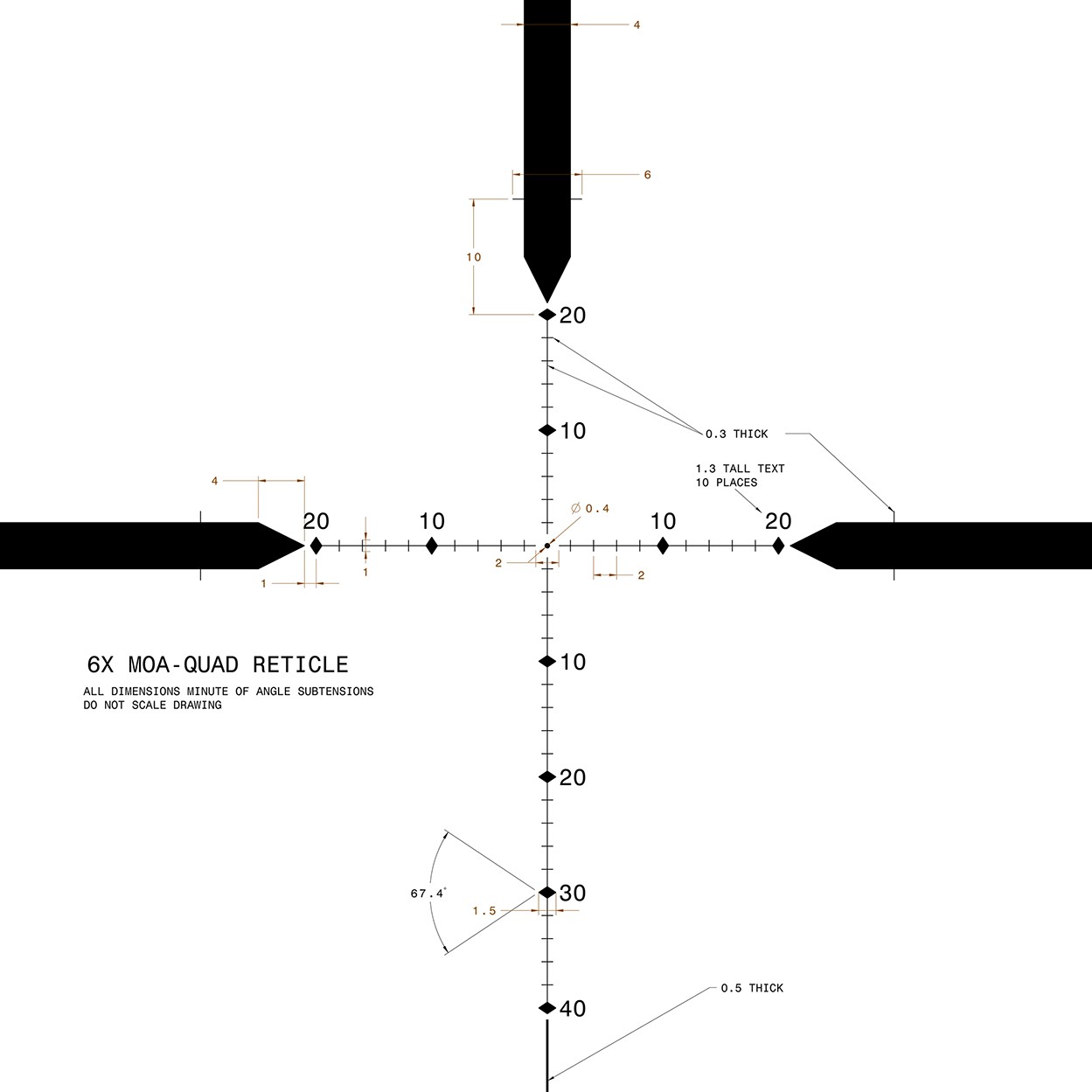

Hey guys, I’m really considering a SWFA 6x Moa/Moa scope. I’m looking to shoot my MkII out @ 500 yards. More often than not it’ll be 50-300 yards, I’m feeling 6x is enough. Thoughts?
Great scope for what you want to do.Take a look at the mil-quad reticle it is a dream to work with.I like the 6X swfa scopes better then the higher power swfa scopes.I shoot out to 400 yd rimfire with the 6x with no problems.Plenty of elevation for long range rimfire.
I use 20x MOA-quads on nearly all my long-range rimfires including my 2 long-range pistols. I made 50 moa mounts for most of them which let's me dial to 500+ yards. I think you'll find the gun is capable of shooting and hitting targets smaller than the 6x will let you take advantage of. Personally I don't think you'll be happy with it.

I have had several SWFA scopes on my MKII FVSR in the past three years. The mil quad is a decent reticle but I have recently started to appreciate more stadia lines with closer spacing than every .5 MILS or 2 MOA for more precise holds without dialing.
I started with the 6X but it lacked magnification I like for shooting small objects at 100 yards. Then, I moved to the fixed 10X but it still didn't give me the magnification I wanted. That is when I tried the 12X but it turned out to be too much for closer shots. That is when I snagged an SFP 3-15 with the mil quad and floating dot. That was a great little scope for close and far shots with a very usable reticle but it lacked FFP (I recently started competing in NRL22 matches and need a FFP reticle). I finally sold the 3-15 and have settled on an Athlon Midas Tac 4-16 FFP. For me, it has a great magnification range, a thin reticle, floating dot and .2 Mil stadia for finer holds without dialing.
I think you will be lacking with the 6X SWFA and think you should think about how you will use the rifle the most and pick a scope that will help you perform the most common shooting tasks the best.
I definitely feel that 6x would be a bit lacking. It is nice to be able to spot splashes in dirt should you miss, and below 16x I dont know that you can easily make them out. I have 16x and 20x on my 22s and they are excellent out to 500 yards. Hope you are happy with whichever one you get. I dont know that there is any better scope in that price range for long range rimfire.

I have 2 of the 10x moa quads. One is on a 223AI that I regularly shoot in 600 yard matches. They are built like a damn tank and just plain work. I'd go 10x.
I have the 12x and the 16x MIL/MIL SWFA SS scopes. 6x and 300-500 yards do not seem like a happy match. I would go 12x or 16x. 22lr does not kick up much dust at 500 yards. Also, with 22lr trajectory, the ability to hold fine is a must. 6x is for 25- to 50-yard hunting shots, or long shots on large targets with a centerfire rifle.

I went with the 10x SS. I think it’s about perfect for a LR rimfire. I almost never shoot closer than 50 so the 10x is fine. If it was something I was going to small game hunt with the 6x would be good too.
I’m thinking of going with the 6x for small game but I’ve read that some people find the reticle too small. Is there any validity to that at all?
