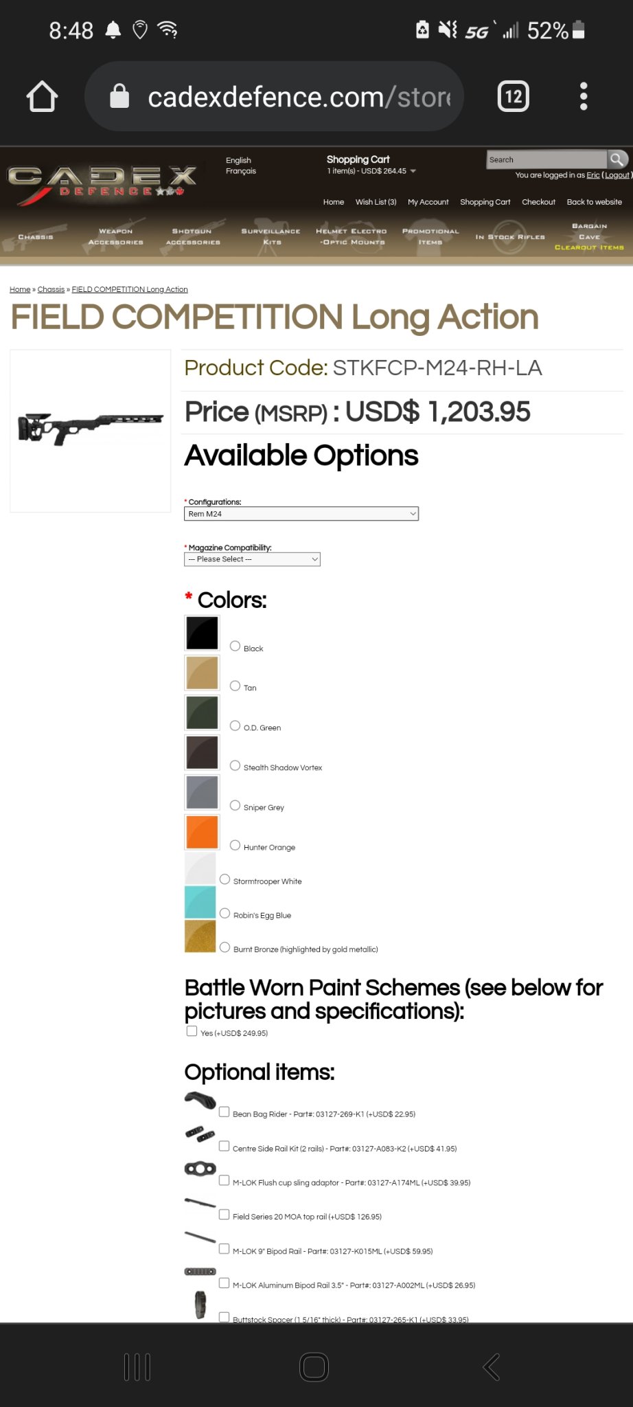

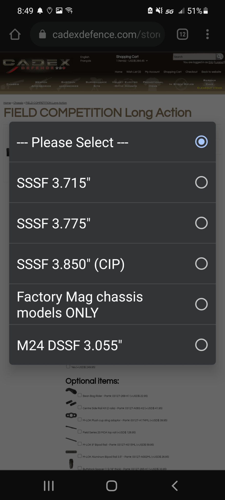

Are you running a long action? I ordered an accurate mag 3.850 magizine that I'm going to play around with and see what calibers I can get to feed out of it with the .470 bolt face. I don't have much rifle experience but I do have quite a bit of fabrication and MacGyver experience under my belt lol. It's worth a shot. Being I've already dropped the coin on everything I have now

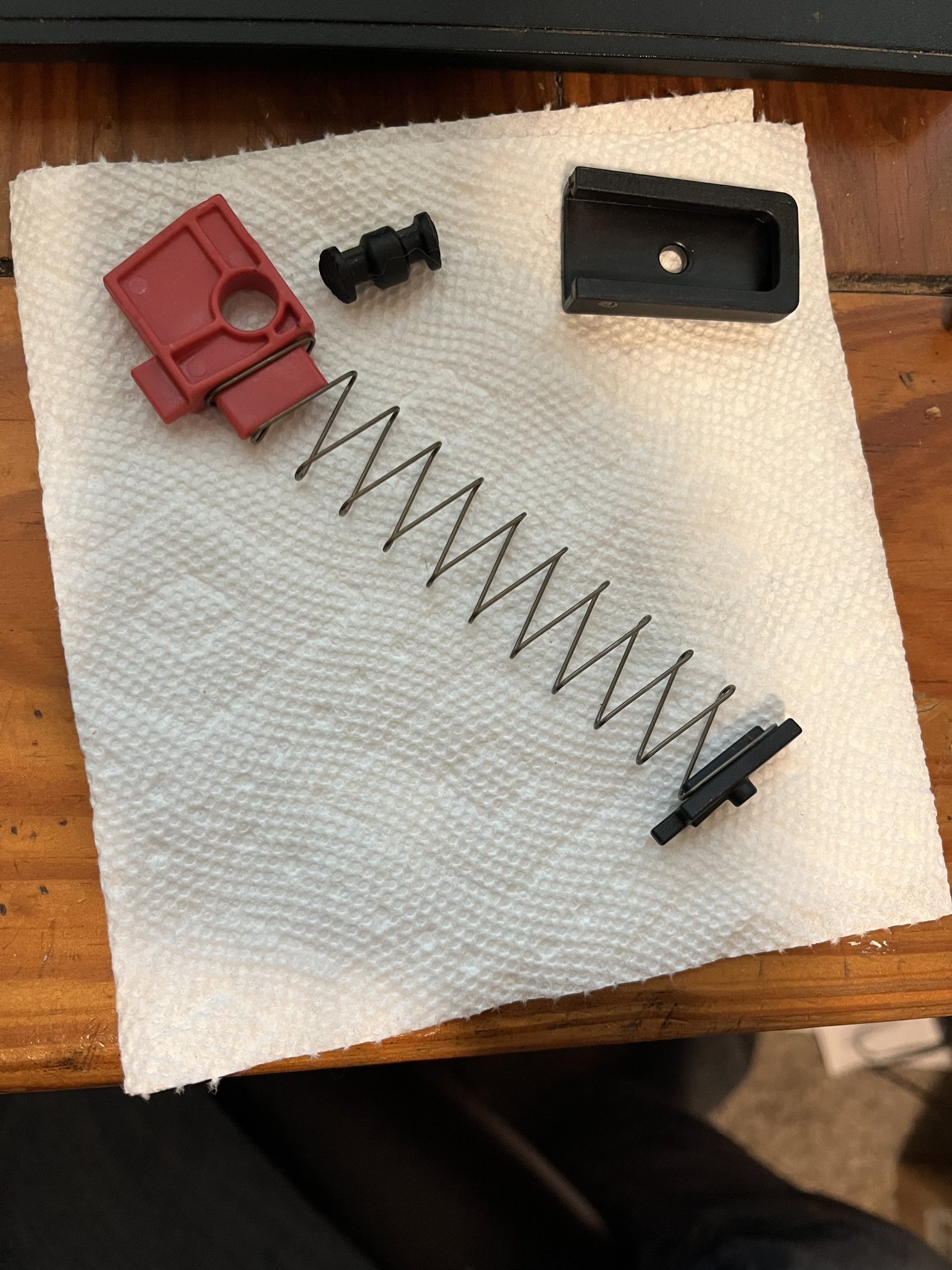

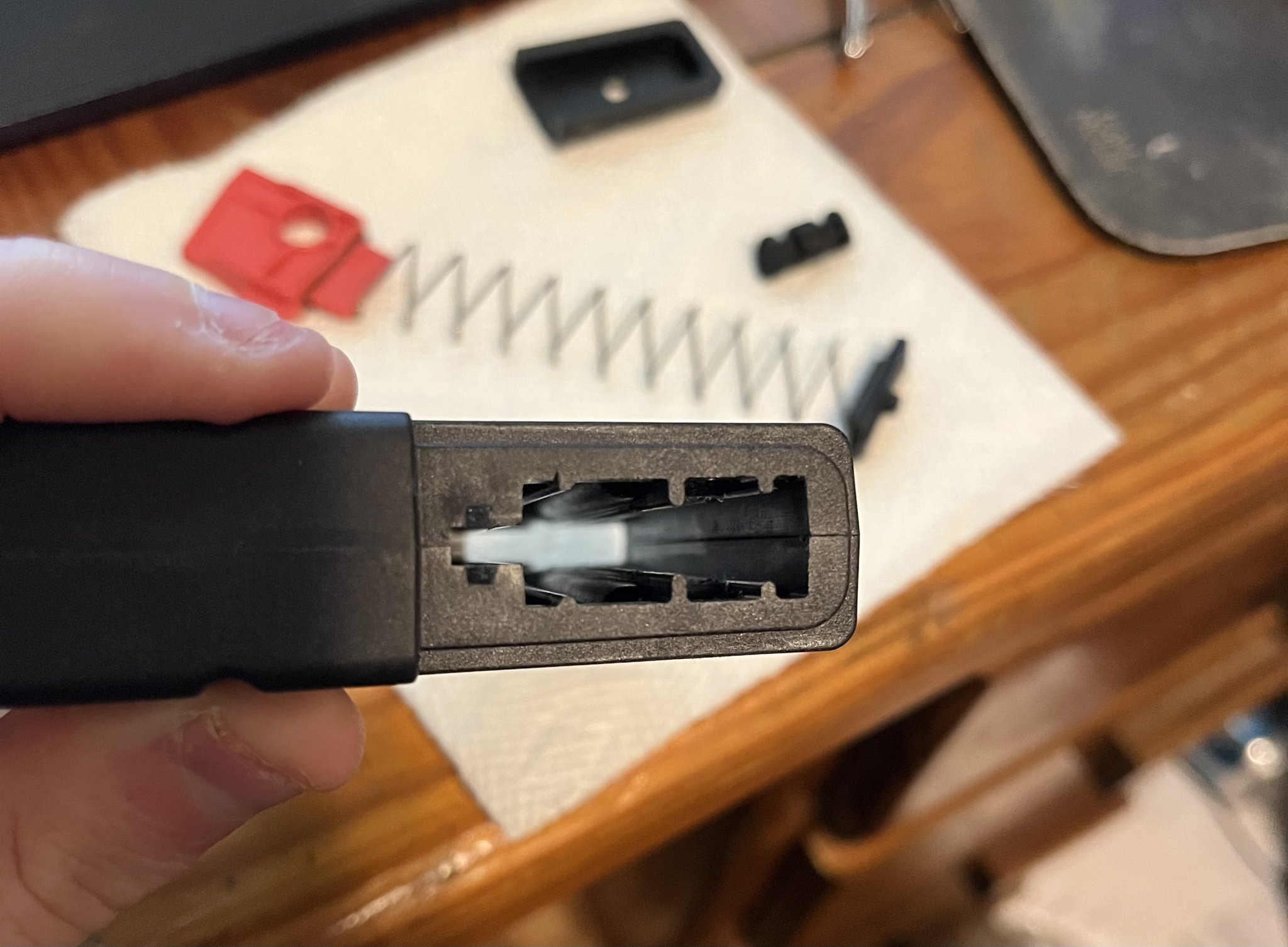

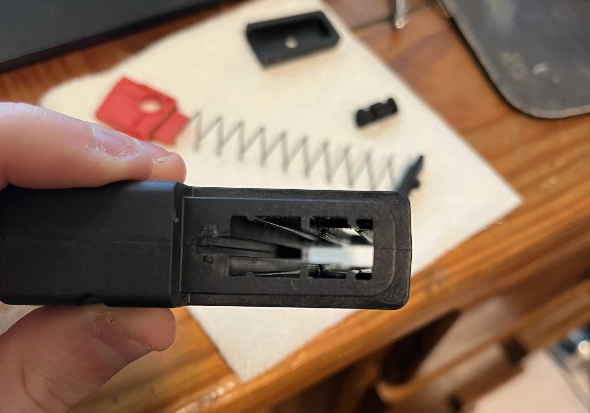

Looking at the guts of my knockoff Vudoo mag, the follower has a tab that rides in a vertical slot in that rear spacer, plus that little button that slots through the follower and lets you pull it down without pressing rounds down on top of each other. That'd be a nice feature to include, although certainly not necessary.

LOL, I don't think you're making the point you think you are. The history of developing the 40X rimfire mag and how it became the Vudoo mag didn't happen last year. It took a long time, wasn't accomplished by the home hobbiest, and still remains the weak part of V22's and somewhat the RIMX. To say folks are happily running these rimfire mags is a bit disingenuous. People struggle with them all the time. Factory solutions. Struggle bus.
Ok, fair point, they haven't been flawless, and yeah, a lot of design and trial-and-error went in them. Should've mentioned that, rather than making it sound simple and effortless.
Still, it'd be really cool to see a mag like this, it's gotta be easier to do with a cartridge that has a pointed, jacketed bullet and no rim vs a 22LR. Who knows, someone'll probably make it someday and fail to pay me all the royalties that are my due :ROFLMAO:

Cadex makes a specific M24 setup. Its a LA chassis with short action bottom metal. I had one along time ago and sold it like a fuck boi.
And cadex also have addtional bottom metal for short and long action and you can run a 223rem all the way to any long action caliber with the right sleeve and bottom metal.
