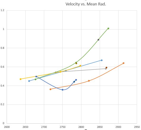

Firstly, I haven't seen evidence of an optimum velocity for dispersion.
Each different colored line is a different powder. All of this data is the same bullet in the same barrel at the same seating depth. Each point/dot is a 20-shot string worth of data. Left axis is mean radius at 200yd, bottom is velocity in FPS

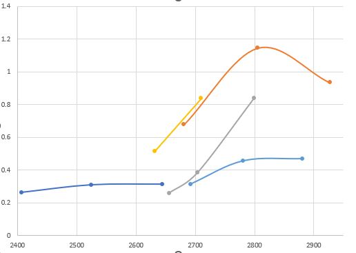

Here's a similar graph in a different cartridge with a different bullet

So the general trend that I've seen between these tests and many others is that the lower the velocity/charge weight, the lower the dispersion. However, as you can see some of those trend lines are very flat and the functional difference between them is very small. Often times from a hit probability standpoint, a slight gain in mean radius is worth the 200+fps gain possible over the spread of safe charge weights... Conversely, sometimes a 100fps hit in velocity is very much worth the help in dispersion that results.
Anyway, with that basic supposition removed, and with some anecdotal experience of mine, I'd say NO, you can not expect to swap from a 140 Berger to a 140 Hornady and achieve the same results. From a safety standpoint, I would always suggest dropping charge 10% and starting over if you're anywhere near the top of book data. The idea that they're the same bullet weight so they'll have the same pressure/velocity is also not necessarily true. Bullet weight is one of the main contributors to the pressure created, but another huge part is the length of bearing surface and yet another part is bullet rigidity. You can get 10,000psi difference easily between two different 140gr 6.5mm bullets with the same jump and powder charge. One bullet is fine, the next one blows a primer if you're on the edge to begin with.
What I have seen, and what I suspect you will see if you care to test it in-depth, is a distinct and different level of performance between the two bullets with the same powder and charge (assuming both are safe loads). You may need to try different powders or a different charge weight to get the 140 ELD-M to the same level you currently have with the Berger, or it may very well shoot better right off the bat. You won't know until you try it out.
That said, 140gr ELD-M with 41-41.5gr H4350 with a .020-.040" jump (pick a number in there, they're not sensitive), is a good starting point in a 6.5 Creedmoor.

Thanks Ledzep! This is a super informative graph. As I've responded before, I was expecting this response in general, but was hoping to get lucky. Also as you've pointed out, looks like I was on the right track in saying the difference in bullet shape would change the seating depth, pressure, etc etc. Now 10k jump in psi? Wow! That was not something I expected.

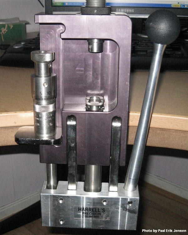

Take an arbor press and inline seating die to range. Get a bunch of capped vials like pictured below. Fill enough vials with powder charges to test seating depth.
Load your initial powder charges and such, then use that data to decide what vials/charges to use and seat them in an arbor press.
Just takes a little logistic planning and you can take everything you need in one trip.

Rio why the Harrells?
Doesn't matter which. That's just the one I could think of off the top of my head. There are numerous presses made for a bench at the range.
Hell, if you wanted, you could weld up a platform that goes in your trailer hitch and mount your favorite normal press to it. Or mount a normal press on 2x6's long enough to span the bench and then use C clamps to hold the 2x6 down.

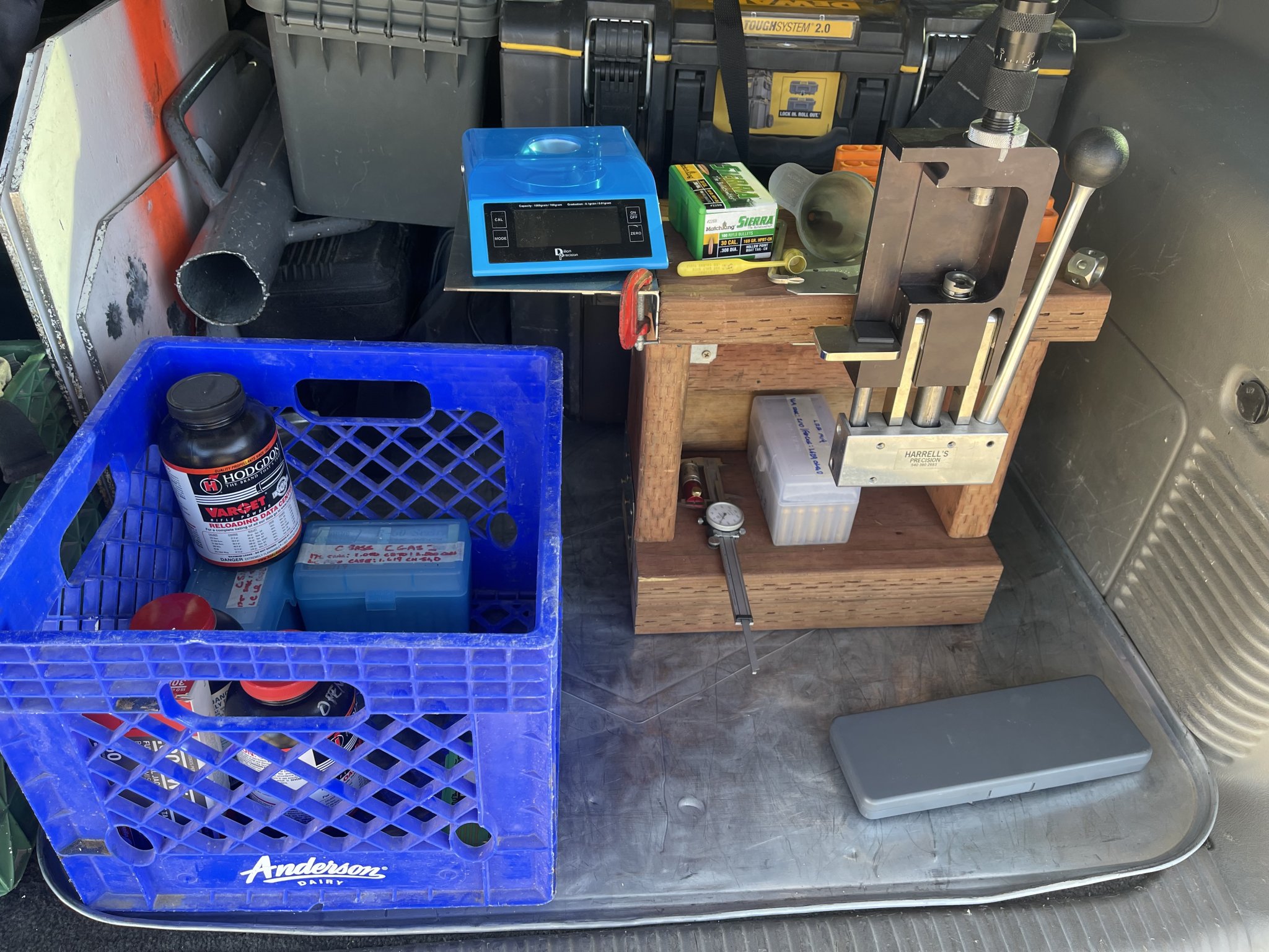

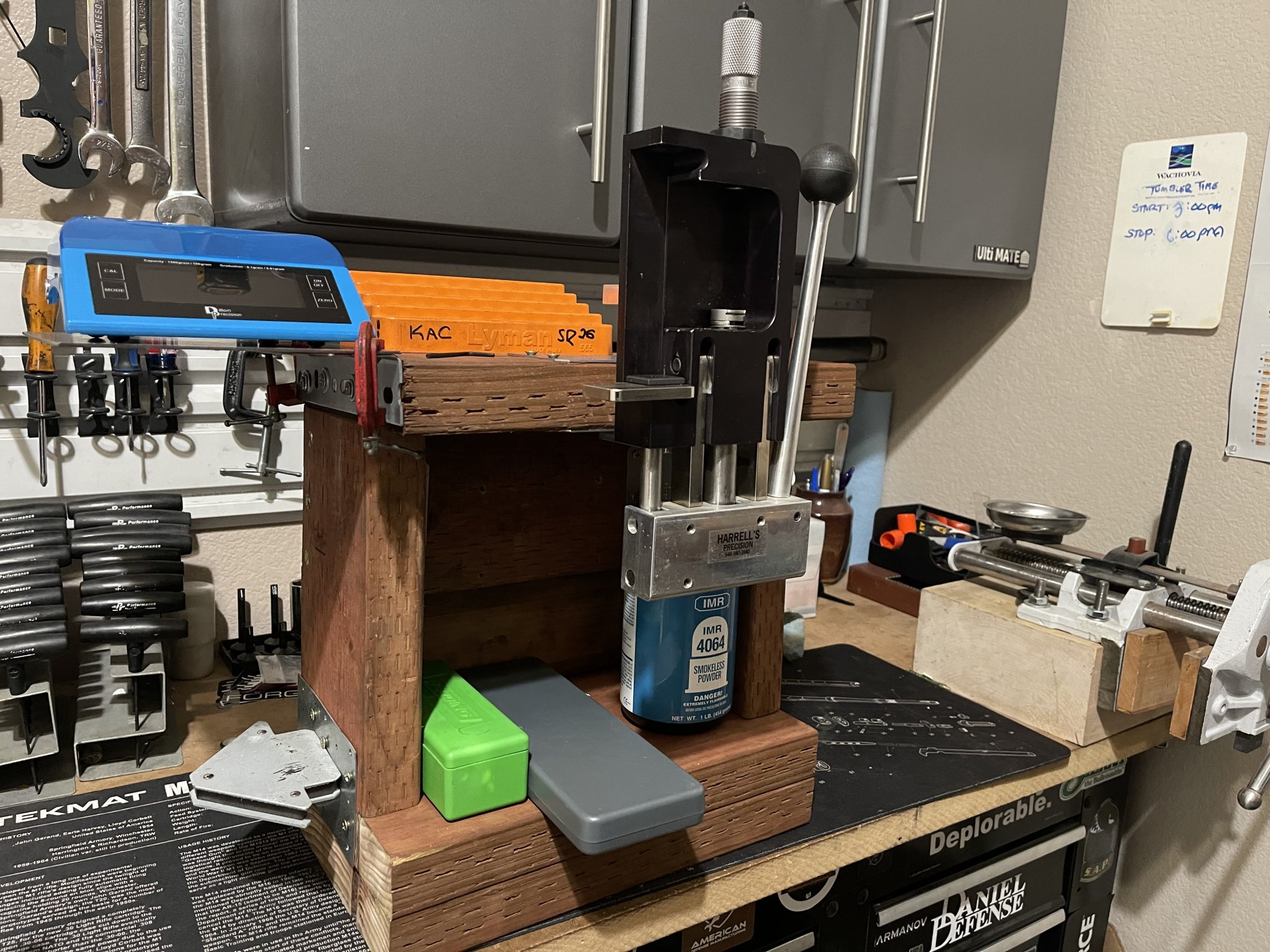

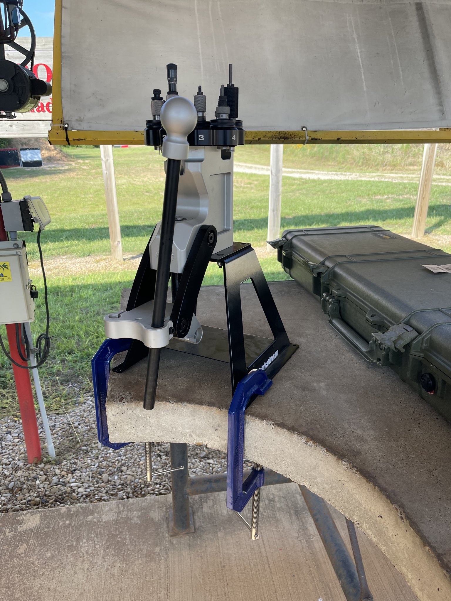

The Harrels press is great for loading on the go... I take it along with the rest of my mobile reloading kit to do all my load development/testing/adjusting at the shooting spot. Saves me from making multiple trips and I can usually arrive at a final load for a given rifle that day...I size, prep and prime all brass ahead of time and just charge and seat at the spot, for efficiency...
Here's my crude but effective set up.
The Zero is nice but I can’t say for certain I would buy again. The T-7 is a pretty impressive unit itself and I still use it for .260 and 45 Colt instead of changing heads on the Zero. Yes, the .260 is precision ammo. I wasn’t compelled to change.
Reactions: BoltBandit

Ledzep, thank you for your research and data sharing.
In first your picture it seems that goup is getting bigger at 2750fps, and in second at 2650 (with a lot of imagination :).
Can we have a theory that group is getting bigger after certain bullet's rpm=spinning?
Likely it’s because when you push things faster there’s more forces imparted on the bullet, which exaggerates small issues on the internal, and external ballistics side. Based on the graph, the small issues on the internal ballistics side get exaggerated a whole lot more than the external ballistics since the type of powder has a much greater impact on whether it gets worse then not. Based on that, I think it probably has more to do with the barrel/bullet interactions and how the powder burns at higher pressures, then anything else.
