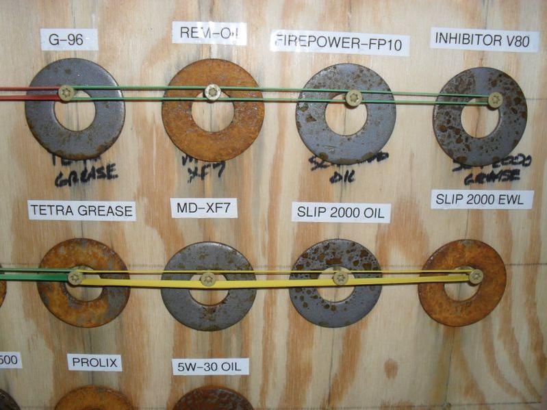

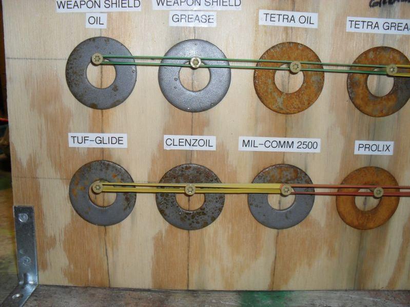

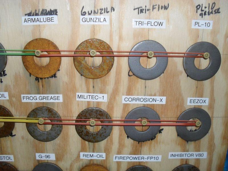

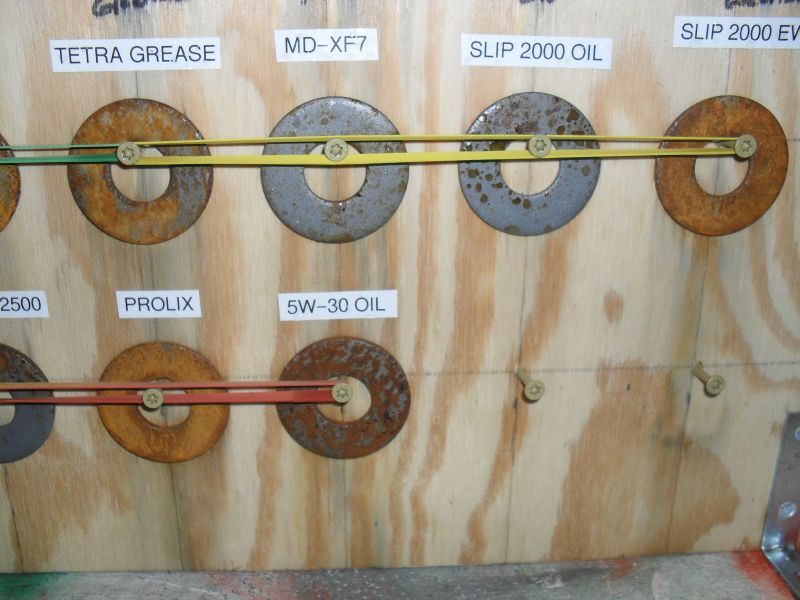

There was an interesting experiment last year from one of TOS on corrosion resistance of many "wonder lubes" out there vs some common ones as well. It seemed as though some pretty good controls were used and these are the results after just 5 days of exposure with daily salt water misting:
Link to the thread: Corrosion Testing (New Pics - 5-08-12)
Just a test of corrosion resistance, but good info nonetheless.
