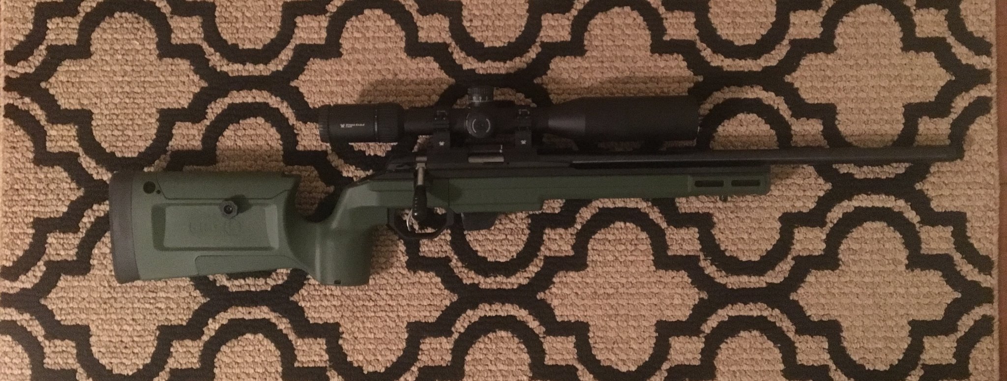

T1X with Sterk, Bravo, and Elay Precision Spring for 1lb trigger.
T3X with Sterk, Bravo, Timney (8oz 1st stage, 8oz 2nd stage)

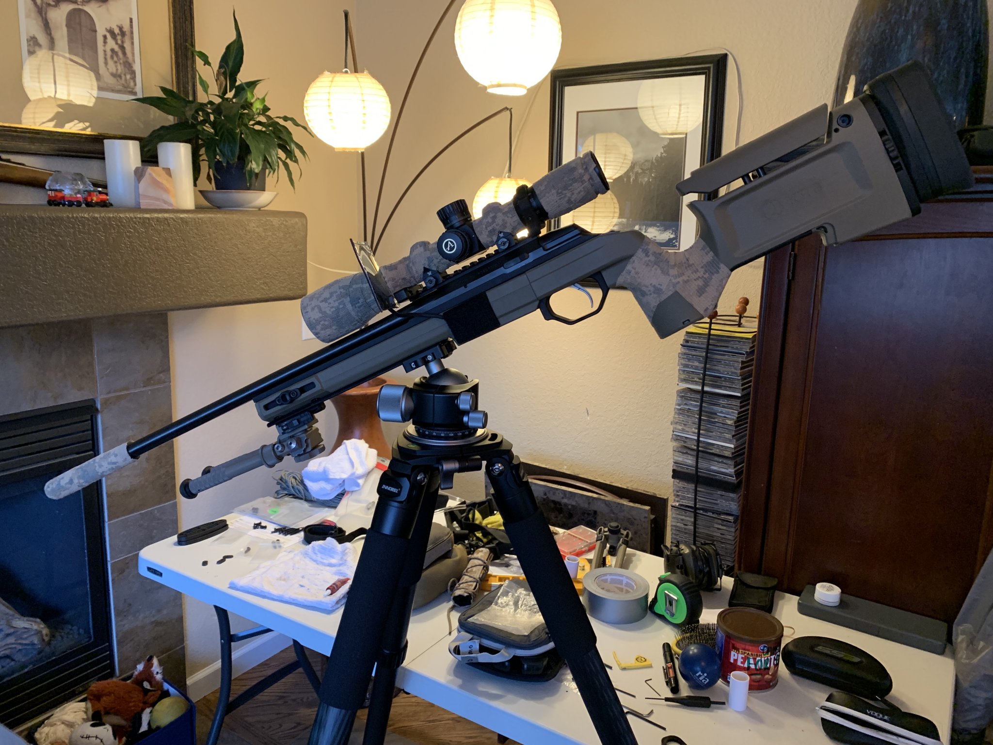

PS - I originally was thinking of going Sako Green and interchanging the cheek piece cover and butt-hook cover with my black Bravo, but that FDE keeps capturing my eye. Good looking rifles! (y)

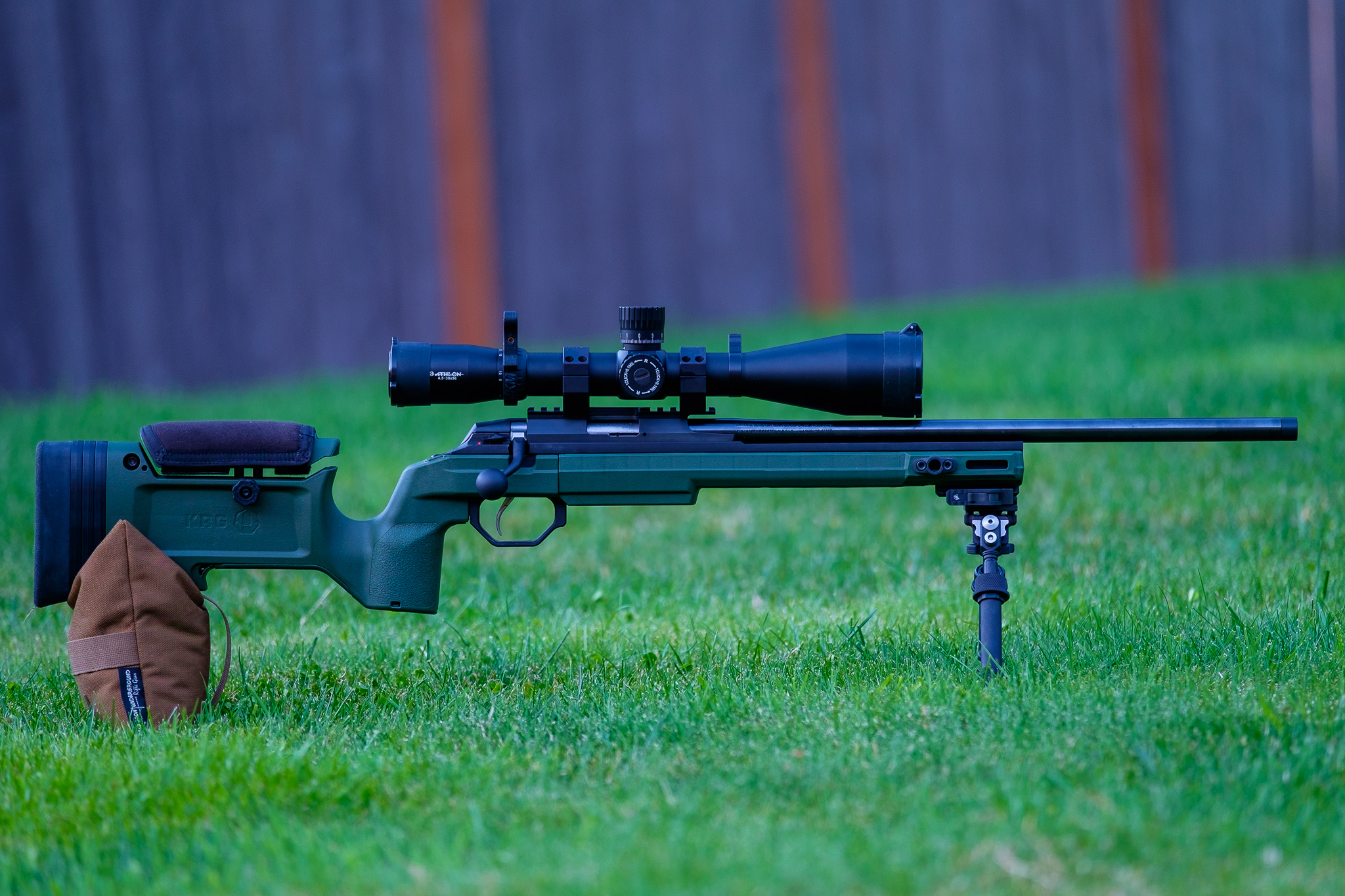

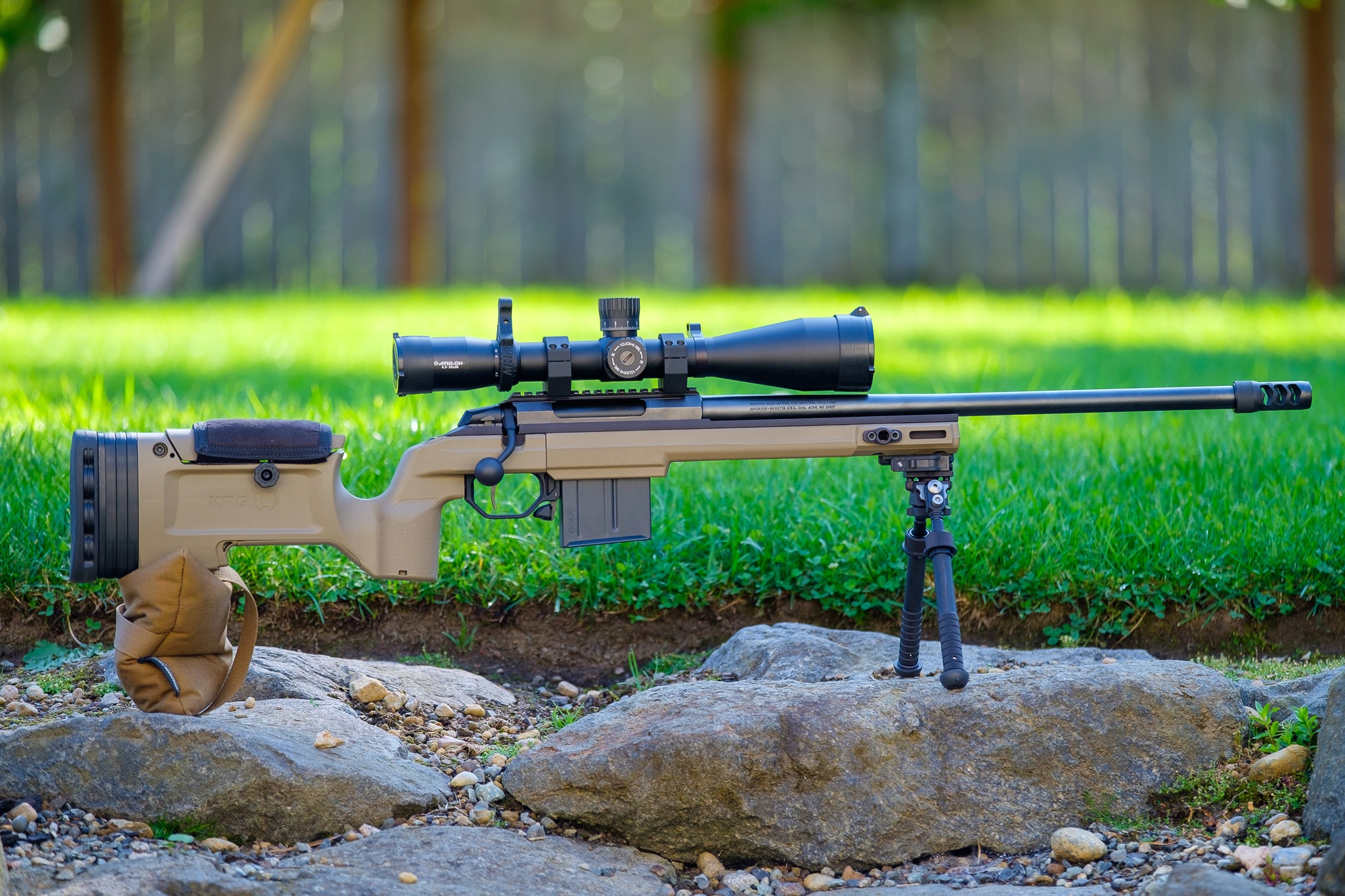

This is a sweet looking rig! Whats the build list
Tikka T1x .22lr 20" barrel
KRG Bravo FDE chassis
KRG ARCA rail
KRG tool-less buttpad
KRG hook cover (black)
Magpul M-Lok QD
Sterk swept bolt handle
Sterk bolt shroud
Atlas bipod in FDE
Thunder Beast 22 Take Down supressor
Athlon BTR 4.5-27 Aplr3 Mil in Vortex rings
Area 419 30 MOA rail
MK Machining Scope lever and level
Sidewinder DOPE card holder
Mtn. Tactical trigger spring. (1.75 lbs.)
I have a KRG spigot mount that I'm debating on its use.
Timney 2 stage trigger TBD. ?

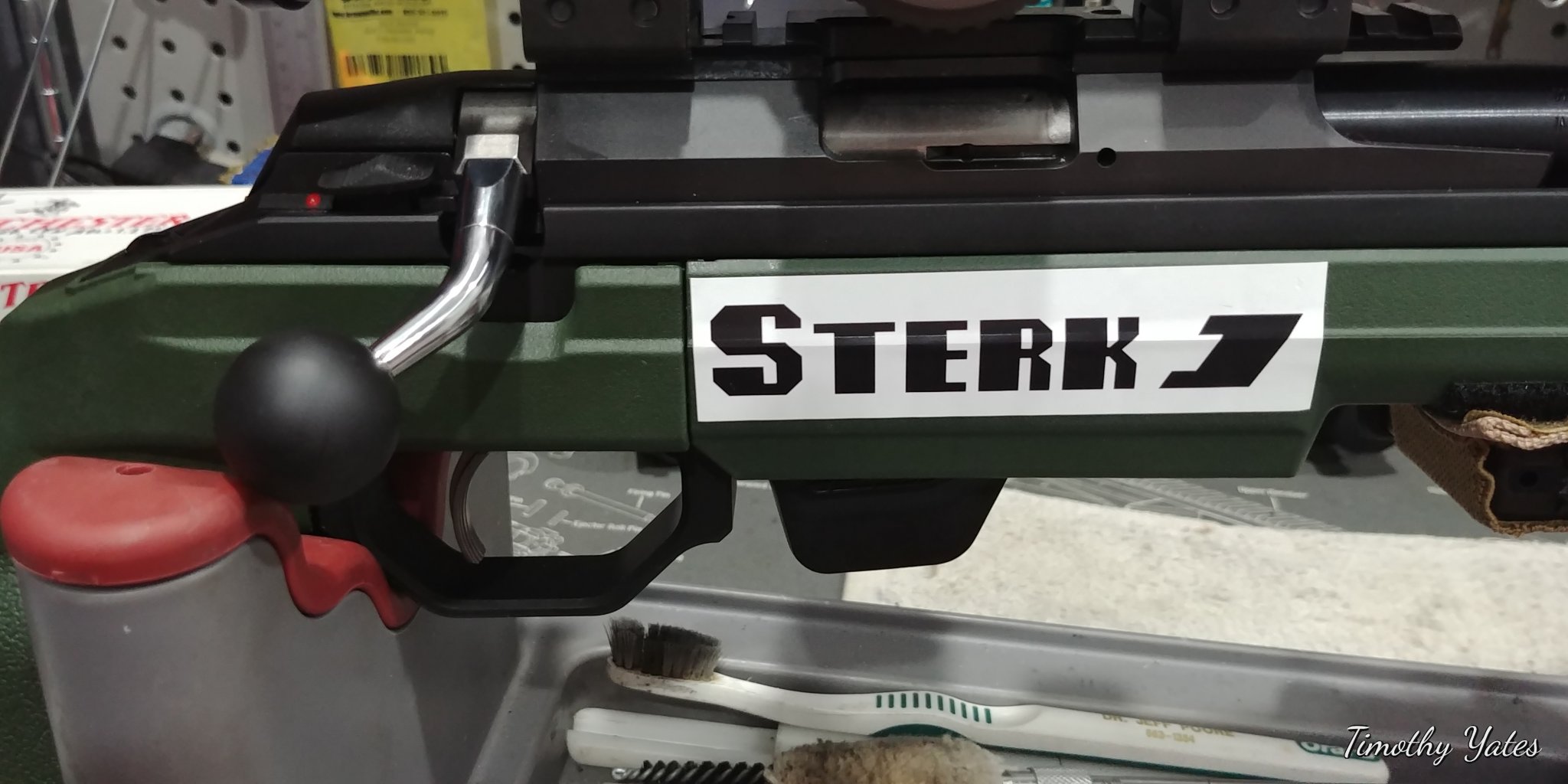

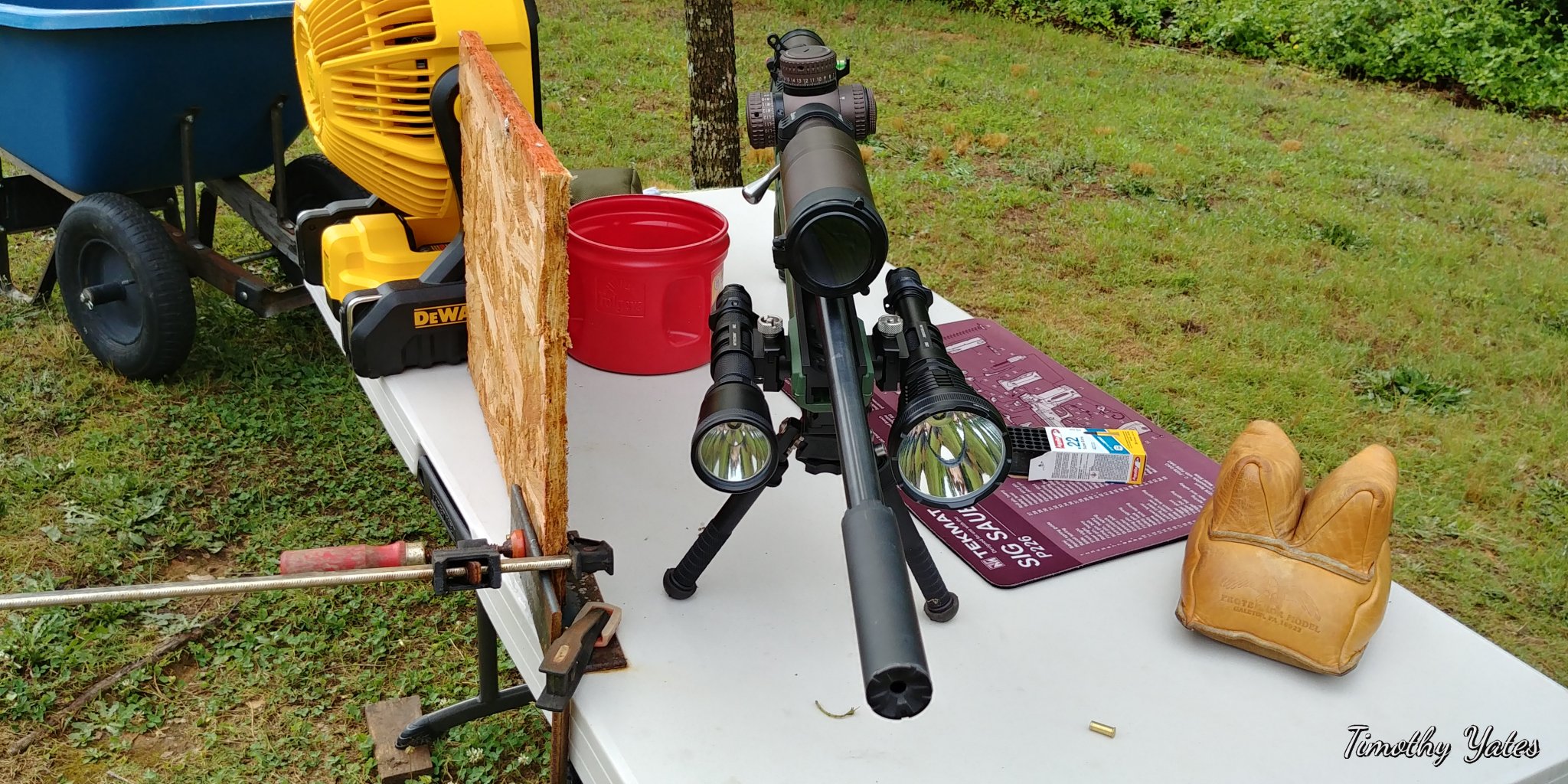

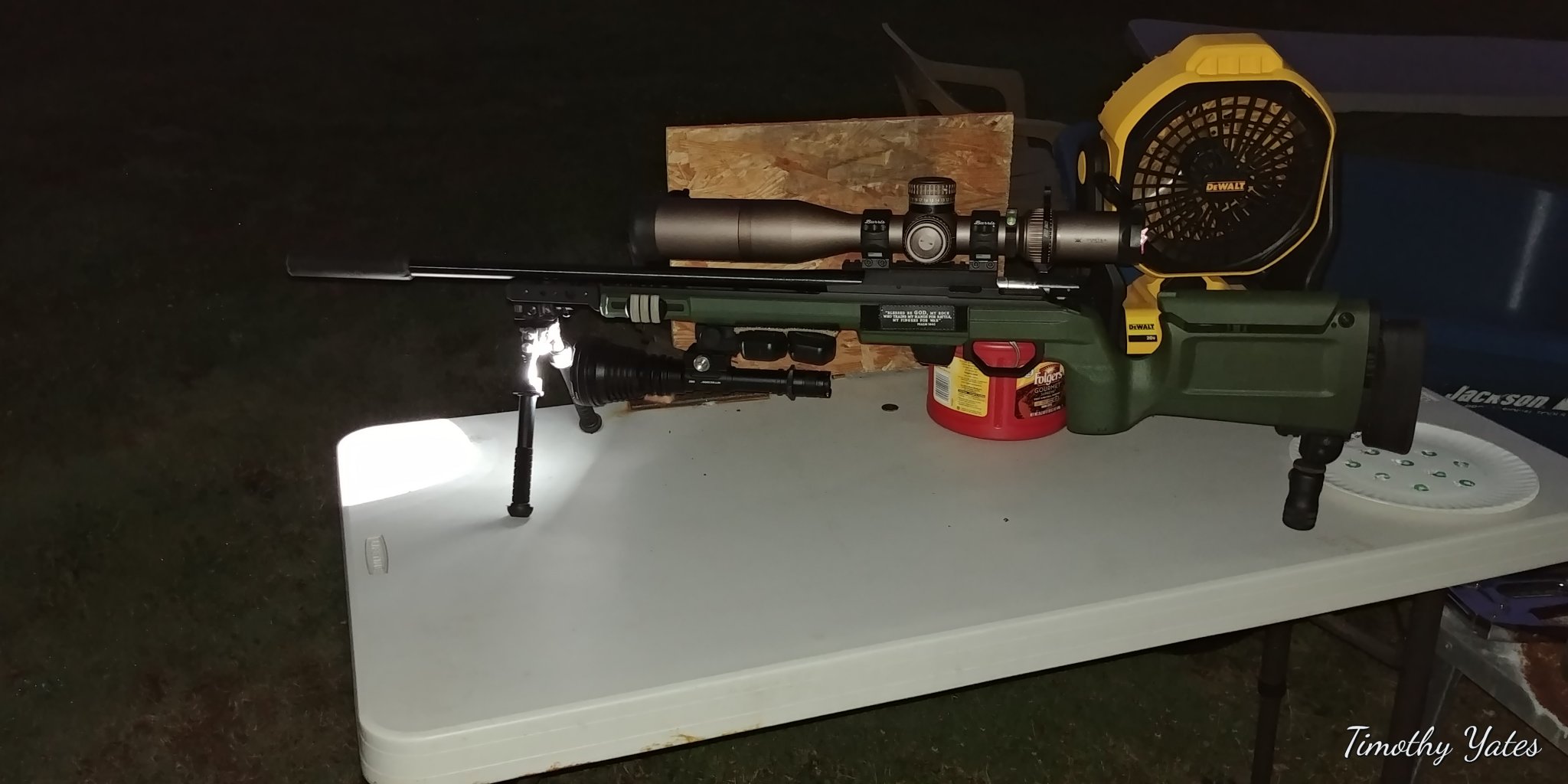

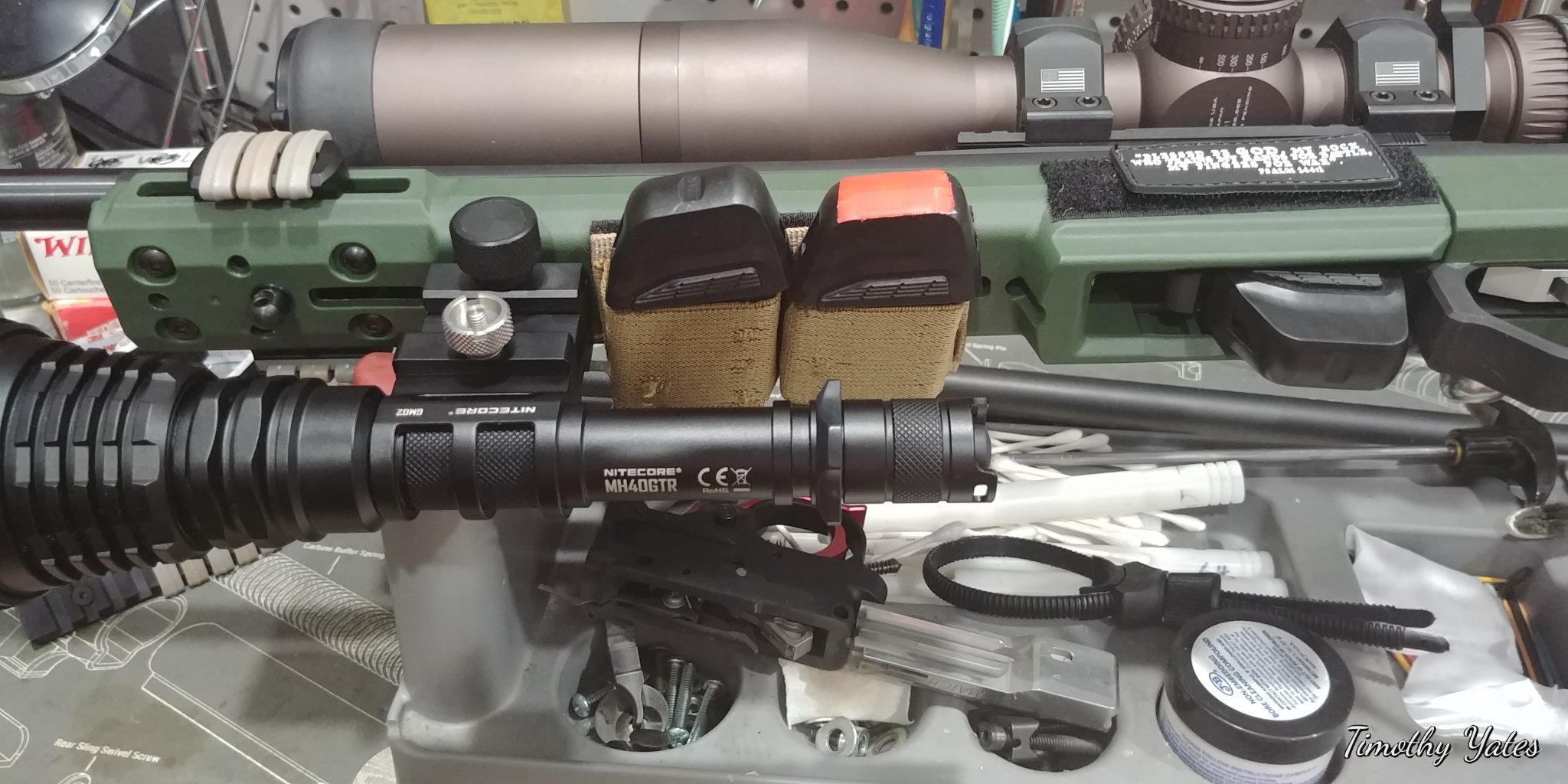

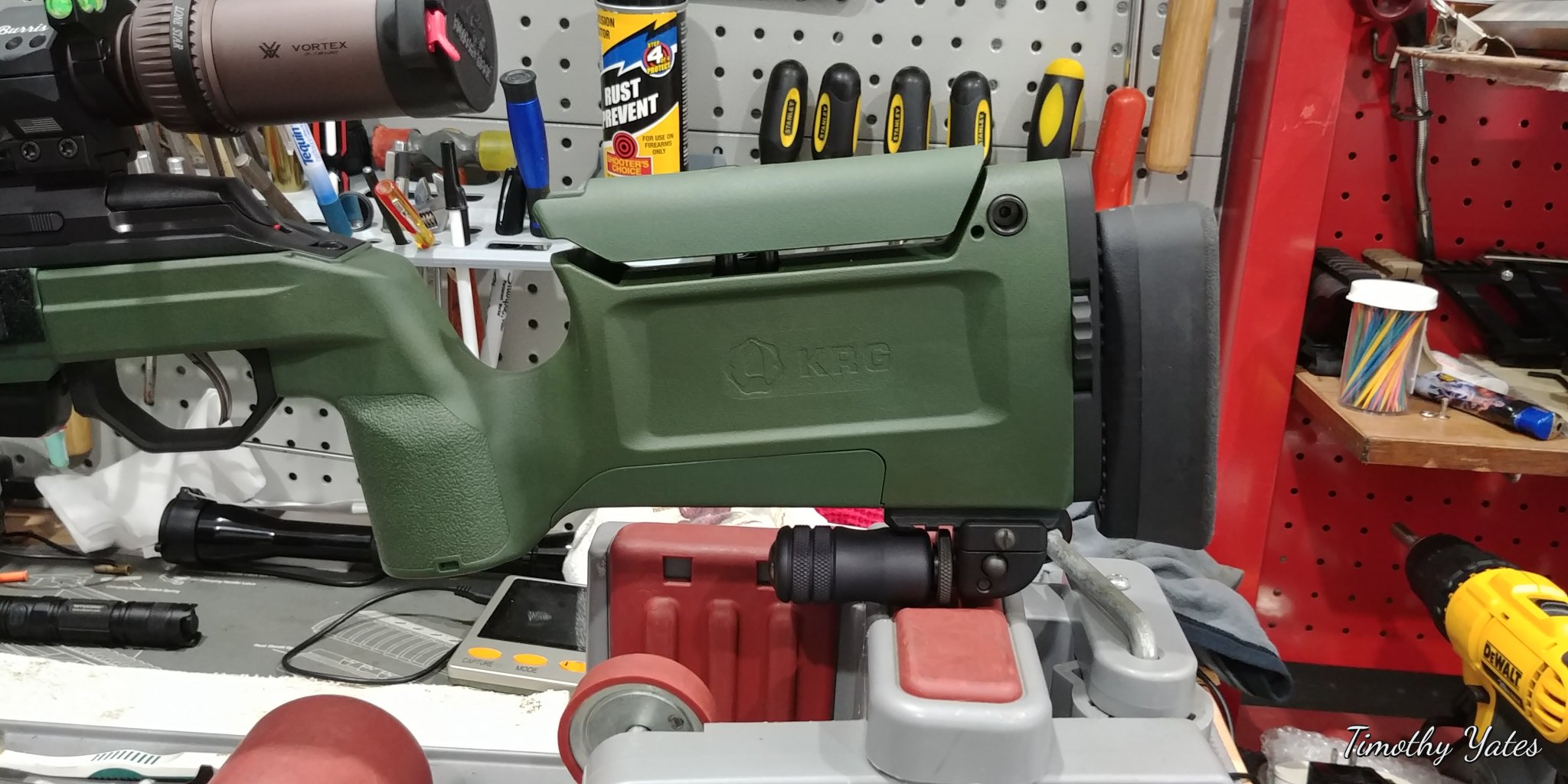

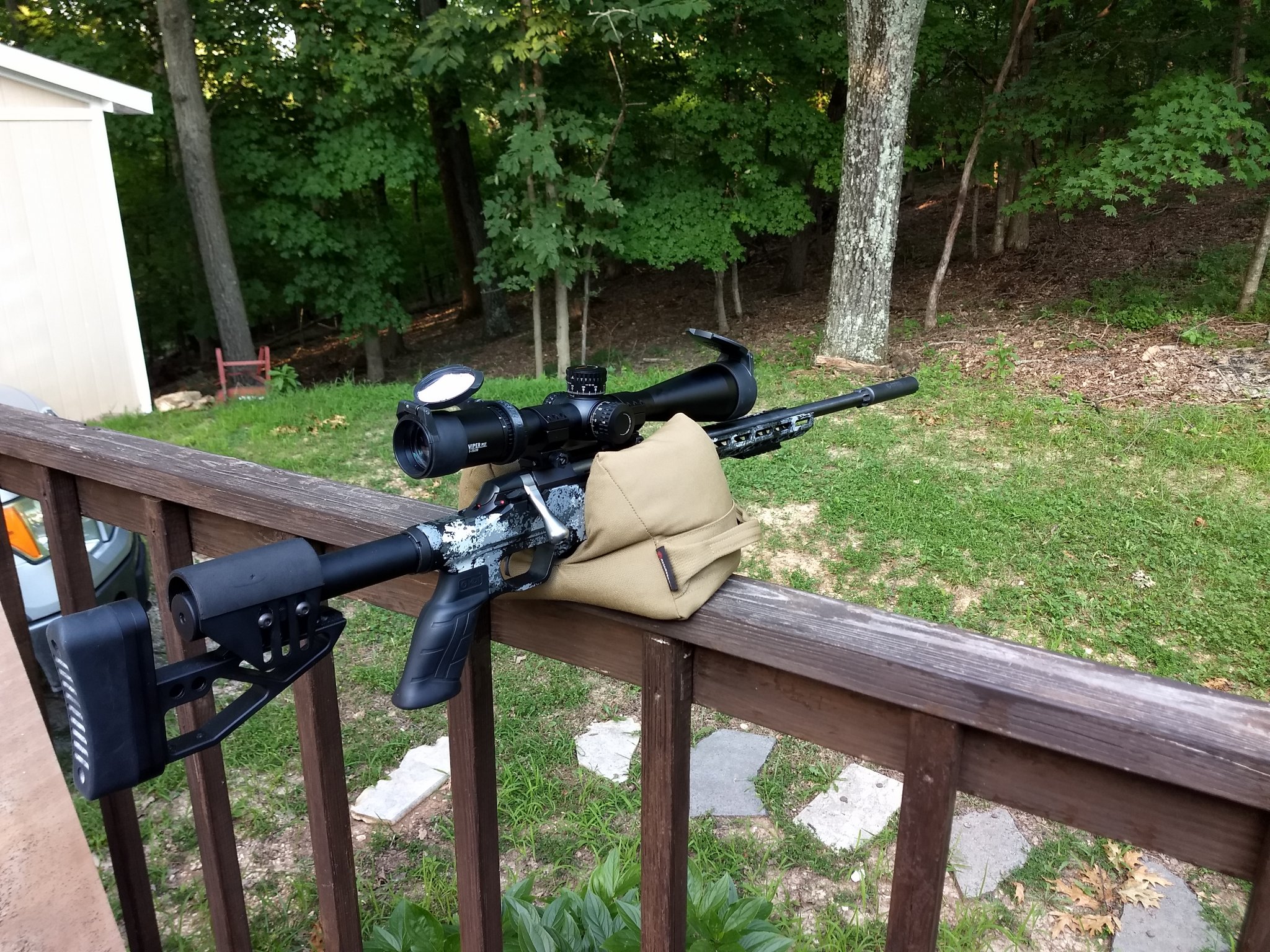

Here is your T1x upgrade options.
First off, Sterk handle, if you ain't got a sterk....well hell, you just ain't got a Sterk. LOL ?

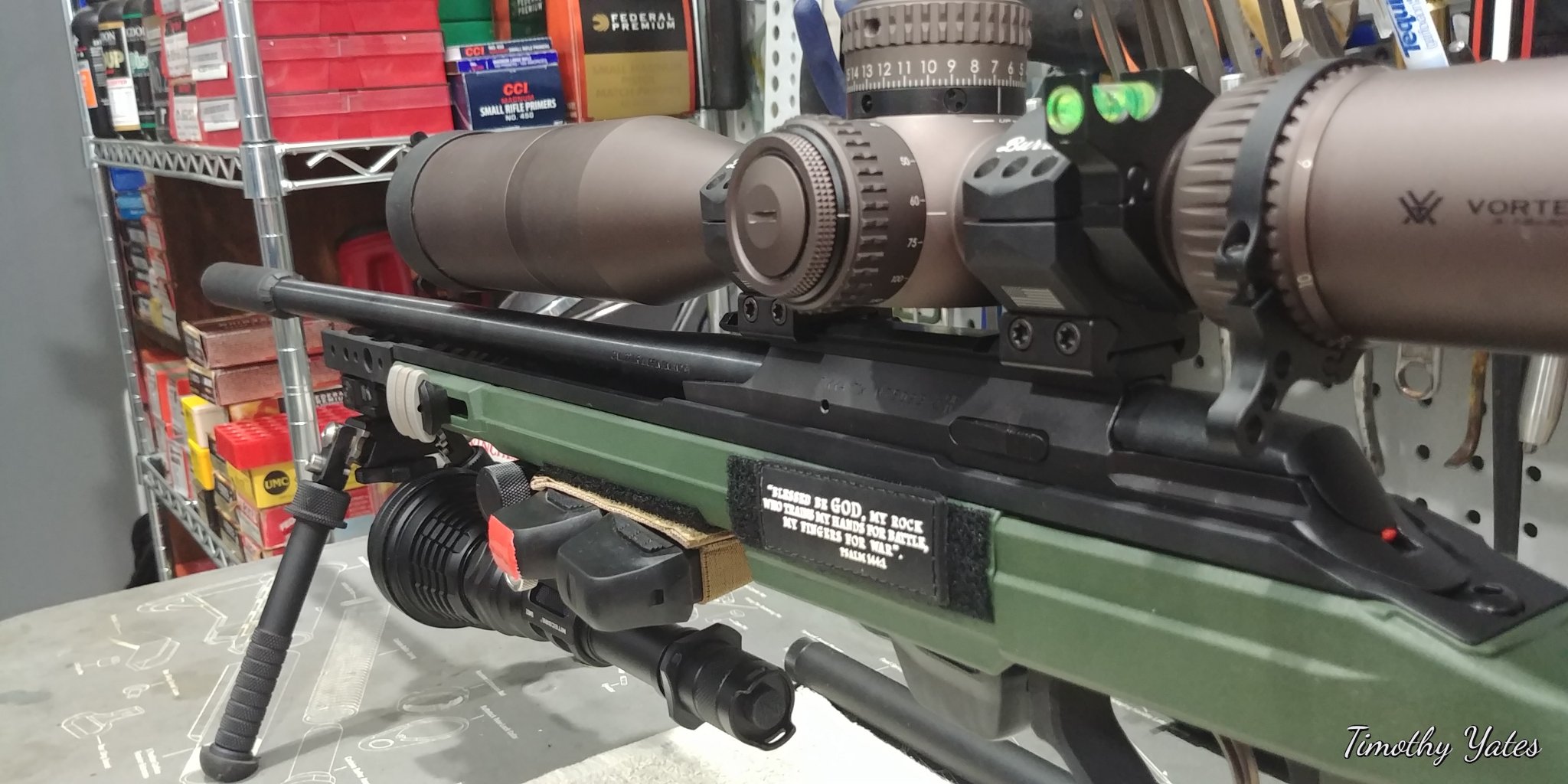

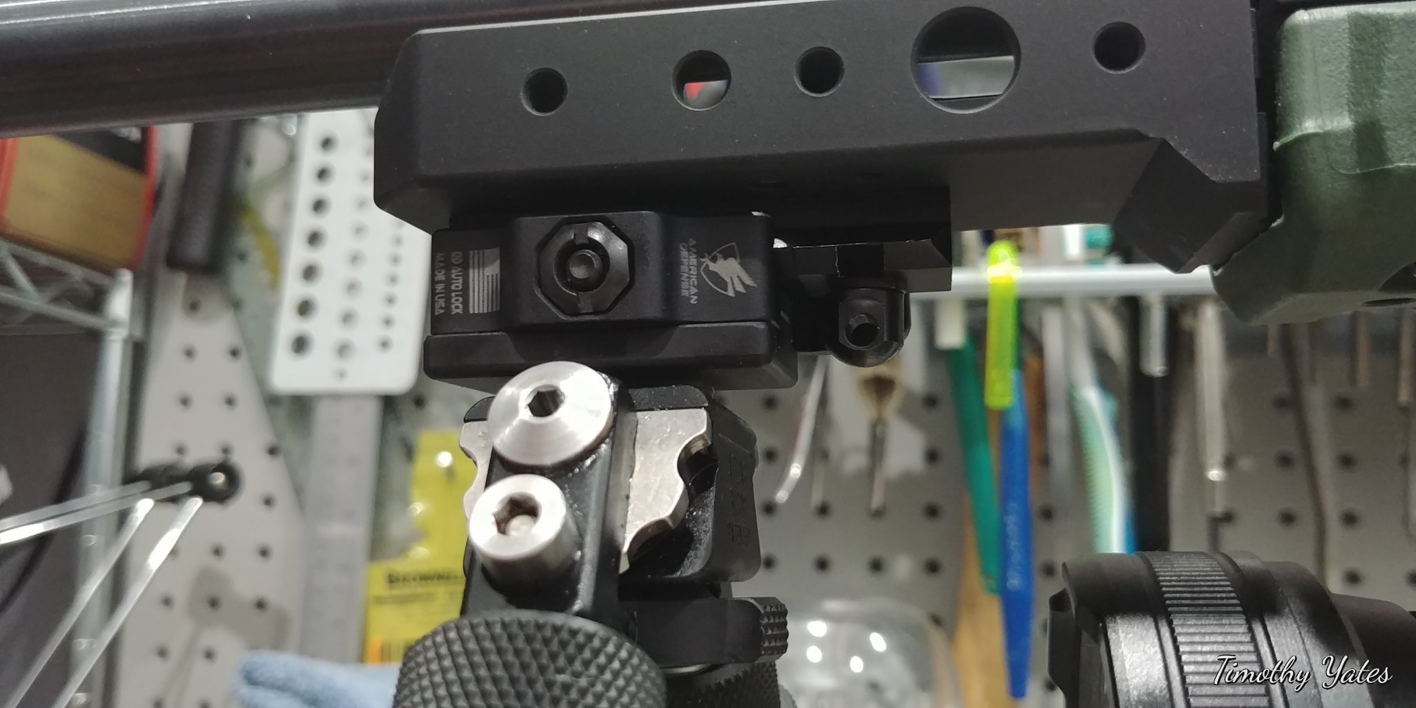

Next you got to slip it in a KRG Bravo and doll it up with a spigot mount to get a nice extension on the fabulous Atlas Bipod. Made in Merica baby.
Long necks, short necks, broad shouldered, bent shouldered or whatever else makes you look like the hunchback of ND you can be fitted with the adjustable butt pad. Just another KRG specialty product that just feels right.
Don't play around with GLASS on a 1st CLASS rifle. Wrap that baby in some Burris Sigibaby rings under a (take your pick) 20 moa rail and you got yourself a 60 moa possibility situation here. Can you dig it!!
Do you carry your ammo in your shirt pocket? Hell not we ain't no Barney Fife. You got to make a custom mag holder.

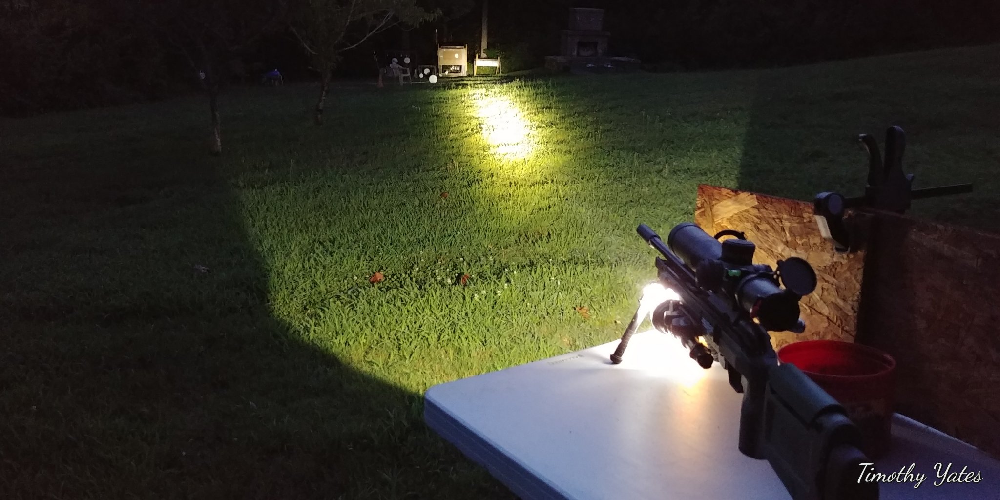

You got the room baby, why not add a spot for some daylight at night.
If one ain't enough but two on. Turn night into daylight my little grasshopper.
Hey homie, did you hear that? No bro I didn't hear nuffin. The Sparrow...they never know what hit'em. Dang, that sounds like a commercial. Anyway when you roll it all up and let go out pops a......drum roll please.......
The Night Stalker! ?
Please drink and shoot responsibly.

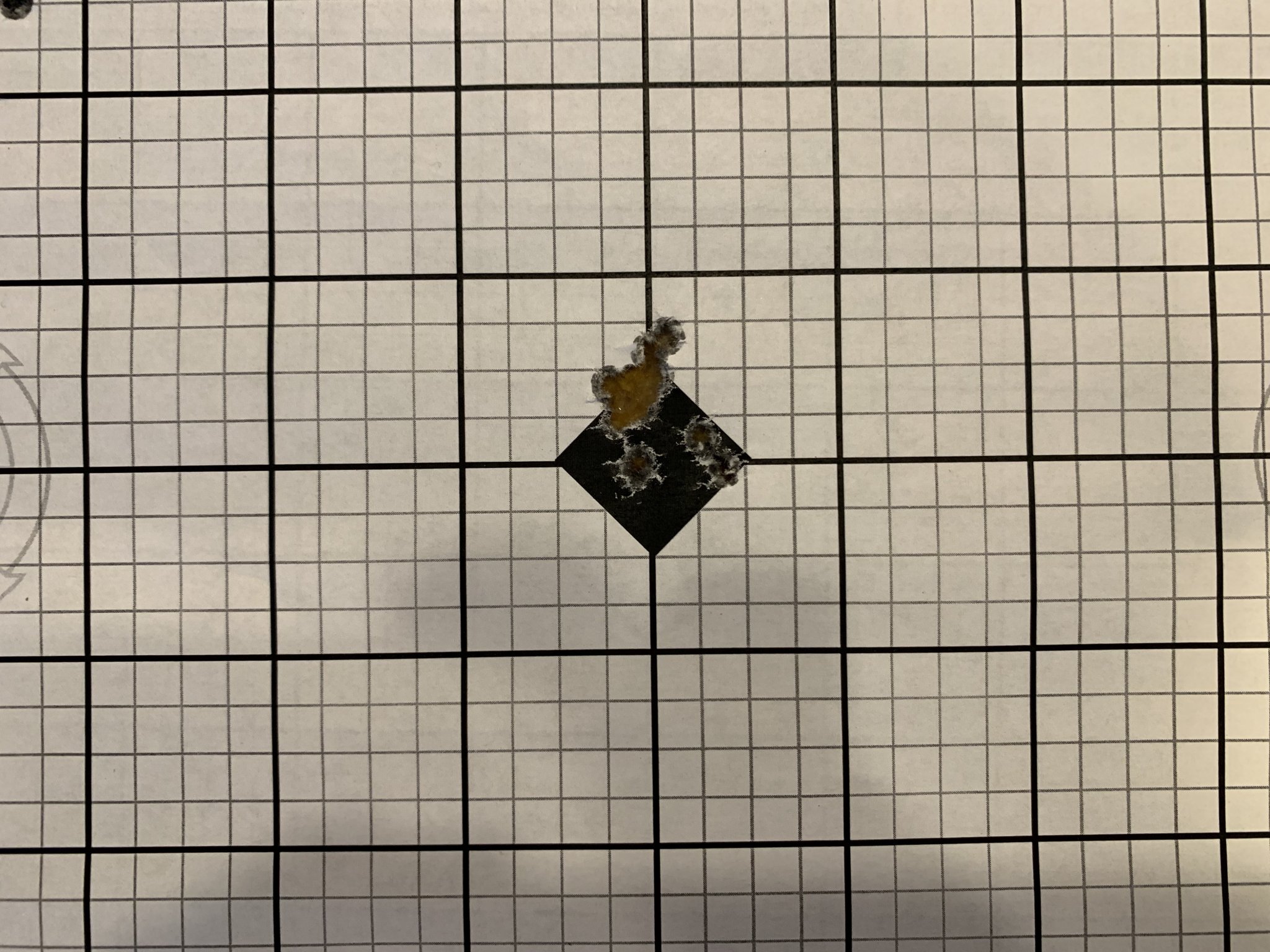

It shoots pretty good too. Lapua Center-X @ 100 yds. Cherry picked group, but still a group. 10 rounds at that.
Edit: While I was at the range I asked the 'smith to measure my trigger pull. 1.75 lbs. Was happy. ?
Still need to test more ammo.

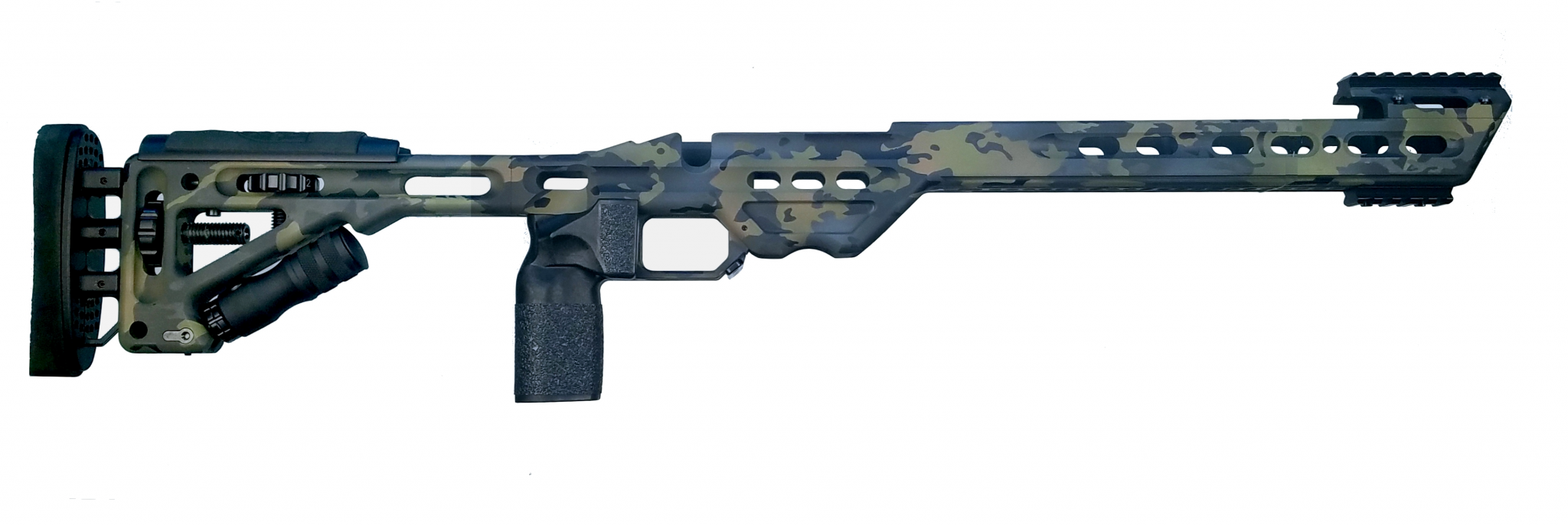

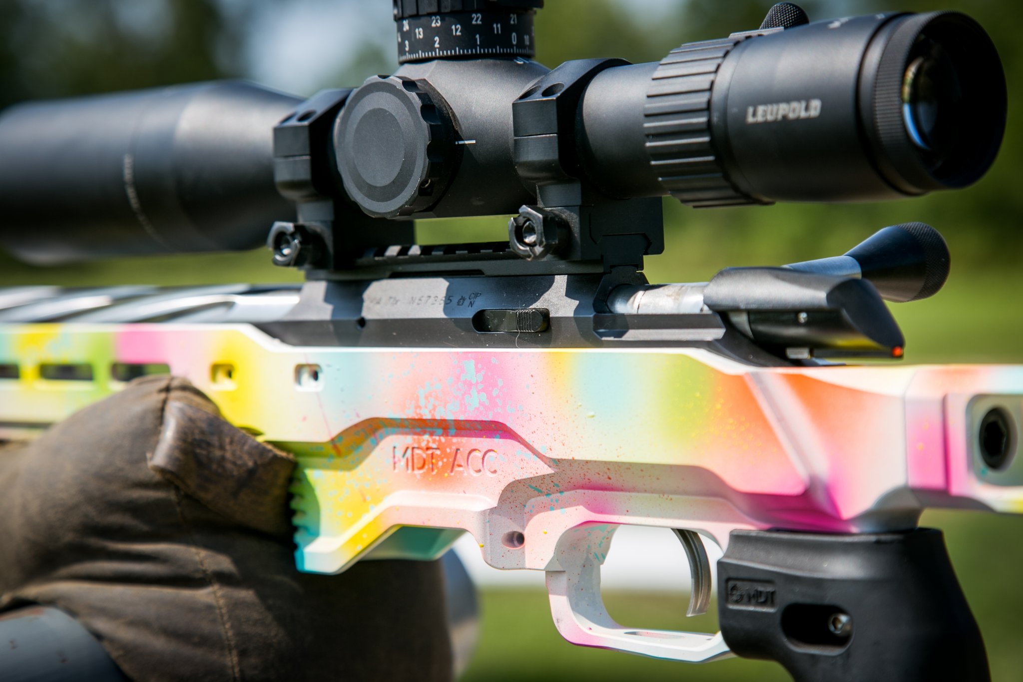

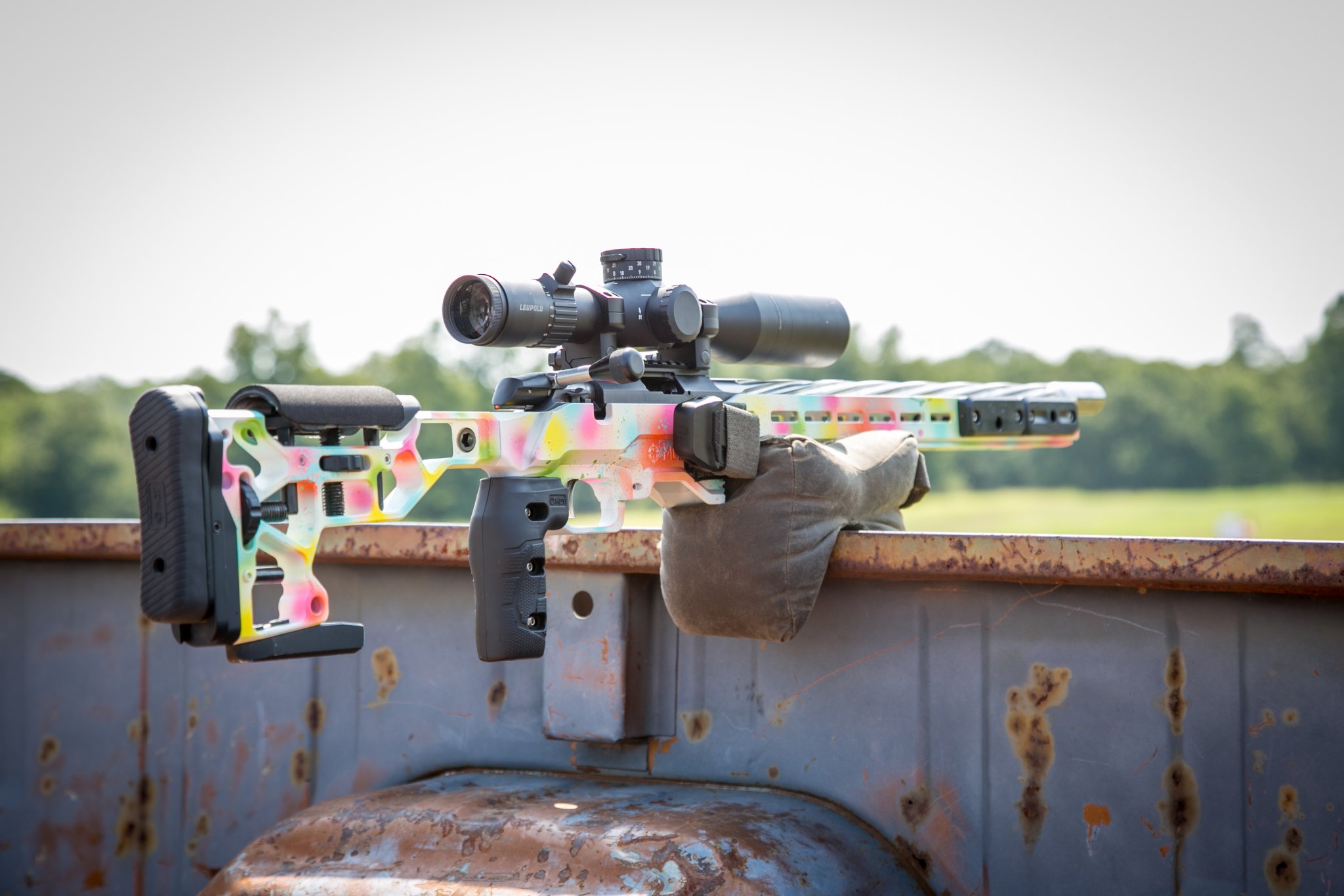

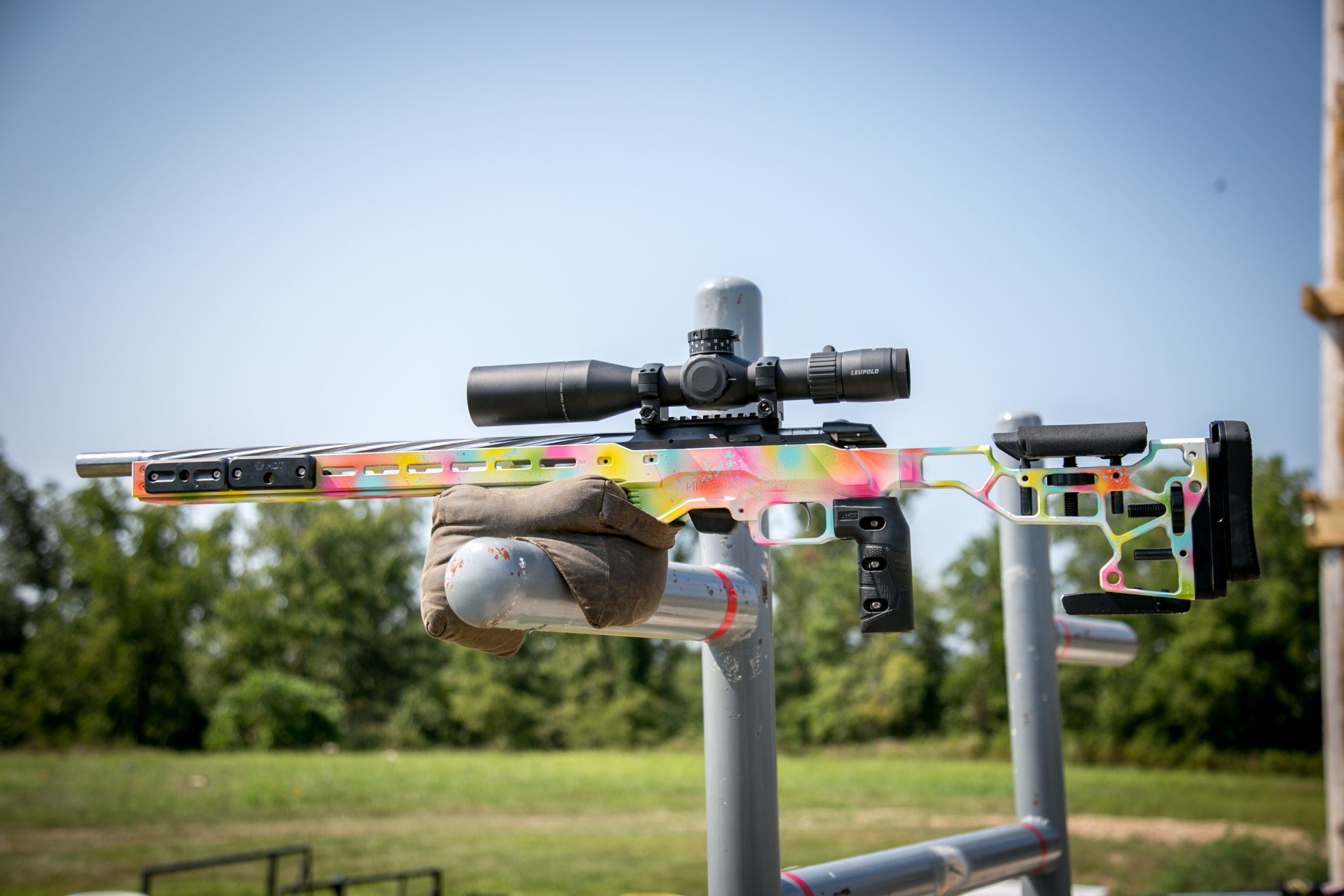

@3guns2hands ..... that fabulous!
No seriously.... I like the paint. Not my thing, but I like the uniqueness. Done a buncha cerakote jobs lately (well, got someone to spray some cerakote for me) and am thinking about getting a real artsy one done soon.
Like maybe...

Each square is 1"? That's an amazing 10 shot group. I need to try out a box of center-x... People claim sub-moa @ 100 yards with things like Eley Target, but I can only get sub-moa when using Eley Tenex, and that's just way too pricey to be constantly burning rounds on. Yesterday I was shooting Eley Target and getting random flyers... like 3-4 shots grouping, 1 shot randomly low or randomly right. Very odd. I thought man maybe something is wrong with my rifle / scope. So I put in 15 rounds of Eley Tenex just to see, and 3 5 shot groups all < 1".
Also on a cold bore with my Tikka, I usually get a .2mil up shift POI. (.75 inches high @ 100 yards).
I'll see if I can bum a box of center-x off someone at the NRL22 match tomorrow to see.
I'm curious how swapping to a Lilja barrel, or any other match barrel will turn out. Another $300-500ish investment in a barrel. This also puts the Tikka @ ~$900ish. I guess still a $9000 cheaper than a Vudoo.
Each larger darker square is 1" square. Each square is ¼" ?
It was cherry picked my friend. I had many random flyers on my other groups. I would say I was getting close to 1 MOA average. Much better if you exclude some of those random flyers. And they are 10 round groups. I'd still like to find a bit more consistency. Whether it's the ammo, me, or both. ?
I'll try and take pictures of the entire session for full disclosure.
Reactions: garandman
I did like 14 more 6x5's with Eley Target the last 2 days. I did 10 shot group and it wasn't pretty. At 100 yards, my 10shot group is usually like 2". It usually looks like 7 shots within 1", and then 1-2 shots .5inch low, and 1-2 shots .5inch high.
With 5 shot groups, I averaged 0.9" to 1.5" with the average of my 5x5 or 6x5 around 1.2". I'm curious what room for improvement there is - how much would I expect to improve upgrading to a Lilja / Proof Research barrel.

Please tell me more about the prefit barrel. Does the manufacturer sell into the US, how accurate is the barrel, how easy is it to install, what contours are available?
Being able to put a high quality aftermarket barrel onto this gun would make it darn near perfect.
international barrels is a canadian based company, permits are in the process of being approved to bring them into the US
the barrel is pretty darn accurate, SK rifle match holds .4" 10rd groups at 50yards and sub moa 5 shot groups at 100 yards (ill have to dig up some pics)
install was very easy.
1. heated up the factory barrel/tenon
2. removed old barrel.
3. installed new barrel with feeler gauges @ .042" headspace
4. tighten barrel set screws
5. shoot
not sure on the contours available, but this one is .900" all the way down and 22" long
Like maybe...
this paint job was literally the result of me telling the painter "i dont care what you do with it". and he did a fantastic job

I like them
DIP bolt handle - I like it over the factory bolt, better leverage even without the added curve of a Sterk
Area 419 30 rail - bought a 15 MOA rail first :(
Trigger spring - lowered trigger pull but may end up with an after market trigger later
Pic rail for bipod - mine has a flush cup built in
Flush cup on the rear - for sling mandatory stages
ODG Pistol grip - helps with trigger control over the regular factory stock
ODG Beaver tail fore end - feels better in the hand and adds material for the pic rail
(And) Then I bought an XLR Element chassis to match my 308.
Anybody want a decked Tikka stock and a 15 MOA rail for cheap? :)
John
Reactions: Just Chuck
Your decked out stock sounds like the one I'm adding to. Orange pistol grip on its way, DIP bolt handle and muzzle brake back ordered, DIP rail on board, added flush cups on rear stock and fore end. For now - I've decided to stick to stock - stock. Maybe later I'll make that jump.
@Just Chuck,
After adding a thicker recoil pad, length of pull was pretty good, then after adding a Vickers cheek rest, the stock was a pretty close fit for my body. The problem is that the stock is overall just too bendy - and maybe I'm still a bit ham-fisted with it too.
My Tikka was purpose built as a trainer for one of my other guns. I had a choice between a McMillan and an XLR as that is what I have on two other Remington 700 SA pattern rifles. For now, I'm shooting more .308 than 6.5x47 Lapua - so I built the Tikka similar to my .308/XLR.
Just as easily I could have built the Tikka as a trainer for my 6.5/McMillan - and I still may build another trainer, but if I do again it'll be a Vudoo in a McMillan, but I'll need to save up some more before I visit Mile High Shooting Accessories. Until then I'll work on finding another McMillan stock and a scope for the build.
IMHO, for the price - features - fit - adjustability - etc., the XLR is truly a great deal - and while there are other chassis systems out there, I already owned one so I knew what I was getting into with buying my second XLR Element.
Just sayin', but I really do like the Tikka! Just not a fan of the stock. Mine is pretty accurate. I've only had ~2 FTF issues and once I ran a boresnake down the barrel and across the feedramp, it again shot great (I've now gotten into the habit of running a boresnake at the end of each range session) - just recheck the cold bore shot the next time at the range and I'm good to go.
After adding the XLR, the Tikka trainer will be done. In the mean time, I'm still shooting it. A bunch.
