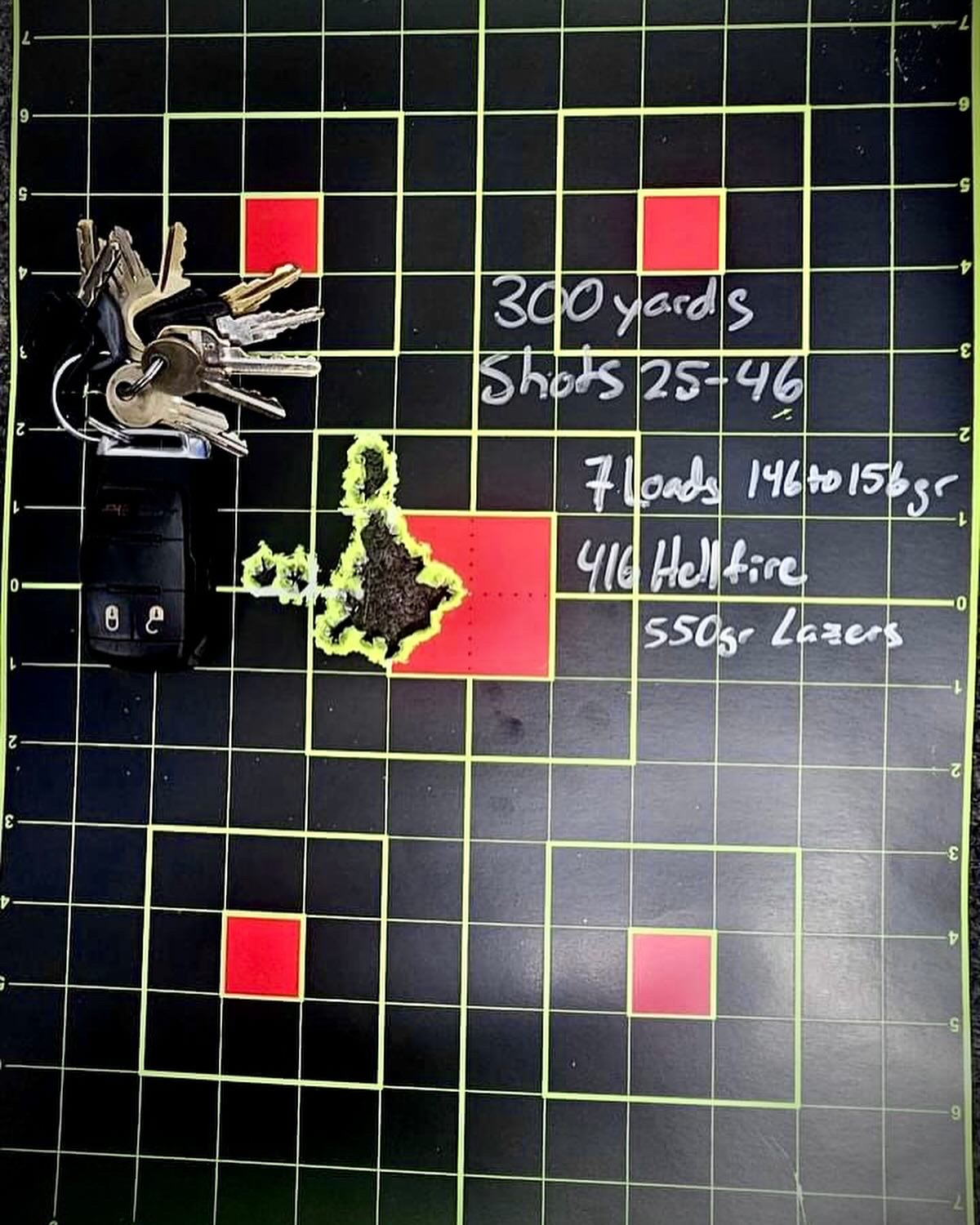

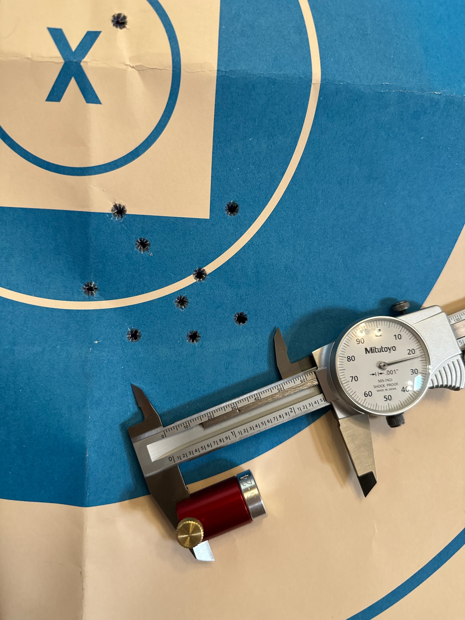

I posted 30 round groups from two different 300Norma platforms.
50 round groups from a 6xc
50round groups AR10 .260rem.
.22cal groups
All to date being noted as not viable- including by yourself.
If 50shooters note the barrel is superior to a their standard barrels-OBJECTIVE EVIDENCE- at what point does the objective evidence become a hypothesis?

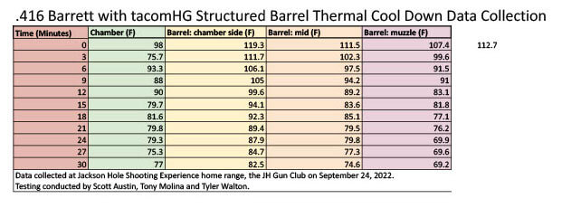

Does any of the following matter to a shooter (assuming one hole guns):
Ease of load development
Ladder forgiveness
Reduced gun/chassis movement
Heat
Heat dissipation
Mirage
Reduced SD migration

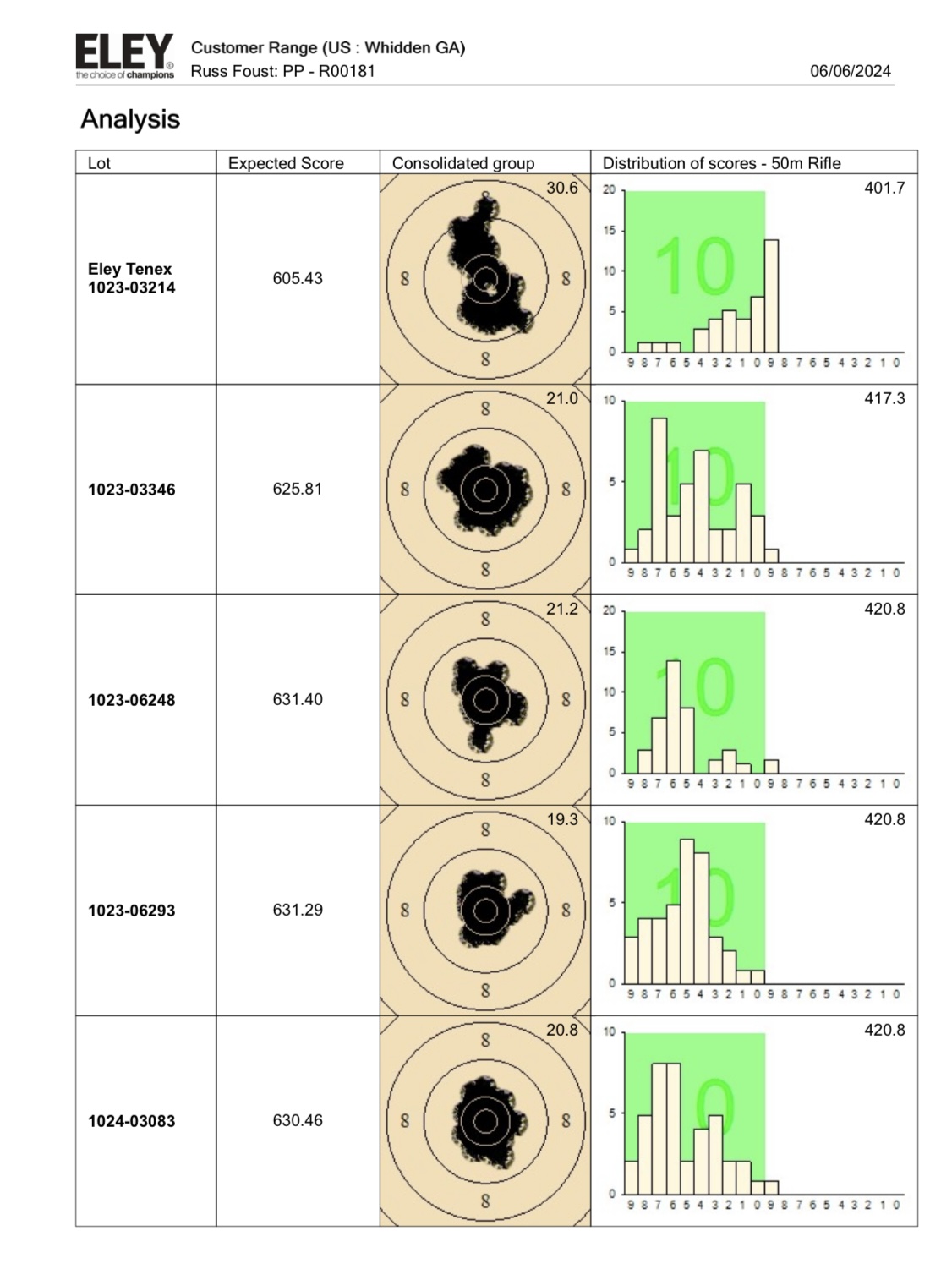

I have a 1000yd bench guy... part of our "objective" evidence is from him.

Did he win nationals? The top shooters don’t touch your barrels. Because they offer no benefit. Sorry bud
If YOU want to change the industry and claim a Revolutionary product YOU need to provide the proof. Here you are arguing with me and asking me to fly when you could have just provided us any shred of proof

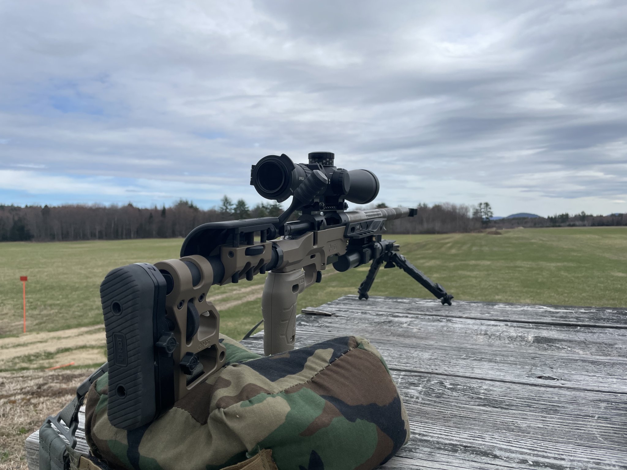

We have three new actions
Three new chassis.
As identical as can be.
Standard barrels and structured barrels.
All the same weight- solid barrels same weight as structured barrels. Structured barrels size for size is lighter. The smallest diameter we have made to date is 1.01"
Same total weight for the rigs, and held there as the barrels are modified. Target weight will be 21lbs
First up is 6.5mm.

I have a structured barrel. Made by Kreiger, 1:8 twist, .308, John Mills =gunsmith= blueprinted “dummy round” for the chambering
I am very very happy
The rifle is very pleasant to shoot and any and all that have shot it. Love it. Why?
Because it smacks targets all day out to 1476 yards ( setting up for a mile (1776 yards instead of 1760 yards…. (Think July 4th)yards) tomorrow )
It is fun to shoot
Shooting is fun
I went into the process of buying a structured barrel as an adventure and comparison to other barrels I have …. Namely Shilen, and Bartlein. They are in fact all good
But there is a very different feeling shooting the structured barrel
I am finding the tacomhq barrel more fun to shoot
That’s the name of the game
For me
No ego
No id
Just fun

10gr spread
300yds
shots 25-46
416 Hellfire 550gr Lazers

Heat:
1) These barrels have 3-500% more surface area per weight.
2) Our barrels run cooler- not insulate- cooler.
3) Our chambers remain coolest on the barrel as the forward section.
4) Heat moves towards cold- If this is incorrect please provide the counter.
5) The barrels run cooler than their contemporaries- at what point does that matter?

View attachment 8447109View attachment 8447109
10gr spread
300yds
shots 25-46

“The first 10-rounds with the SK were one hole. One thing became very obvious to me is the ES/SD impact shows immediately, but that was it. The rifle wants put everything in the same hole. It’s like watching a video game through the scope. No recoil, no movement, nothing just deadness.
Groups at 100-yds | POA 2/10ths high:
+ 1st row CX .001RO | Avg .1675″
+2nd row Midas+ no RO | Avg .268″
+3rd row XACT no RO | Avg .276″
+4th row Tenex no RO | Avg .272″
*RO – Run out
Corollary data:
CX 0.001RO | Avg 1065 SD 6.7
M+ | Avg 1068 SD 11.4
XACT | Avg 1049 SD 8.9
Tenex | Avg 1107 SD 8.1
Δ58 FPS
Honestly, the rifle outperformed every ammo I fed it. It needs to go to Lapua and Eley for testing in their tunnels to find an ammo lot that will deliver the best SD’s. It was amazing shooting across the radar that I could tell based on where the impact went whether the velocity was high or low. I did have some ammo I was testing an Olympic runout gauge on, and the ammo performed best. And it was .001RO. I still need to shoot the .000’s I have, those will tighten up the group even more. Or at least the data of 20 years of research shows that for every .001″ of run out equates to 1/10th group size.
The barrel is outstanding, and shows quickly the weak point is in the ammunition. Even though it’s Olympic ammo.” – Chris Baxter
5-Round Groups from Four Different Manufacturers
An initial look at cool down data- will try to get more from the Cerakote test.

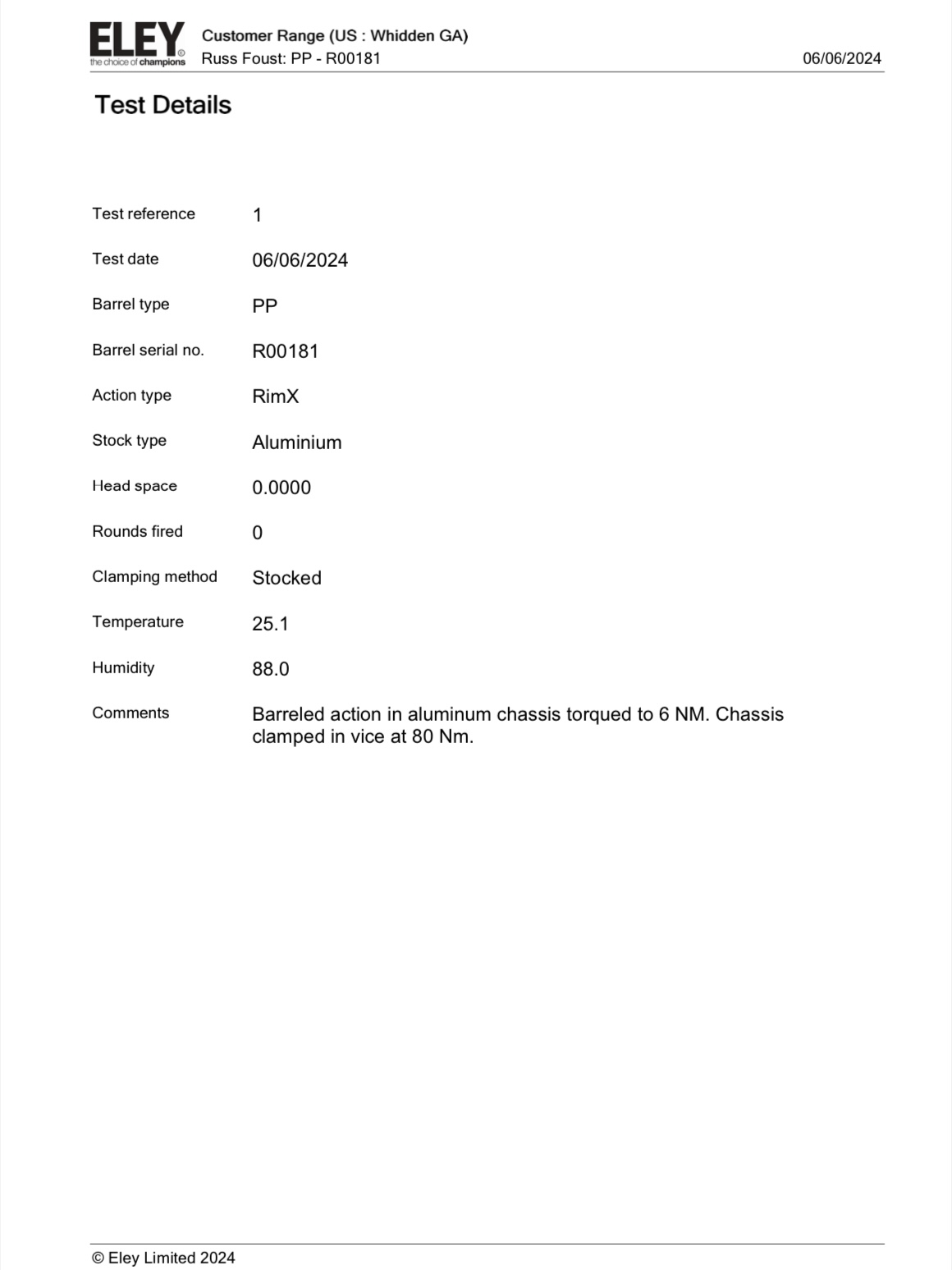

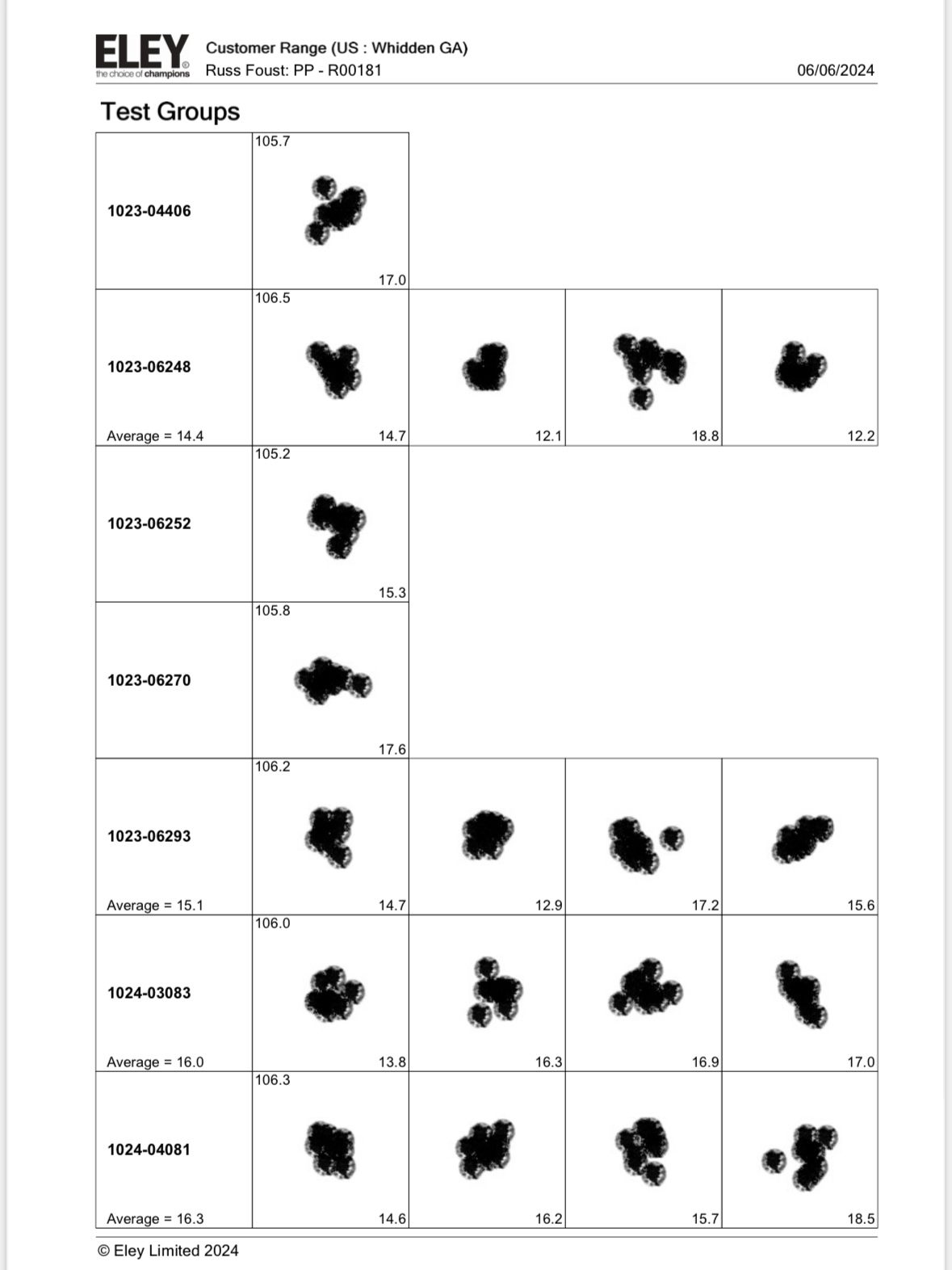

“Small update on MV info and how this barrel shoots. After the lot test I got the rifle back and I ordered 10k rounds for the rifle. Put the rifle back together, zero’d and began gathering data. I like to shoot a couple full boxes for the average. This particular lot was mean averaged by Eley at 1078 MV, I shot 2 full boxes(100rds) with the Garmin mounted to the rifle and after all the rounds recorded I had an average MV of 1140.5, an extreme spread of 18.8, and an SD of 4.8….and this barrel is about 5-600 rds away from being broken in by my usual standard. Crazy result over 100 rds IMHO.
I chose the lot that had a 14mm 50M average. I wasn’t sure that was ‘good’ and he said it was very good and olympians shoot 13-14mm average ammo.
This rifle is HAMMERING for a .22 in terms of repeatability, consistency and potential….and it hasn’t reached its full potential yet which is the most important part for me thus far. It’s this good now and will only get better.“ - @76.binder

Heat:
If heat does not matter your cars radiator would be a 4x4x2 solid block.
