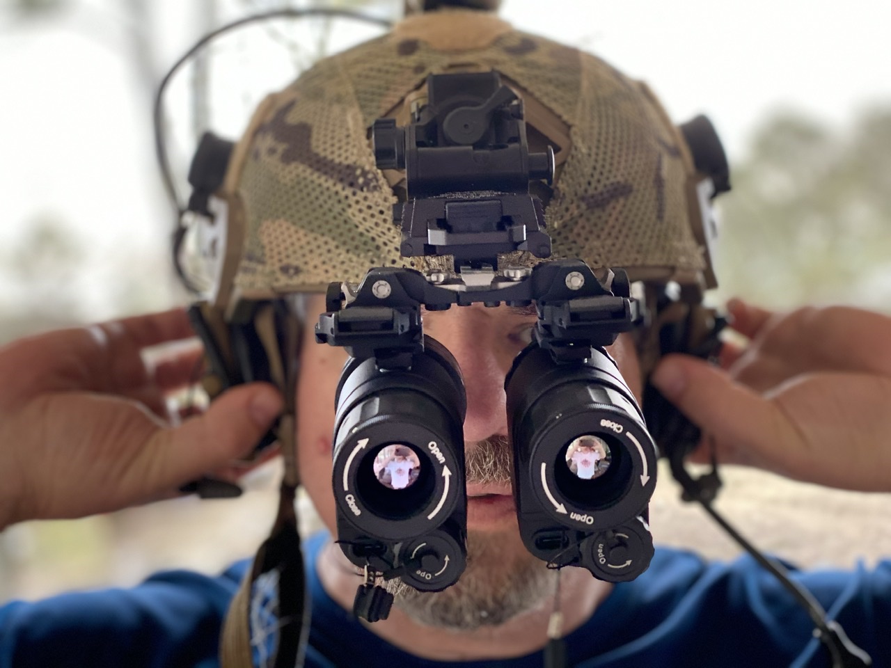

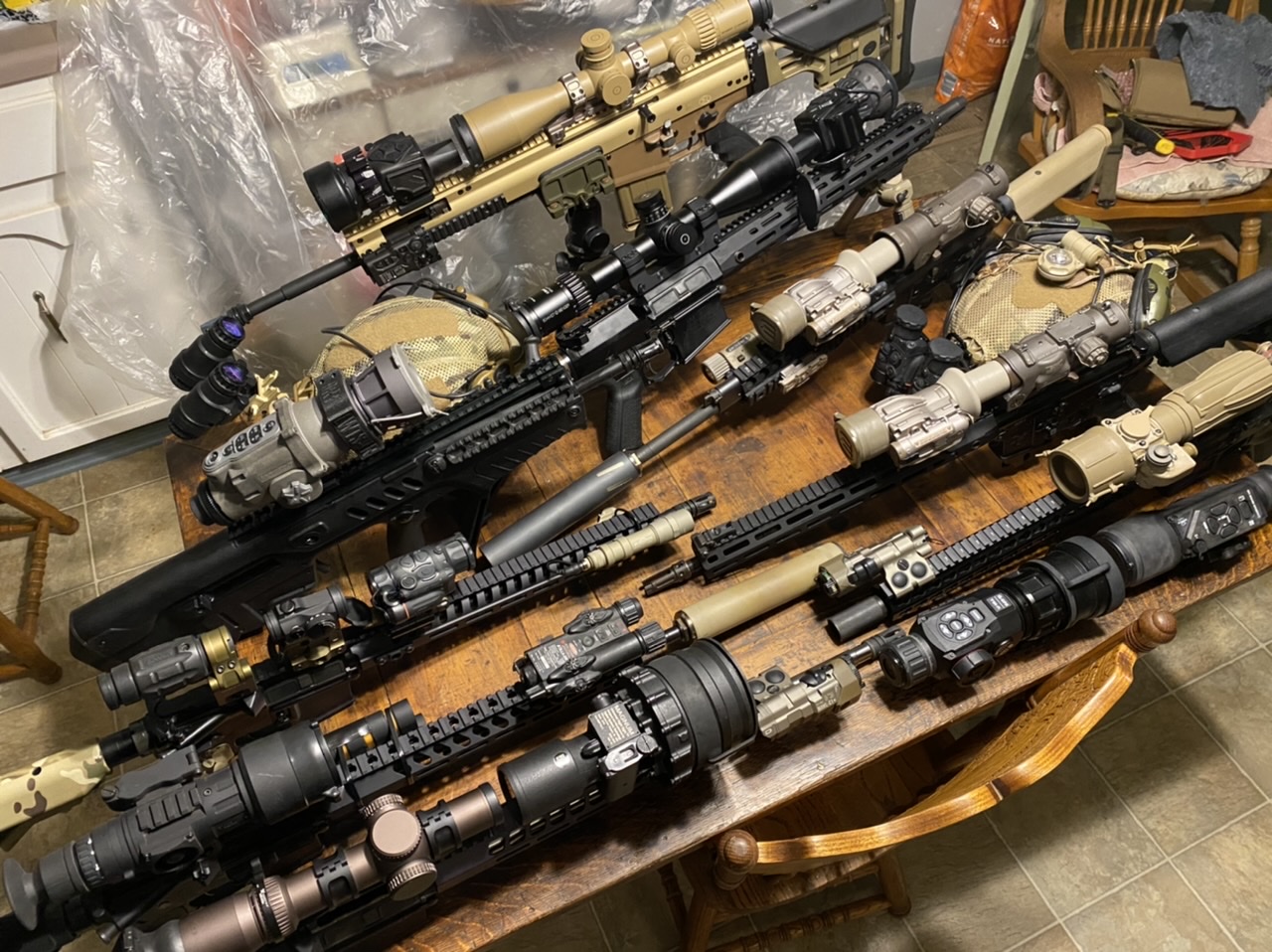

The MH25 is hard to beat, for the price, but I no longer use them and use my Halos virtually every night I go out… for a reason:
And, well… I own a few things, so take it FWIW:
