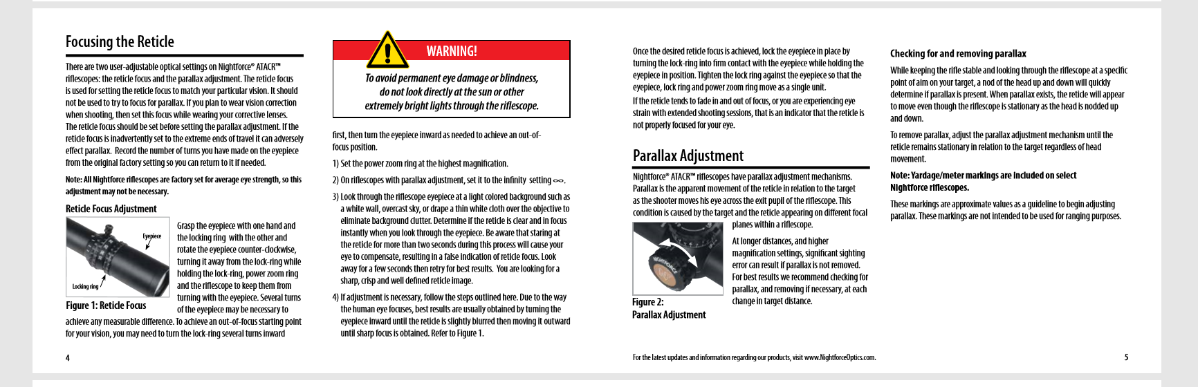

I contacted NF about this issue some time ago and they told me that the numbers indicated on the parallax knob don't necessarily correlate to that specific distance. They recommended that I just adjust the parallax knob until the parallax is eliminated and don't remain focused on the numbers on the knob. It works but it definitely begs the question of, "Why put a number there if it's irrelevant?"

Phoning NF support about this, they initially got stuck on the "numbers on the knob don't necessarily..." thing. I clarified with them that the issue I was having wasn't related to the numbers on the dial.
Pretending there are no numbers at all on the dial... if I dial the parallax so that the target is in sharpest focus at a given range, there's still parallax. If I dial the knob so that the parallax is eliminated at a given range, the target is blurry.
In every case, the setting that gives the sharpest focus is always quite a bit off from the setting that gives the least parallax.
Hearing this, NF support suggested I go back to the diopter adjustment again. After initially setting it at home, I had re-preformed it in the field after noticing the issue. They suggested I redo the diopter adjustment inside against a white background. If it doesn't resolve the issue, they'll have me send it in.
There are scopes that I can’t set the diopter using infinity and the sky. Half the range of the diopter is perfectly sharp to me.
In those situations I place a target at 100 yards with very obvious shapes and letters and such, then I get the image parallax free and then adjust the diopter until the reticle is sharp. I go back and forth between the two until the reticle is sharp and there’s no parallax error.
I then verify at multiple distances until I’m happy. Works for me.

It means your diopter isn't set properly. The parallax knob is simply a focus control. Diopter adjustment sets the focal plane of the reticle. Parallax sets the focal plane of the target. When both are adjusted properly, both focal planes intersect at your eye. Therefore there is no parallax error.
So why is your target blurry?
Because the whole thing about setting reticle focus at infinity against the sky or a wall is a bit misleading. Do that as a first step. But then you need to get out at distance and look at a target. Set your parallax control to eliminate parallax like what you've done. If your target is now blurry (and not from mirage), then you need to slightly adjust the diopter to bring your target in focus. Then re-adjust your parallax. Do this a few times and it will fine tune everything. Do it at different distances as well.
NOTE: When you adjust your diopter, do not try to focus your eye on the reticle. Your eye needs to be relaxed (i.e. not using eye muscles to try to focus on something). This means you need to be looking at "infinity." Look at the horizon for 5-10 seconds so your eye relaxes. Then move behind your scope and get sight picture while still focusing your eye at infinity. Adjust diopter. Now look at the horizon again. Back behind rifle and adjust diopter. Back and forth a few times.
If you do all of this, your parallax setting will always give you a sharp target, sharp reticle, and zero parallax error. And you will reduce eye fatigue.
You should be able to have a cheek weld with your eyes closed, like you're sleeping on your rifle. Then open your eyes and immediate have a clear sight picture without trying to refocus or strain your eyes. Then you know it's all set right.

The specific distance does not matter. Ideally, it’s far enough so that you are using your infinity setting on the focus dial, but in absence of long range things to focus on, it can be any longer distance.
And do not pay any attention to the hash marks or markings on your focus/parallax dial. At least not during this exercise.

We had issues with 2 NF 7-35 F1's, a call to NF and were told by a tech to set the diopter or eyepiece at 25ft, with the power maxed out, focus on infinity. You can do it on a wall in your house or garage, you are not remotely focusing the picture as much as getting a crisp reticle and no clutter on the sides. Once we did this, no issues to date, and basically over 80% of the focus knobs range is unusable now, I think both of our focus knob settings range from 150-300 on the dial, from zeroing the scope at 100, to hitting steel to 2K.
It looks goofy as hell, scope focused at 2K, parallax set on 250, but once you get the idea out of your head that it seems messed up, it makes it a lot easier just to focus for a clear pic and have fun, regardless off what the dial says.
