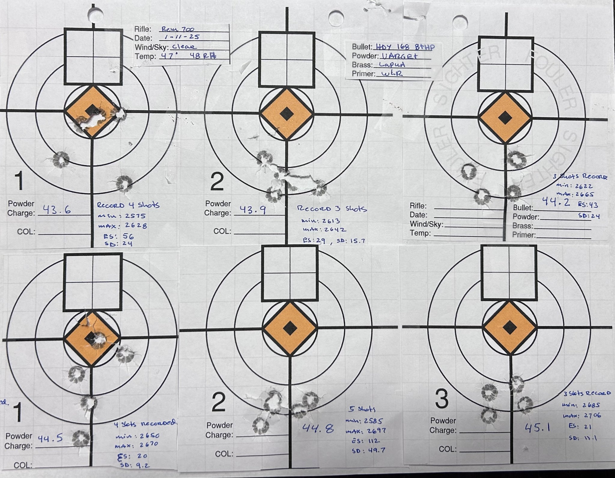

Need a little help deciding what loads to pick from on the ladder test. I’m thinking 44.5-44.8 gr varget in .1 increments to find the winning recipe?
REM700
1:12 20” factory barrel
lapua brass
WLR primers
No exactly sure where to go from here.
Any help would be appreciated.

I figured somewhere in the 2600 fps range. Not married to a velocity really. I would like for them group tight and consistent and let velocity figure itself out… maybe that’s not the right thinking..? Not sure

Well, considering this is a ladder test you are looking for the least amount of vertical dispersion. 44.8 grains looks pretty good.
Yeah, and I'd say 44.5 to 44.8 even though that "flyer" on 44.5 might be from who knows what. I would have shot another 44.5 round to see if that "flyer" might be shooter error. This is why I load up more than 3 for each powder charge (like 5) in case I see something in one of the 3 shot groups that I can't explain. And though 44.5 -44.8 look good on the vertical, it needs to be verified with another trip to the range, no matter which load one thinks is "the one." It's all about being able to repeat the results one is after. :giggle:
3 shot groups don't produce repeatable results. Chrono SD data is a far more reliable starting point than group size IMO. I Chrono 5 shot groups to find a good node then 10 shot a few loads that look promising for group size
Assuming you are using OCW then the 44.5 to 45.1 gn has a pretty consistent point of impact. Would test again in that range with a smaller increment. of 0.2gn. There should be a lower"node" about 1.2 gn below this which would be around 43.2 to 43.9 gn. 43.2 is in the range of a known load with Varget and 168s.
A note though on the 168 BTHP Hornady Match bullet. I have recently been working with that bullet and have not found it to be very consistent in my Rem 700 Tactical. Best groups seem to run about 2x the size of my 168 SMK groups. Not terrible but definitely larger.

Thanks for all the input guys. Yes, you are assuming correctly about the OCW.
Based on all the above, i think the next plan of action is to load 5 shot groups from 44.3-45.0, get some chrono data and see what they do on paper.
I'll try to get to the range this weekend and see.

Funny thing you say that, I was loading 43.9 for a while, but got "inconsistent" results. Some days they would group great, some days would be all the way out to 1.1" group.
After a shooting a 600 yd competition and not getting the results i expected, figured it was time to run the OCW again... I kept thinking it wasn't in the right node... ?
I may need to try the SMK's. Problem is, i have a bunch on HDY BTHP...
The throat on this factory is a country mile long... .126 jump to the lands... You think COAL will make that much of a difference with a jump like that?
I can’t tell you how many times the best group when testing new loads was also, by far, the worst as far as ES and SD go. It seems to happen often. You definitely need chrono data to see this as it would not otherwise be noticeable until you start shooting longer range and see unexpected vertical dispersion. My best SD’s are sometimes not the best group until I do a seating depth test, which according to the brain trust here, doesn’t matter 🙄, despite targets that appear to indicate that it does. Start with chrono data.
Reactions: kaskin
I would redo 43.6 through 44.2 using a chrono at a different coal. I think 44.2 might cloverleaf if the coal was maybe .005” longer or shorter. And at that coal you may see another good accurate charge with a lower sd.

If memory serves me right 43.9 varget with HDY BTHP was giving 2680 fps. This is just for benchmark purposes.
So, at this stage, is the consensus load 5 rounds from 43.6 to 44.8 in .2 increments, .1 increments??
or
43.4 - 44.5 in the same fashion? Get MV for all loads and see what prints?
or
Didn't want to load 100 test rounds (exaggerating), then, have even more confusing data for this ole mind to try and sort...
I have a Creedmoor that needs the same thing done to it.. and while i love reloading, i'm not as good interpreting data as i thought...
Reactions: ShtrRdy
I figured i could get these to shoot... After all, i do get some cloverleafs.. occasionally that is... LOL
I my grab 100 SMK's and see what's up.
Sidenote: the gold standard FGMM will not group in this rifle. 1.5"+ at 100 yds

OCW is worthless. Even if it worked, 3 shot groups vary in size way too much to gather any legitimate data. You can’t have a consistent POI to look for in OCW if your group sizes vary by .75in at 100yd….. You might consider another bullet or powder. Or if it has great SD and ES just shoot it.

The numbers from 45.1 look good. I wonder if I can fine tune it with seating depth?
I don’t have COAL on my notes. I get the comparator difference, but, I only use this comparator to load bullets for this gun… so for me, it’s a non issue. These bullets are restricted to internal mag length. When I load another batch, I’ll note COAL.

10-4. I’ll stretch the next batch .005 at a time.
Funny thing, the 44.8 charge seems to shoot tight, but that ES was quite extreme. Hard to move on from a group with sizes like that. Such is life though. Haha

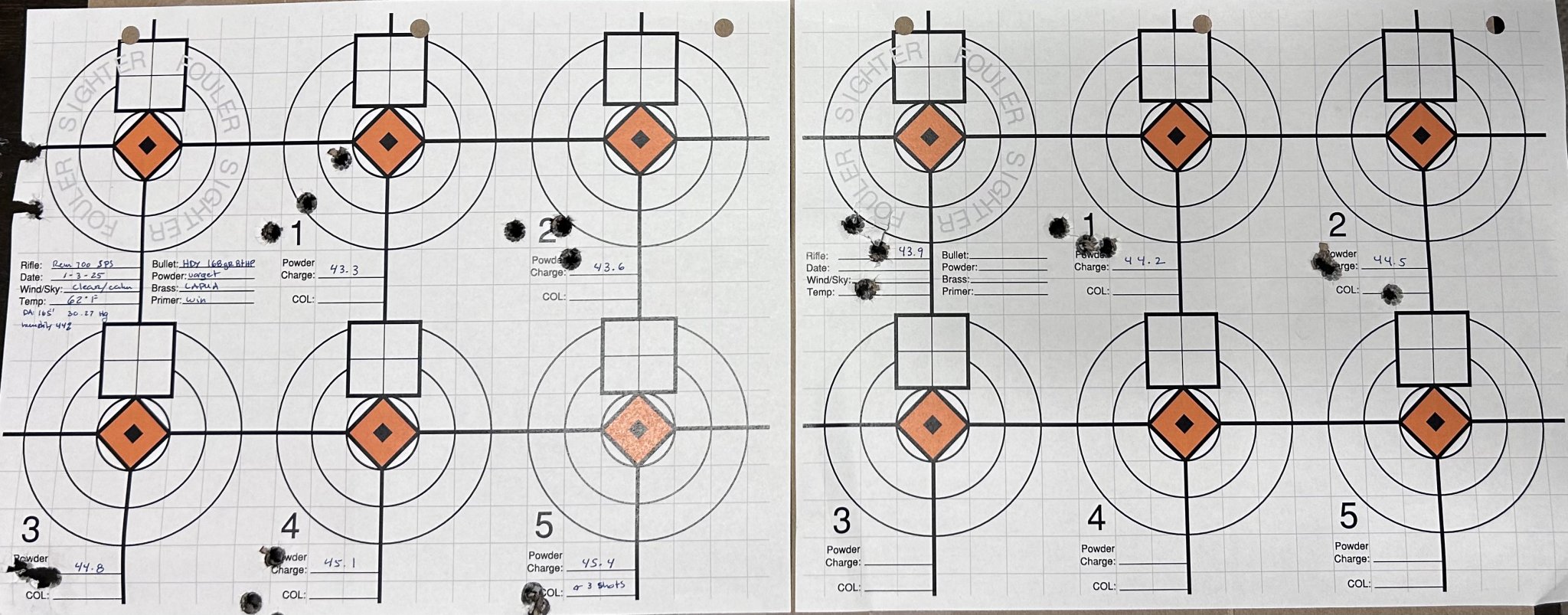

Update, range day.
Here are the findings.
Having seen two sets of targets I am going to say that something is wrong here. There seems to be some consistency in point of impacts but there is more scatter in the shots than I believe can be explained by either charge or seating depth. Several things come to mind.
I am assuming this is a SPS Tactical of some vintage and flavor and probably is a Hogue Overmold stock. These stocks have a lot of flex on the fore end and can flex to put pressure on the barrel. This is especially true with a bipod.
Without knowing the OP I think based on the target that he may be having trouble with getting a repeatable setup. The could be based on front/rear bag issues or body position. Is the rifle coming to the same position after recoil? This can be exaggerated if the groups are shot round robin.
What I would suggest is to load ten round (or less if you like) with 43.0 grains of Varget and a COAL of ~2.800". Shoot that load at 100 yds. either as 2x 5 shot groups or one ten shot group while being cognizant of the items above. This load should put you in a known "node" that should give better than 1 MOA groups. It will be a lower recoiling load probably around 2550 fps.
You can chronograph those shots but don't look at them while you are shooting. There will not be a good correlation between the POI and changes in velocity.
Based on the second set of targets you seem to have a "node" around 44.1 gn.
I wouldn't be telling the truth if i didn't start questioning my technique when i saw some of these groups... Then again, I was conscientious about loading the bipod, cheek & rifle position and recoil management...
These were shot in sequence. All the bullets for 1 charge in 1 run. 1 minute or so between groups to download the chrono data.
30 shots total. Leave the bolt open while downloading data. Rinse and repeat. Once the bolt was closed, tried to keep things moving so the round wound warm up in the chamber...
talking about the rifle:
Rem 700 SPS 1:12 twist
Boyd Stock: Devcon bedded
Scope: Vortex 6-24 FFP
Chronograph: Magneto Speed Sporter...
Regarding the "no data" shots... This magneto speed is not mounted on the barrel as it was intended by design. The rifle has 2 slot picatinny rail on front / side of the stock. The magneto is mounted to an articulating arm that allows for positioning under the barrel, but not touching. It can be tricky at times to keep it where it needs to be due to recoil. The thought behind this was to have the ability to capture data without disturbing harmonics... Is it possible that it touched on a bullet or two? maybe. I would like to think the set up was perfect every time, but... we are human...
If it helps, when the trigger broke, i saw the reticle lined up with the target on every shot....
The vertical stringing was weird to me as well...

How are you loading these rounds? Regular dies or bushing or something else? How many firings on this brass?
Redding Body Die
Lee Dies for Neck, Seat and Crimp.
Lapua Brass x 3. Next loading will be 4...
Annealed, sized and Trimmed, chamfer, deburr.
Lyman single stage press...
