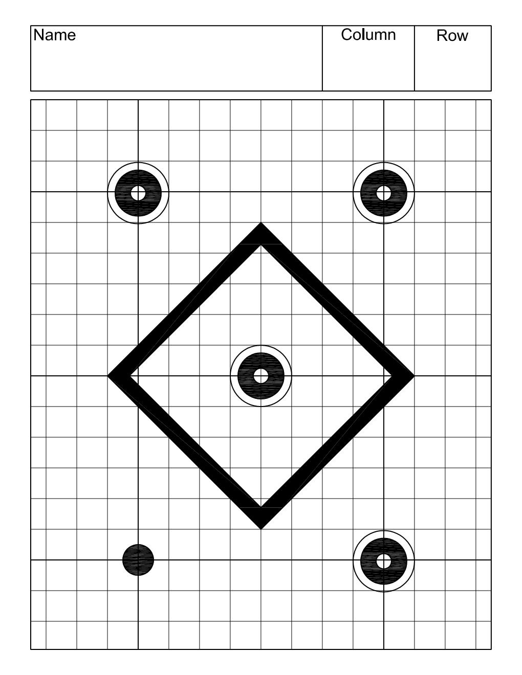

Here is a target I made after listening to the podcast. This target will do several things if Frank used it in a class.
There are 9 Aiming points on this one paper.
  • Write the name of each student at the top so they don't shoot the wrong target.
    • This also helps the instructor learn the students name.
  • Order the columns and rows so this could be used for reference if needed as well.
  • The center dot in the triangle can be used for gross zeroing if needed. This is a 3/4" dot with a 1/4" open center.
    • The large diamond around this target will help new shooters with aligning the vertical and horizontal reticle lines.
  • The 3 larger dots around the perimeter could be used for refined zeros.
    • These do not have the diamond and will force the student to start using the center dot.
  • The smaller 1/2" dot could be used to refine further.
  • Each point of the diamond could be used as a super fine aiming point.
Remarks
  • The 1/2" grid could be removed from the target is wanted.
  • The outer 4 targets could be moved a specific distance from the center to allow dialing a given value (and still aim at the center.
  • 15 students would be 4x4 target array - this is 36" wide x 44" tall. A doable target board size.
8.5x11 printable paper.

Give some Idea to this. I can make changes as we decide whats best for Frank with 10 people on a line. @lowlight

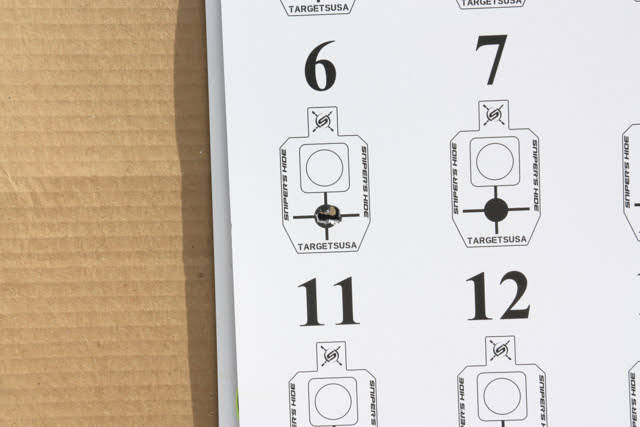

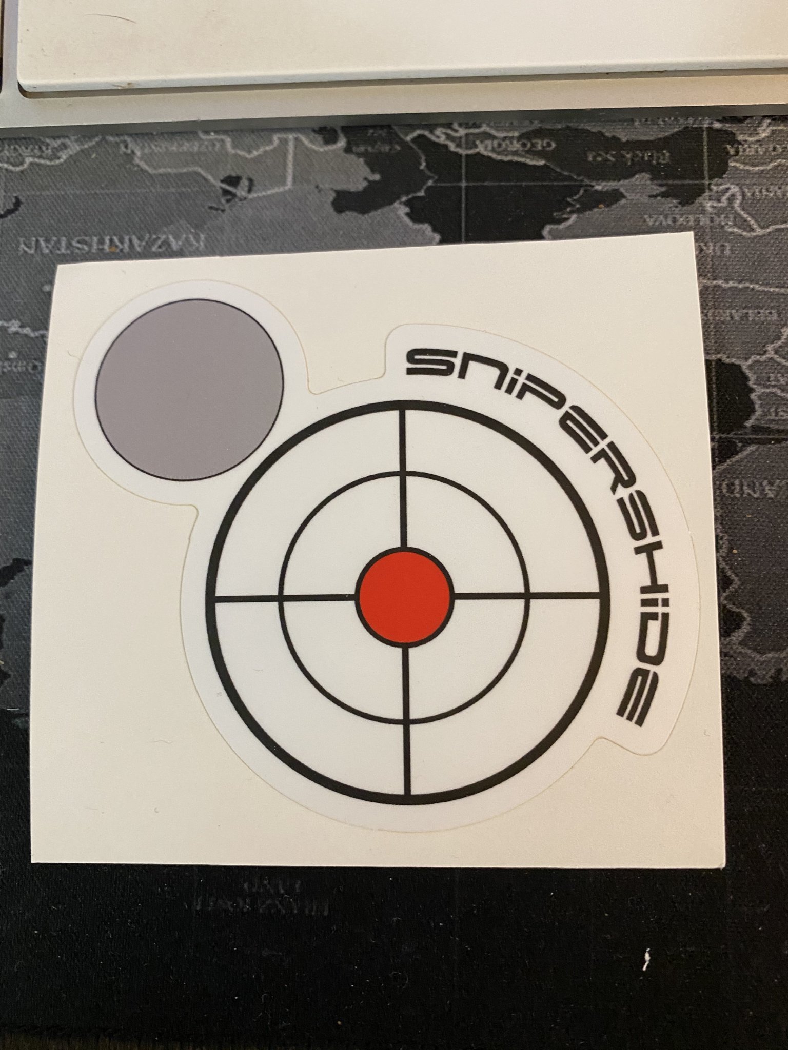

I have done several different "target stickers" for me to use in classes
The sticker solution is my preferred method, vs paper, stapling, etc. I do carry some larger paper targets, but they can be a pain in the butt
We had several variations made over time,
Originally, talking about destroying aiming points, I have rolls of these targets
this didnt' work because of the black dot, the paper was shinier than I wanted I needed a better matte finish, but it was designed for the very reason mentioned above, aim black, impact above
then for the Fundy Eval I moved to these

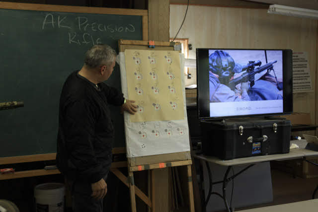

Part of the issue was, during the Eval people always shot the wrong target. You tell them to shoot Target 10 and they either shoot above or below the number, they always shot the wrong line. So in the grey, I put their number on it.

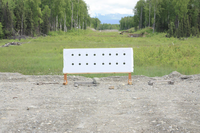

Here you can see what a typical board looks like
We had these made up, but the design was wrong and didn't work right, but also look at the board it's packed
Those look like this
Same thought, you can move the impact up to not destroy the aiming point
Stickers are the easiest to use, and mostly I use Shooting Cs
And we went to a bigger board.
The space is easier to work with

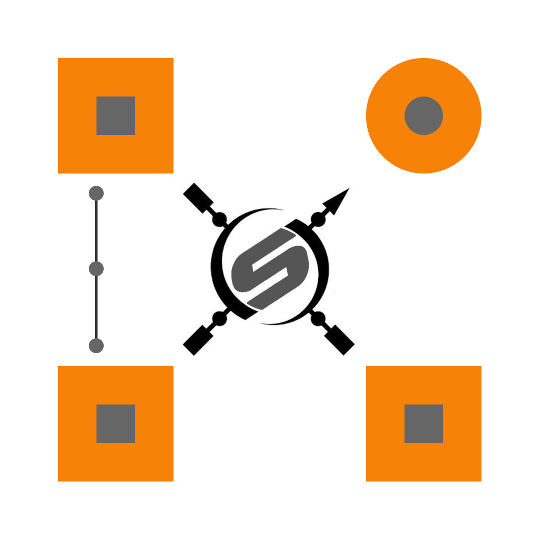

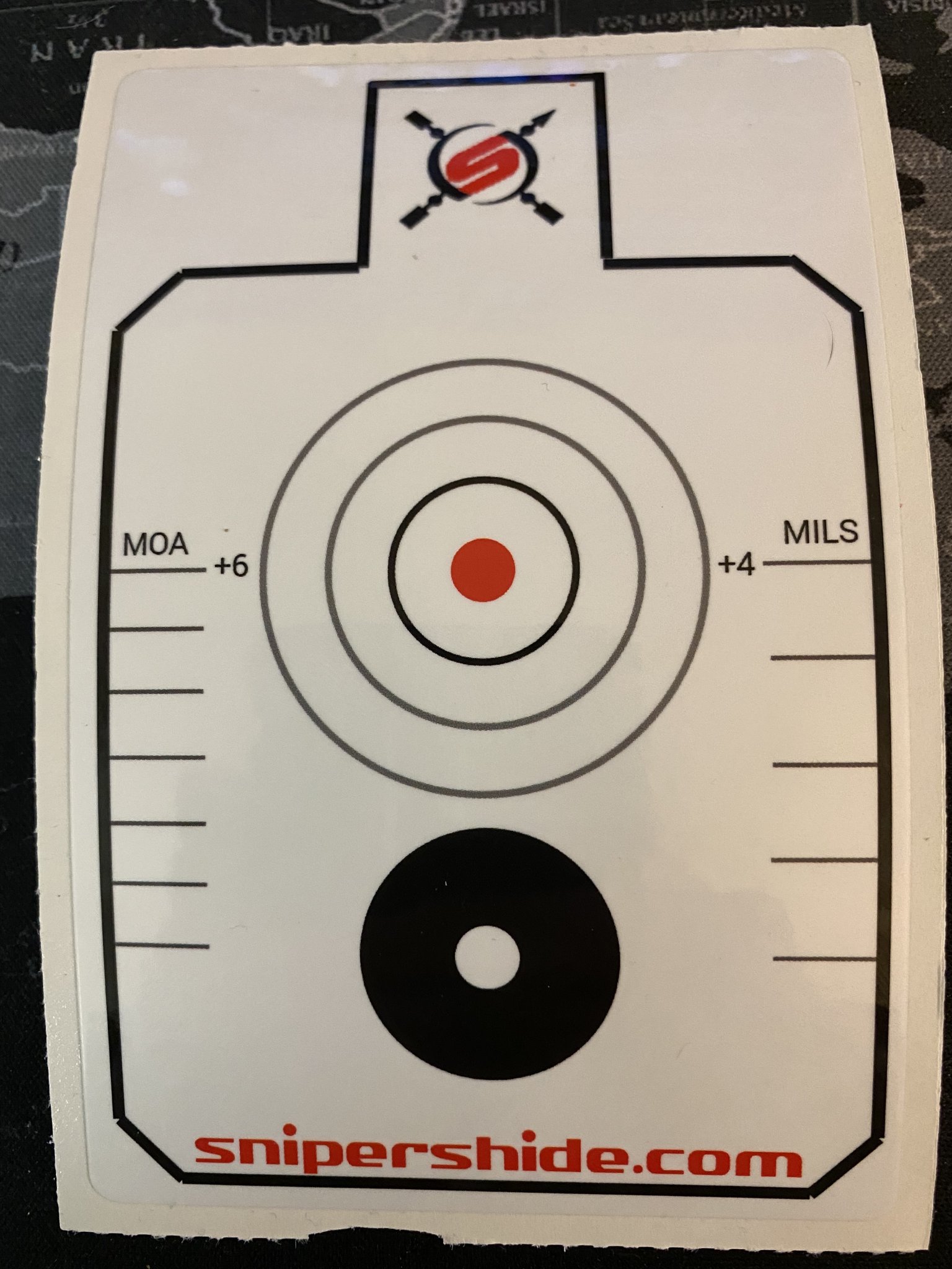

Lastly I am working on this which would be a 3.5" Sticker to paste over the top once a zero is established
Making this a 3.5" sticker means its easy to transport, it's cheap buying in bulk and sticker giant does me right
The issue was, creating the right design the first time vs these false starts
View attachment 7219659 Same thought, you can move the impact up to not destroy the aiming point

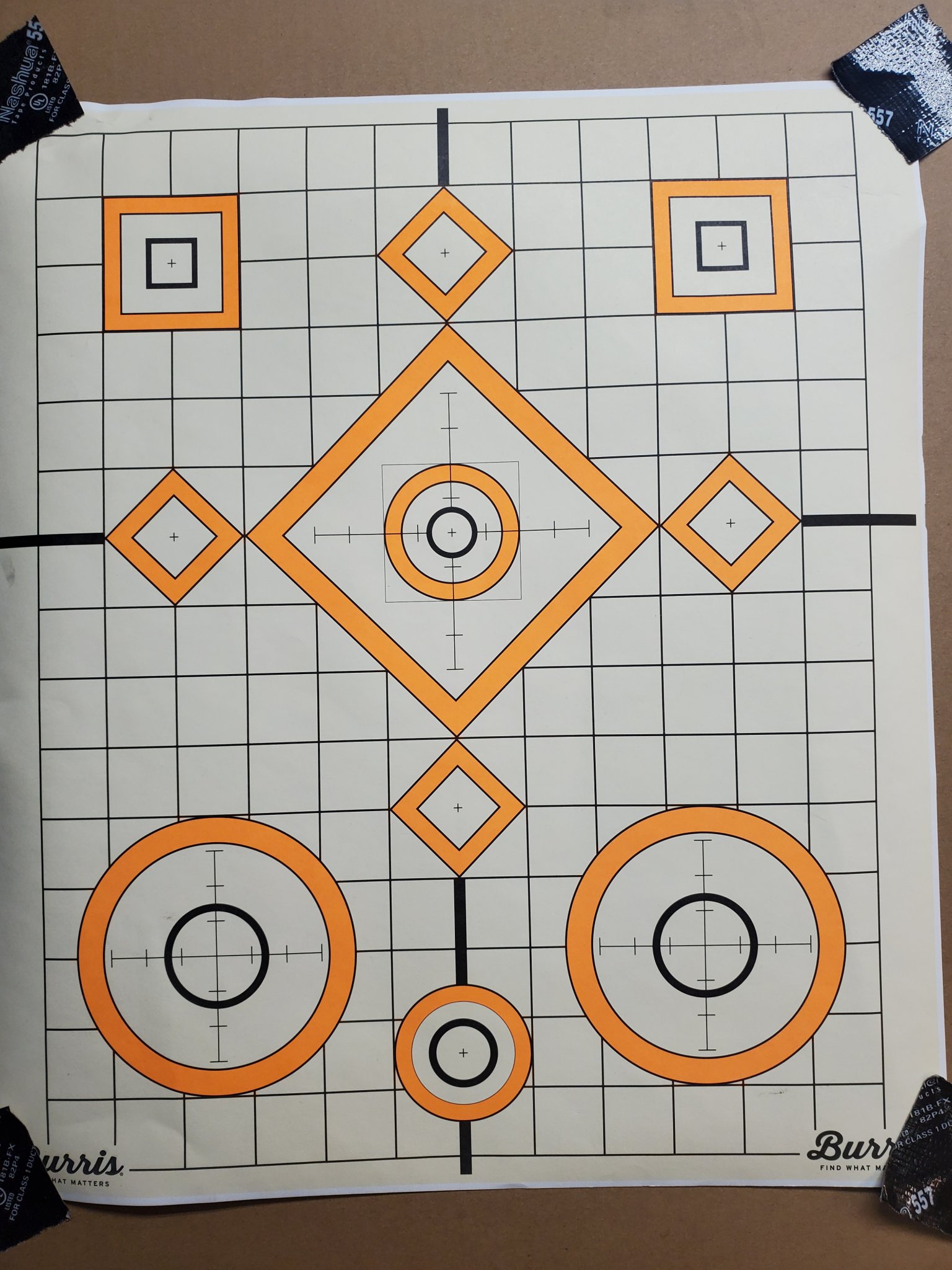

I see you used squares rather than diamonds. Was there a reason why? (did I miss this in the podcast?)
I use a similar target to what Jack posted. I grabbed it from an online target archive, but I like Jacks a bit better so I went ahead and yoinked that one to switch to.?
Reactions: Jack Master
I didn't like the angle of the diamond originally
I can change it, this is not a finished product, but just the feedback of the "orange" was an improvement
So incrementally I have been playing with it, I did all 3 earlier, I had two squares, a diamond and circle, which might be something to look at, but who knows
I still have to print copies and shoot it

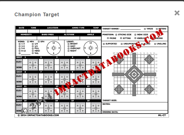

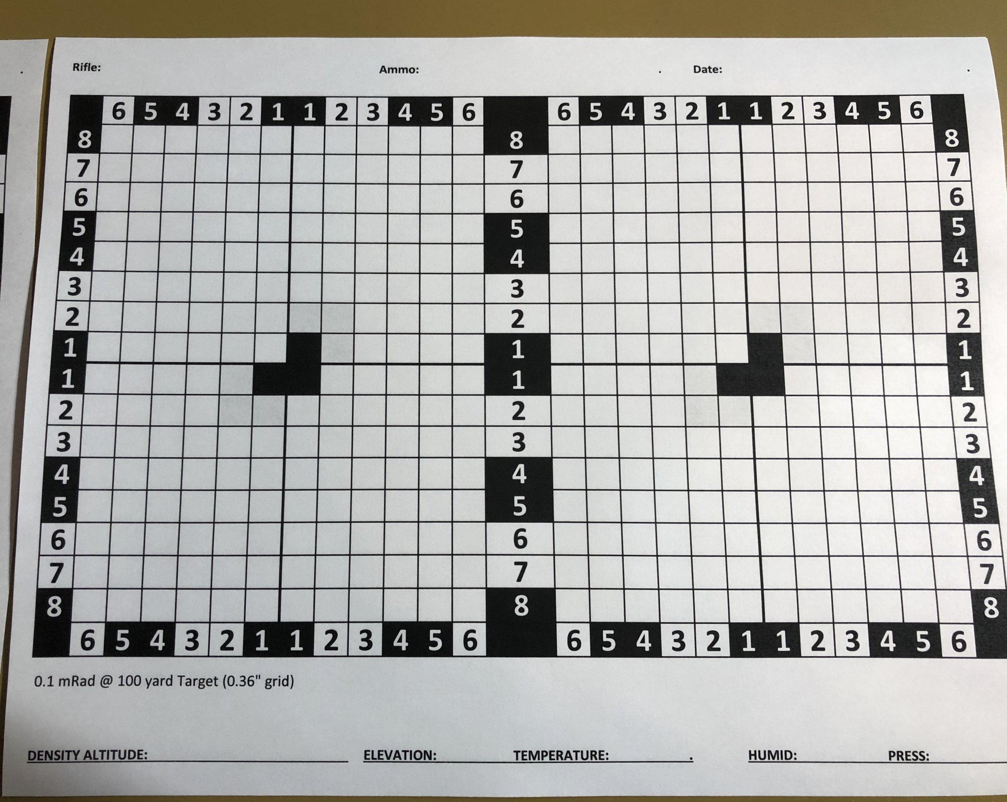

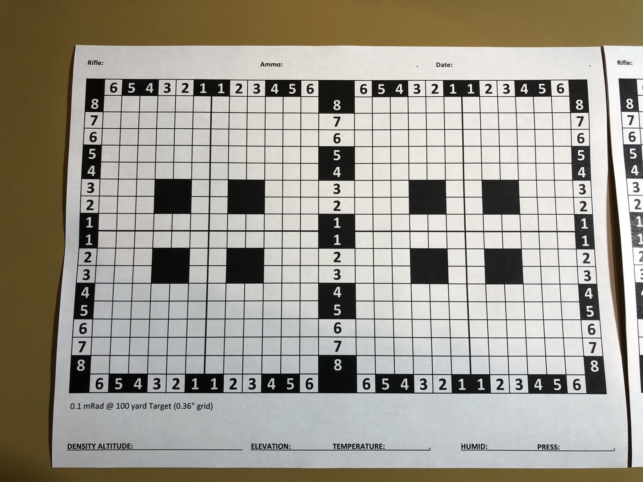

I use the MIL Zero Target from Impact Data Books under the free downloads. It corresponds with the same databook page. works great for me as a solo shooter.
However, for your needs @lowlight , i see this databook page and corresponding target being valuable. Only catch is I have yet to find the target that goes with it, its not on Impacts, target downloads.
Get box to bench to print you some of these up for class.

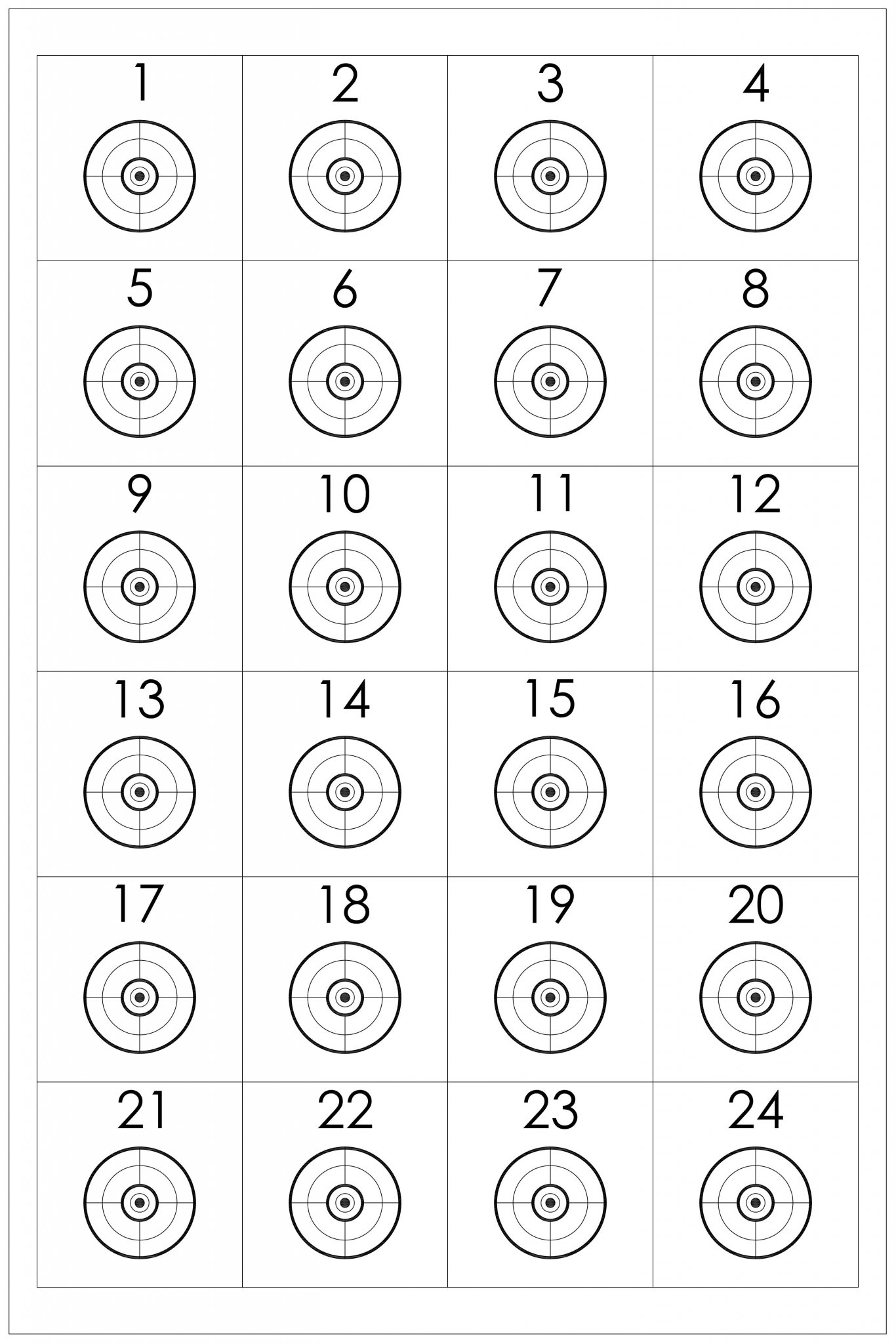

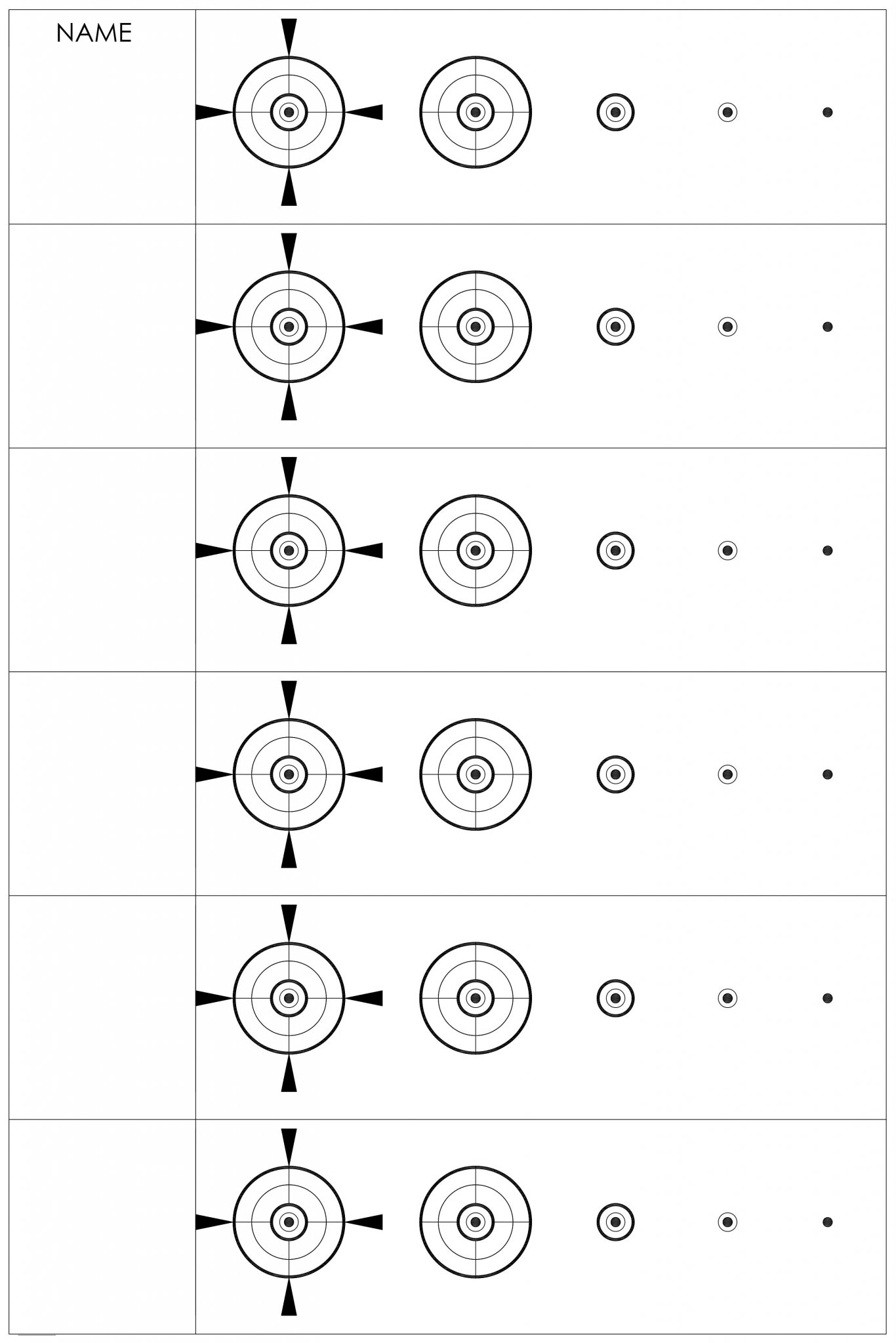

I can make that up for you. 24x36 page. The circles are 3" outer, with 1/4" dot. You can post a Shoot-N-C over them if you needed but this way you'll have the numbered targets.
Also Attached is a 2nd target that I thought might work. This will take 2 boards to get 12 shooters but these targets let the noobs use the larger targets for zero then small dots for refinement. Aim small miss small a the end. Just my 2 cents.
Rather than shoot-n-C could you have stickers made that look like these targets? Would that be cheaper than shoot-n-c?
I Truly think to get people to shoot the correct target is putting thier damn name buy it. Add a the first letter of the last name if you have 2 people of the first name.

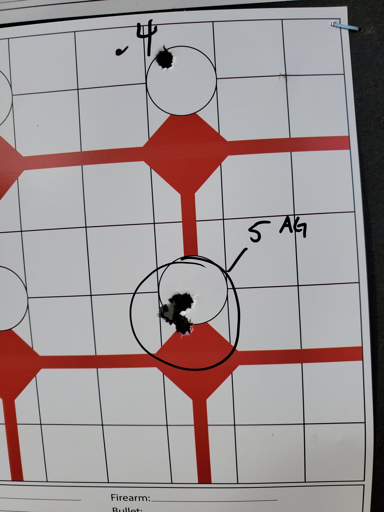

Shot the orange today it was perfect

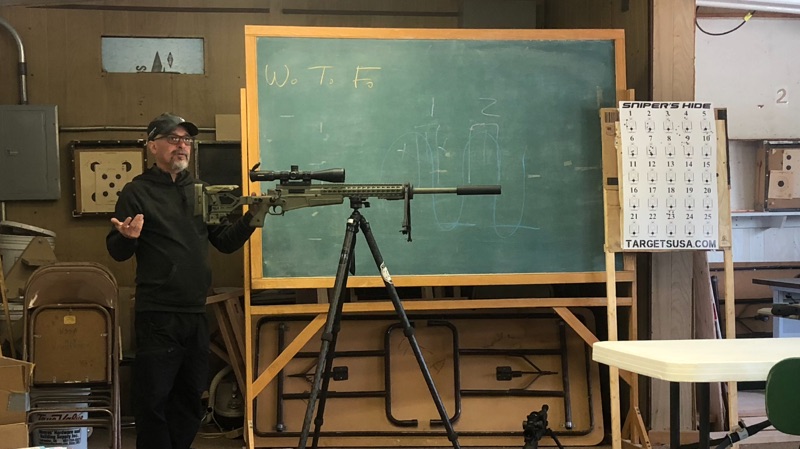

Guys, you have to remember, this is not meant to be a one-off for one person, I need a group target for a group of people who are gonna shoot a series of groups
The point, is ease and efficiency on top of having the best target and experience to shoot at
It's about not having to give 16 people, 16 different instructions, and it's about downtime, you want to just run down, and slap a target up or cover the holes with a sticker

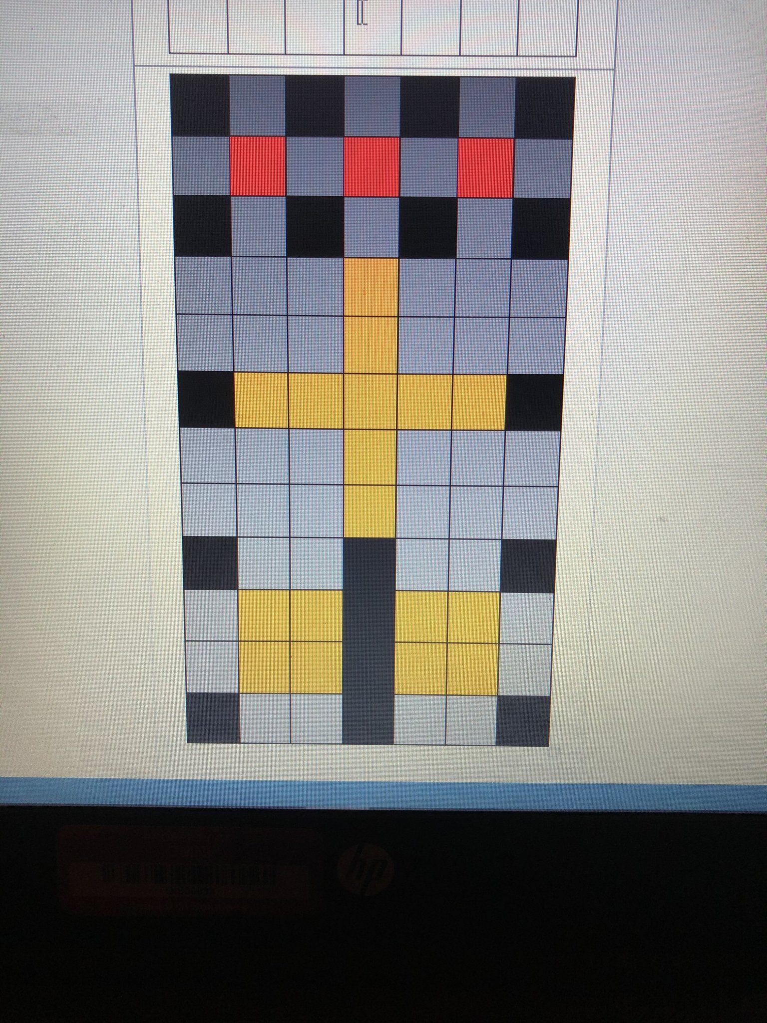

Listened to #222 today so behind the curve a bit. I made some 8x11 and 3x5 targets with .36” grids that have worked well for me. Easy to adjust POI with the .1/.2 features in the targets vs dicking with 1” squares.
Below are the 8.5x11 on paper and the 3x5” note card targets.
Just listened to the latest podcast. Love the orange diamond idea. I like orange lines that extend out off the tips to give me something to overlay my crosshairs on. Just a thought.
Cheers
I like the diamonds I use them myself. The points give you a more sure reticle alignment.
Color preference is personal, but I see it this way:
Bright yellow/green is the color that the human eye sees most readily. That is why many fire engines are that color. However, the edges could wash out a bit against the white, so the addition of black borders that amount to .05 - .1 mil at 100 yards would help define the edges.
Bright orange wouldn't need the edging as badly because of increased contrast with the white, but could still probably benefit from it.
I agree that diamonds probably do a better job helping the brain subconsciously align the reticle with the diamond points, and for shooting groups to test loads, rifle, etc, they work well. However, if part of the exercise is to teach shooters to quarter the aiming point, other shapes like squares or circles that force the shooter to deliberately quarter the target might be better. Just a thought.
To me fine tuning zero and shooting groups are two different efforts, and trying to find one target that does both is always going to compromise one or the other. However, doing them separately might take too much time in class.
I prefer to isolate the vertical and horizontal components of "zeroing" if you really want to fine tune zero and are not interested in groups. Top archers have been doing this for decades because they've learned it's easier to adjust one thing at a time. It also takes the "mental stress" away from shooting groups and lets the shooter focus their hold on only one axis at a time. One big issue I see with shooting groups for zero is that once guys blow 3-4 shots into their tiny aiming point, it's no longer distinct enough, I can see where diamond aiming points help if you are aligning reticles to them.
It's simple you shoot at a 1/8" thick vertical line to set your windage, and that's all you worry about, then you shoot at an 1/8" horizontal line to set your elevation, your zero should be done, and it will be a finer adjustment than most aiming points guys are tearing up in 3 shots. Seems like you could have a large sheet that had say 16 numbered vertical lines on it, and the same for horizontal. Heck if people shooting wrong targets is an issue have the lines different colors "#1 you shoot the orange line" etc. If traveling light is the focus you could even do this with thin detailing tape, no need to even pack paper.
