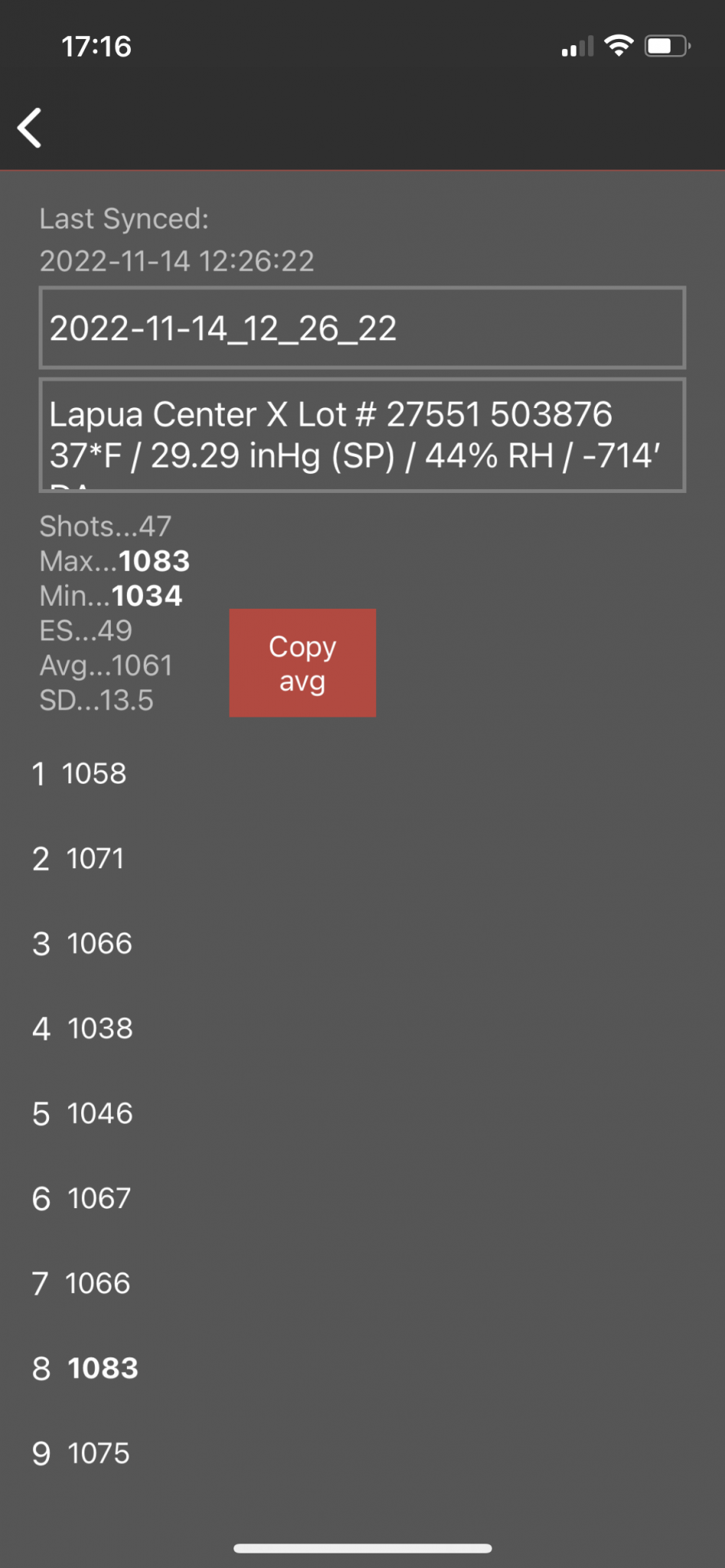

Can anyone point me to any data on temperature sensitivity of Lapua rimfire ammo? I've noticed that under 50F my good lot of CenterX is less good. Today I played around with that CenterX and some Biathlon Extreme in temps just above 50F, and it looks like the CenterX slowed down 20 to 30 FPS from summer temps, while the Biatlon Extreme is currently shooting about the speed that I get in the summer with the CenterX. Is there any more comprehensive data available?

Both. The speed is lower and the SD is higher. At 270 yards, it went from about 1.5 MOA to about 3 MOA (more vertical spread)

A recent observation is the amount of drop with 27 spd Center X when shot at 200y in 84deg F and 52 deg F. In the warm weather it was 8.4 mil and yesterday in the cooler temps the drop was 9.2 mil. A slight wind in the cooler air was very impactful causing the rounds to spread 4” horizontally at times. Plus the Lapua lube gets harder below 50 deg. I have a few rifles that shoot Lapua biathlon extreme well. It is faster and has no lube on the cases at all which makes it stick in some tight match chambers. The bullet lube is either harder or non existent. If I recall, Lapua told me they did not lube that product but it caused so many issues that they discontinued it.
When I play with the numbers, that looks like about a 50 fps difference. I think I am seeing a bit more than that, but in the same neighborhood.
