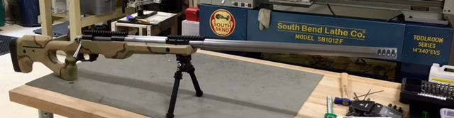

White Mamba - How about a picture of the whole gun? Skeeter builds good looking rigs and they've done well at the URSA matches.

[No message]
