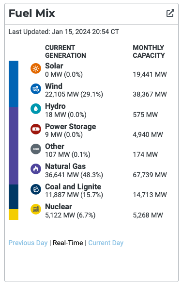

Reviewing this thread, and especially in light of the very bad weather being experienced down there (well, actually *over there... I'm farther South), reminds me of this classic Zack Rushing Video. "We ain't Built for this!"

im pretty sure ive shared this before, but i work closely with a very large generator and transmission company, so I get to know some things other might not.
First, ERCOT is going to tell people to "conserve" just because. its standard practice going forward. as far as i know, there is no issue with the grid right now.
the issue with the grid back in the deep freeze of 2021 was the entire state, 254 counties, were all below freezing temps at the same time. That was brownsville to Dalhart, El Paso to Orange. Multiple days where it was freezing. Keep in mind, in the Rio Grande Valley, basically everything south of Beeville, it rarely EVER FREEZES. During that year, there was roughly 25% of the generator capacity was down for SCHEDULED OUTAGES and maintenance. There is a planned outage moratorium from May 15 to September 15th every year, which means line upgrades, station upgrades and outages, and generation cannot do anything until its outside that date. Before that, the last time there was any brown outs or rolling blackouts in the state was a really hot year about 2009 in Laredo. Since then , there has been Billions and billions in infrastructure, transmission and stations and generation that has been planned and built. Summer demand since then is ALWAYS much higher because winter some people heat with NG and Propane and usually the RGV is not below freezing when north Texas is.
As for now, there is plenty of generation capacity for demand. the sources are all telling me there is just no issue like there was in 2021. ERCOT is also adjusting and trying to not have as much planned generation out in the coldest Texas months which are January and February.
anyway, the sky isnt falling, we all doing just fine down here in Texas.

It can. I bought and installed most of mine. Payback is around 7 years, and I have fridges, office and Internet on critical load panel that can run for several days on battery backup. I can top those off with generator if I want. That's also assuming inflation doesn't hit electric costs.. lol.
Reactions: Maggot
Wasting your breath. You could lay all the paperwork on the table to prove your point and most would still deny it. Its kind of embarrassing..
Green Man Bad:whistle:
