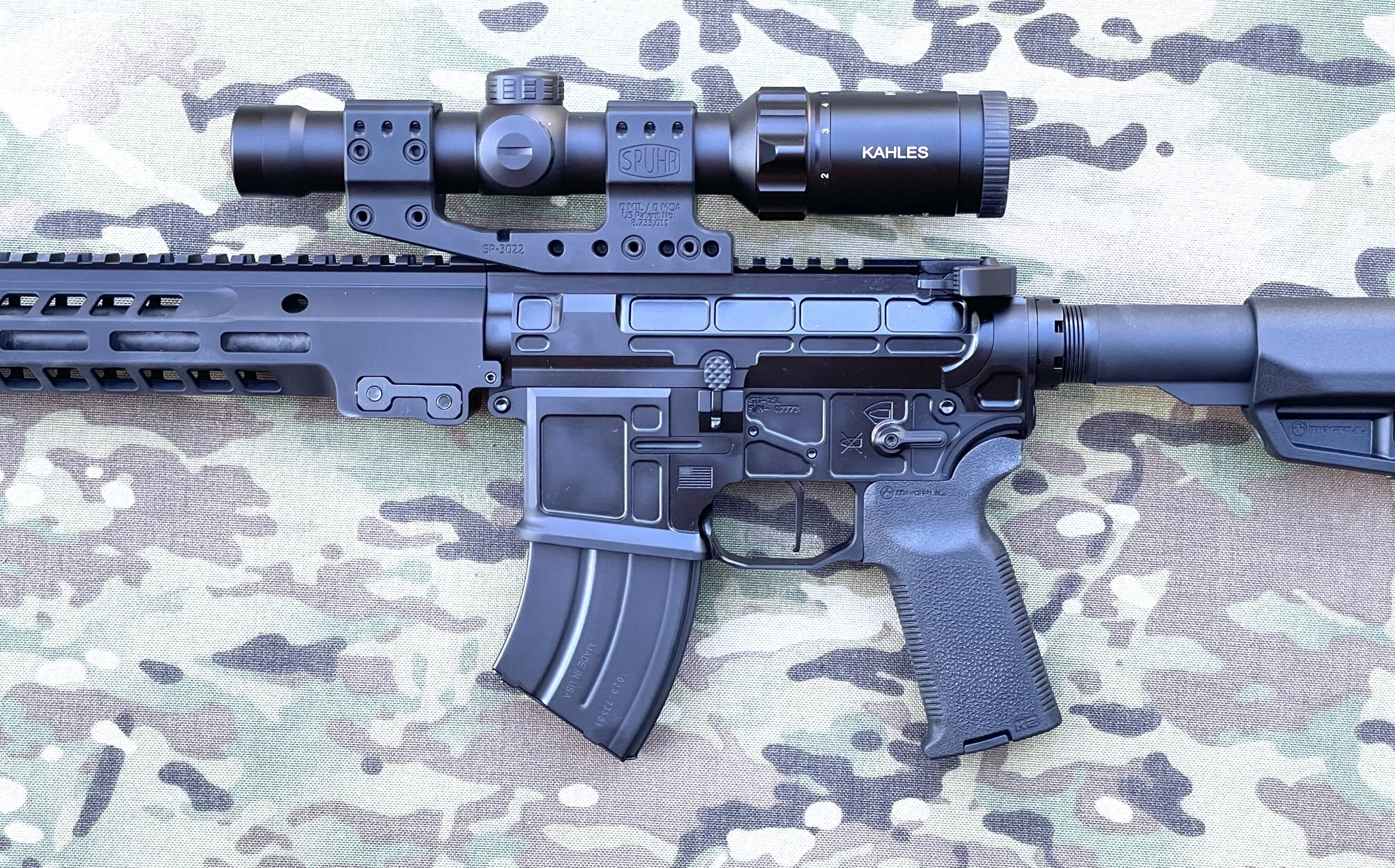

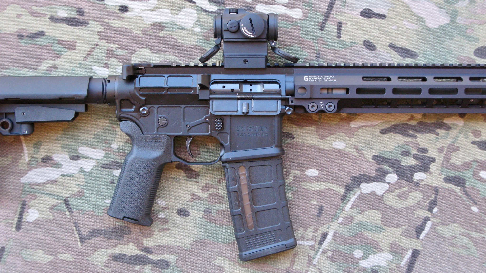

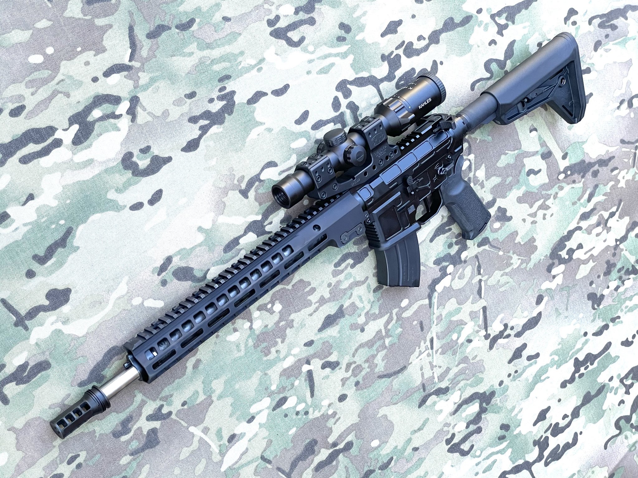

Here's a custom 6mm ARC Recce carbine that I did not want to let go: SanTan STT-15L billet receiver set; Proof Research carbine fiber wrapped 16" barrel with rifle length gas system; SLR adjustable gas block; OSS 7.62 brake, threaded 5/8-24. Geissele Mk 14 rail and Super Charging Handle (SCH); SanTan Tactical BCG; titanium push pins, fire control pins, mag release, receiver end plate, tube nut, buffer stop, and grip screw from V Seven; S7 tool steel bolt stop from V Seven; TriggerTech Adaptable trigger set to 2.75 LB; Magpul K2 grip; Vltor A5 recoil system; Magpul SLR-S stock; DuraMag (I know... but it works!); Kahles K16i in Spuhr SP-3022 mount; OSS HX-QD 762 TI suppressor in the works.
For my eyes, the trick to getting a decent zero with a scope having a 2 MOA dot in the center is use a 3 MOA round target. After zeroing the scope for the customer, I decided to fling a quick three out to 200 yards. This resulted in a nice symmetric 2.5" group.

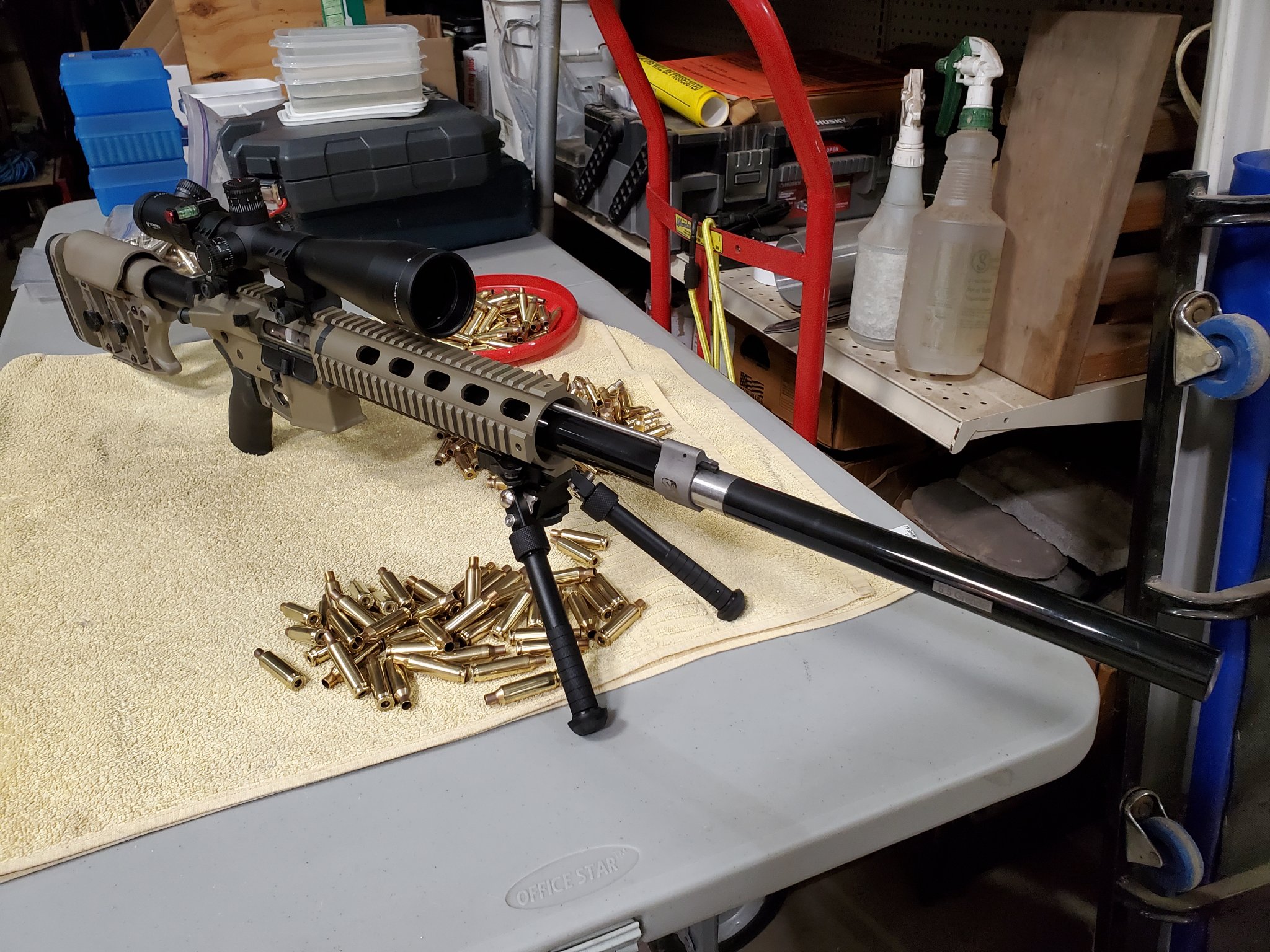

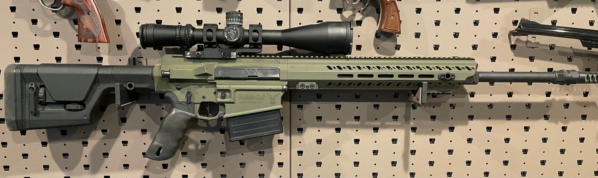

The green one is a 338 Laupa mag made by Sword International that I use to shoot hogs when I'm mad mad at them.

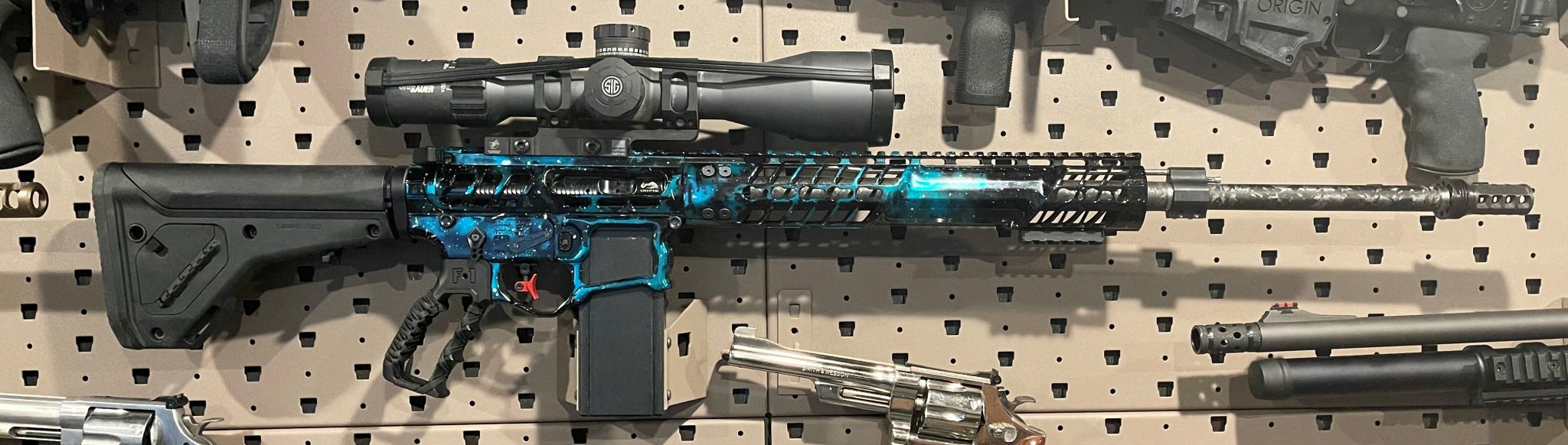

The black/blue one is 224 Valkyrie custom build I put together on a F1 firearms chassis that I use to shoot prairie dogs when I'm mad at them.

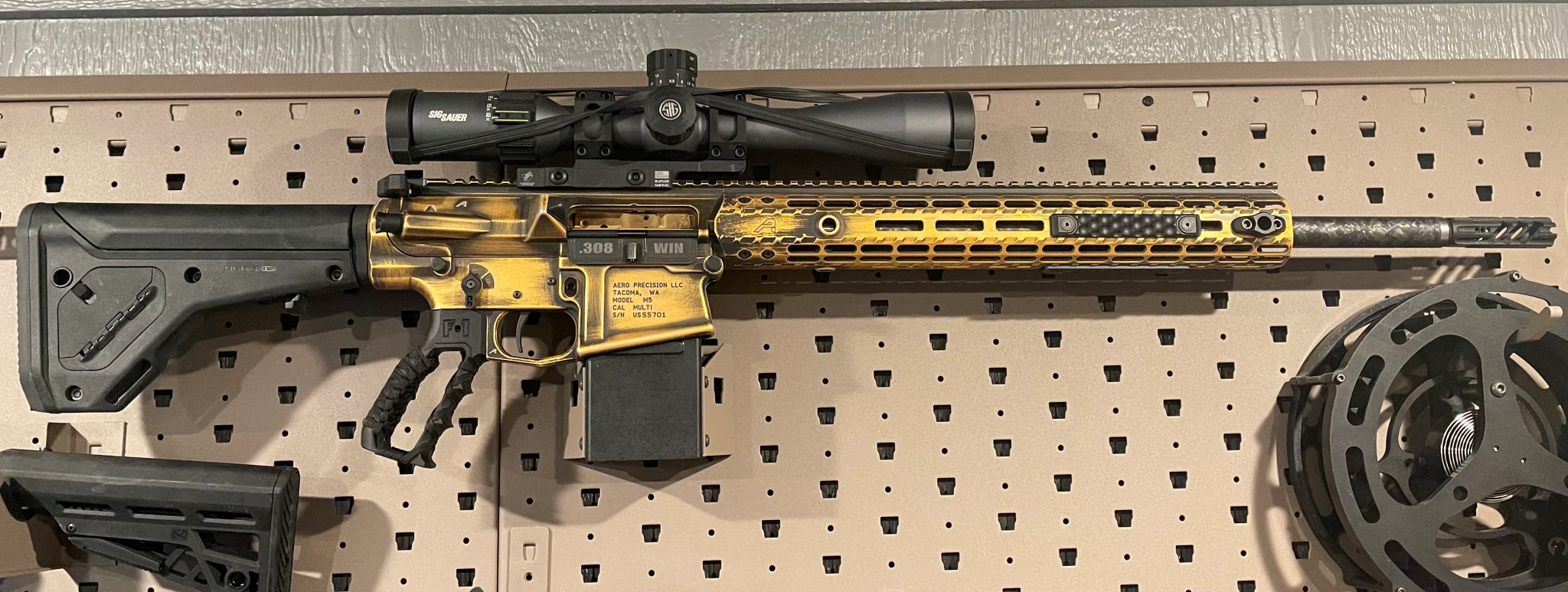

The black/gold one is a 308 win custom build I put together on an Aero Precision monthly builder kit special because I thought the "spent brass" paint color was pretty like a shiny nickel.

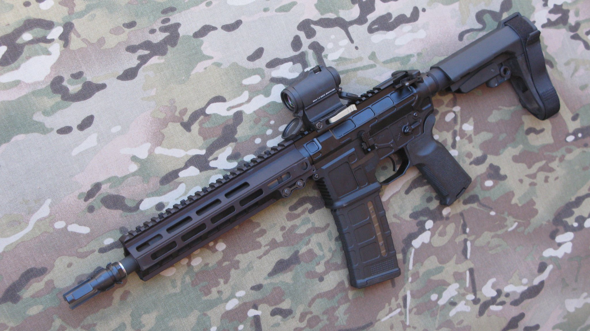

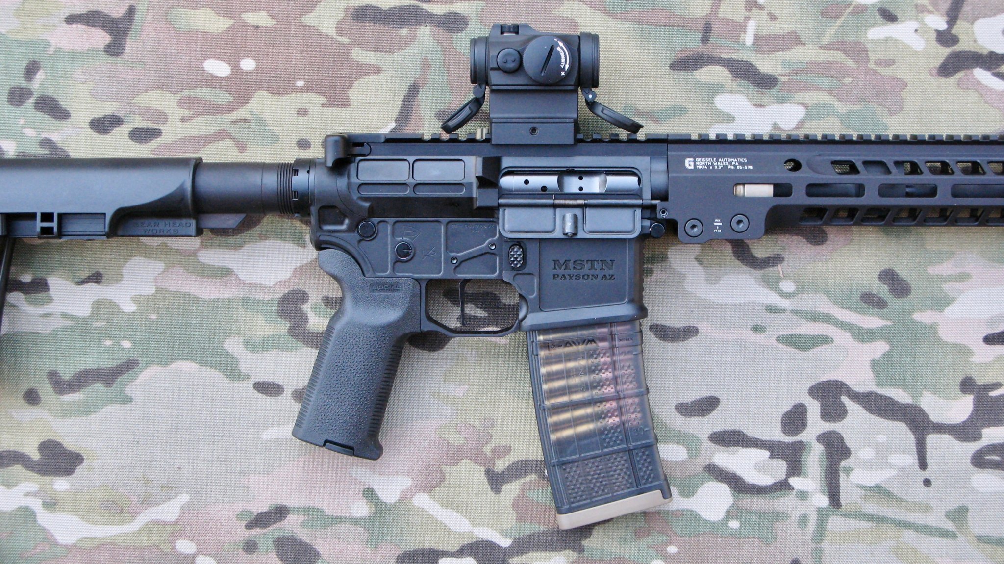

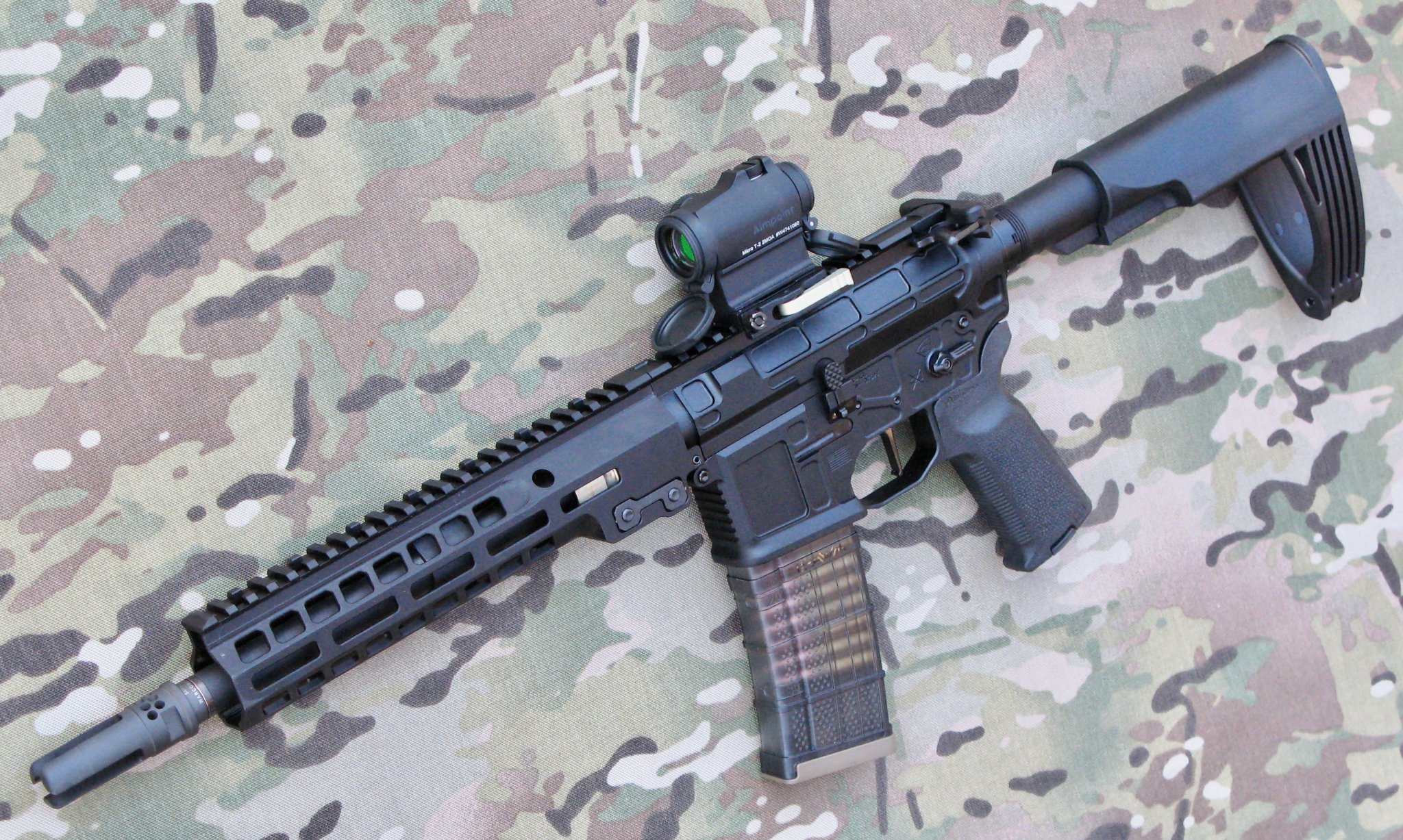

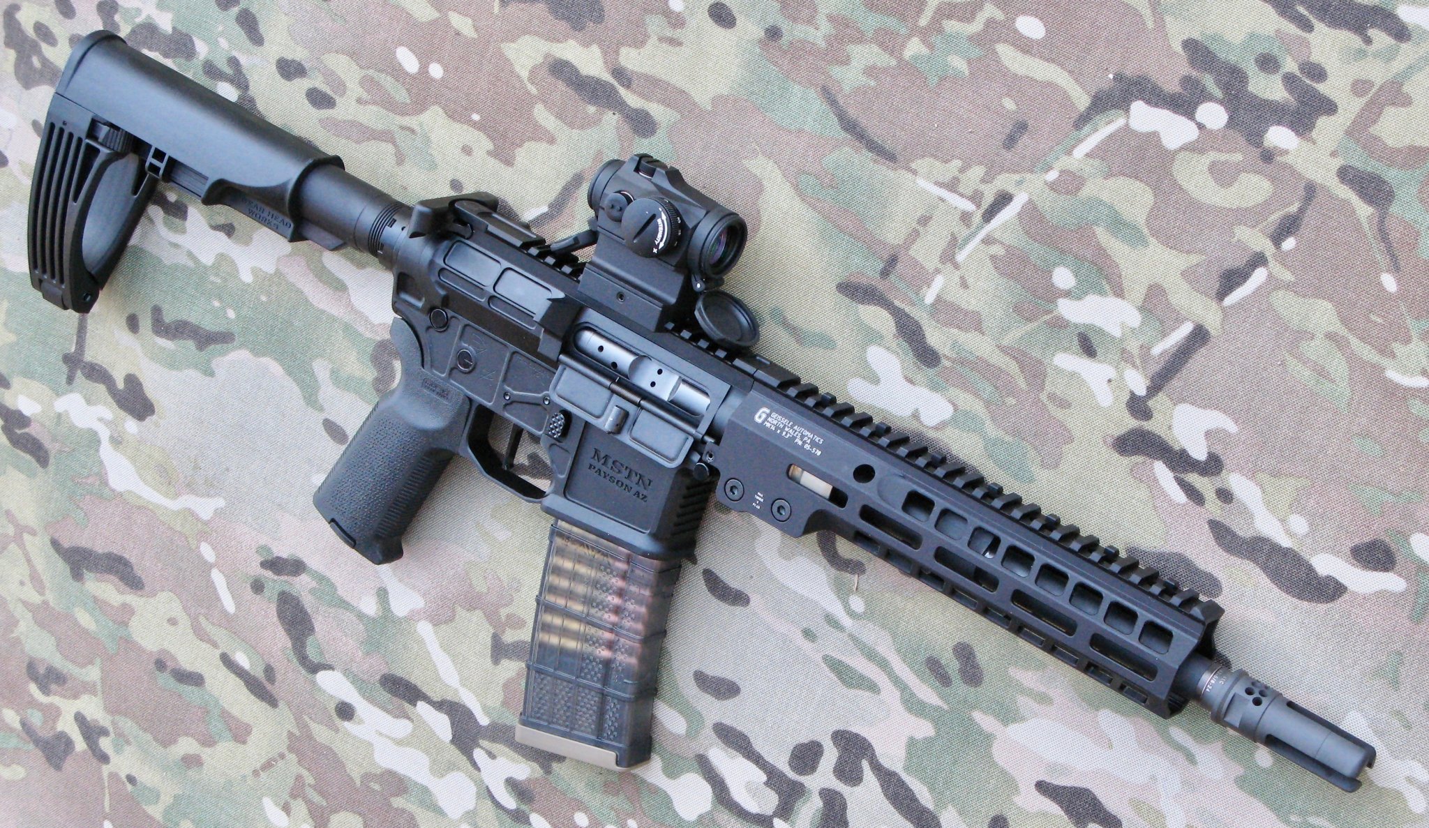

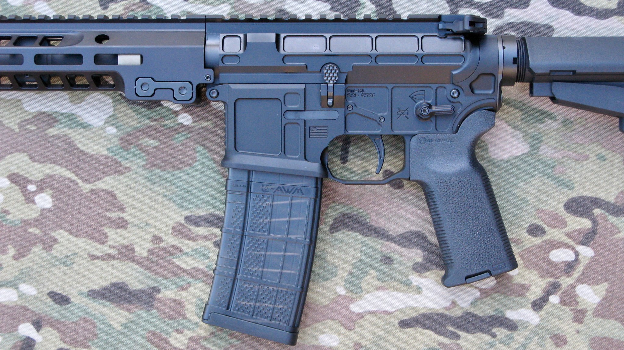

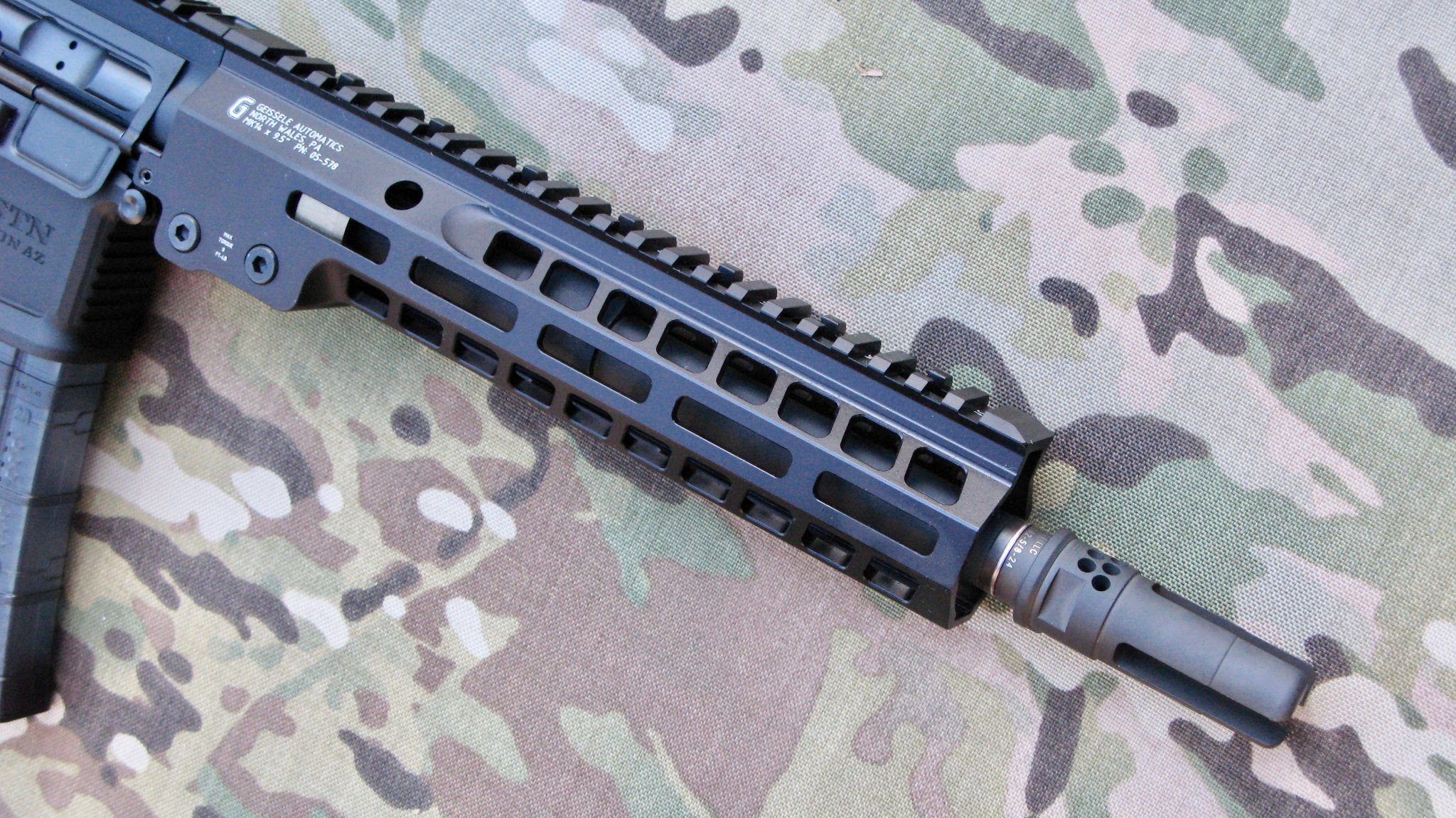

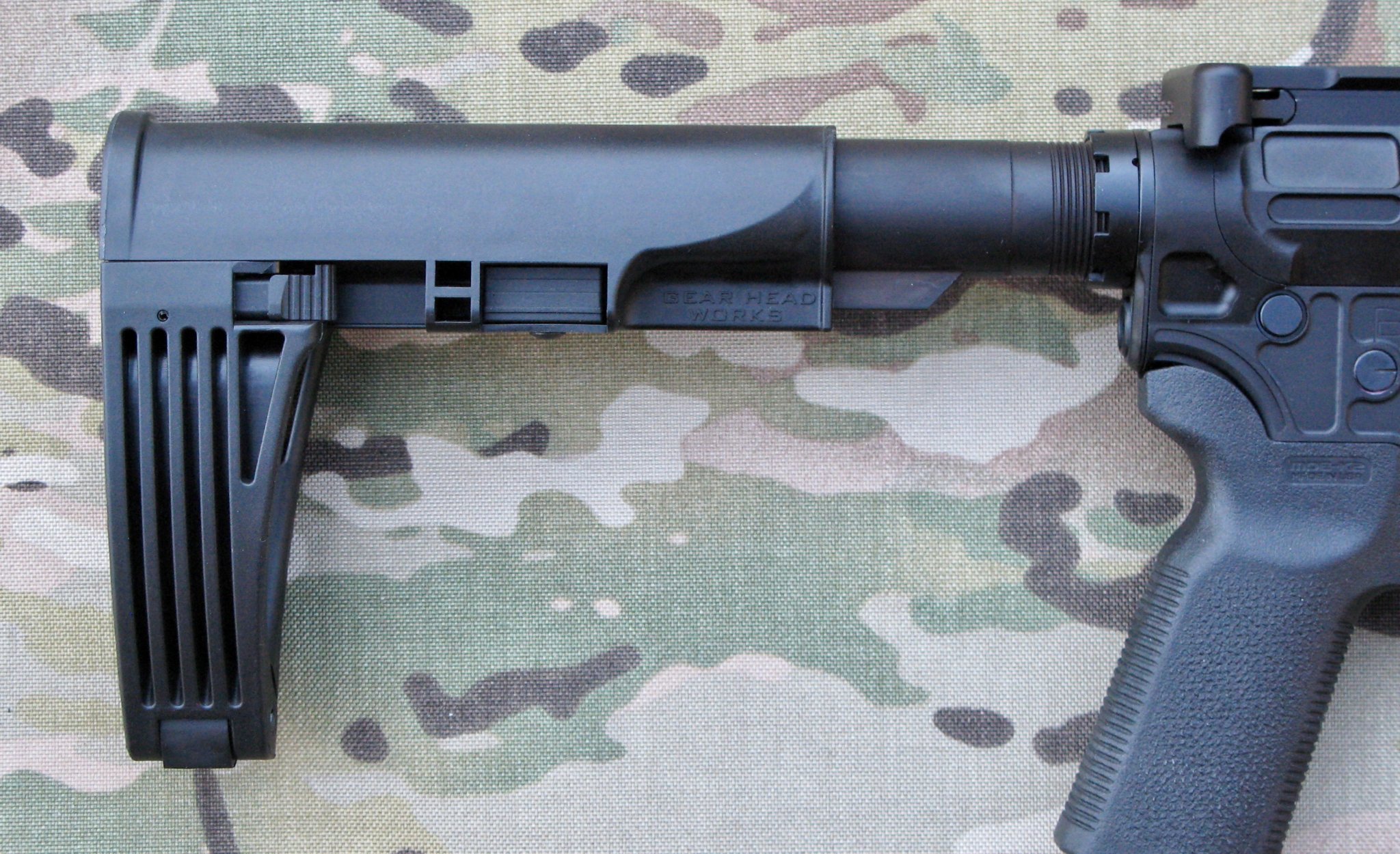

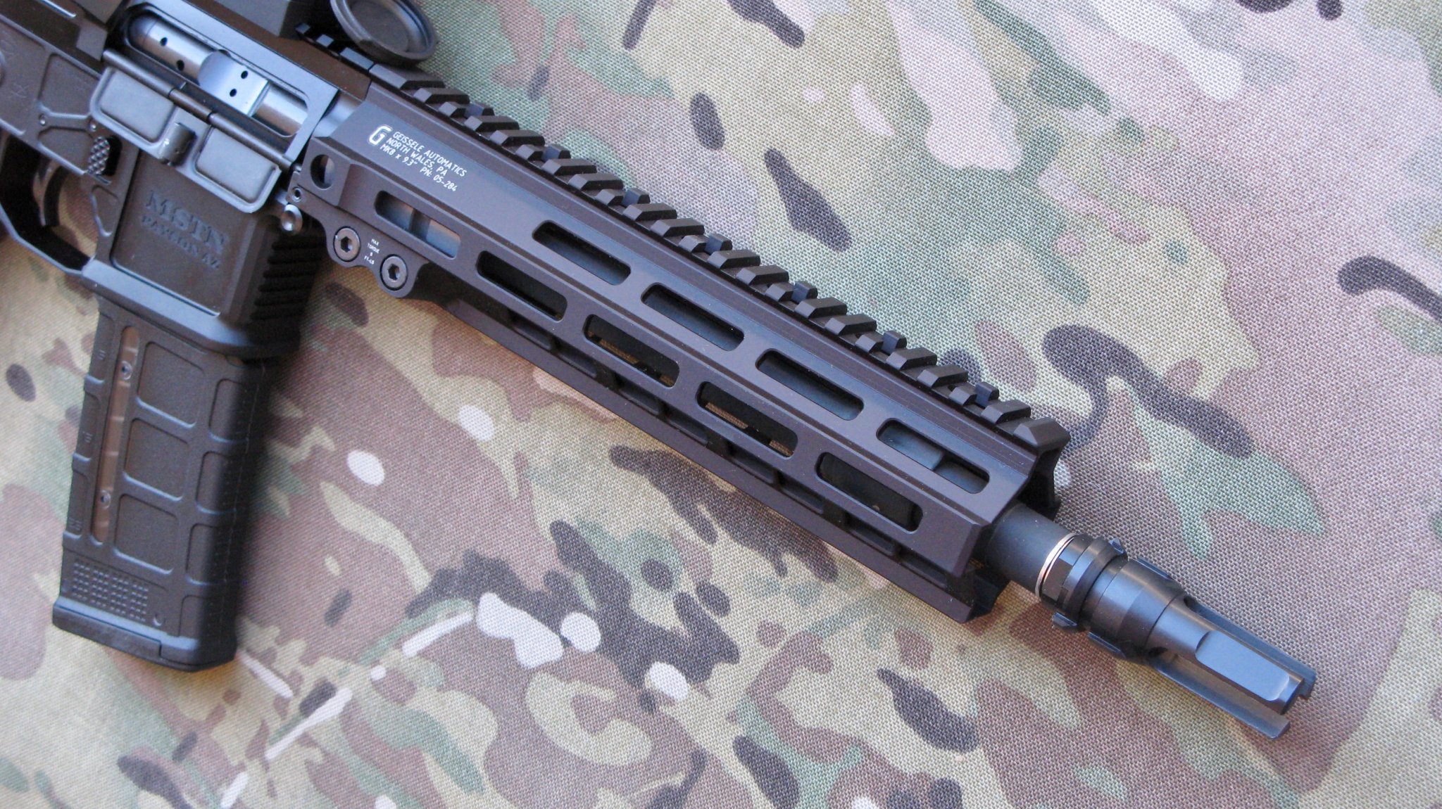

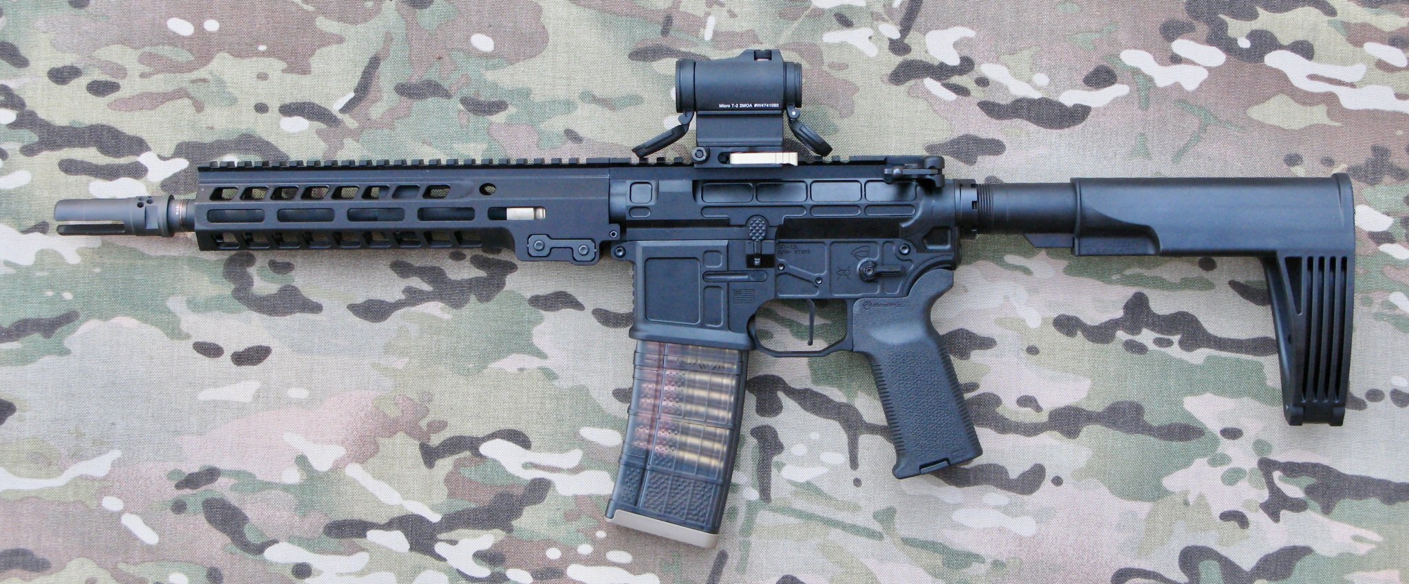

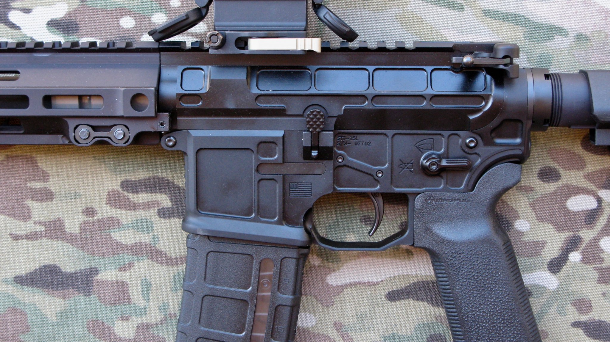

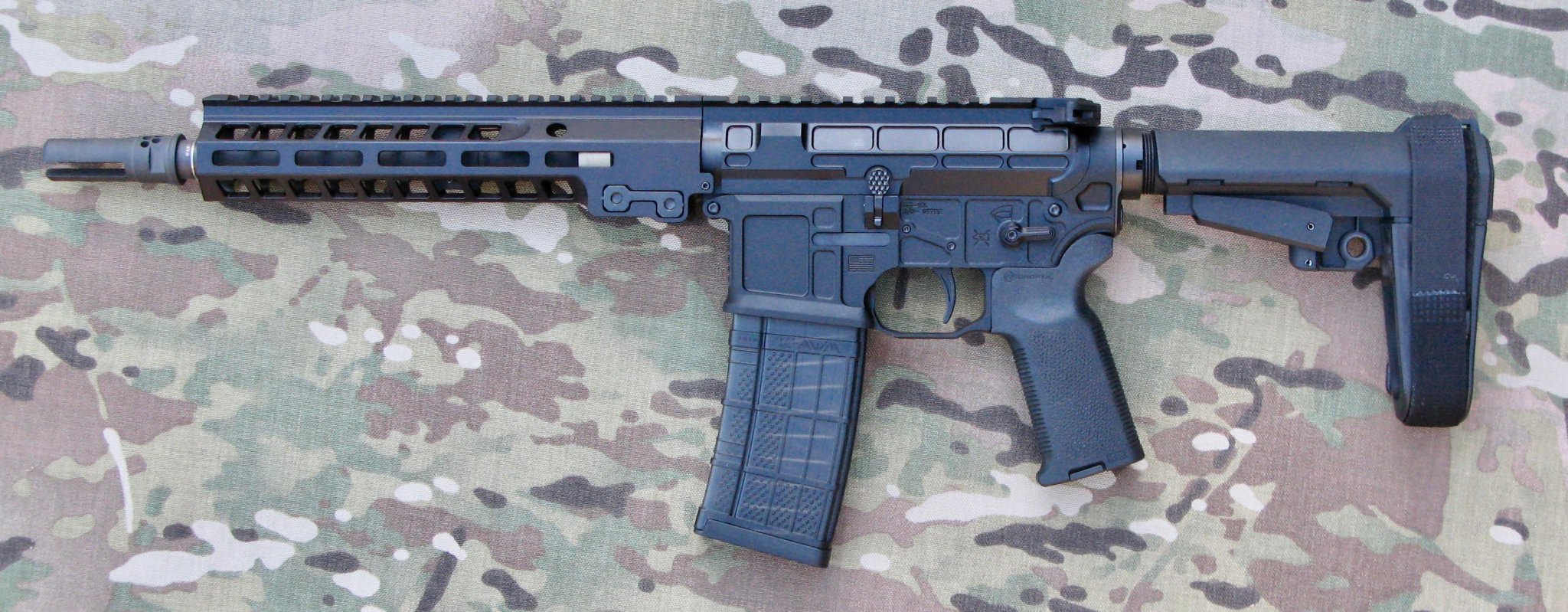

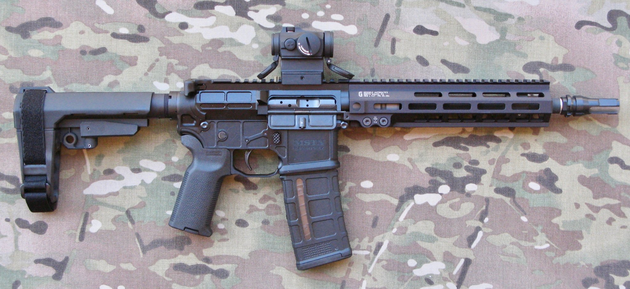

It's great having parts in stock again. This is a .300 Blackout PDW/Pistol, built around the best components available:SanTan Tactical STT-15L billet receiver set; V Seven 10.25" SS barrel, coated Black, with feed ramps contoured and polished; Geissele MK 14 rail; Surefire WarComp; PRI Gas Buster charging handle; Young MFG centerless ground, hard chromed bolt carrier and gas key, both Ionbond DLC coated; JP Enhanced Bolt Kit; DLC coated, as well; just about every titanium part V Seven makes - DLC coated - push pins, safety, mag release, fire control pins, receiver end plate with nut, grip screw, buffer stop; V Seven S7 tool steel bolt catch; TriggerTech Competitive 3.5 LB trigger; GearHead Works Mod 2 pistol brace; JP polished recoil spring pushing a V Seven H1 buffer; Magpul pistol grip; Lancer translucent .300 Blackout magazine; Aimpoint T-1 in 39mm throw lever mount.

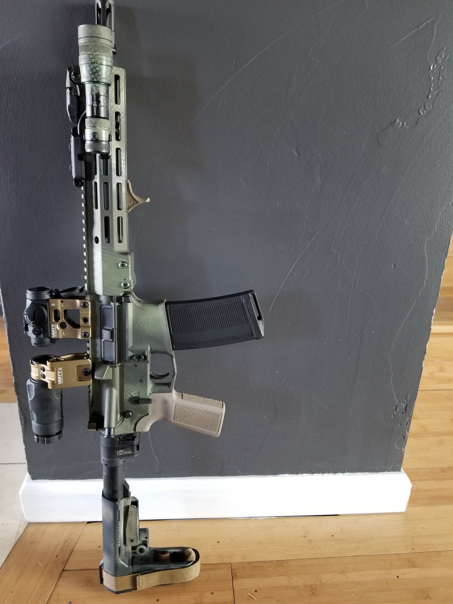

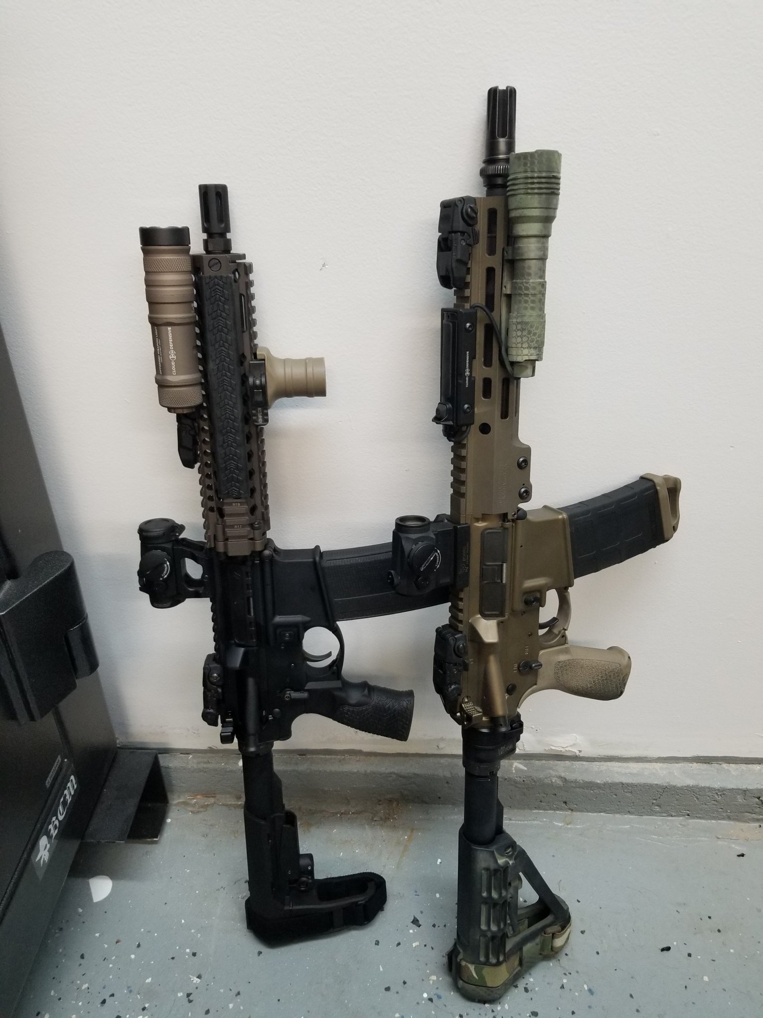

Small and large mini Recce. I have a “medium” that is on order with a 13.7” barrel.
large is a BCM Recce 14 (14.5” p&w) with a CD Rein Micro, Badger 1.93” Condition 1 holding a Nightforce NX8 and offset DPP.
small is a DSG Arms/Seekins 10.5” with Silencerco Omega, MI QD scope mount holding a Steiner P4Xi, Arisaka 35 offset mount and Holosun 507C X2, Poverty pony lower with some Magpul stuff and a Geissele trigger.

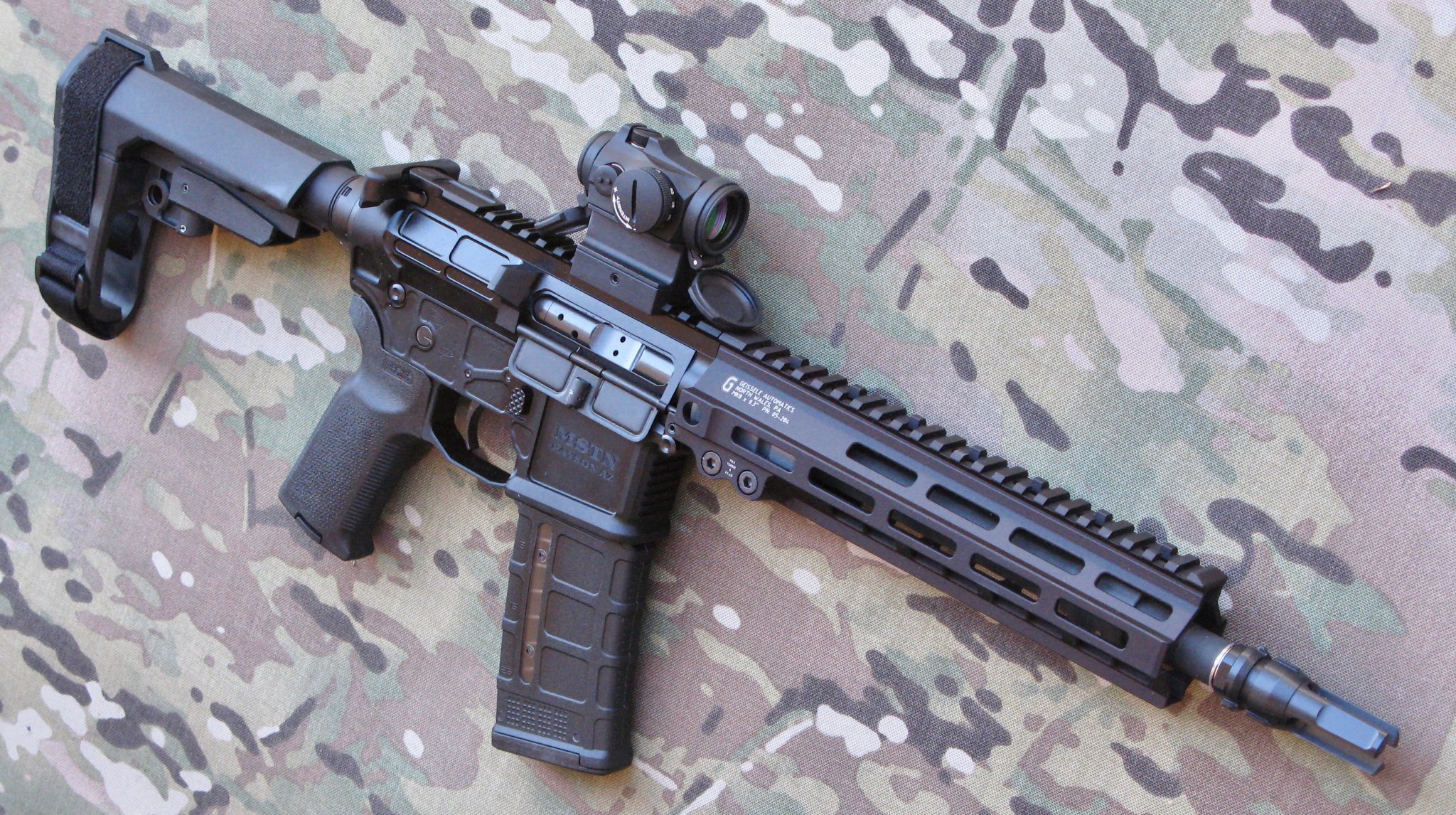

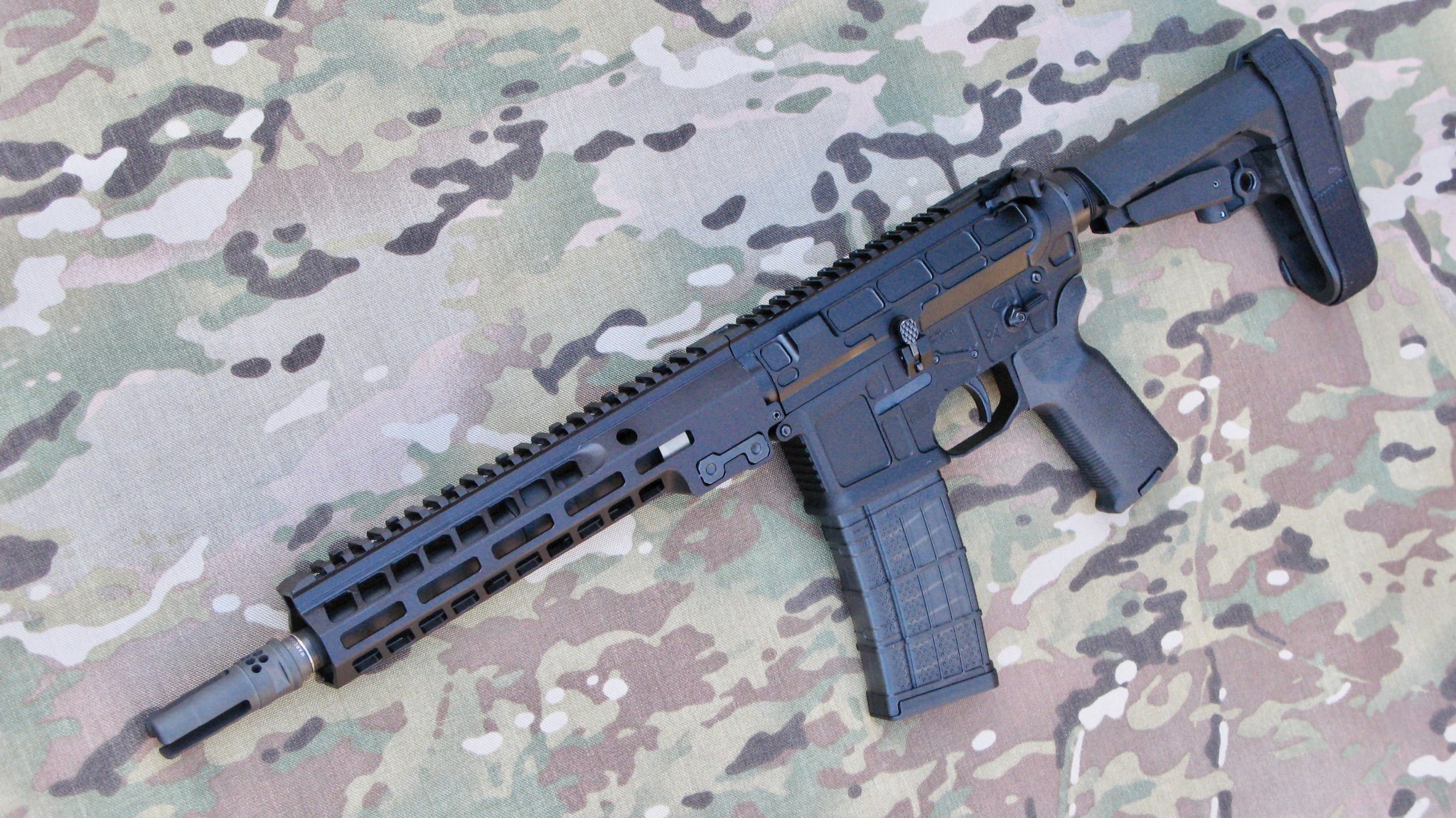

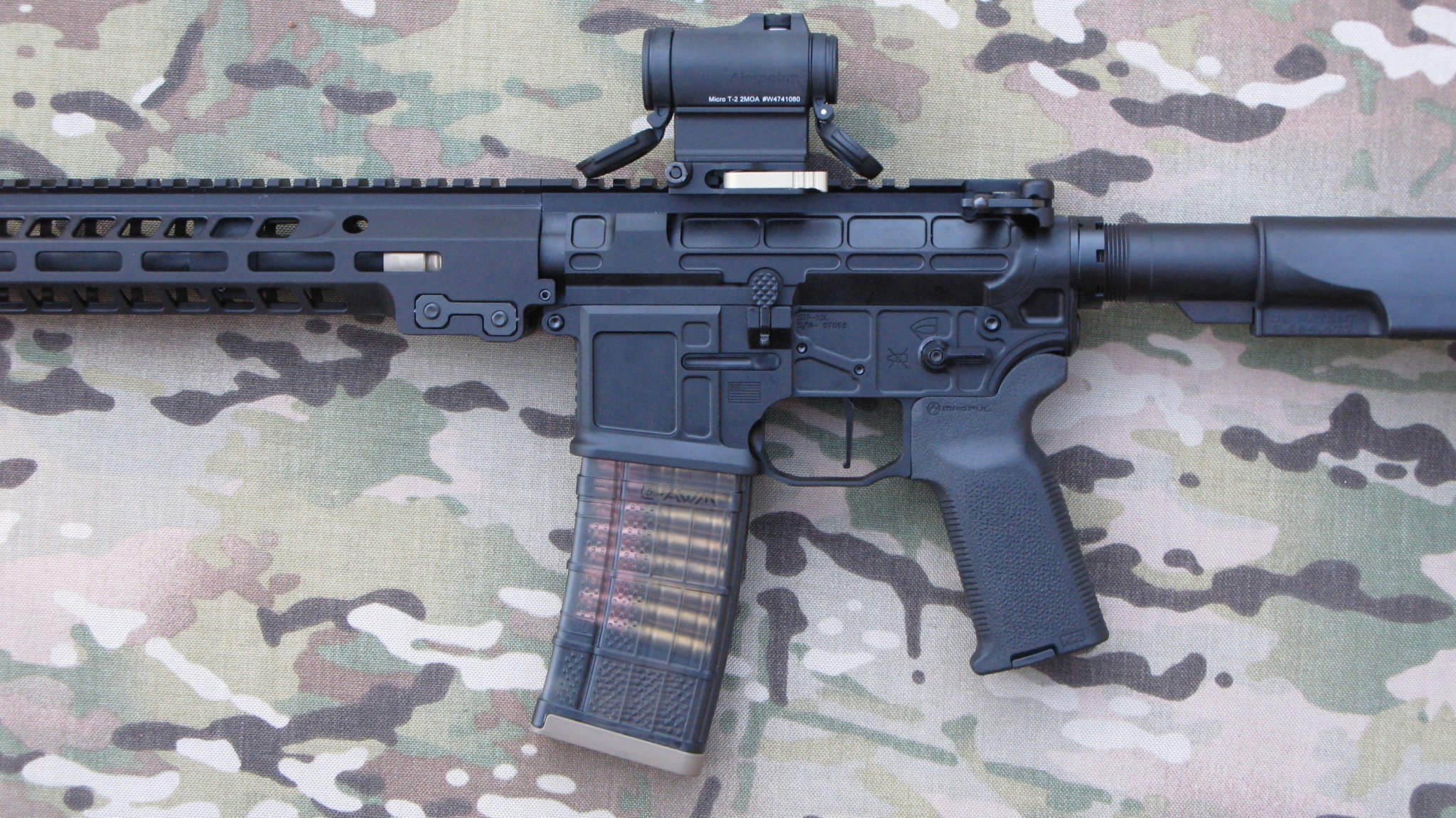

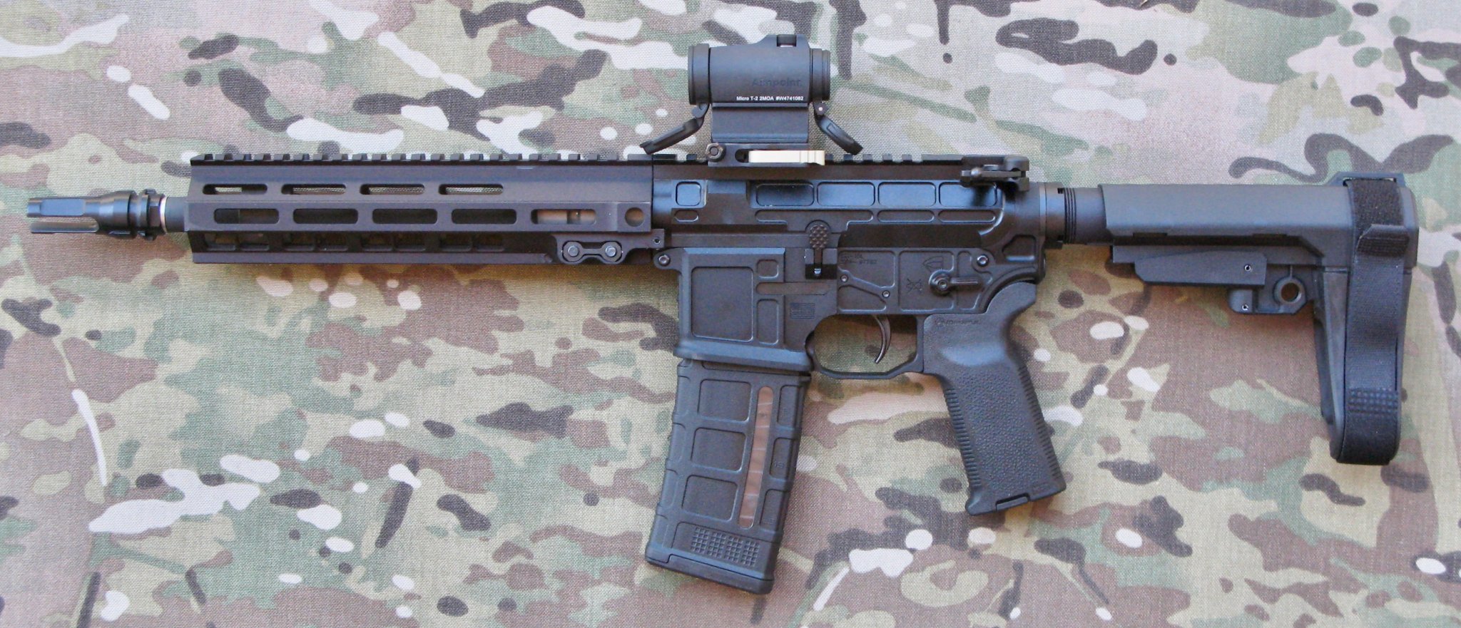

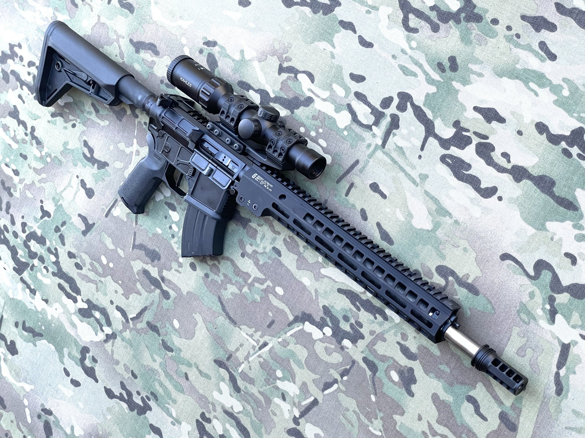

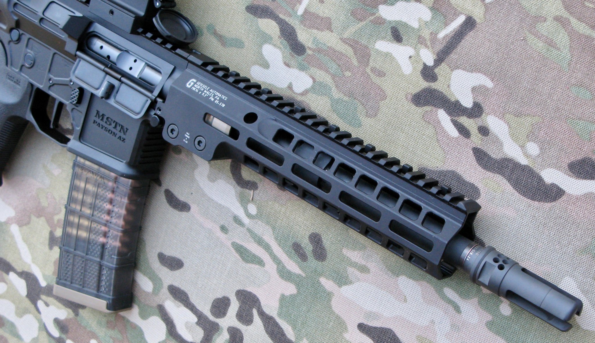

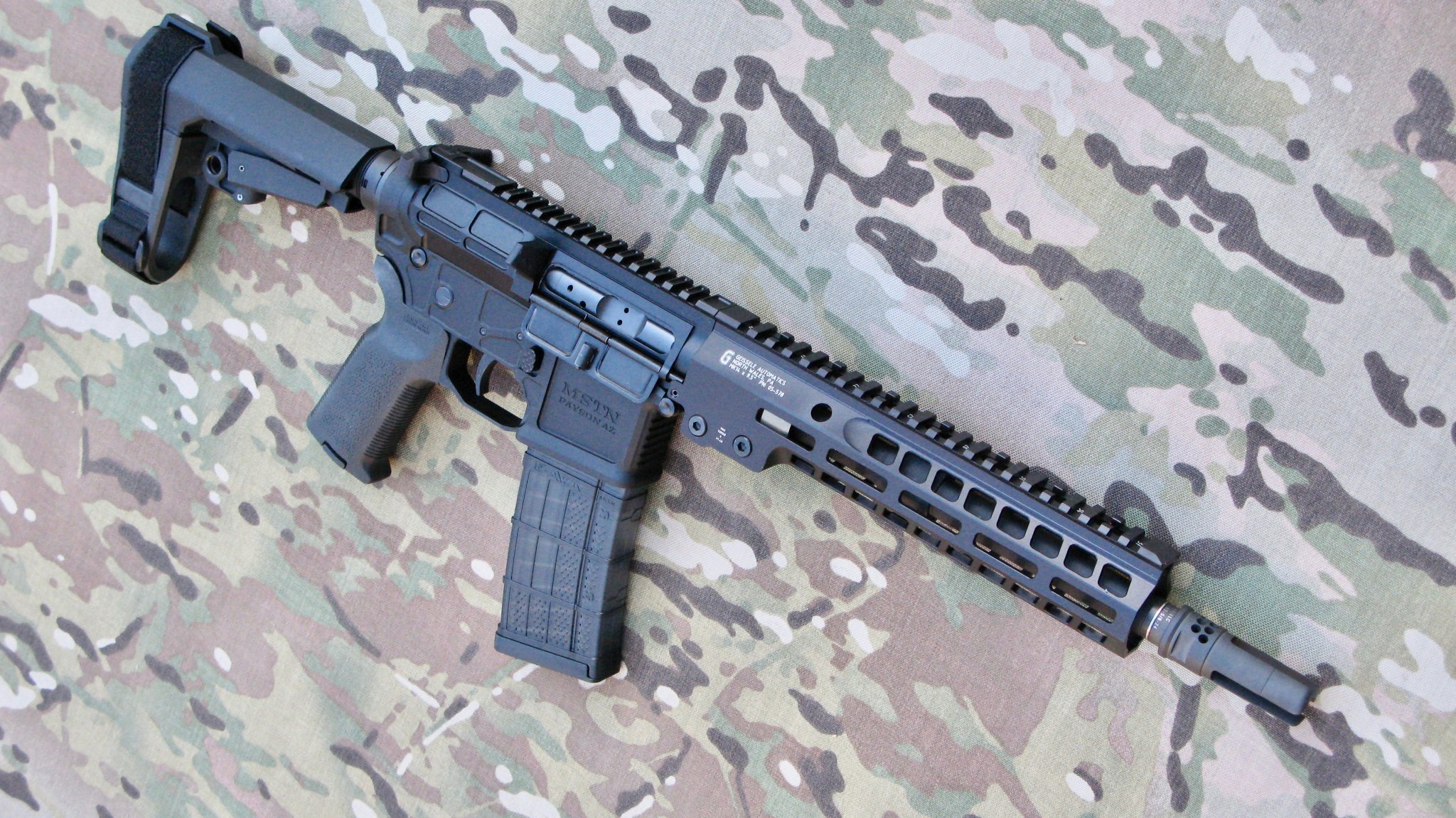

Everybody needs a 5.56 Blaster around. Here's one just finished in a "pistol"/PDW format with all top shelf components: StanTan Tactical STT-15L billet receiver set; Noveske 10.5" hammer forged, chrome lined barrel with contoured and polished feed ramps; Dead Air flash hider; Geissele MK 8 rail - for those days the gun gets HOT; PRI Gas Buster charging handle; a trick bolt carrier group consisting of a JP Enhanced Bolt in a Young MFG hard chromed bolt carrier, all Ionbond DLC coated; DHD DLC coated push pins, receiver end plate and tube nut, short throw safety, and magazine release; Geissele SSA trigger; SBA3 pistol brace; JP SCS H2 Silent Captured Spring (SCS); Magpul Pmag and K2 grip.

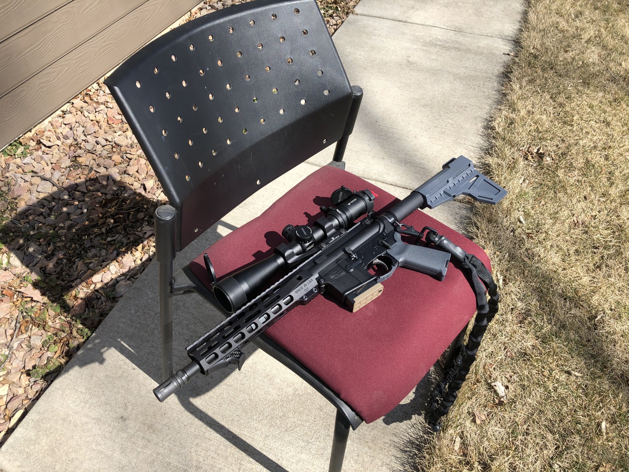

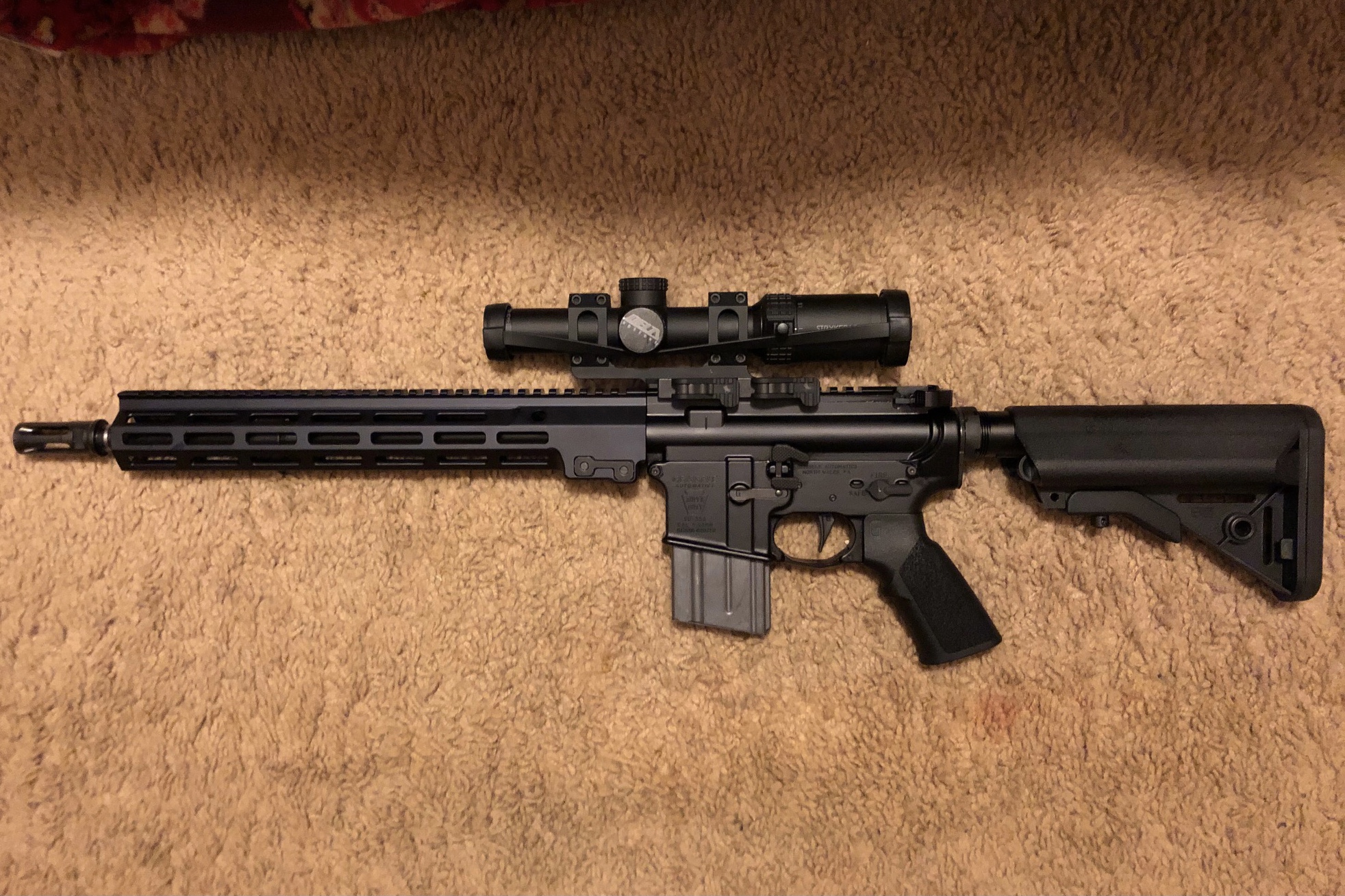

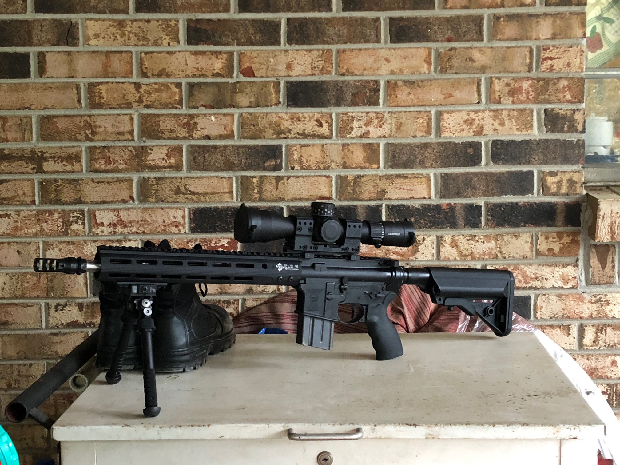

This is my two year Black Friday build and I’m under 1000 on the rifle.
Geissele Receiver set 150.00
WOA 14.5 Barrel and matched bolt 200.00
Superlative gas block 80.00
DeadAir break 75.00
Radian CH 70.00
LMT Enhanced carrier 150.00
MBT2 80.00
Wilson Combat Lower part kit 35.00
B5 SOPMOD and DSG enhanced assembly 135.00
i have not made it to the range yet.

Dang. So that's what being patient could net me? I might try it some time.

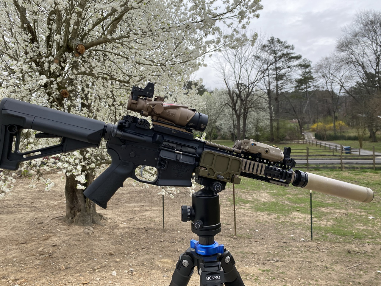

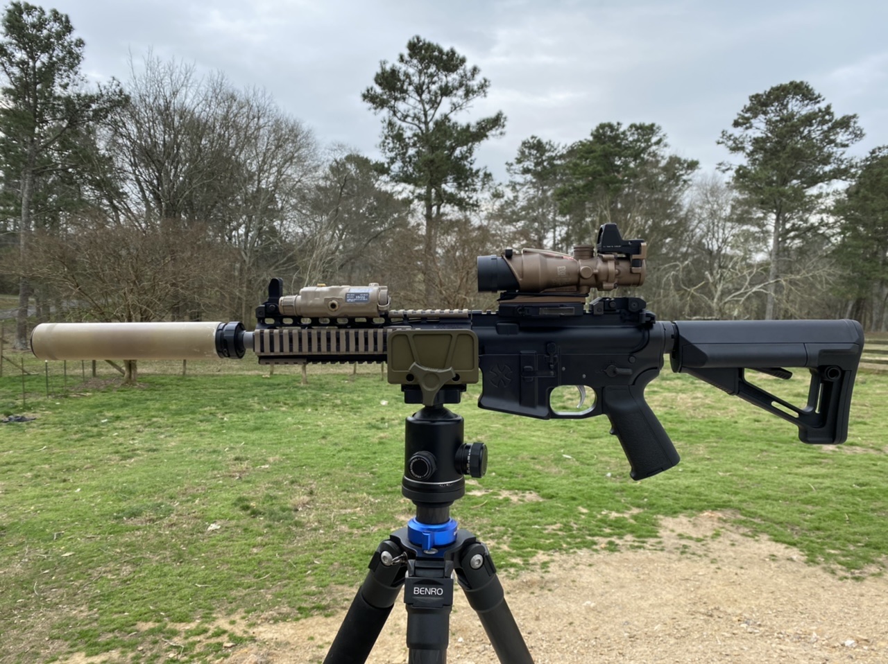

Full Factory 300BLK Noveske 10.5” Upper mated to a factory Noveske N4 lower (separated from a new, unfired 13.7” pinned Noveske Infidel factory rifle). I did a Form-1 SBR on the lower last year, so yes, it’s a legit SBR.
Not a big fan of Rail Panels, but they came with the upper (received today) and the installed brake was an ASR, which just happens to be one of the many mounts I have for my F1 suppressors.
Not exactly sure how I’ll finish this one off, but I had a spare ACOG ECOS kicking around and a spare brand new PEQ-15 still in sealed pouch, so I figured it would do for now until my BOSS-XE arrives. 😁
Gonna eventually be my go-to HD and Yote gun.

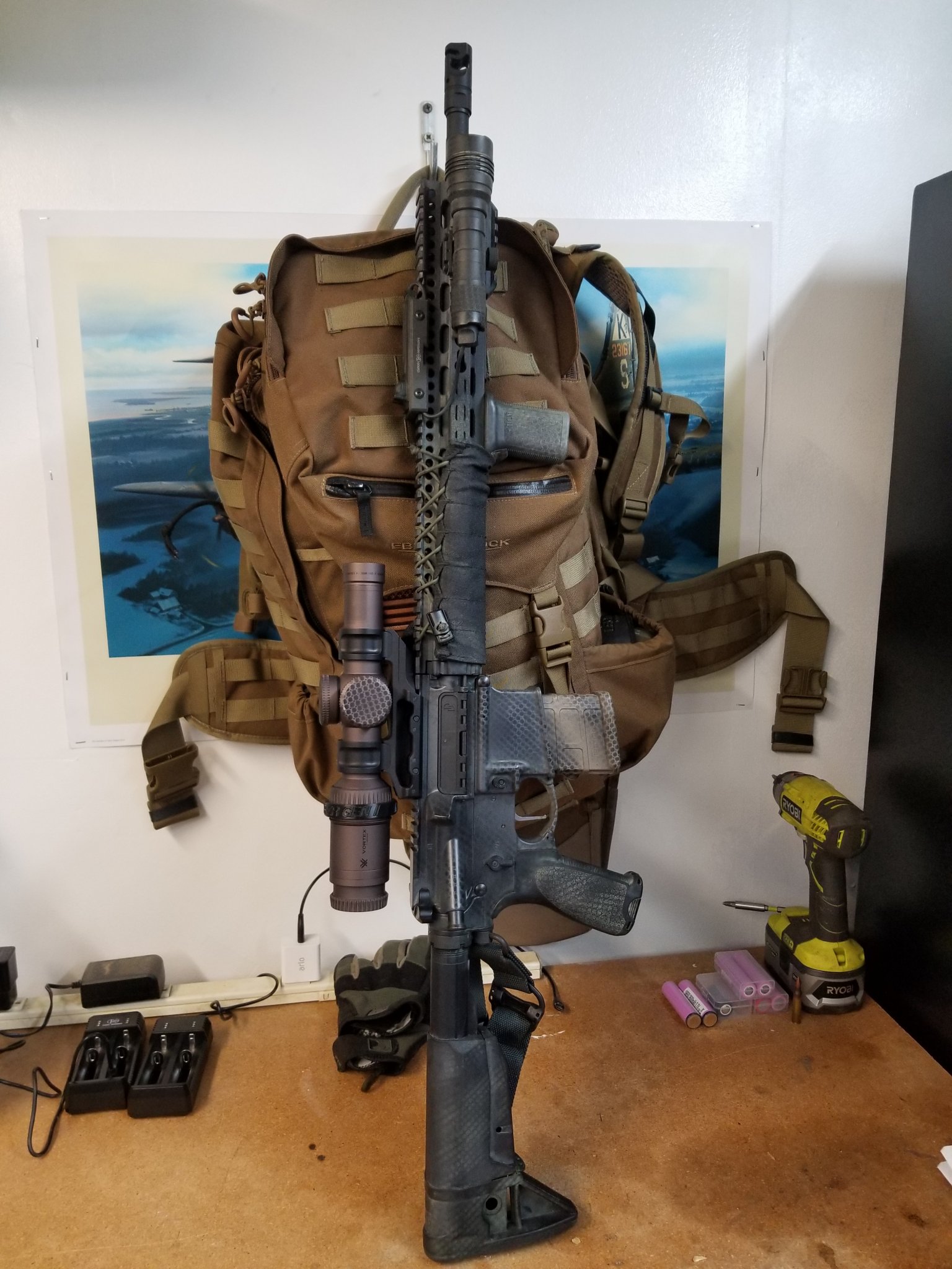

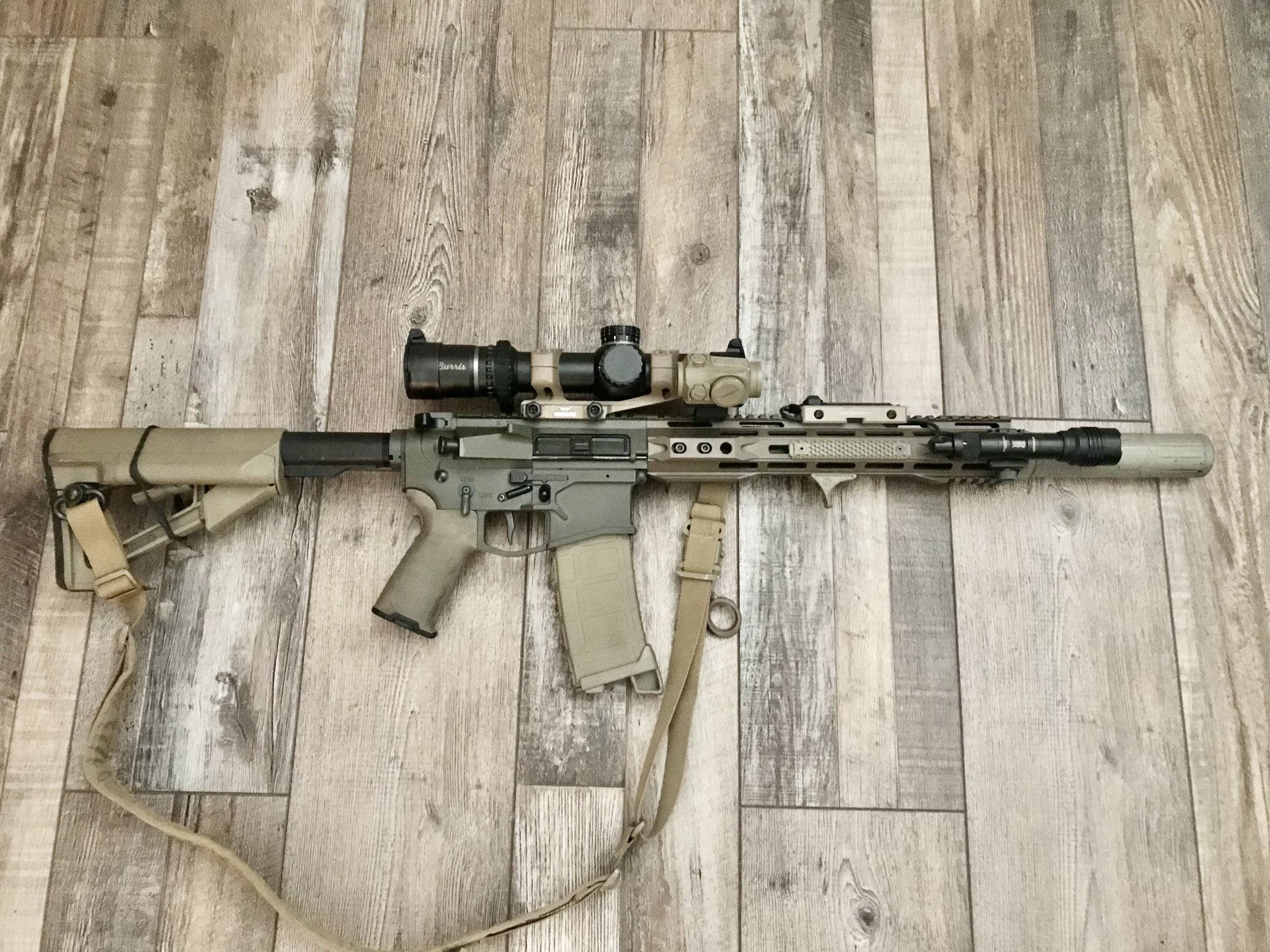

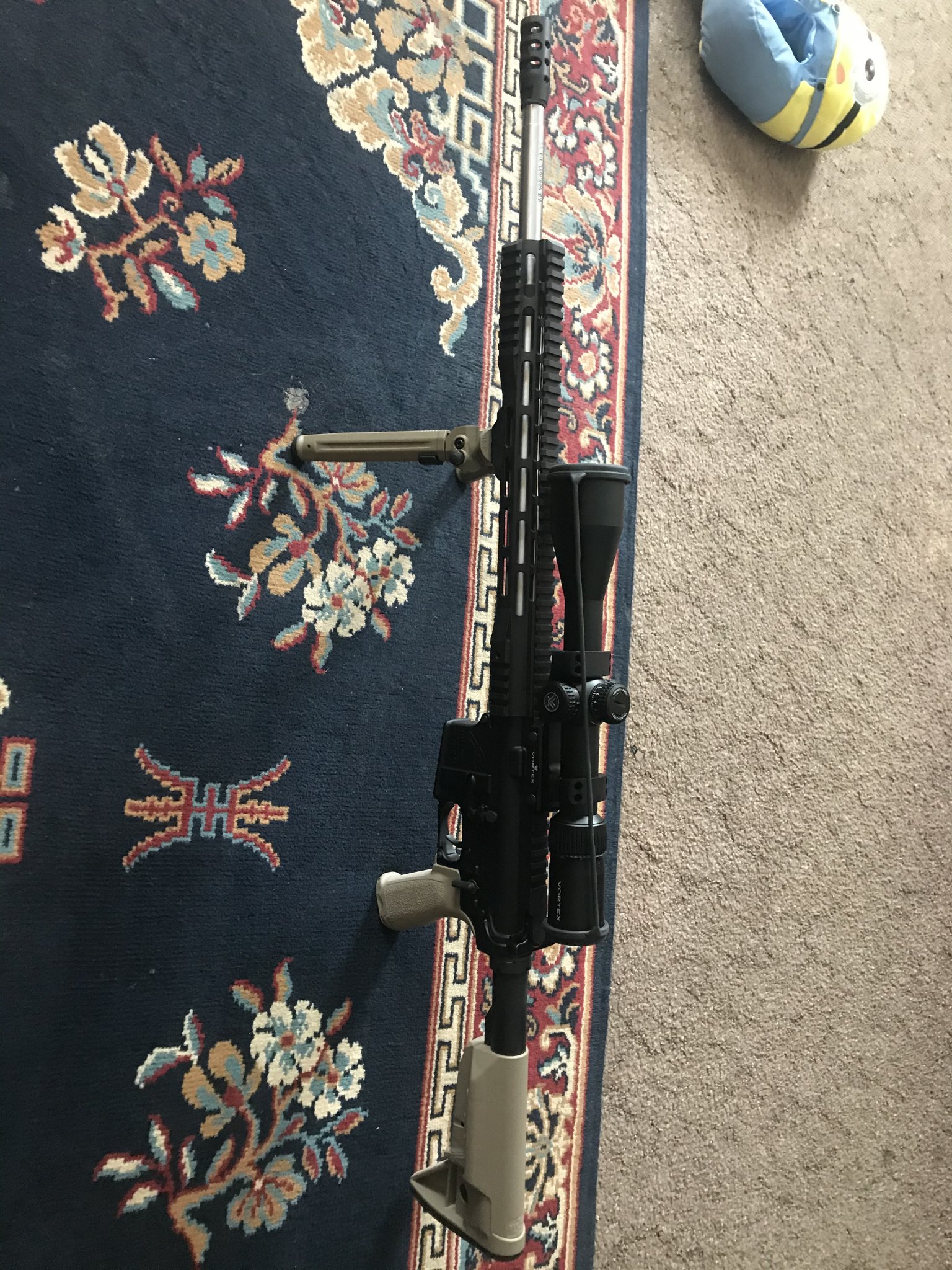

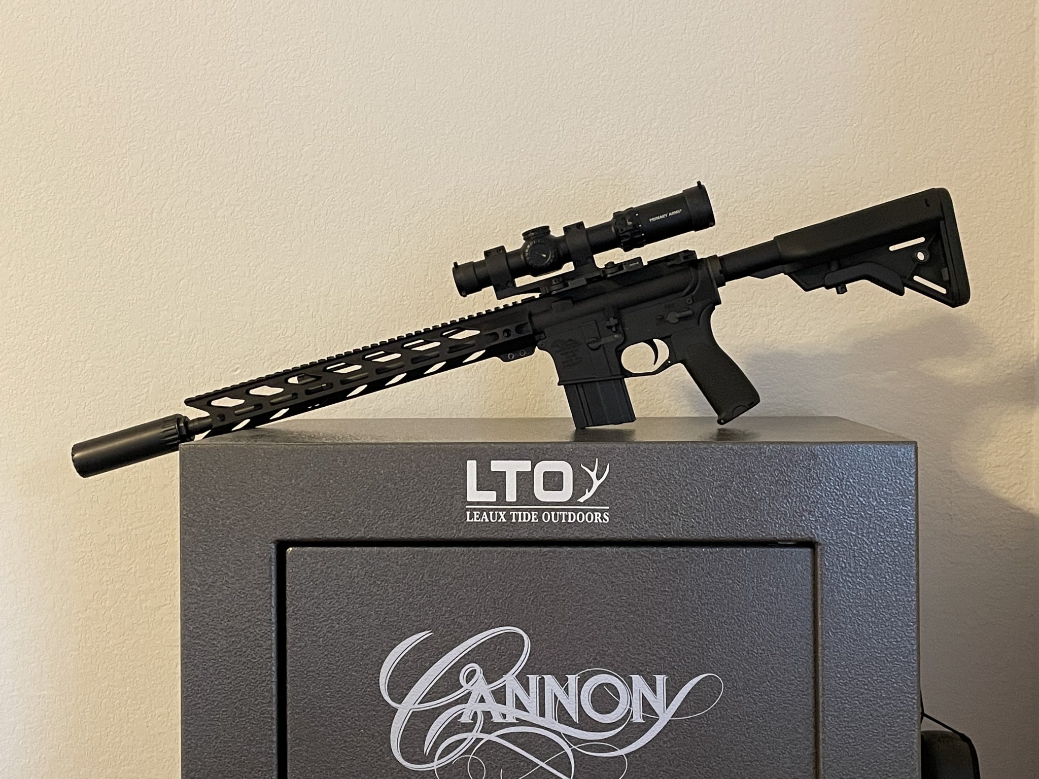

Build list
NBS stripped upper
Strike Industries dust cover / forward assist
Bcm gunfighter charging handle
16” Faxon barrel 6.5 Grendel II
Prime Weaponry bcg
Seekins adjustable gas block
Ar-Stoner gas tube
15” Stngr hand guard
Area 419 hell fire suppressor adapter
Anderson lower
Bcm gunfighter mod 1 grip
Enhanced lower parts kit
3 lbs single stage mil spec fire control
Carbine length buffer kit
Bcm b5 stock
Primary Arms Slx 1-8x24 ffp
Larue QD mount
Yhm Resonator K suppressor
This will be my dedicated hog / coyote rifle, can’t wait to get out and shoot it!

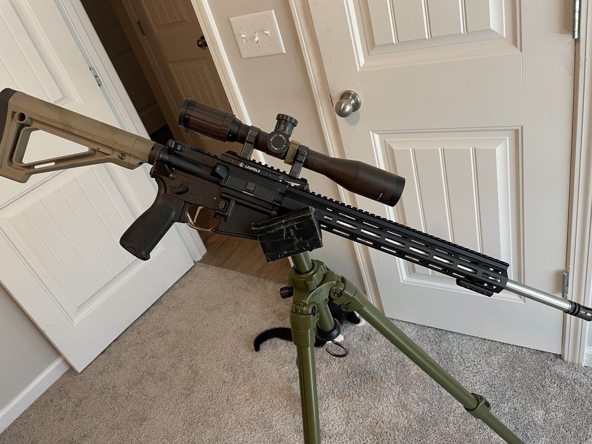

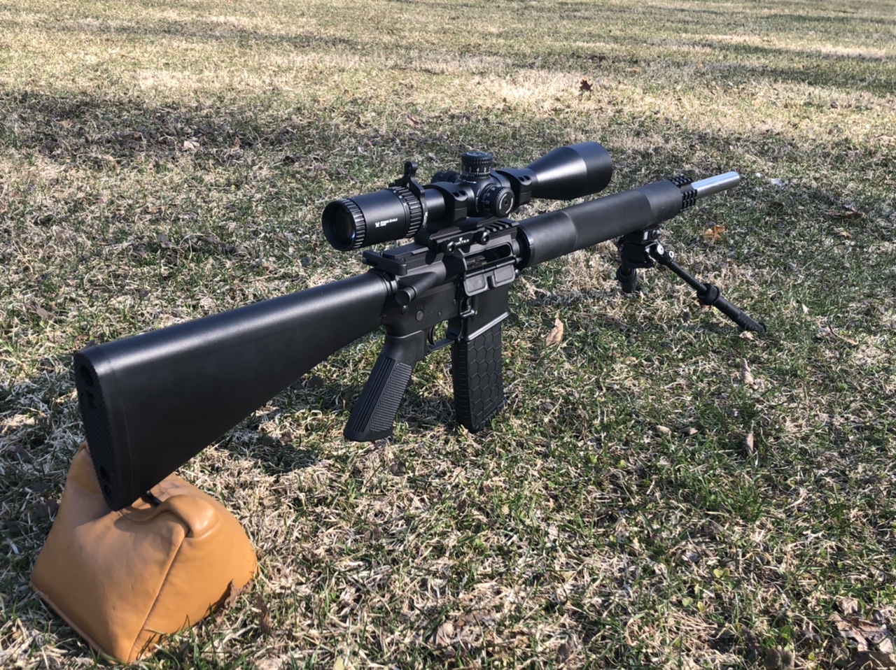

New WOA SPR 20”, rifle gassed, 1:7 twist upper. First range outing a few weeks ago was disappointing. Took it out today and put another 20 rounds of IMI 77 grain through it. Shot considerably better. I attribute the first outing solely to the shooter.
The IMI had 4 5 shot groups at 1.125, 1.06, .625, and 1.06”. Much happier with the system performance today and it gave me a glimpse of my potential behind the rifle. Would eventually like to step up my glass game at some point.
PMC 55 grain blaster ammo shot 2 5 shot groups at 2 and 1.43”. Actually happy with the 1.43” considering the ammo.
Also shout out to WOA on overdelivering. Quoted an 8-12 week lead time and shipped it to me in 6.
Looking forward to getting more reps in with this.

Which hipster were you in the Benro catalog? Didn't see your rifle on that site... They need a pic of you doing parkour with one at the Boaz Factory Outlet!
How do you like the Steiner and arisaka/holson setup? contemplating the Steiner with an offset in my next build but havent seen anyone else with that combo to get feedback from.

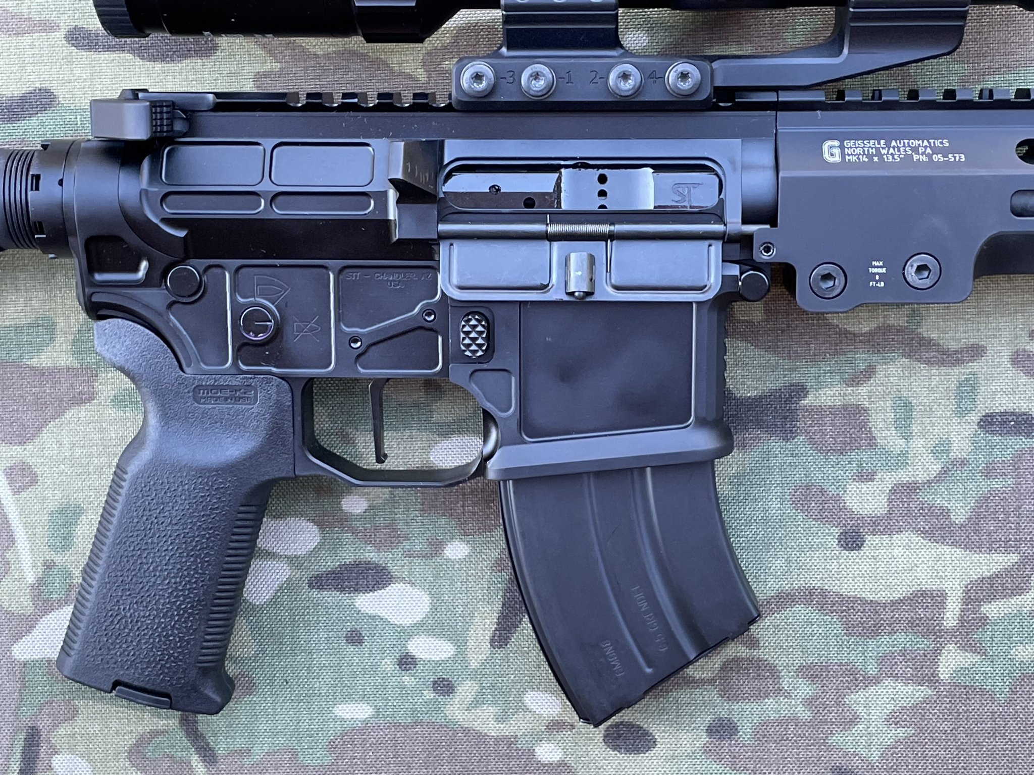

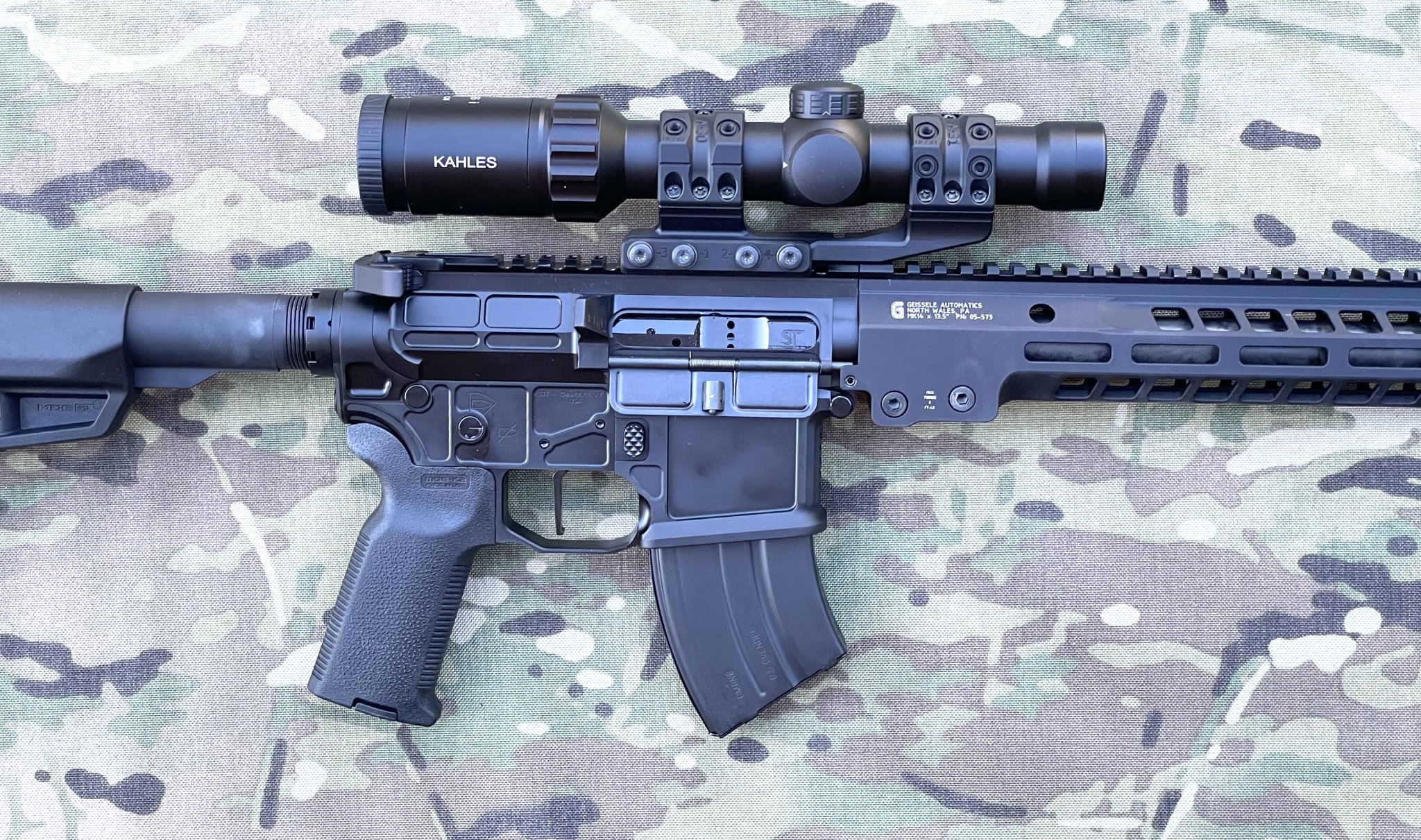

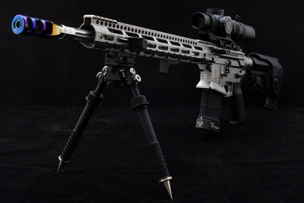

In a custom AR' build, you're free to select whatever components you want. I go for quality. I can only build fifty guns a year without having to charge the 10% Federal Excise Tax, and I want each of them to be memorable. This 5 LB 9 OZ .300 Blackout started on the bench with a billet SanTan STT-15L receiver set. There are a number of excellent billet receiver sets being produced these days. I've tried most of the big names. I don't think anyone can top SanTan Tactical's quality and appearance, regardless of price. The STT-15L receiver set is one of the lighter weight variants out there, too. No one to my knowledge makes a better .300 Blackout barrel than V Seven, either. V Seven is the ONLY outfit that uses appropriately sized feed ramps in their .300 Blackout barrel extensions. Their barrels are all SS with 1x7 twist, so shooting subsonic presents zero bullet stability issues. V Seven gas blocks fit up perfectly every time, too. This barrel is 10.25", and coated in Black KG Kote. Geissele provided the slick MK 14 9. 3" rail. A Surefire WarComp sits out front. It's a top quality flash suppressor, but if you need some other interface with your particular sound suppressor, we can work that out. The charging handle is a BCM Gunfighter 3B (long latch). The bolt carrier is from Young MFG - first forged, then centerless ground, then hard chromed. I didn't stop there and had the carrier and gas kety Ionbond DLC coated. I torque and stake the gas key myself. The bolt is the impossible to find JP Enhanced bolt Kit - also Ionbond DLC coated. Headspace is checked with PTG gauges. The barrel feed ramps are contoured and polished mirror bright. The trigger is the LaRue MBT-2, a good deal at twice the list price. Various lower receiver components - mag release, bolt release, short throw safety, and push pins - are by Dark Hour Defense (aka DHD) - all Ionbond DLC coated. The pistol grip is the Magpul K2, a favorite of mine. The pistol brace is the SBA3, with H1 buffer. The thing I like about the SBA3 is if you want to SBR the gun, it's simple to remove the brace and slide on the stock of your choice.
