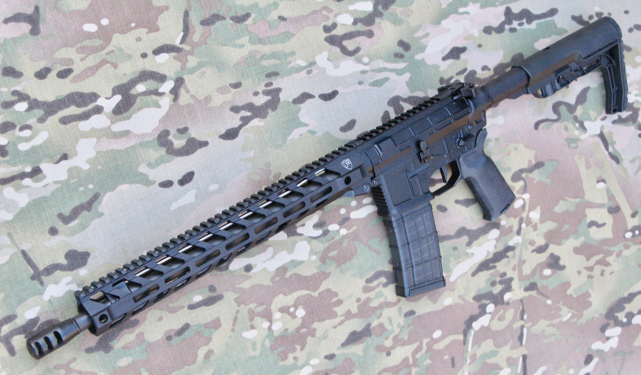

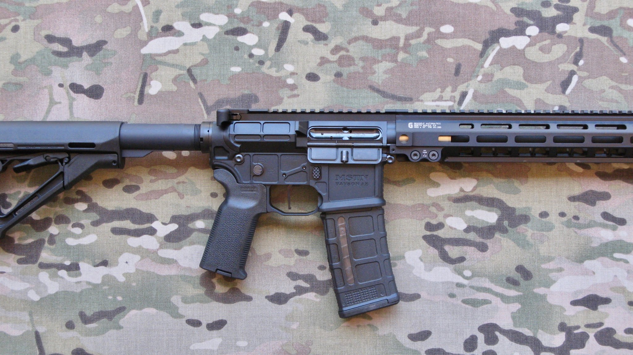

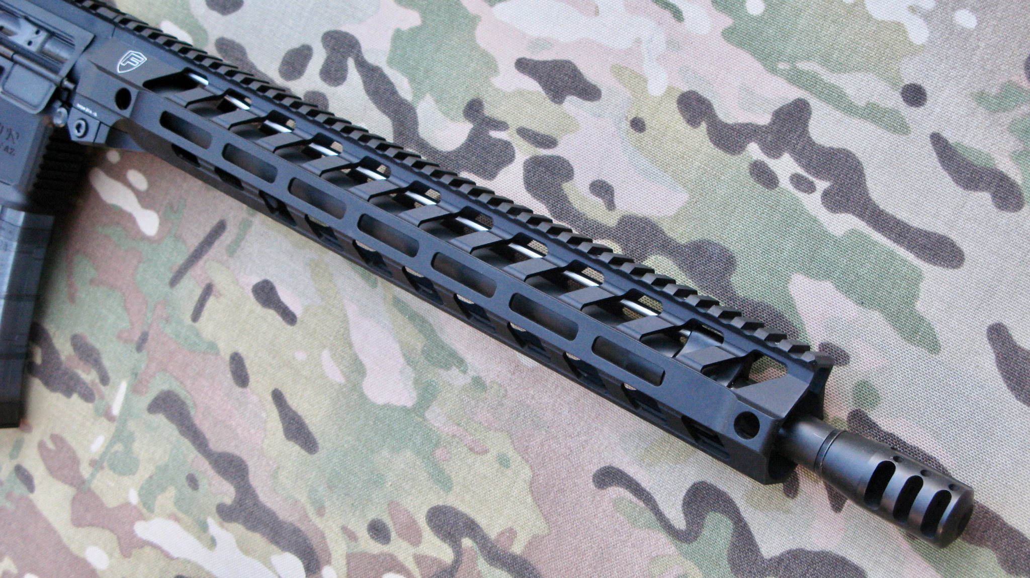

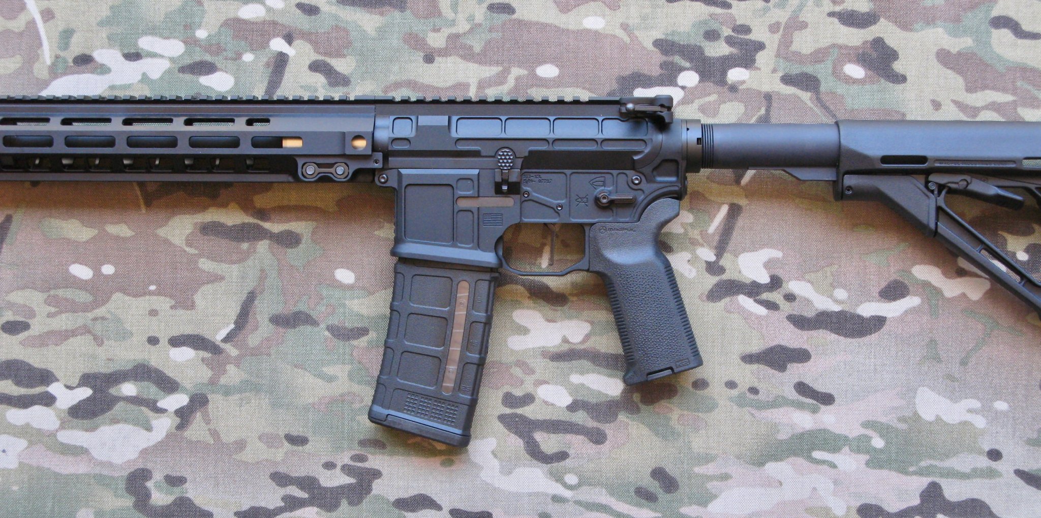

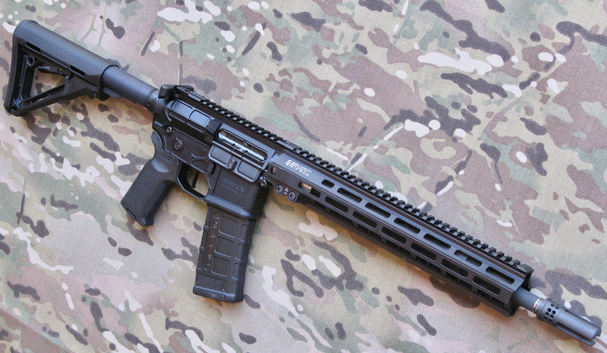

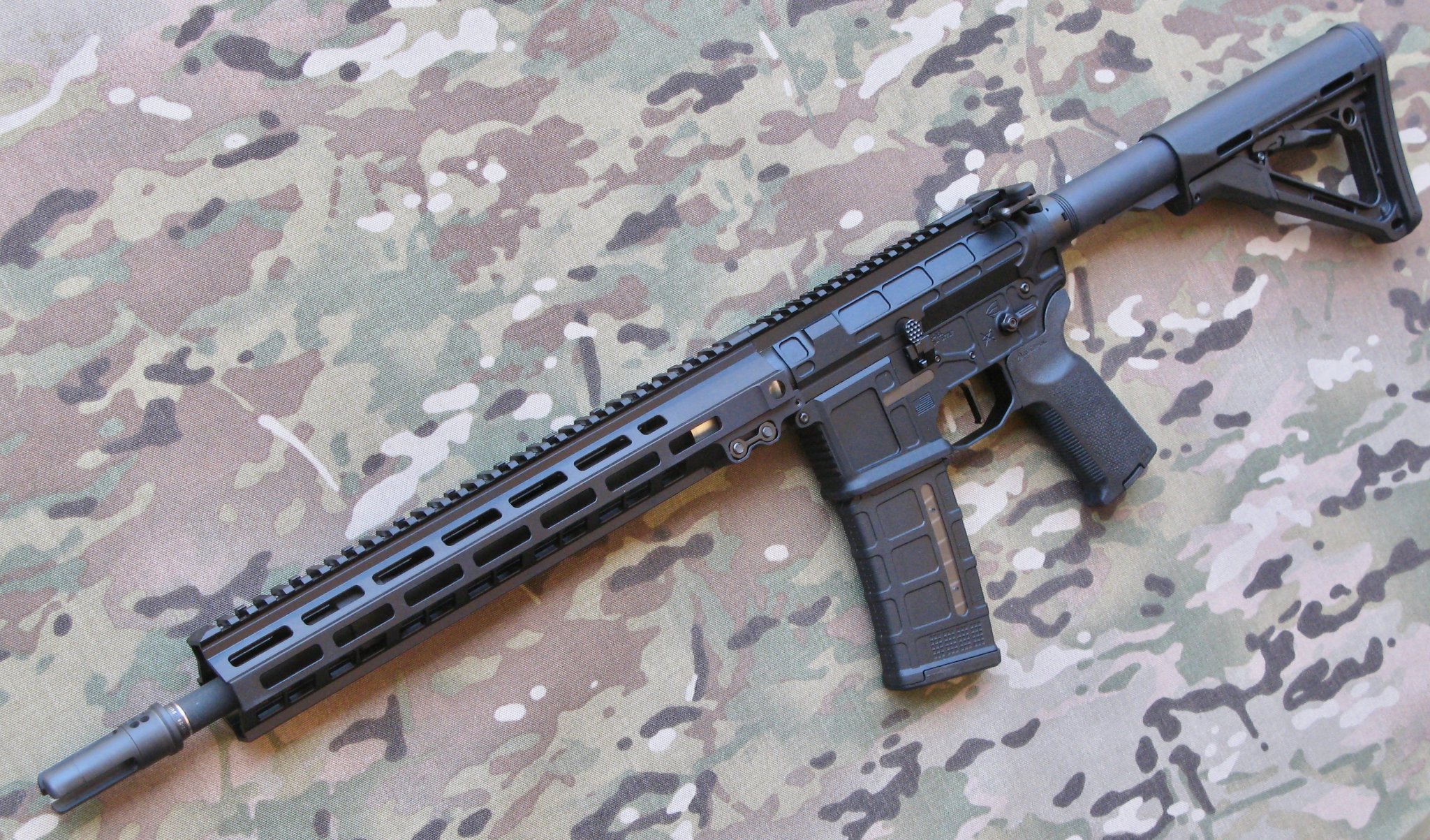

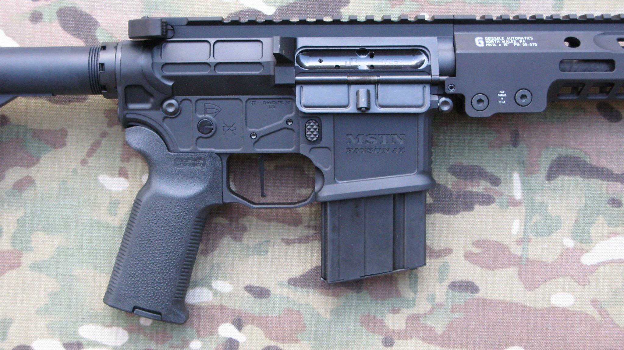

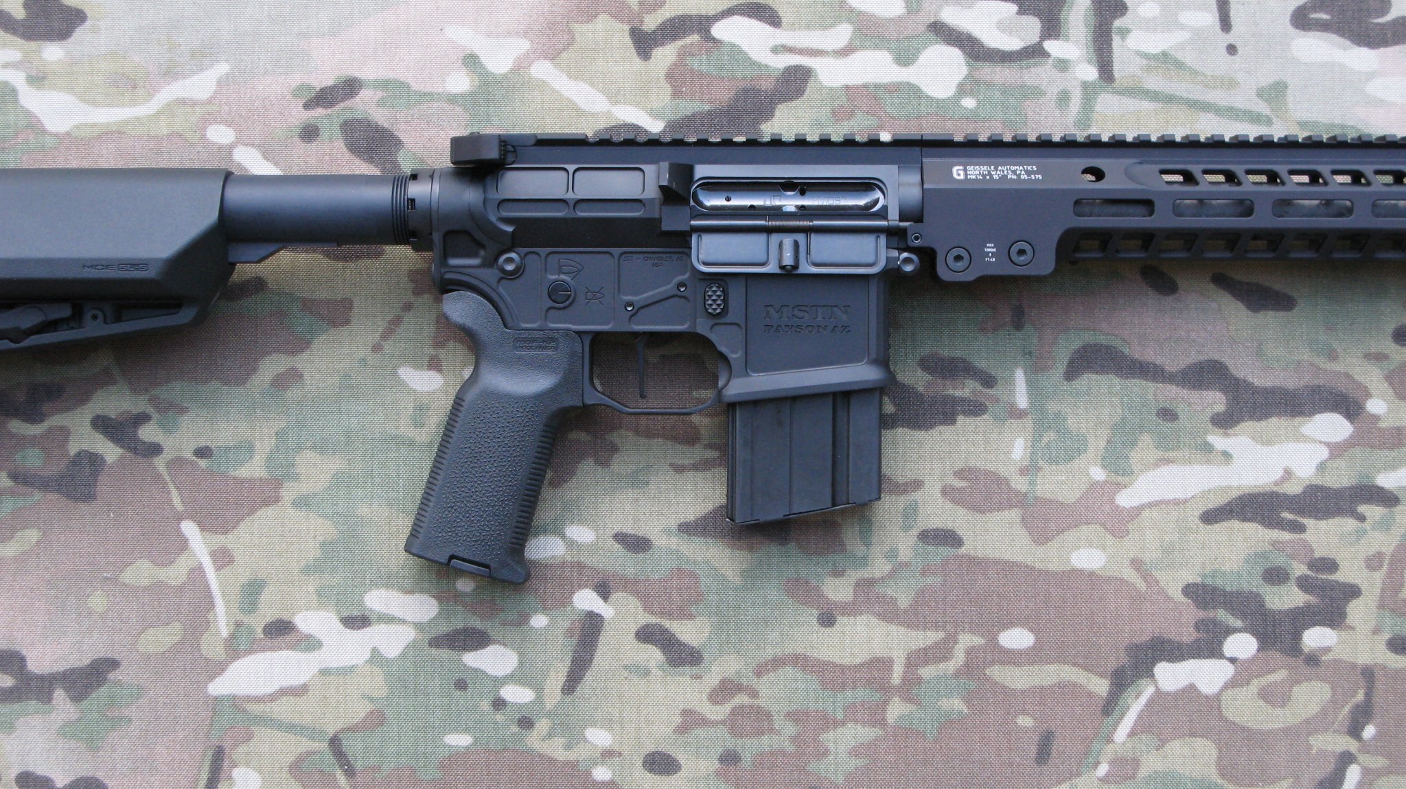

This rifle was built to be simultaneously accurate and EXTREMELY fast. It has enough weight to be stable (6 LB 3 OZ) yet it's not so heavy as to slow the shooter down transitioning from target to target. With suitable ammunition in this 16" Criterion chrome lined, rifle length gas system barrel, this will shoot sub-MOA for many, many thousands of rounds. Shooting a gun like this - FAST!!! - requires learning new techniques, because the gun doesn't communicate with the shooter as we are accustomed to experiencing. The rifle barely moves when fired. The rifle length gas system in a 16" barrel produces a gas pulse unlike that of shorter, more conventional set ups. The Geissele SD-3G competition style trigger doesn't stack - It just rolls through. The Young Manufacturing SuperLite bolt carrier's minimal mass gives up little in the way of tactile information when it cycles. Out on the muzzle, the PRI/MSTN brake, designed by shooting phenomenon Taran Butler, ensures the muzzle stays pretty much where it was a nanosecond before the bullet left the barrel. BTW, it is NOT objectionably loud like other brakes out there! Recoil is nothing and the muzzle merely quivers a little. And it is now time for the shooter to repeat the process. The foundation for this rifle is the SanTan Tactical STT-15L receiver set. I defy you to find a receiver better made - or more visually attractive. The Criterion chrome lined rifle length gas system 16" barrel is in my mind the best value out there in a go-fast completion style barrel. There are a lot of good brakes out there, but the PRI/MSTN QC Brake designed by 3-Gun Champion Taran Butler is my favorite. It does everything a brake needs to do in the braking department without being obnoxiously loud plus counters rotational torque. We have lots of other choice parts in this build from Dark Hour Defense (aka "DHD") in the form of ionbond DLC coated SS push pins, magazine release, and short throw safety. The receiver end plate and nut are Ionbond DLC coated titanium, from V Seven. The recoil system is a simple carbine length with standard buffer, all that is needed with this gas system and lightweight bolt carrier. The stock is from MFT and the grip is the Magpul MOE K2. The magazine furnished with the rifle is a translucent Lancer 30-RD.

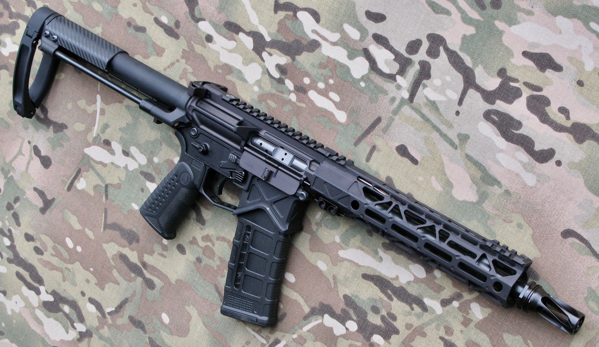

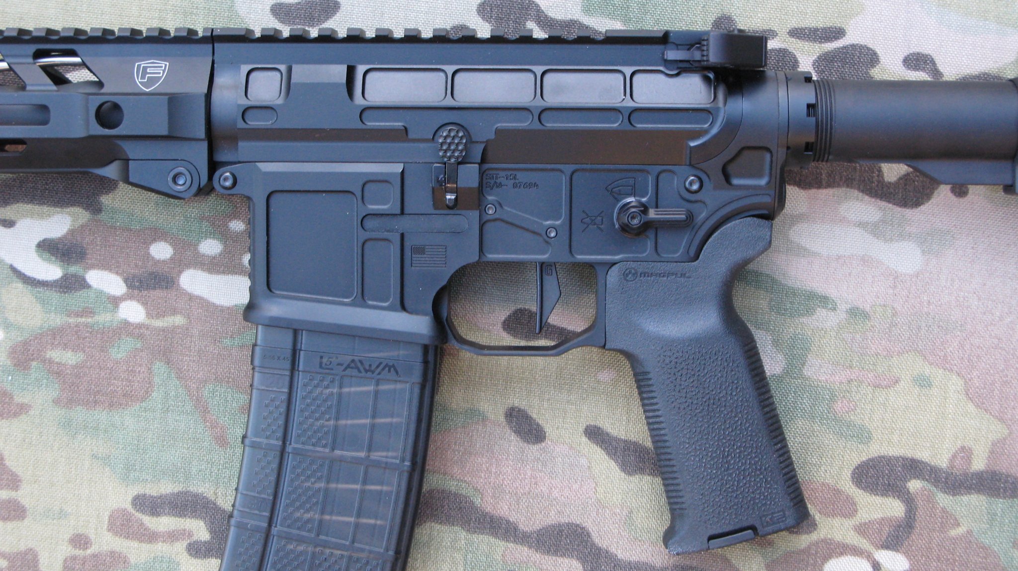

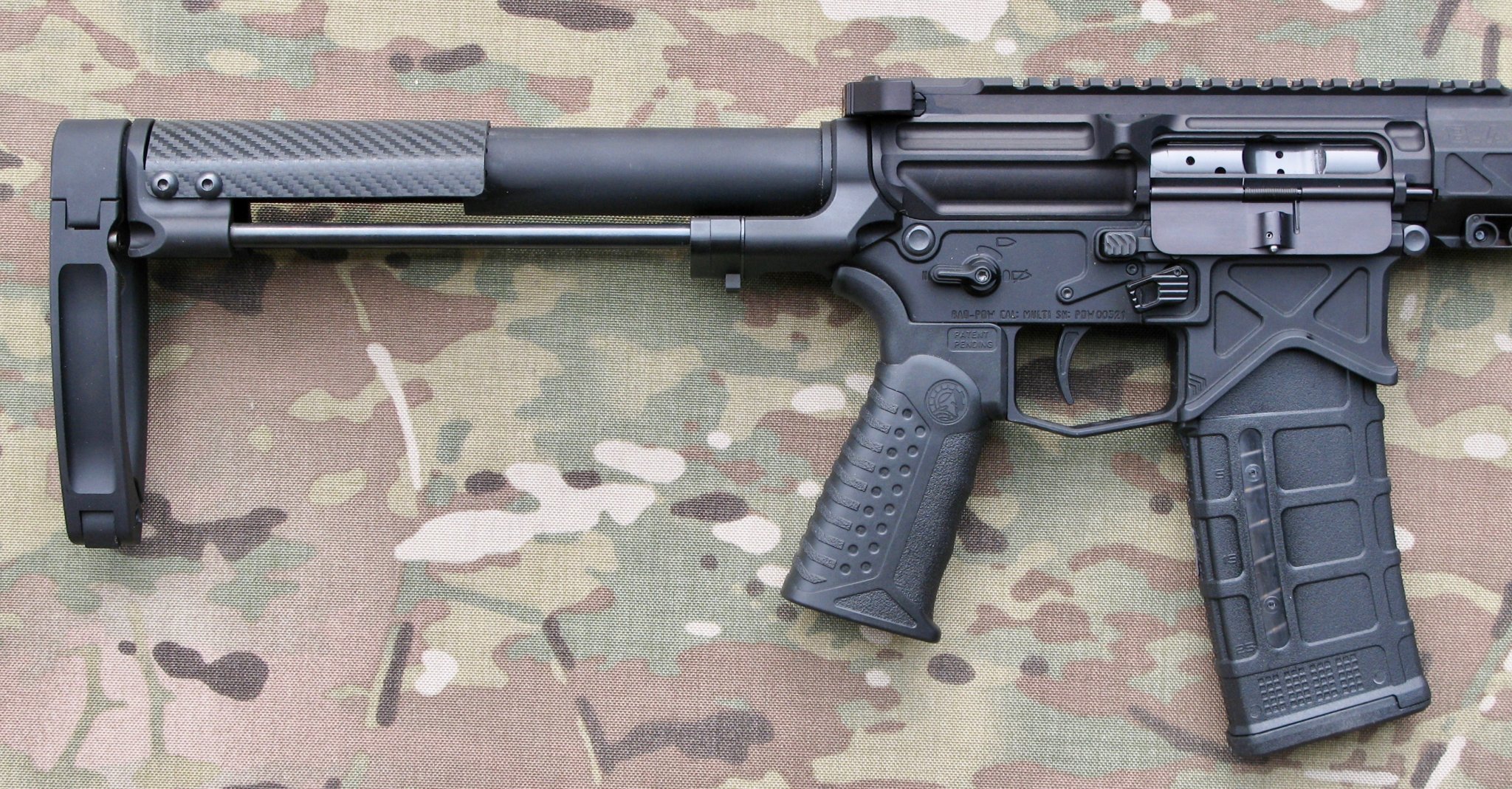

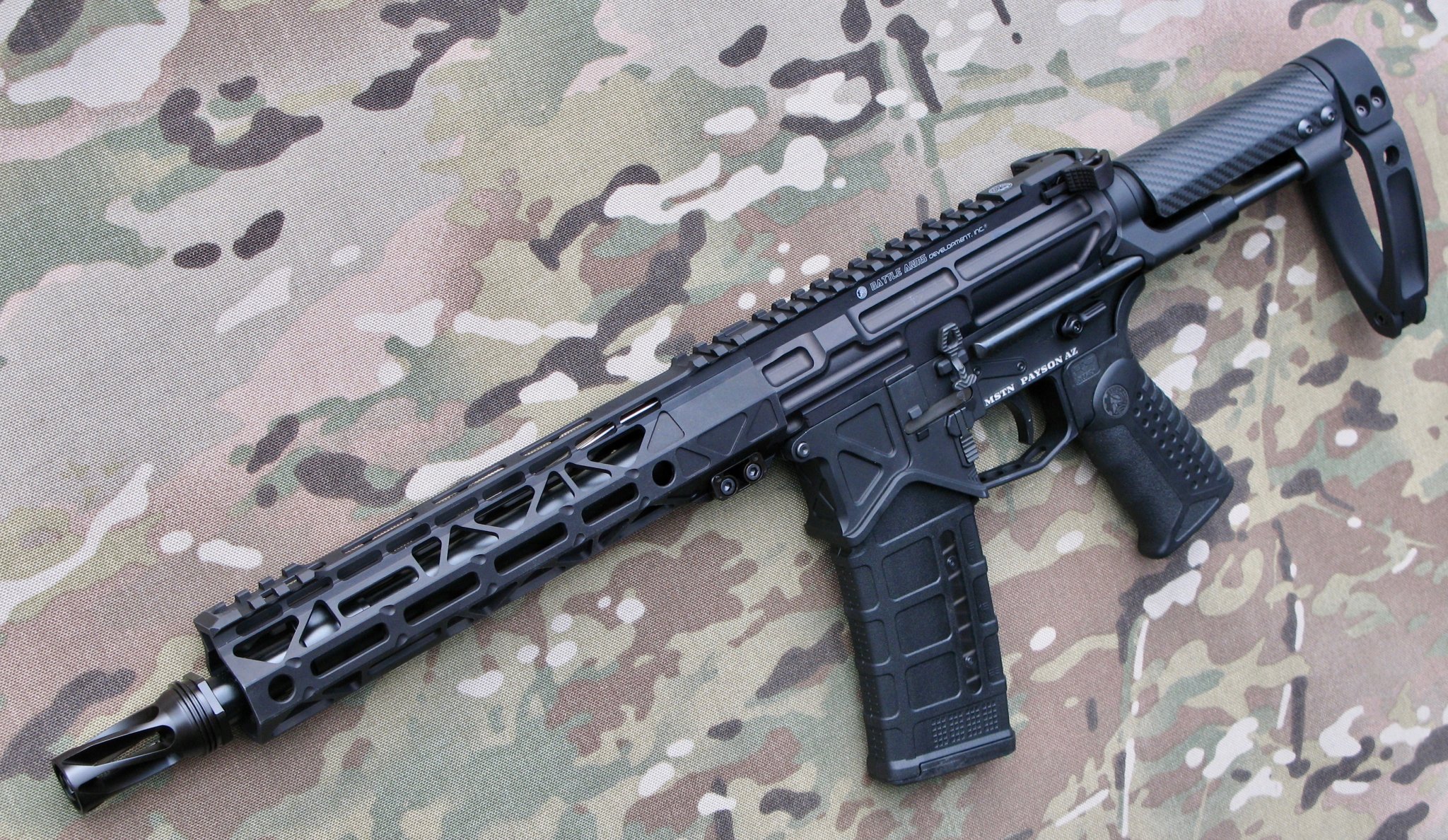

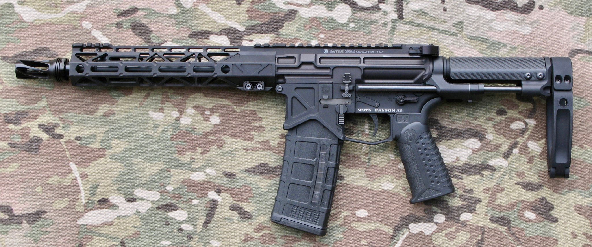

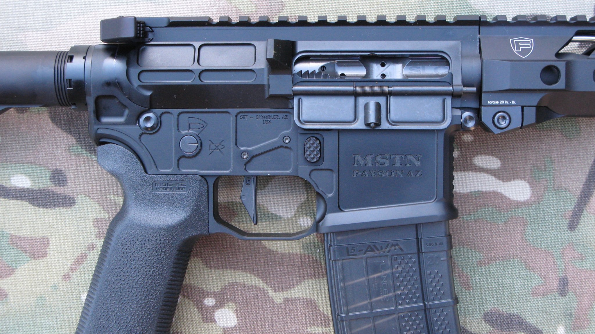

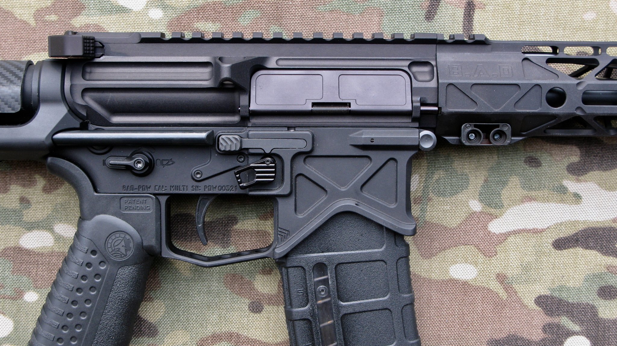

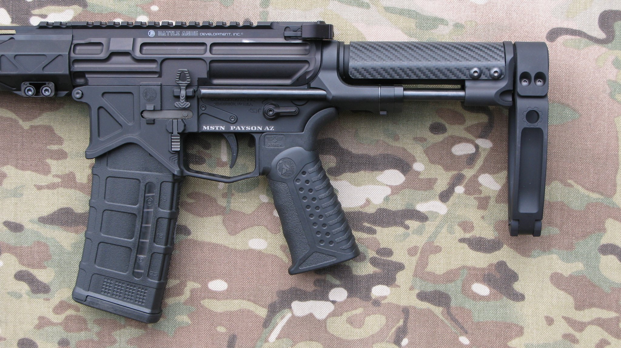

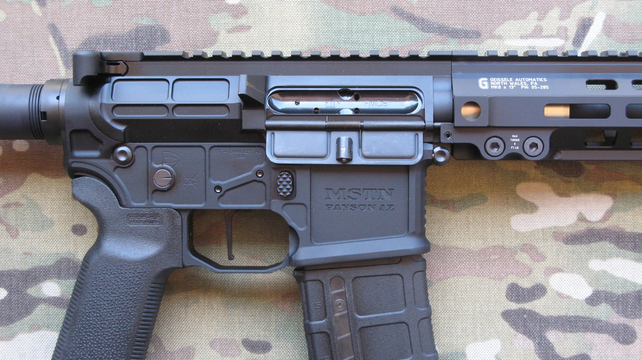

This BAD PDW lower has been stashed away for some time. This is one of their originals with really the neat compound spring buffer. I've got another much like this but with a 6.5" V7 .300 BLK barrel that runs 100%. The addition of the BAD PDW Tailhook adapter allows this lower to be used in a pistol format. With BAD 9.5" RigidRail covering the V7 10.25" SS barrel chambered in .223 Wylde, the gun only weighs 5 LB 9 OZ. The anodizing of the three BAD components doesn't match that well in these photos taken in sunlight, but I can live with it, especially these days. The gun actually looks far better in person. See the V7 aluminum ejection port cover? I've got a JP Enhanced bolt in there behind one of my Young MFG M16 bolt carriers - center less ground, hard chromed, and then Ionbond DLC coated. There's an ambitious Geissele ACH, ambi V7 hybrid short throw safety selector, and built in BAD ambi mag release. The LaRue MBT trigger in this one breaks at a crisp 3.25 LB and really can't be improved upon. There's an OSS flash hider up front, ready for a low back pressure OSS HX-QD 5.56 can.
Here's the current parts list:
Upper:
Geissele URGI MK18 Upper
Dead Air Sandman S
Modlite PLH V2, Thorntail 2 SBR, Modbutton Lite
Midwest Combat Rifle Front Sight
Aimpoint T2, Unity FAST mount
BCM Gunfighter CH
Lower:
Colt SBR Lower
Magpul MOE+ Grip
BCM Gunfighter Stock
Geissele SSA
Radian Talon Safety
BFG VCAS Sling
Nice lookin Setup!

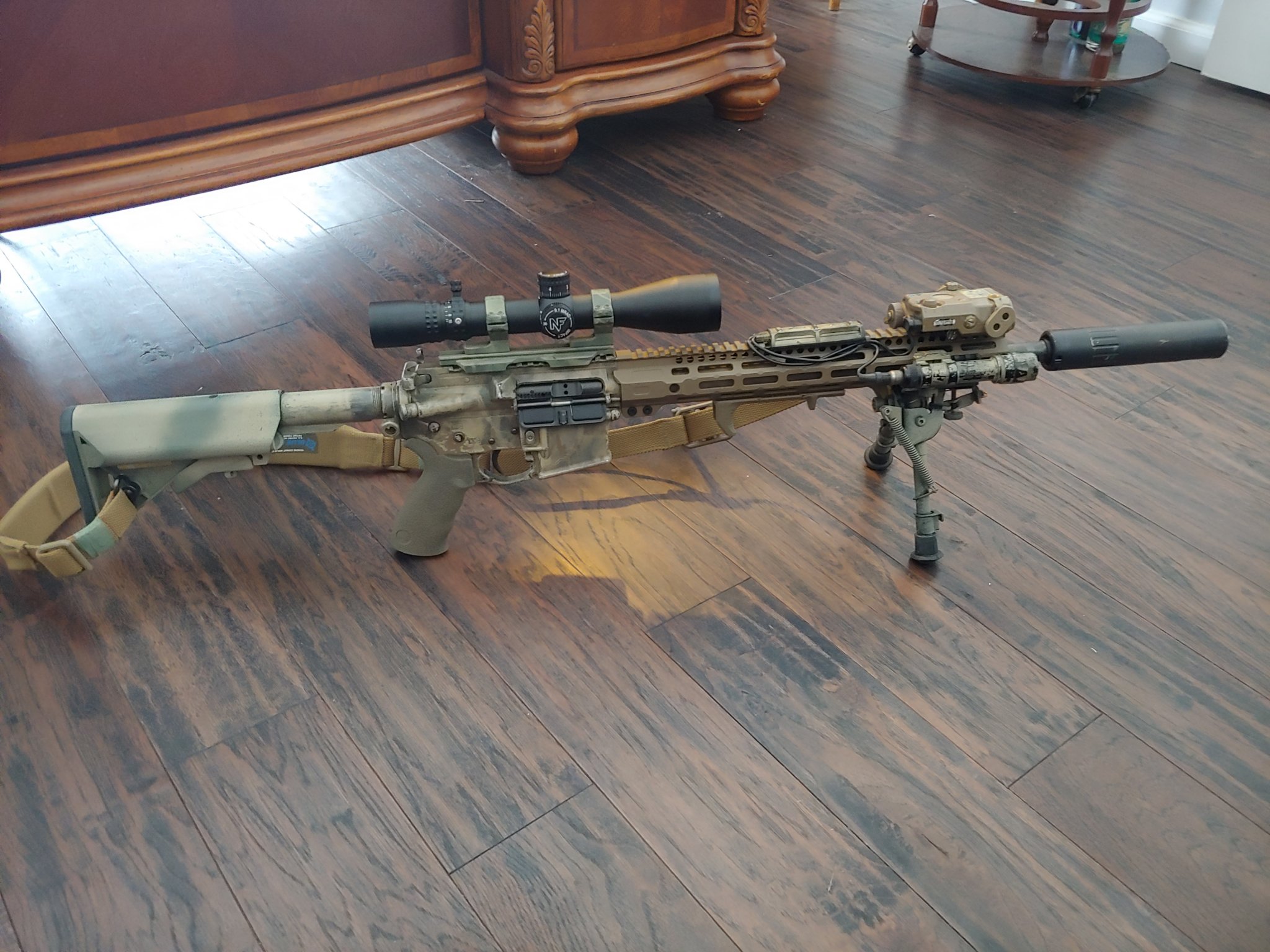

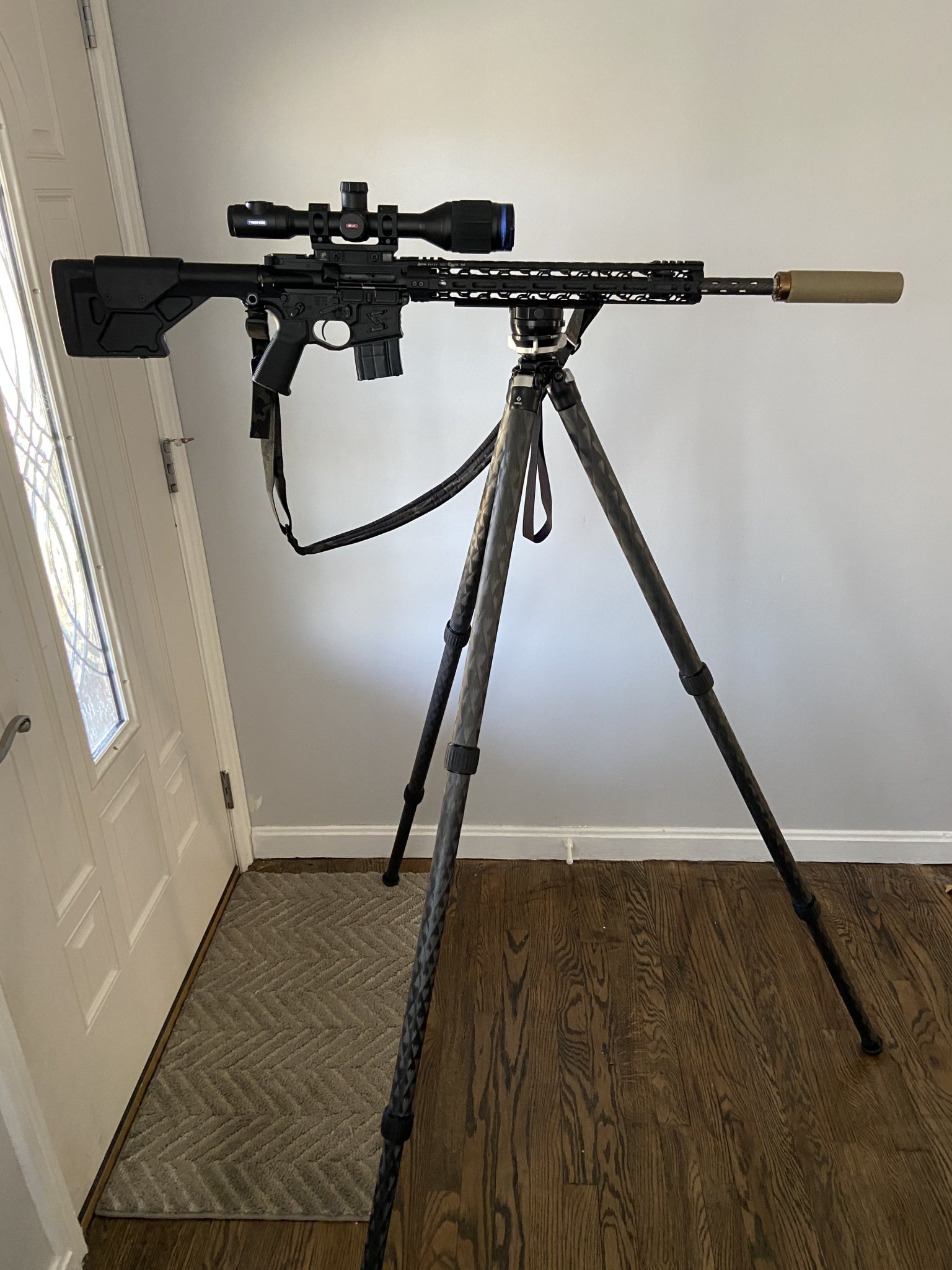

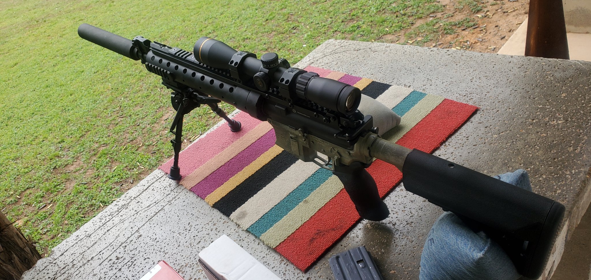

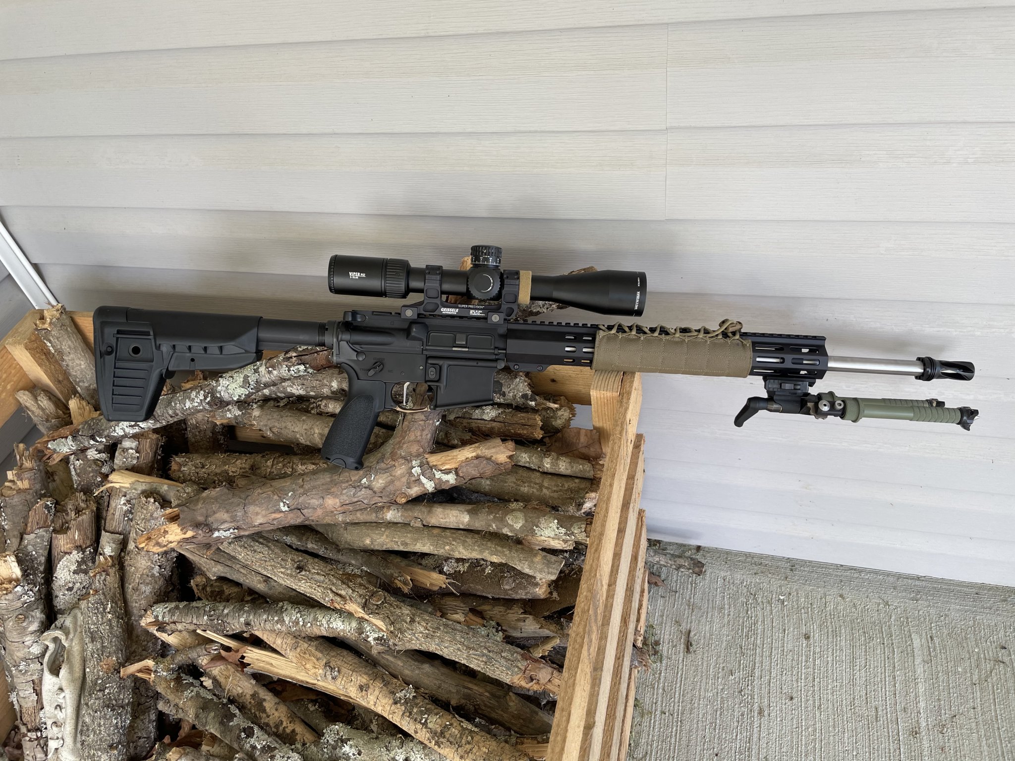

My 224 Valkyrie build. Built it about 2 years ago. It’s a heavy thing too, with scope just over 13 pounds. Shoots great!
Wyoming Arms billet upper/lower receiver,
BlackRain BCG, Geissele SD-E 3.5 lbs trigger,
PWS buffer tube, Hogue grip, Odin Works extended mag release, Phase 5 battery assist device, LWRC Ambi safety, Troy ambi mag release, Stainless steel black extended takedown and pivot pins, B5 Systems Collapsible Precision Stock, Geissele super 42 twisted wire buffer spring, with H1 buffer,
White Oak Armament 224 Valkyrie 1-7 twist 24” fluted/bead blasted stainless steel barrel,
Lantac Dragon GemTech Quick Mount muzzle brake, AXTS black titanium forward assist,
Strike Industries UDC dust cover, VLTOR BCM Gunfighter charging handle, JP Precision Signature Series III Hand Guard 17” M-LOK, Atlas Bipod, Steiner T Series scope mount, Vortex Viper PST 5-25x50 scope.

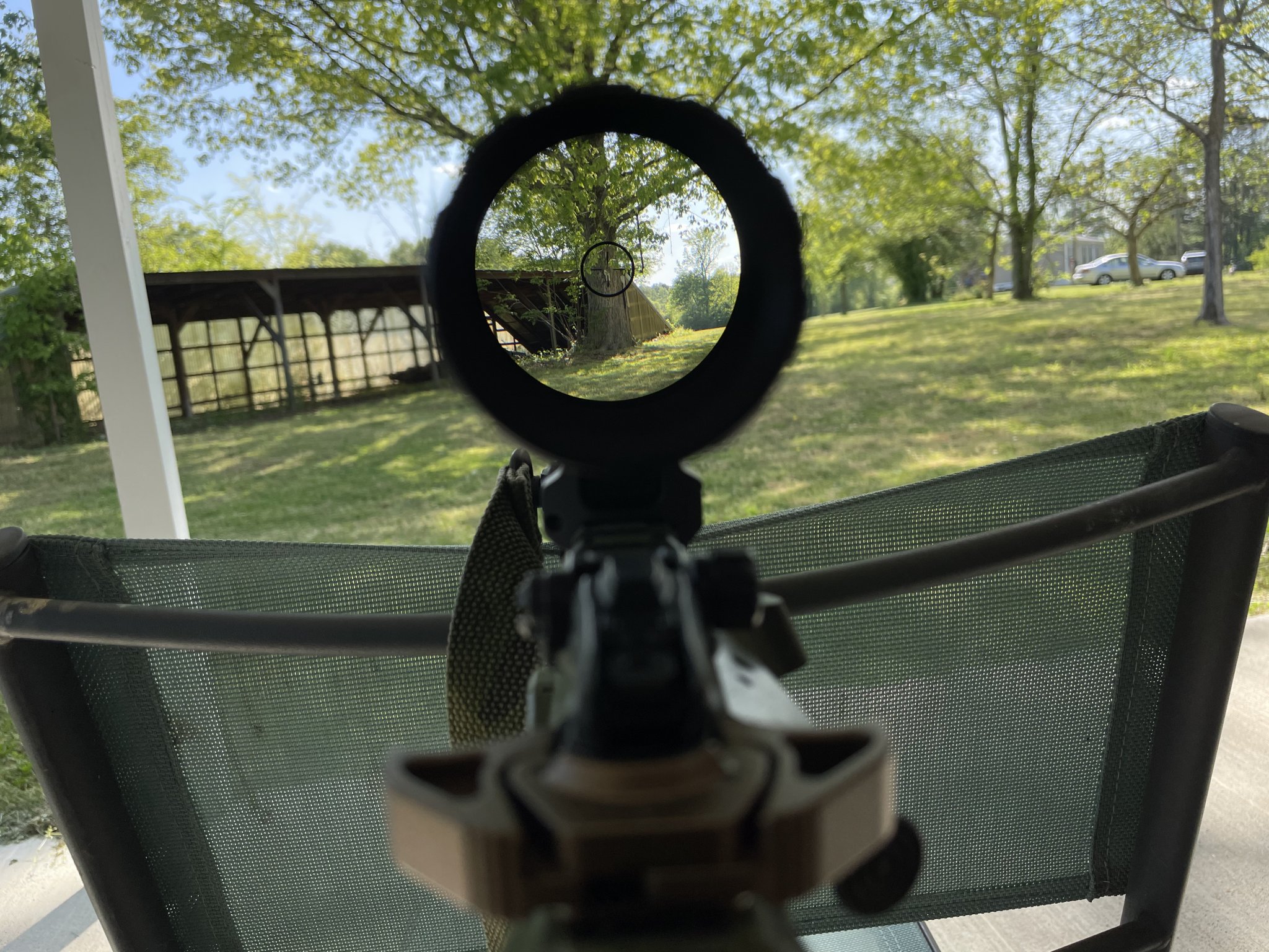

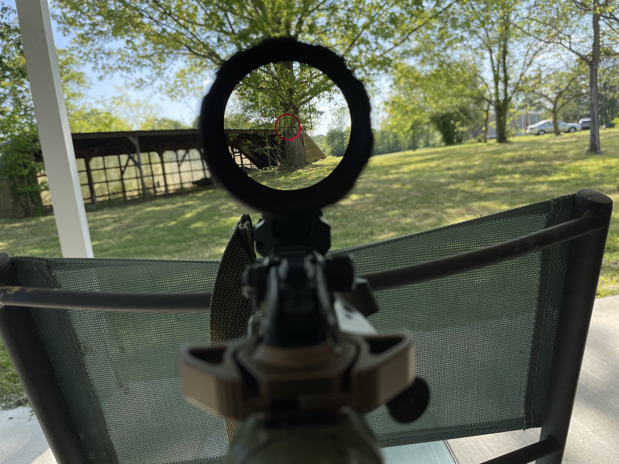

Got this “finished“ for now thanks to @6mmTim getting me the Scalarworks LEAP 1.93” mount. By far the fastest mount I’ve ever mounted an optic with.
Went with the older SWFA 1-6x26 HD they had on their Samplelist for $600. Said it had flawed illumination, but I see zero flaws. I’ve never used a “high end” LPVO, but I love this thing for the price.
Will most likely be getting a Modlight OKW at some point to replace the SF M600DF. Still waiting on my OSS Helix 762 QD to come in as well.
The reticle pictures were done with my phone. Any distortion you may see if for that reason. Looking through it with my eyes is a flat and seemingly 1x sight picture.

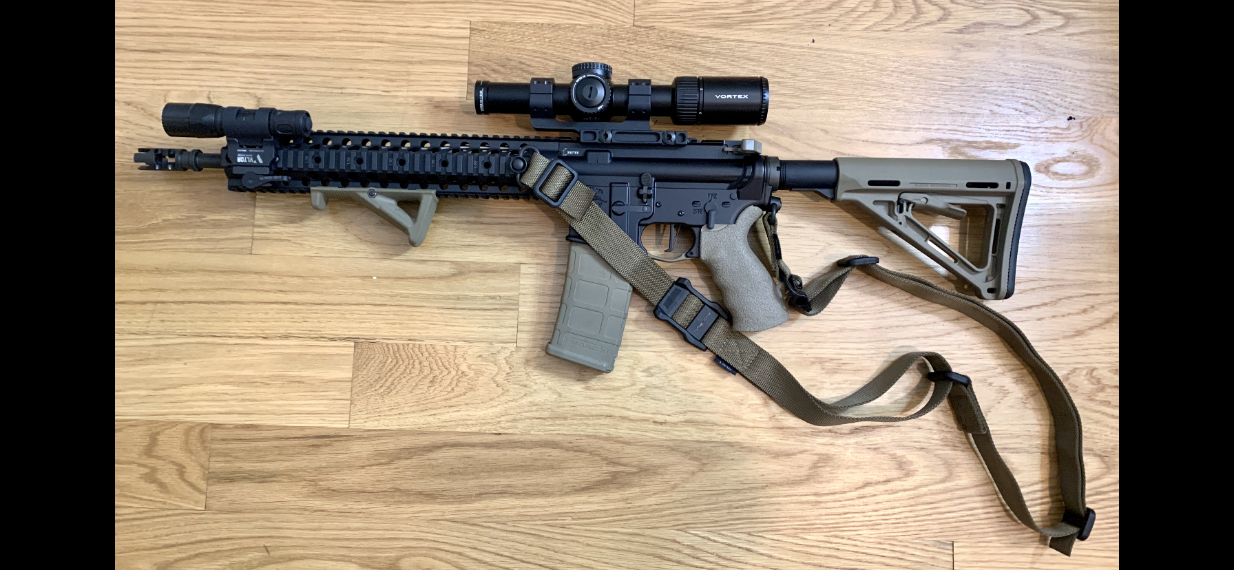

Got another “finished” today. A BCM stock got in and so far doing some dry fire, I’m digging it. Should be able to sight this and the rifle above in next week with some IMI 77 grain.
Just waiting on that OSS suppressor and some spray paint now.
Thanks to @blbennett1288 for inadvertently sending me down this rabbit hole of precision.
The Vortex PST2 3-15x44 was a great deal from Euro Optic for about $615. Has the older EBR-2C reticle, but I’m enjoying it so far. Hopefully the zeroing is not as complicated as the manual makes it out to be.

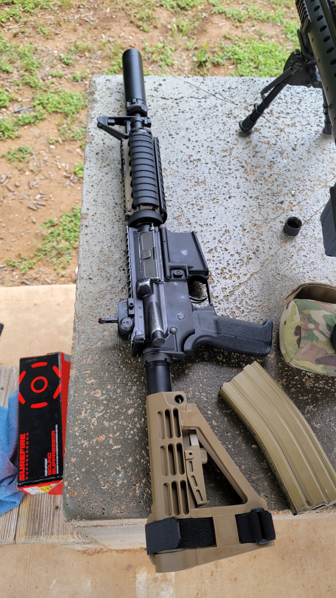

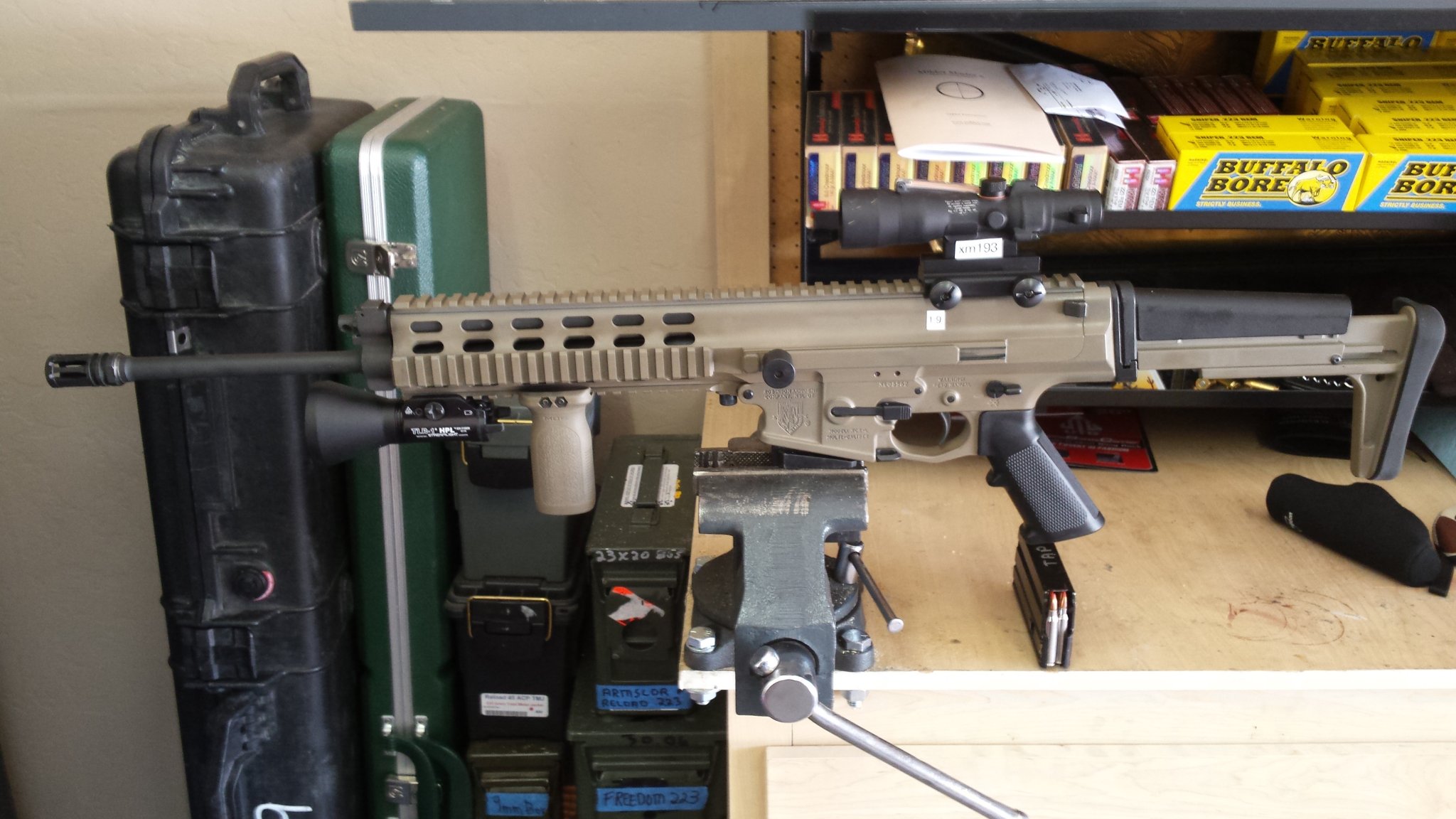

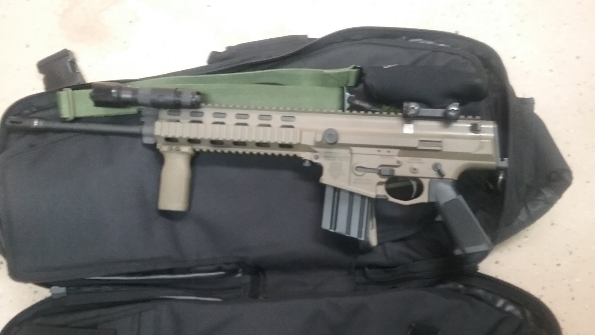

Well technically it's not an AR, but youknow...
I hate the quadrail, but I can replace that through Robinson if I really get a bug up my ass about it.
3x Acog, 300ish lumen light, stubby handle, single point sling and has a Surefire Socom muzzle device on it now. Fit's great in a non-descript bag.

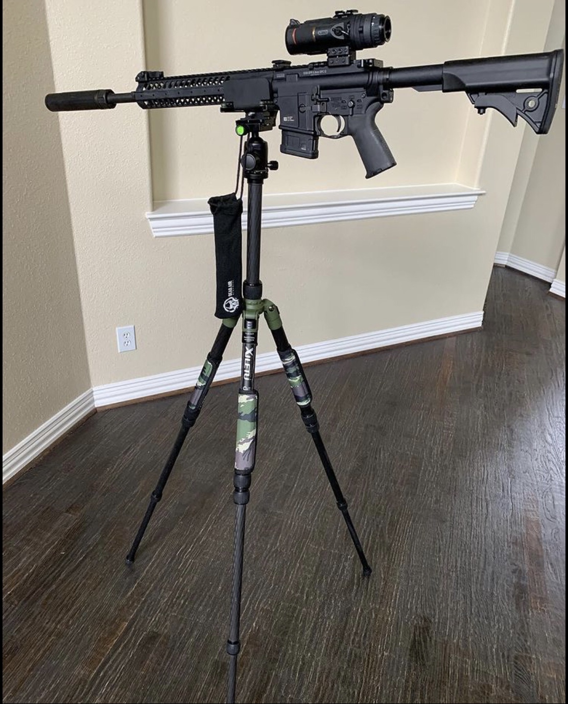

Yeah these are definitely my two primaries. Got them both zeroed today with IMI 77gr (mk262 clone). 50 yard zero on the irons/lpvo and a 100 on the Vortex. Excited with what I’m seeing thus far.

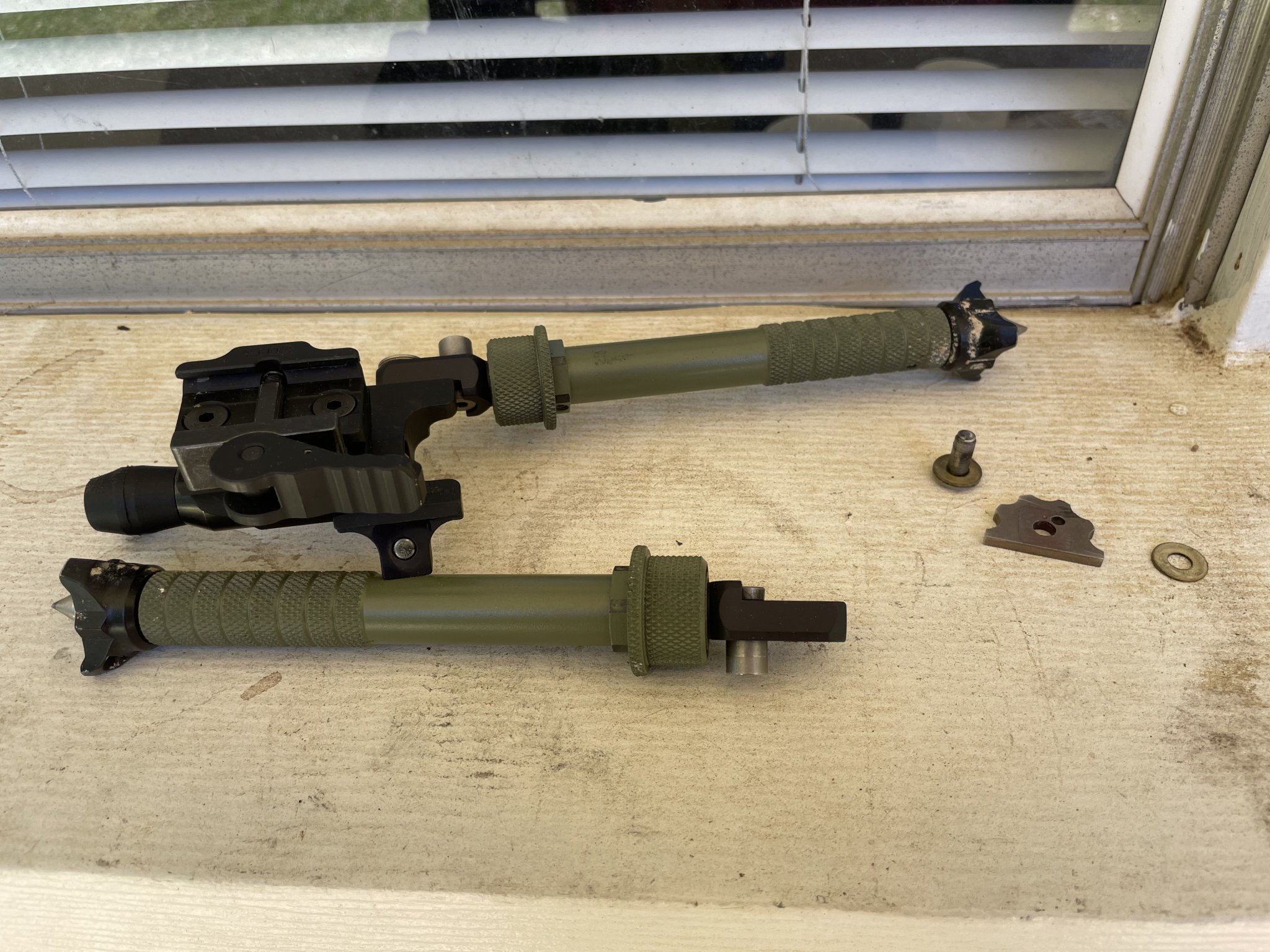

Bad part... my Atlas fell out of my bag, hit the concrete perfectly, and broke. Hopefully it can be fixed, calling them Monday.
This DID teach me just how versatile a tripod is. Was able to continue shooting well resting off of it. The tripod literally saved the shooting day.

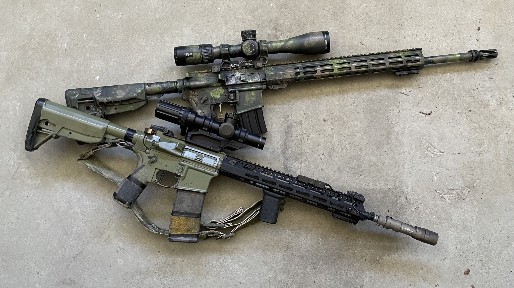

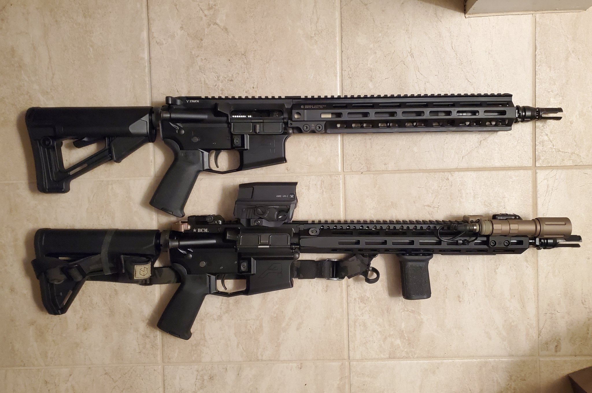

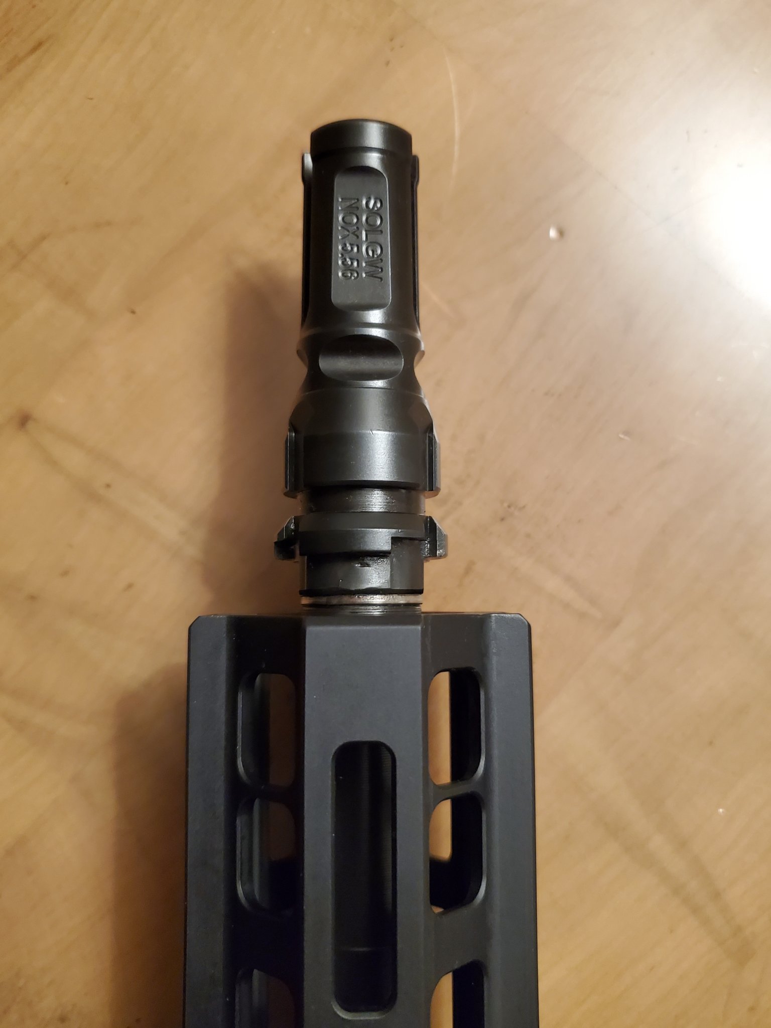

New 13.7" build (top) next to the 14.5 BCM.
* 16" Daniel Defense Mid Length Barrel Chopped to 13.7"
* SLR Gas Block Pinned
* VSeven Stripped Upper
* 13" Geissele MK8 (PITA to find a 13" which was discontinued)
* SOLGW NOX (P&W)
* DD BCG
* Larue 2 stage in a spare aero M4 lower
Shout out to John Thomas at Retro arms for doing the entire Upper assembly, including cutting and crowning this barrel! He's incredible.
My goal was to have a soft shooting, properly gassed 13.7 to pair with a sandman for mostly suppressed shooting. Working on finding a Razor 1-6 and some stuff to finish her off.
You don't need a dimple. It's nice and simplifies assembly, but carbon buildup or a little blue loctite will keep a gas block on a non dimpled barrel indefinitely.
Doesn't any Loctite just turn to powder/dust if exposed to the direct heat of something like barrel? Pretty sure Loctite is not going to do anything after one hot range session.

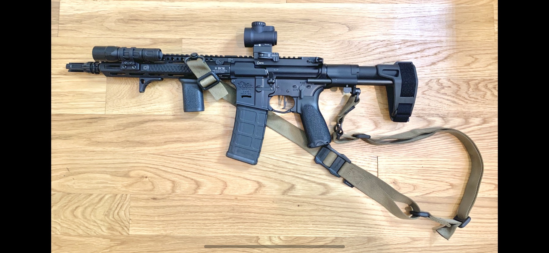

Finished my new SBR last night. All Noveske and Geissele parts chambered in .300. Topped it off with a Nomad-30. Still need to grab an EXPS3 though.
  • Receivers: Noveske Gen III
  • Handguard: Noveske NHR 7"
  • Barrel: Noveske Diplomat 7.94" .300 BLK
  • Charging Handle: Noveske Super Badass Airborne Charging Handle
  • Ejection Port Door: Noveske Iron Cross
  • FA: Noveske Iron Cross
  • BCG: Noveske M-16 Nitride
  • Buffer: Noveske H3
  • LPK: Geissele Super Duty
  • Trigger: Geissele SSA
  • Furniture: Magpul MIAD Grip and CTR Stock
  • Silencer: Dead Air Nomad-30

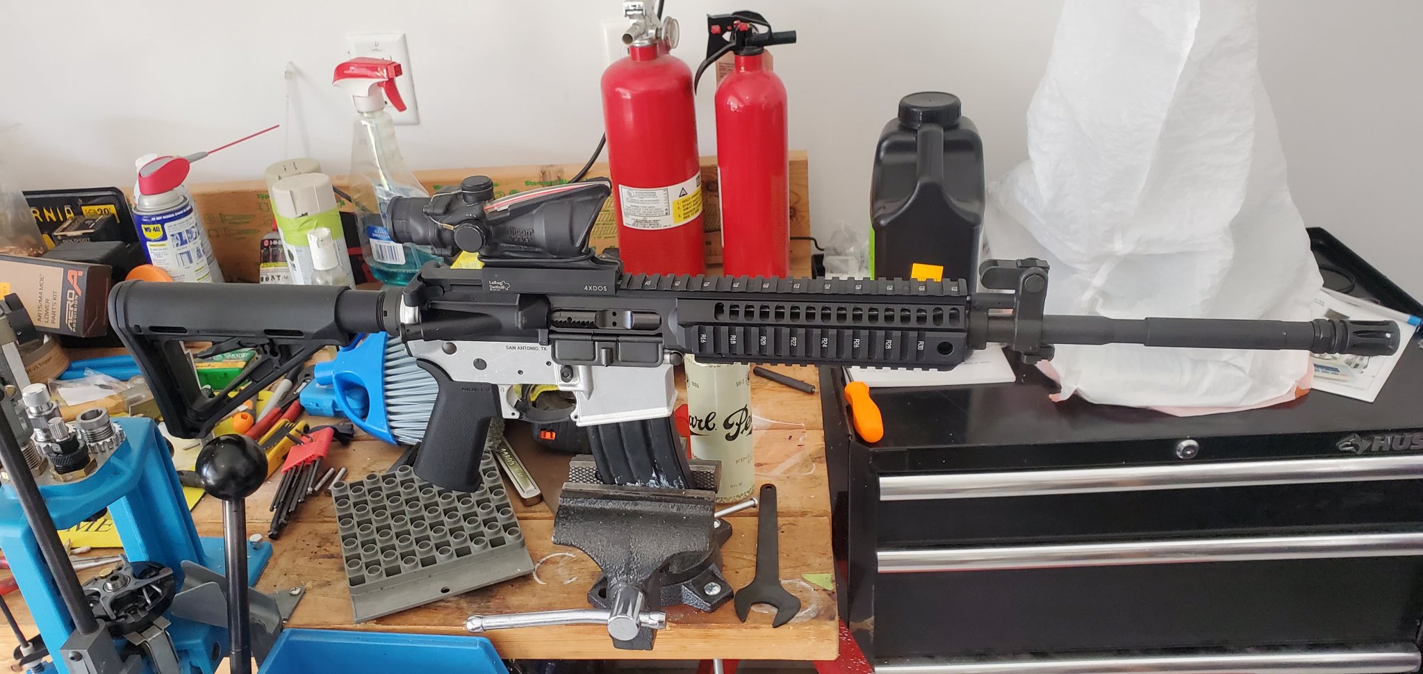

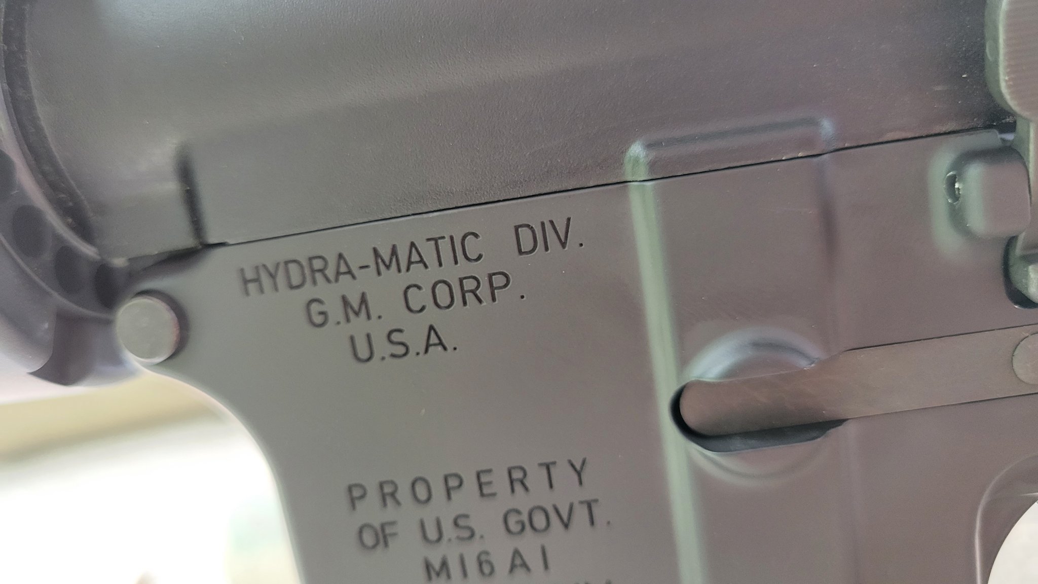

Finished a build about an hour ago.
Colt 6940 Upper 16", complete
Trijicon TA31RCO W/LaRue QD
GM Hydra-Matic 80% lower, 5D Tactical Jig used
Aero MOE LPK
MOE Stock, Colt spring/H1 buffer
LaRue MBS 2 Stage. (AWESOME)
May shoot her tomorrow.
Don't mind the mess. "I know where everything is".

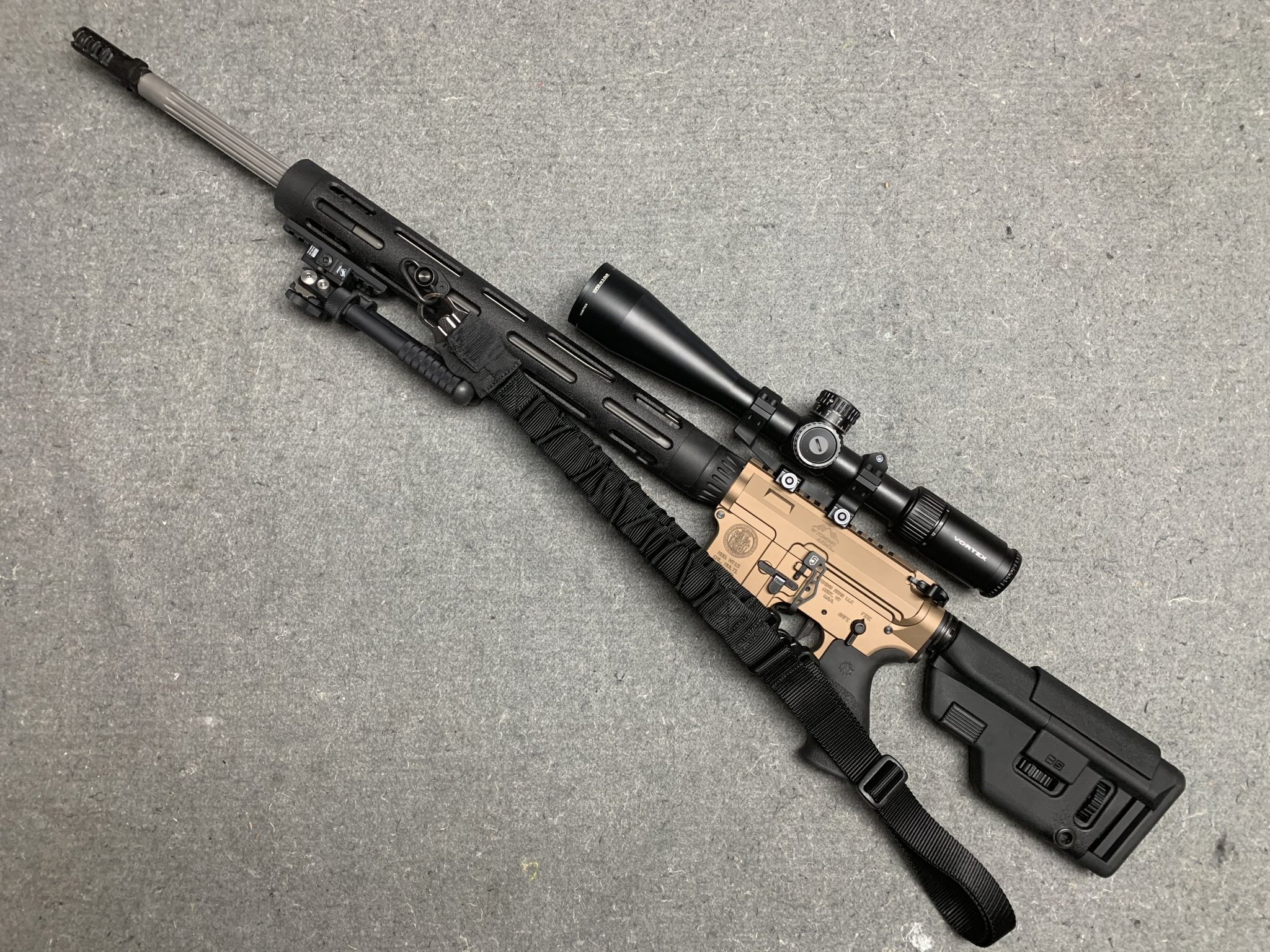

Finished this build in December. Hoping to dial in the scope this weekend.
CMMG MK4 lower with 20" barrel chambered in 6mm ARC. Steiner Military scope, Leupold cantilever mount BCM stock, grip and trigger guard, LaRue 2 stage trigger and Atlas bipod.

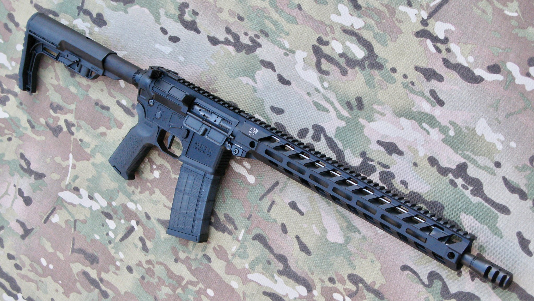

This custom hard use carbine has been built from the finest components available anywhere, at any price. It has taken nearly a year just to get all of the parts! The key component in any AR' is the barrel. In the hard use category, nothing tops the Noveske "Light Recce" 14.5" hammer forged, double chrome lined barrel built exclusively for Noveske Rifleworks to M249 machine gun specs by FN. These barrels will shoot sub-MOA all day long with capable ammunition. The M855A1 feed ramps have been contoured and polished. A JP DLC coated bolt is headspaced at 1.4666" to this barrel. This bolt is a part of the JP Full Mass Operating System ("FMOS) bolt carrier group. The charging handle is the Precision Reflex Gas Buster, a patented safety device, and the one you want on board when shooting suppressed. ASurefire WarComp 5.56 flash suppressor is pinned and TIG welded out front, giving us a 16+" barrel overall length. The receiver set is the billet SanTan STT-15L, an absolute work of art. The forend is the 13.5" Geissele MK 8, which gives you sufficient standoff from the barrel so you won't need to call your mama crying after the third peel drill. The push pins are all by themselves Standouts: Dark Hour Defense ("DHD") stainless - DLC coated. The magazine release, short short safety, plus receiver end plate and tube castle nut are alsomade by DHD. The bolt release is STT V7 tool steel - not going to break. The trigger is the TriggerTech Competion model, breaking at a crisp 3.5 LB. It is supported by V7 titanium fire control pins. The recoil system is the Vltor A5, the best thing to happen to the AR' since the flat top upper receiver. The buttstock, pistol grip, and magazine are from Magpul.
View attachment 7624950View attachment 7624951View attachment 7624952View attachment 7624953View attachment 7624954View attachment 7624955View attachment 7624956View attachment 7624957

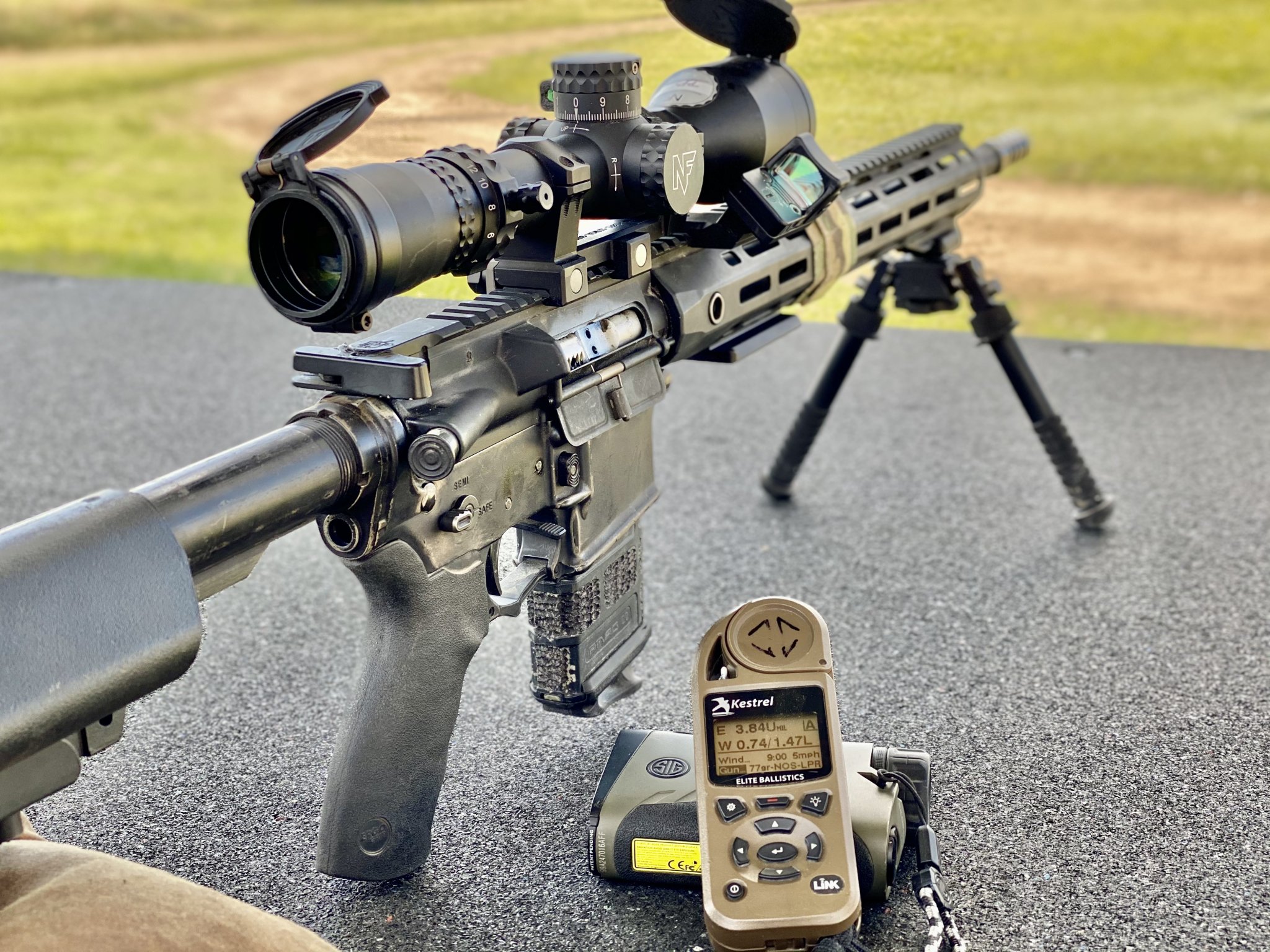

Knights Armament LPR Mod 2 upper
Bravo Company Mfg. lower
Nightforce NX8 2.5-20x50 Tremor 3
Nightforce 30mm 20moa mount
Trijicon RMR
Arisaka offset RMR mount
American Precision Arms Micro Bastard
Atlas bipod
Ergo grip
LMT SOPMOD stock
LaRue MBT
Nosler 77gr HPBT CC
H322
CCI450
I’ve been running this in precision type rifle matches right along side my 6.5CM bolt gun and have been very surprised with the LPR. Very accurate, soft shooting, reliable. I’m using holdovers and wind dots only with the Tremor 3 in both the NX8 and S&B PMII on my bolt gun.
