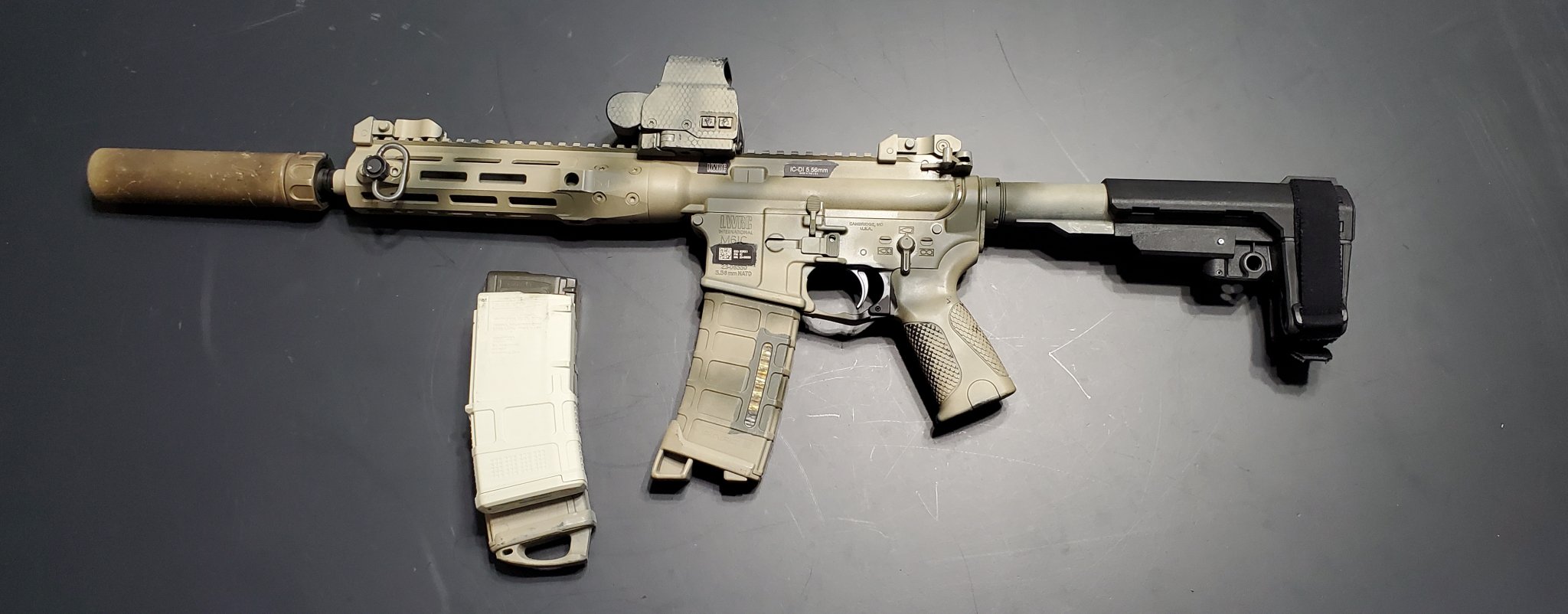

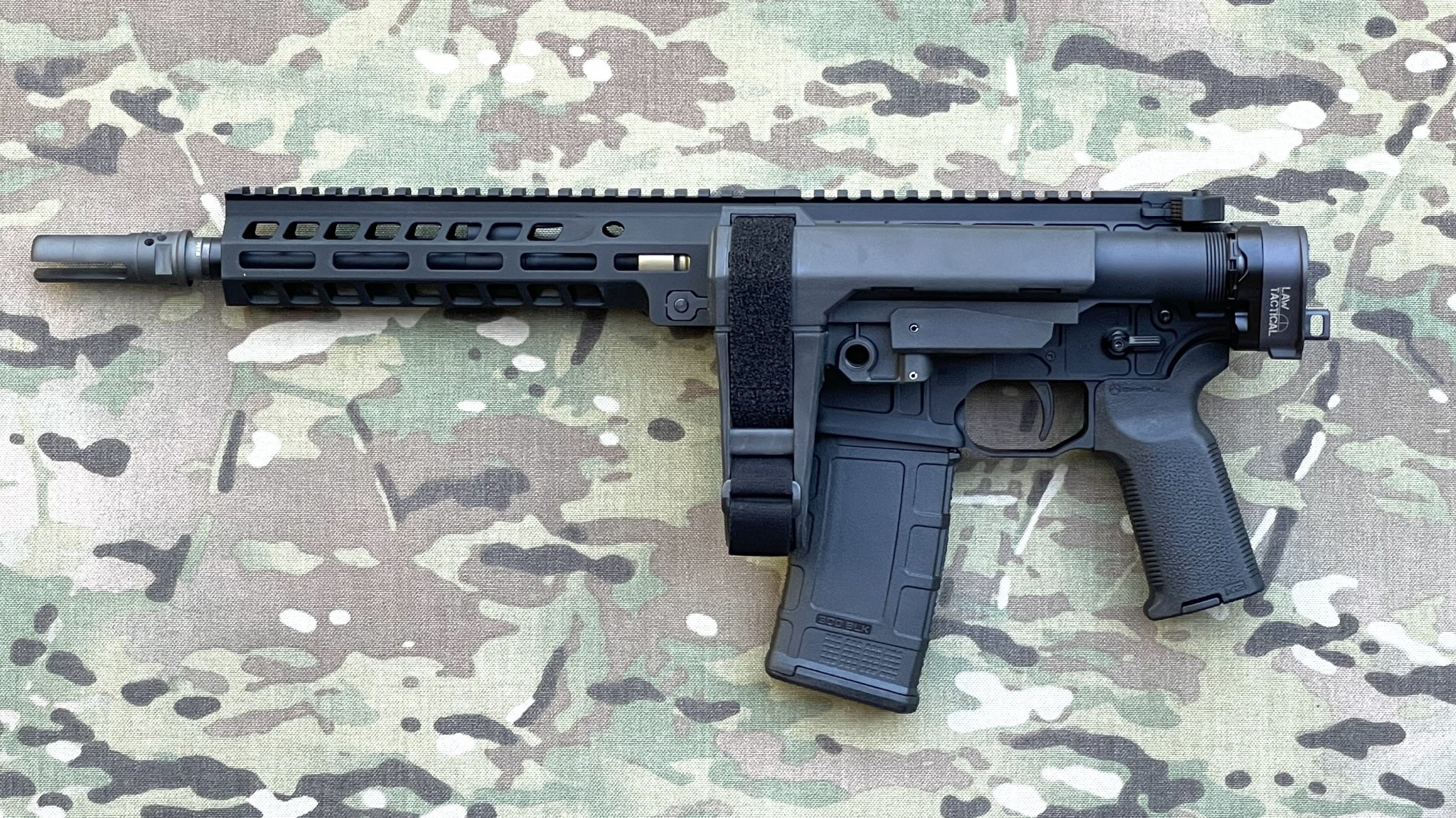

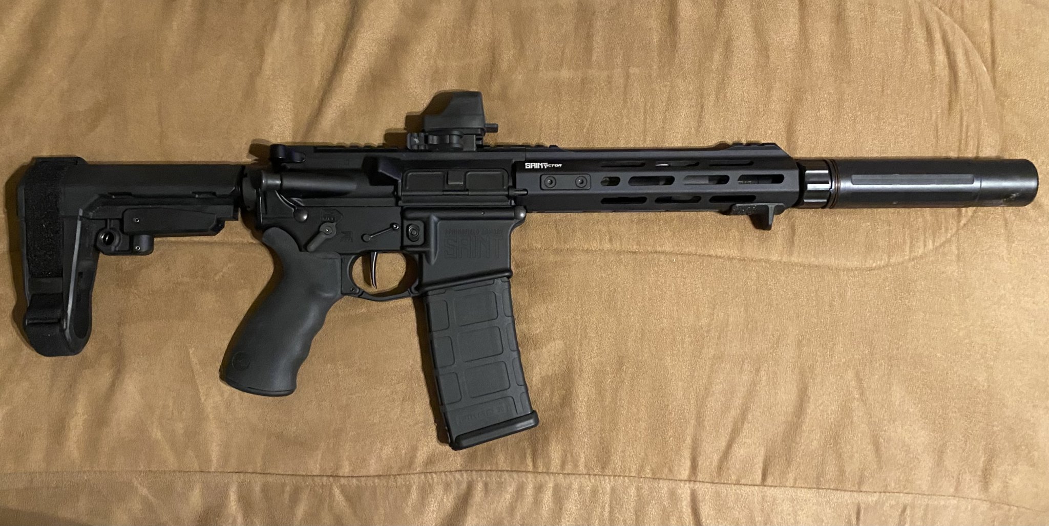

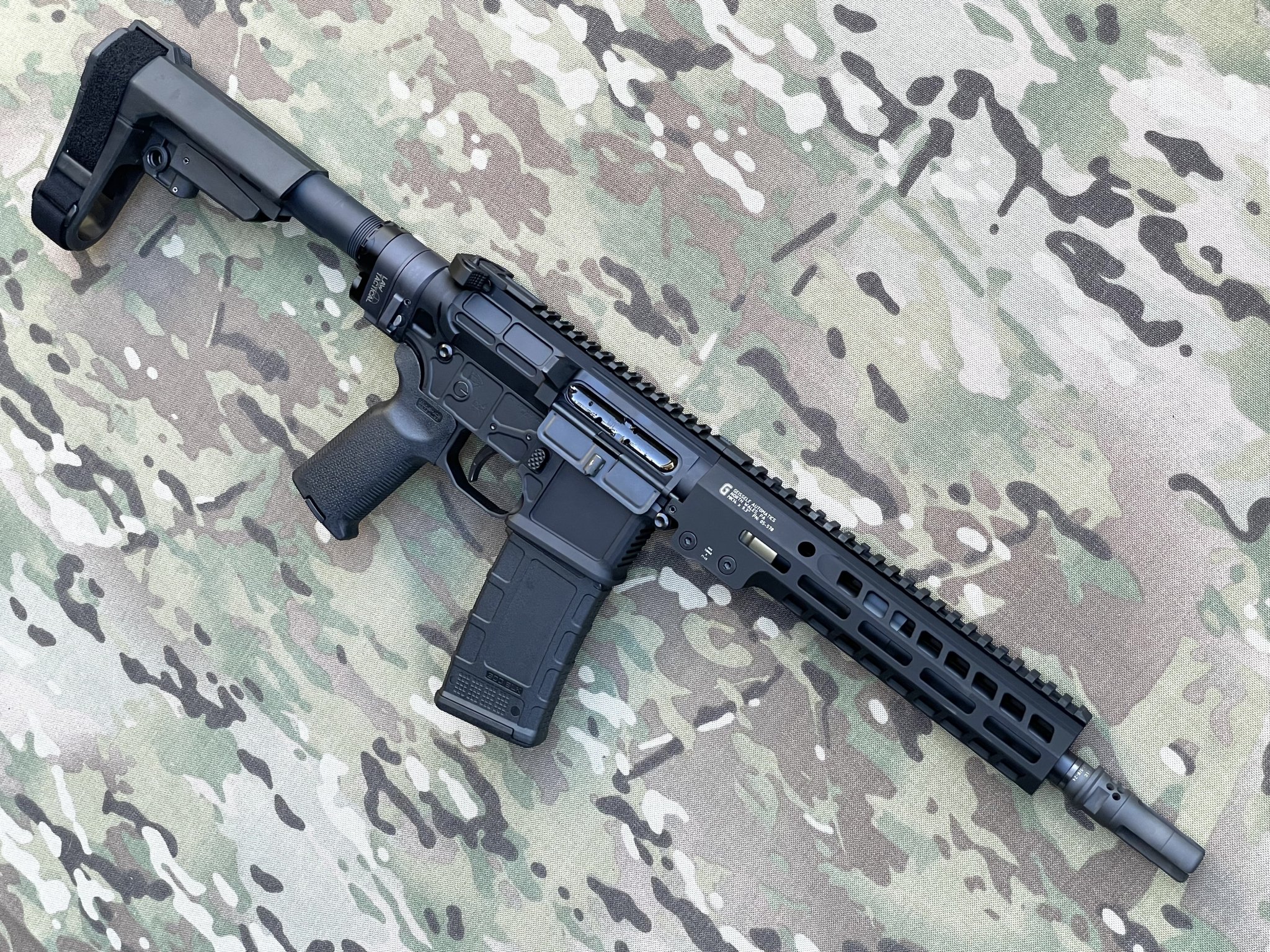

Just like life in the dark ages, it’s short and brutal. 7.5” barrel 6.8 SPC Noveske Diplomat.

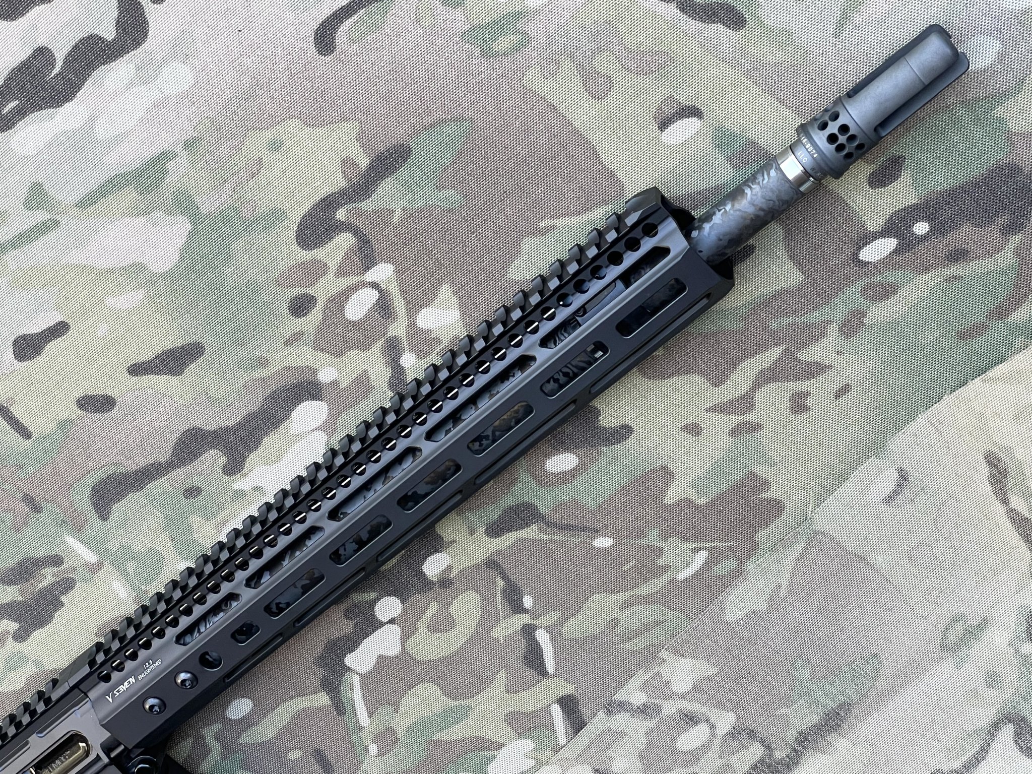

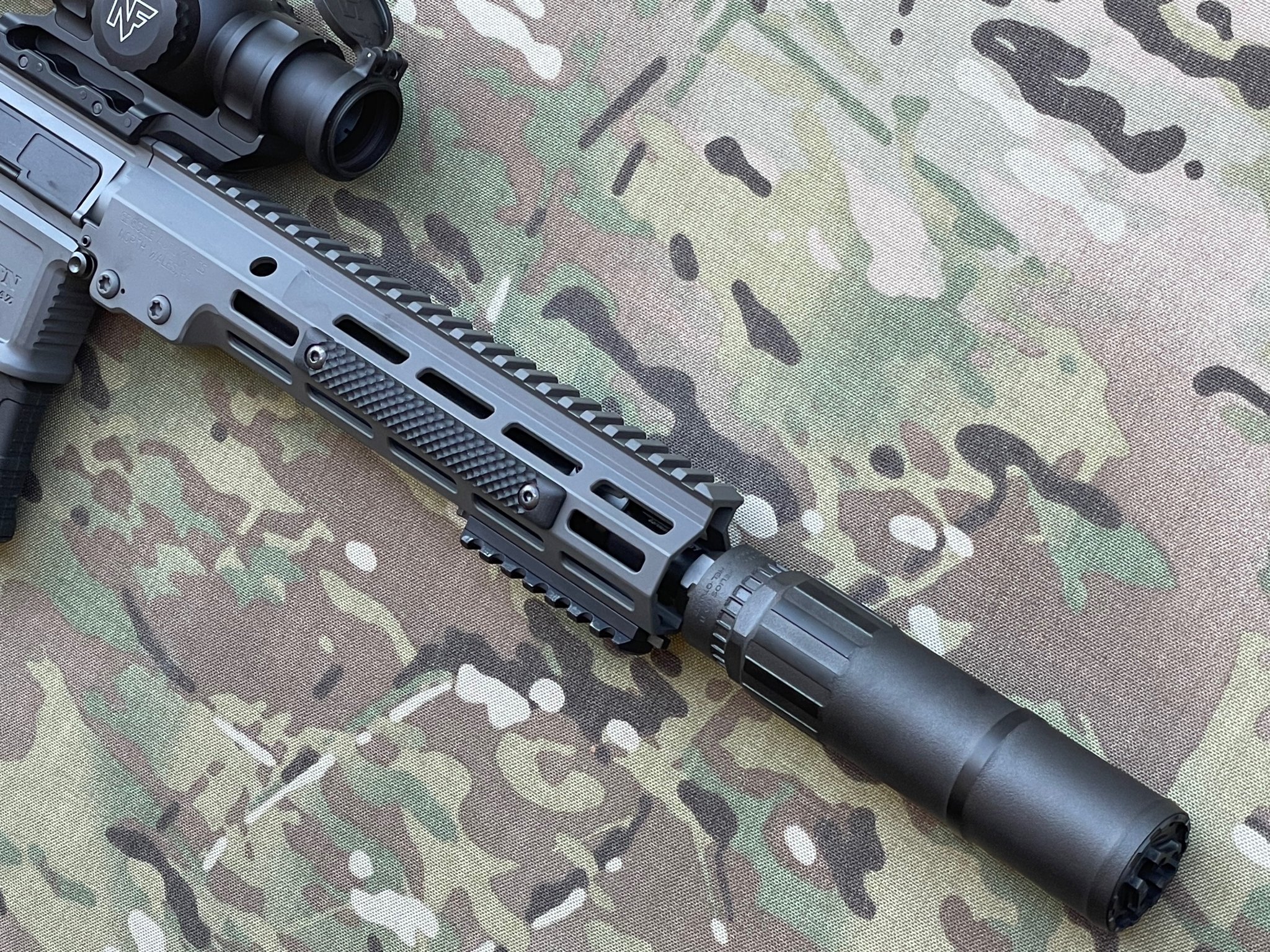

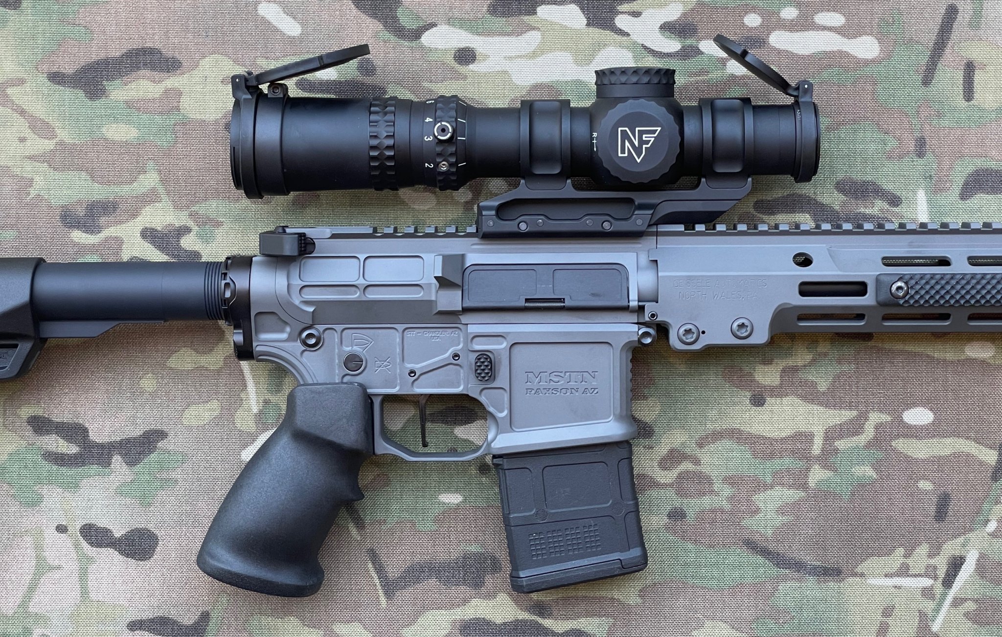

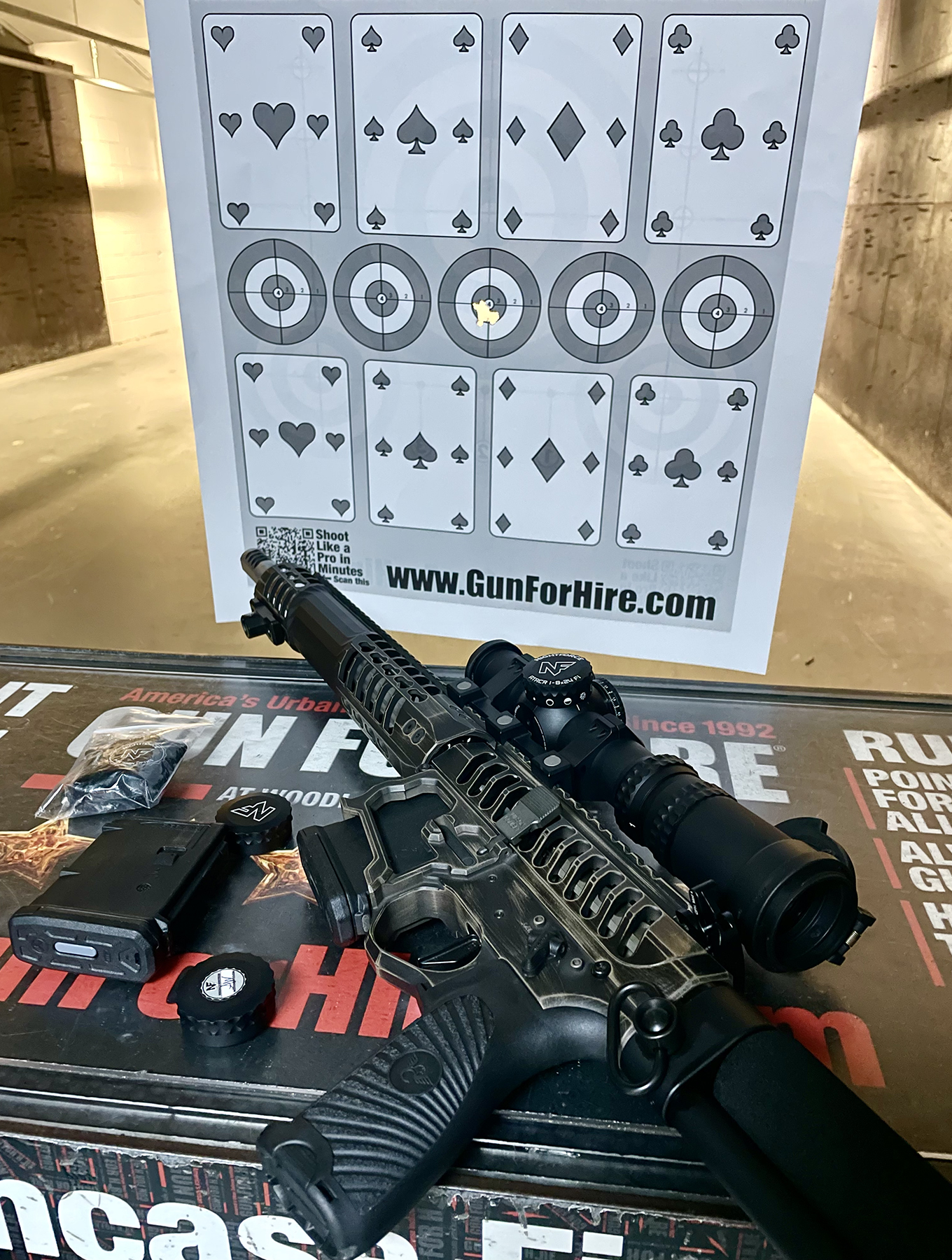

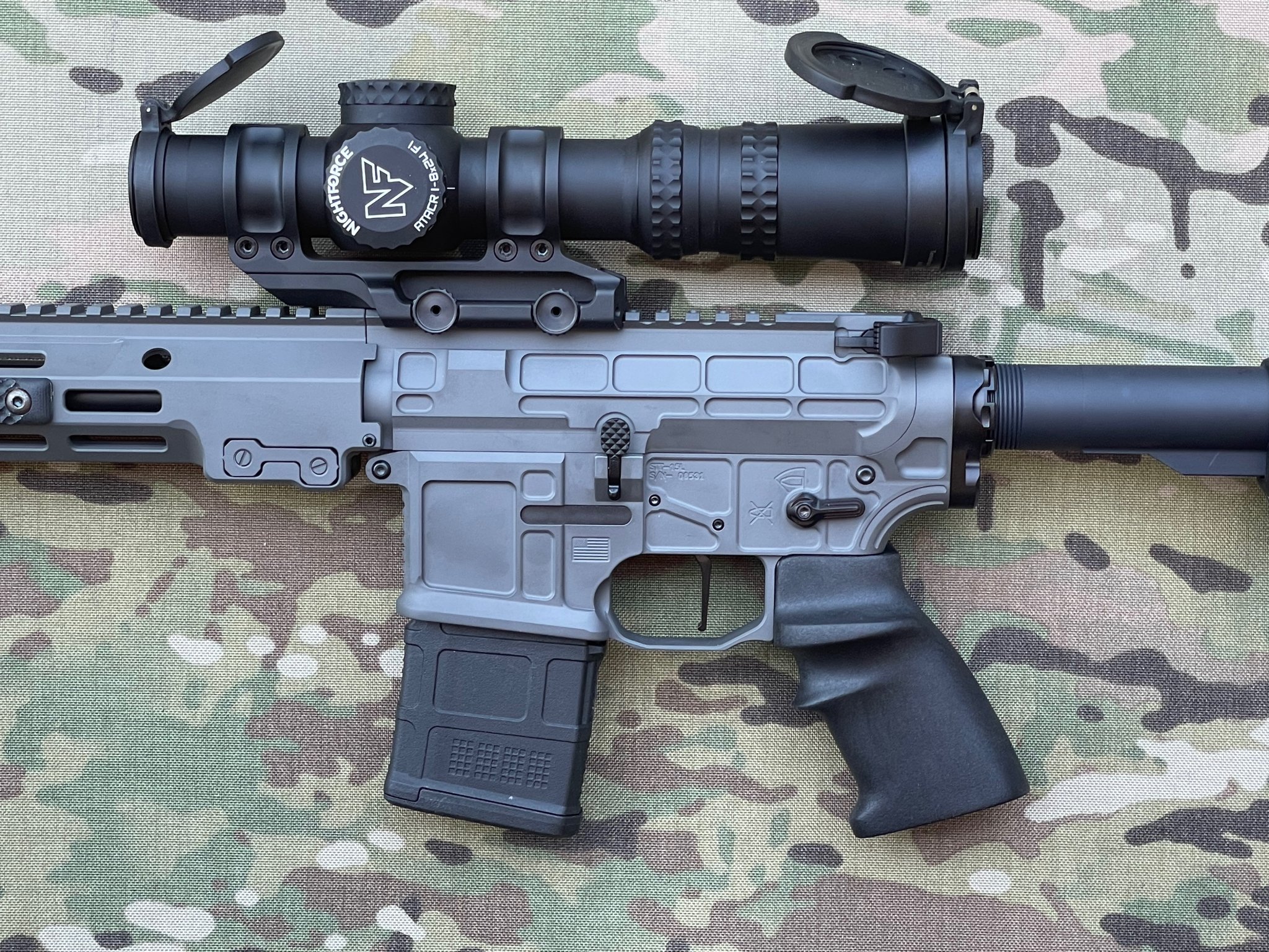

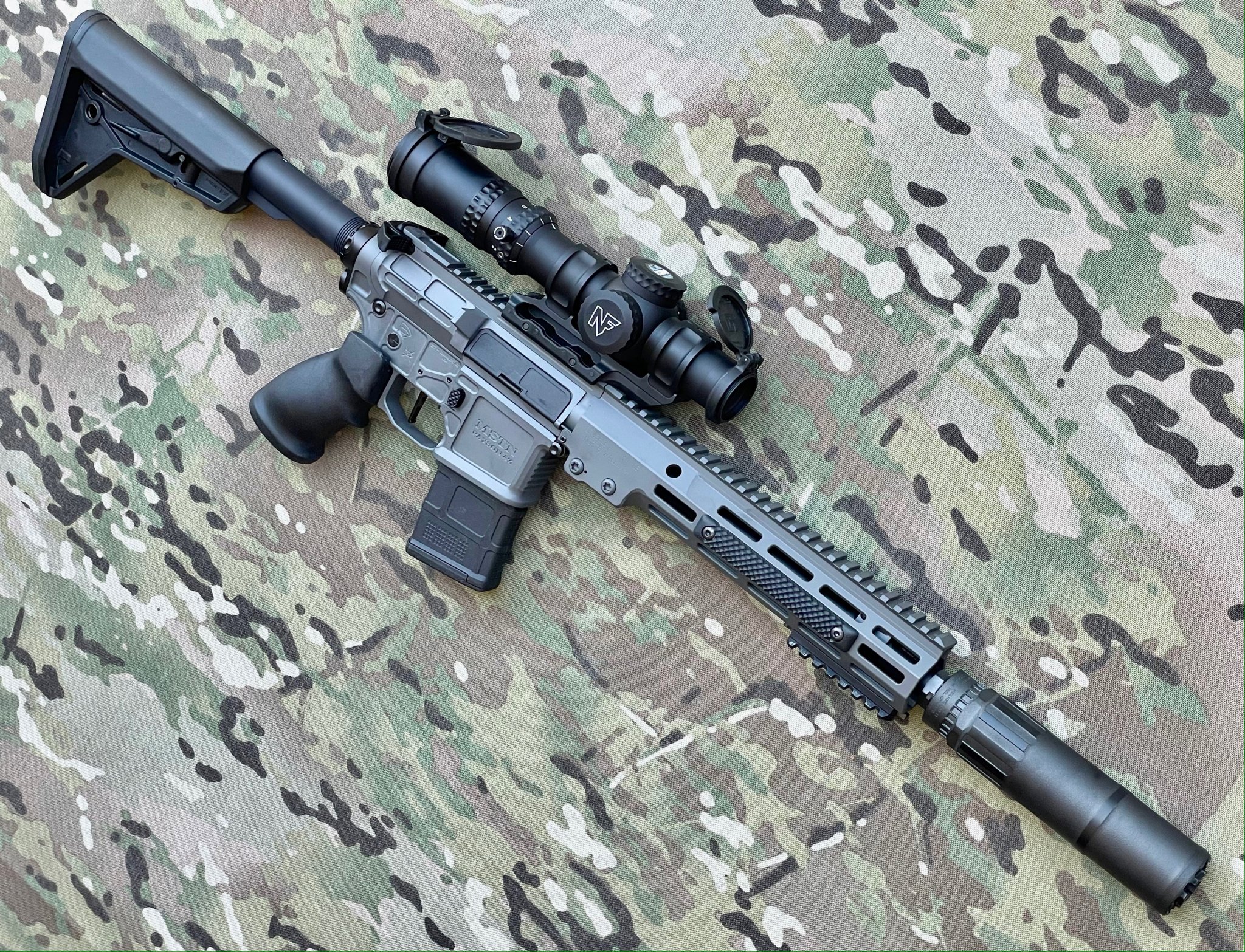

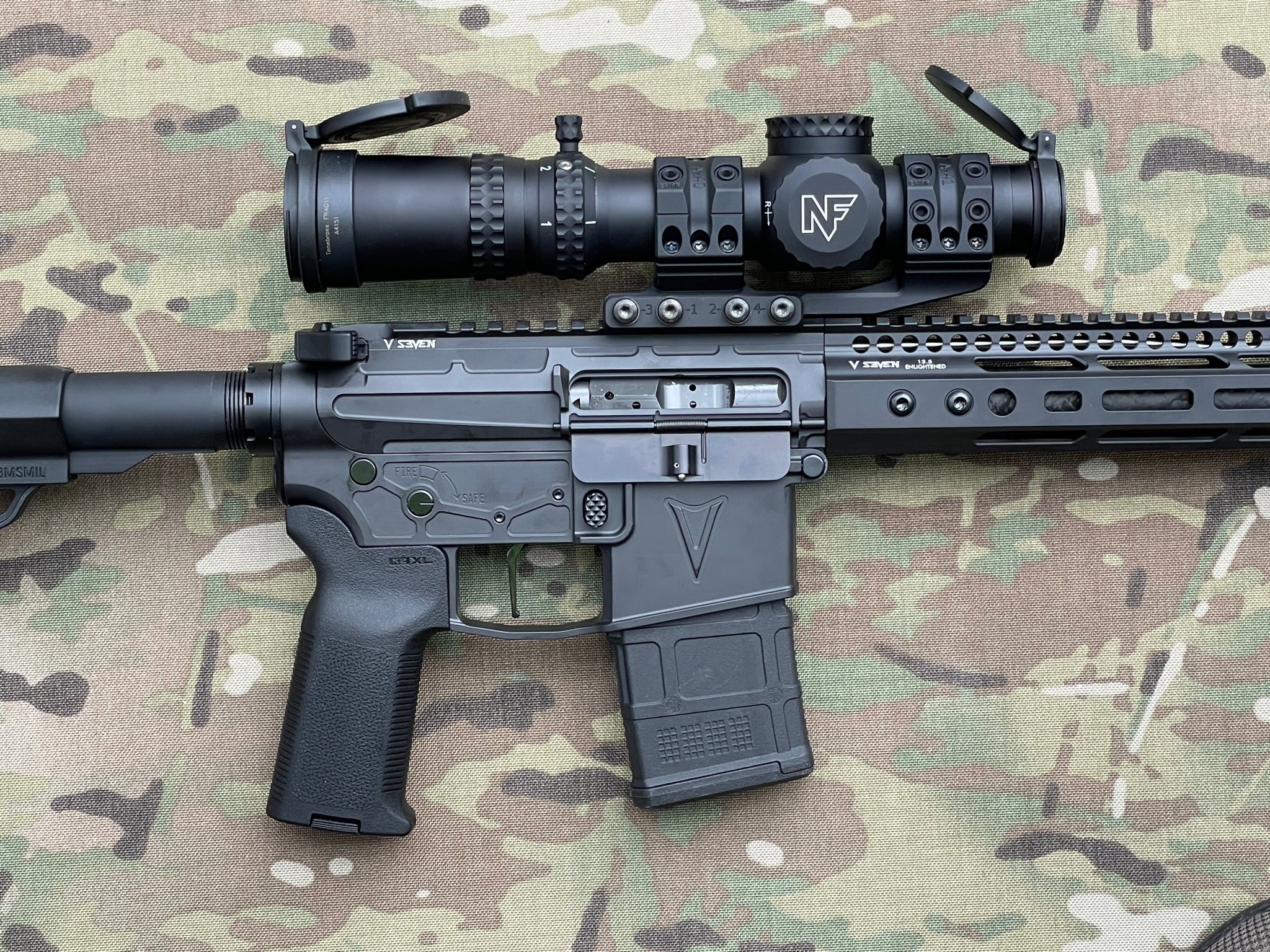

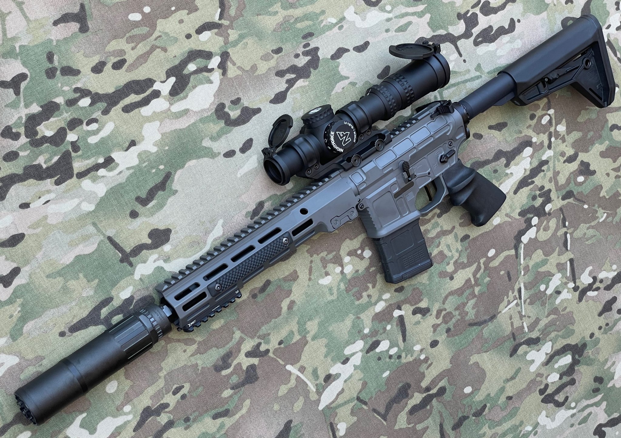

SanTan STT-15L billet receiver set with Geissele MK16 10.5" rail perfectly hiding a unique Craddock Precision Bartlein 11.3" 1x7 SS barrel chambered .223 Wylde. The usual V Seven small parts, Vltor A5 recoil system, TriggerTech Competition trigger, and Magpul plastic. The absolutely perfect Cerakote is by Ronin Arms. I'm really impressed with the Nightforce F1 1-8x24 ATACR scope in the Scalarworks LEAP/07 mount. The CGS Helios QD Ti is pretty interesting, as well. Already shooting well under MOA.

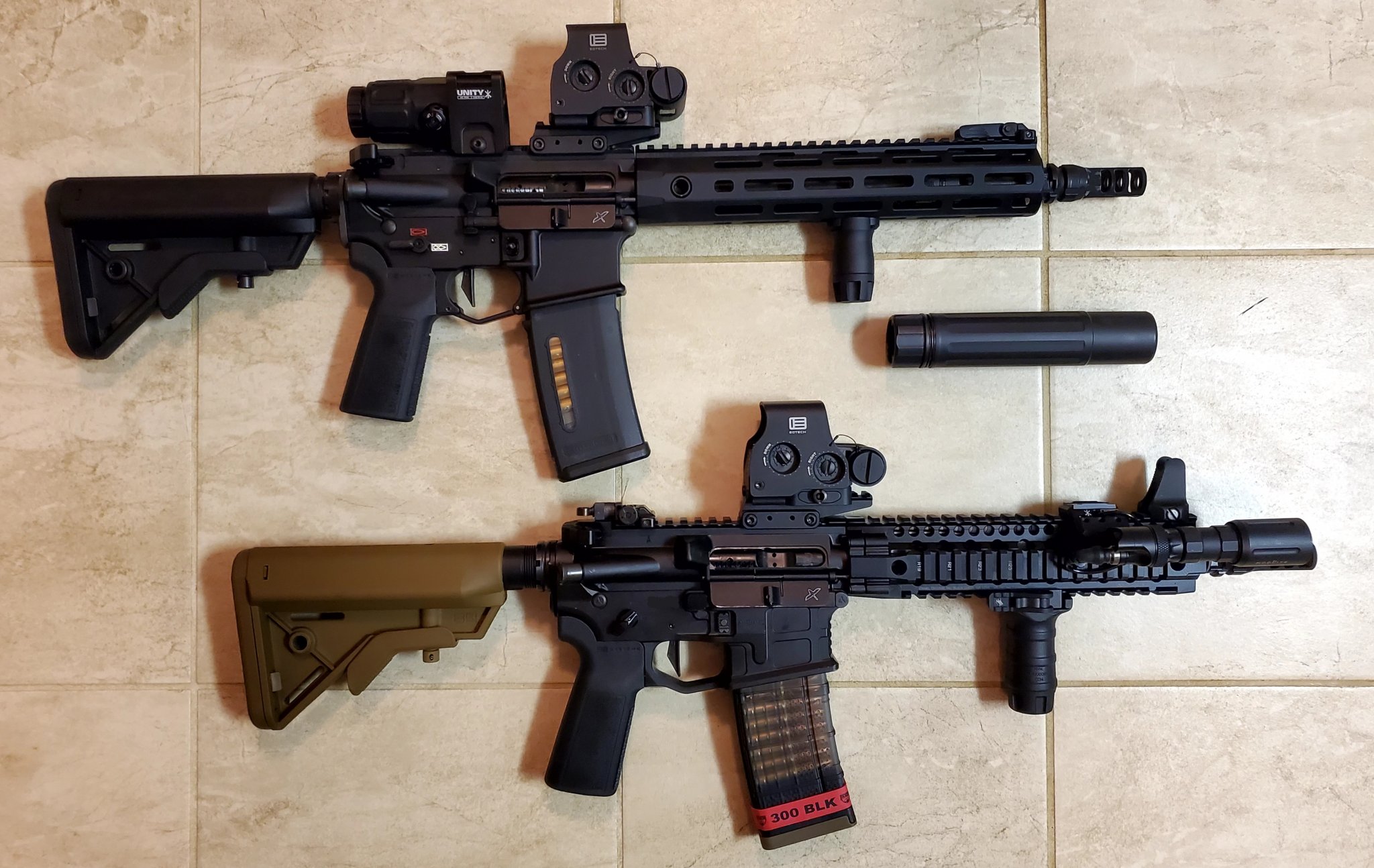

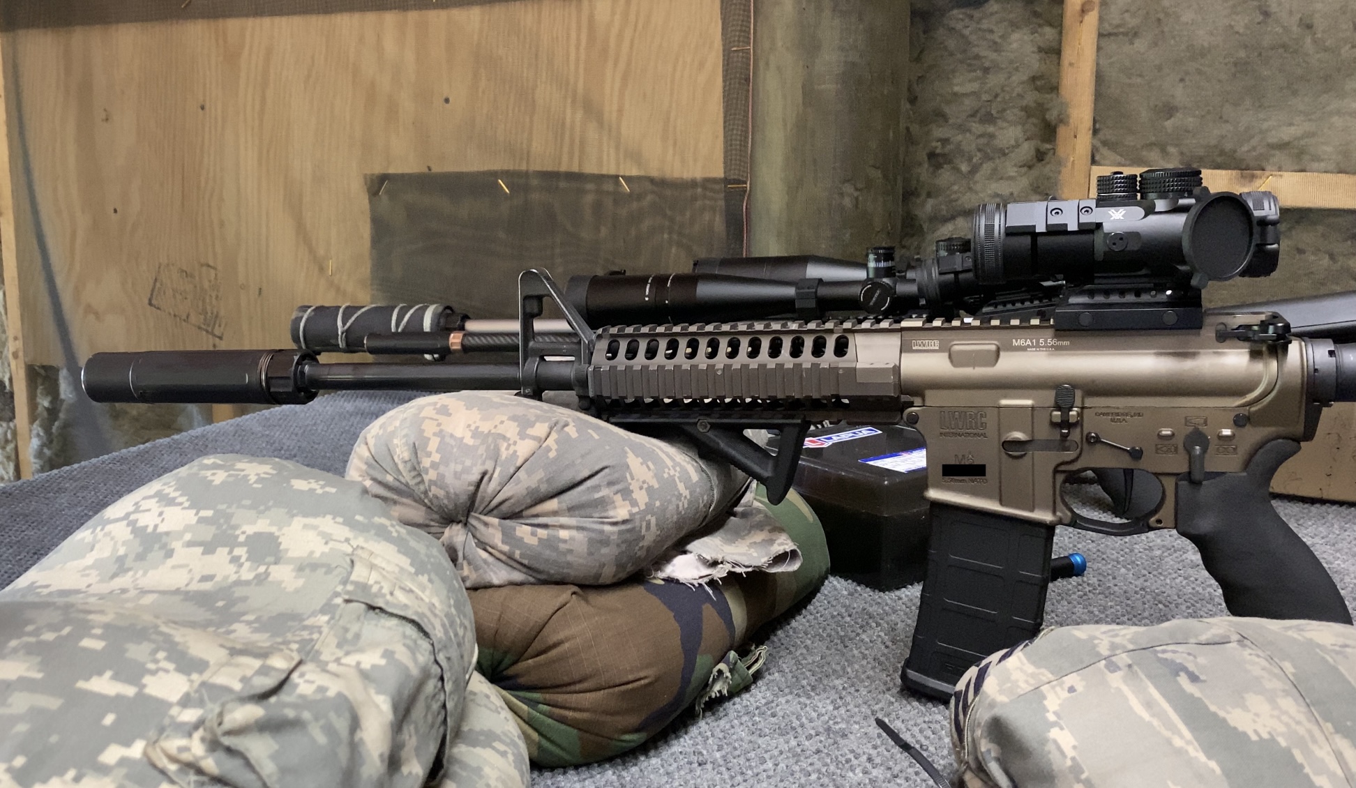

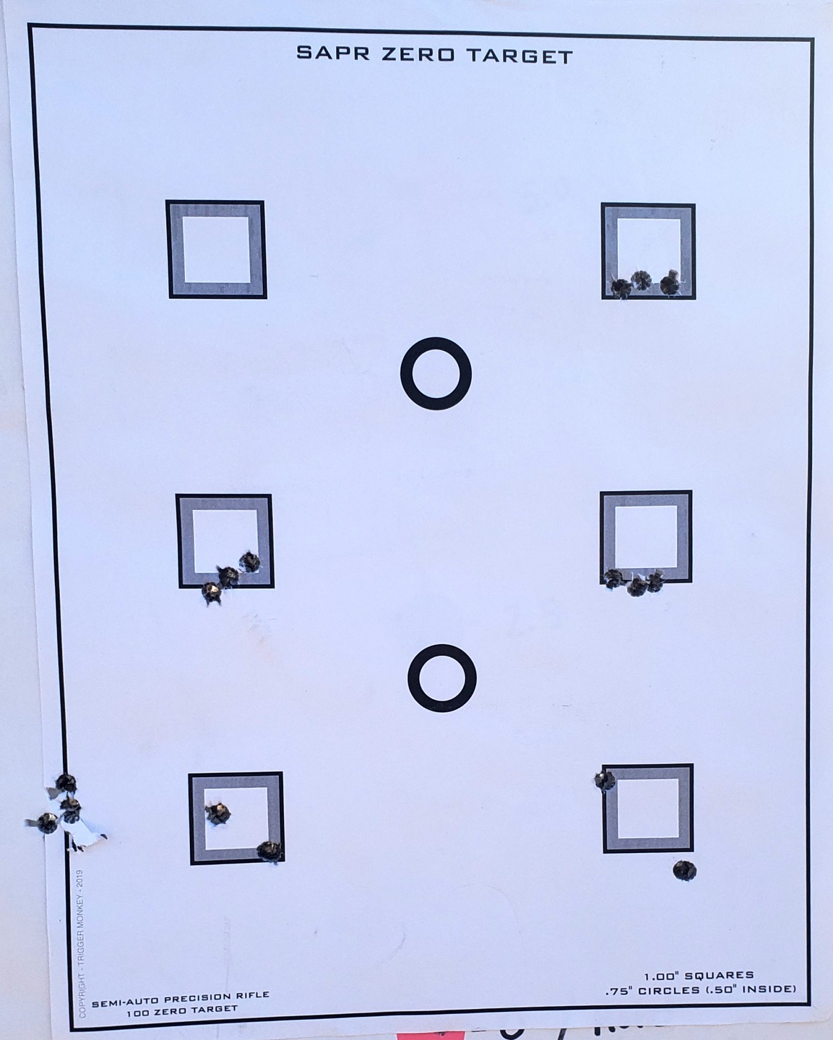

Took the old LWRC M6A1 to the range this morning, and sighed in the new optic on it. I had this spare Vortex Gen1 Spitfire 3x Prism optic sitting on the closet shelf after pulling it from my .300 BLK and installing the LPVO.
Plus, with my astigmatism, the old EOTech that’s been on my LWRC since new (circa 2009) is starting to look a bit fuzzy around the edges and in the middle aiming dot. Plus 5.56 BDC reticle, 3x magnification, red or green illumination if I need/want it, and better battery life. Why not? 🤷🏼
I still love EOTechs, but they’re kind of a 1-trick pony. And being that the rifle is capable of MUCH more than 100 yard tactical accuracy, it really deserved a more cable optic. I’ll keep the old EOTech, and probably toss it on a future 8.5” or 10.5” .300 BLK pistol build for a truck gun, or something.

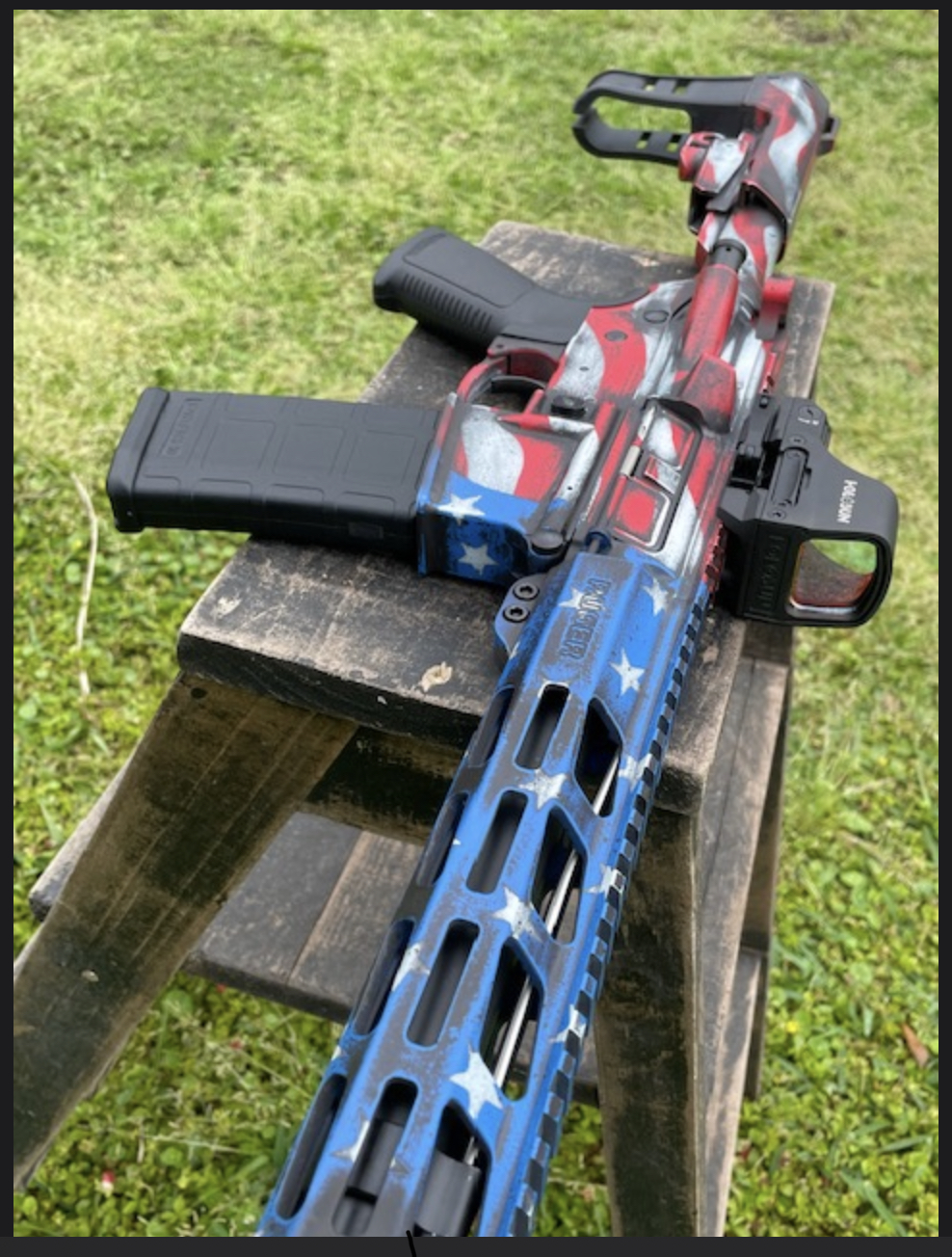

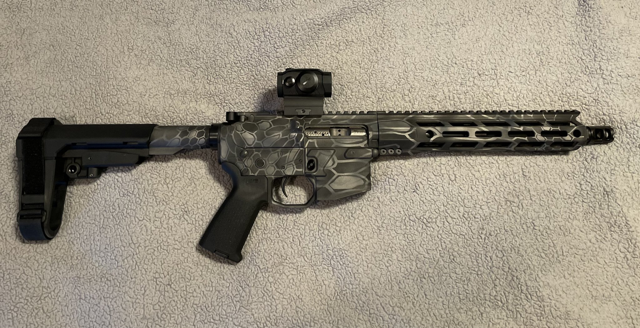

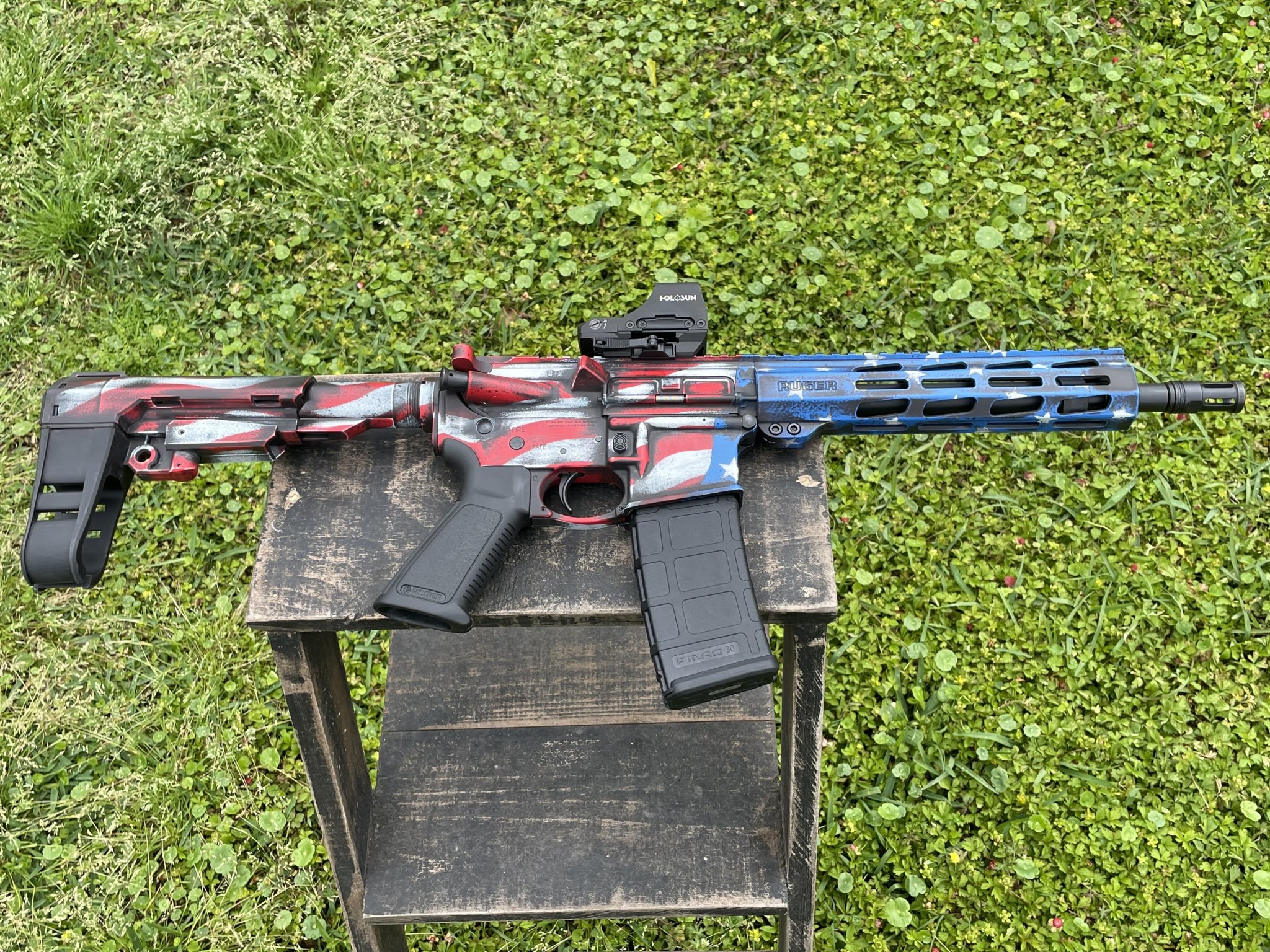

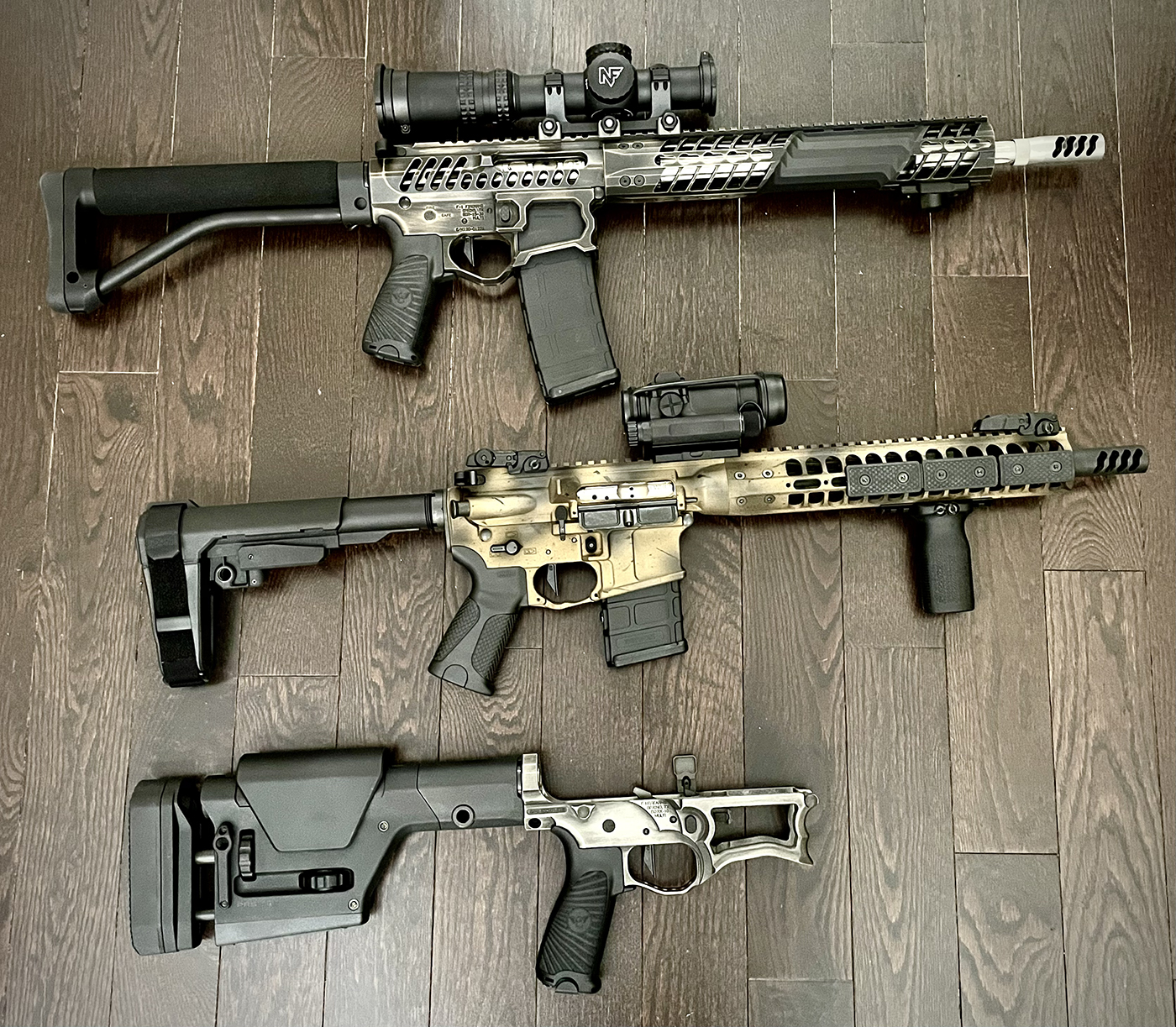

AR’s are generally kinda ugly to me. Saw some nice ones here! I come from mostly bolt guns, but have built quite a few AR platforms.

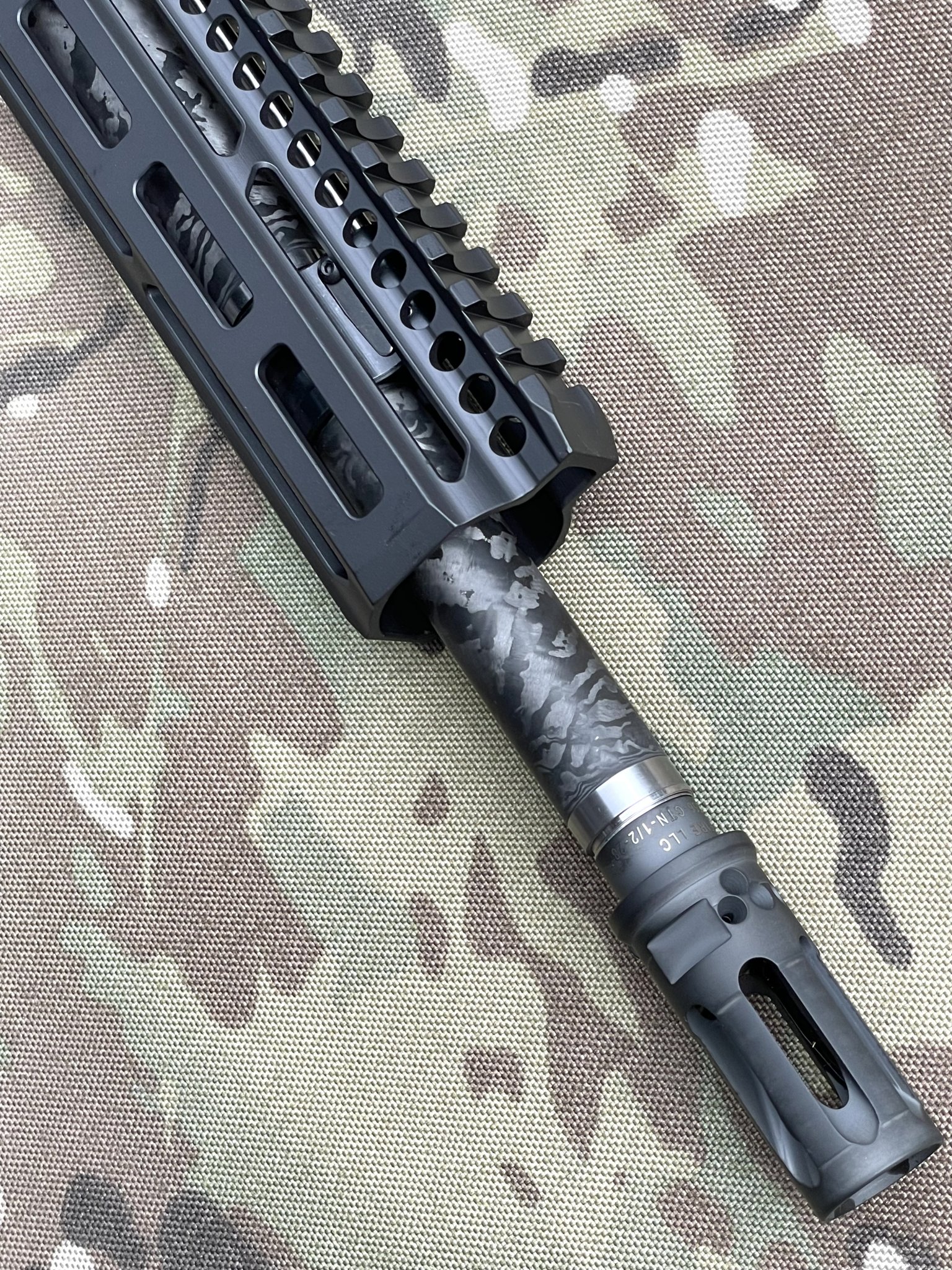

A couple I coated. Flag was a request by a friend. “Broken glass” is a pattern I use often.

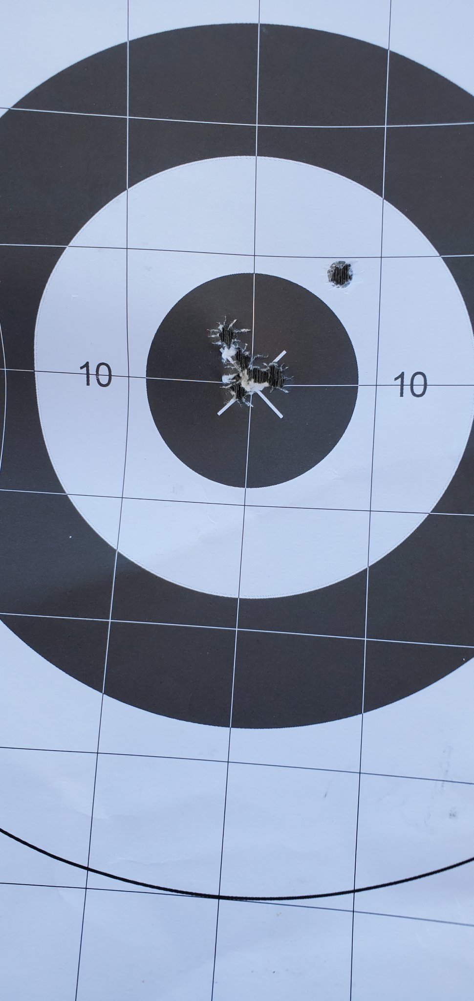

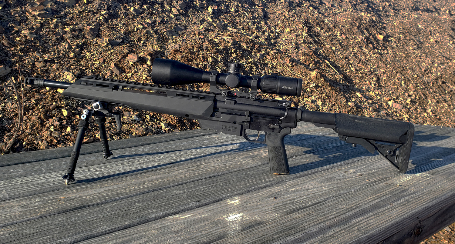

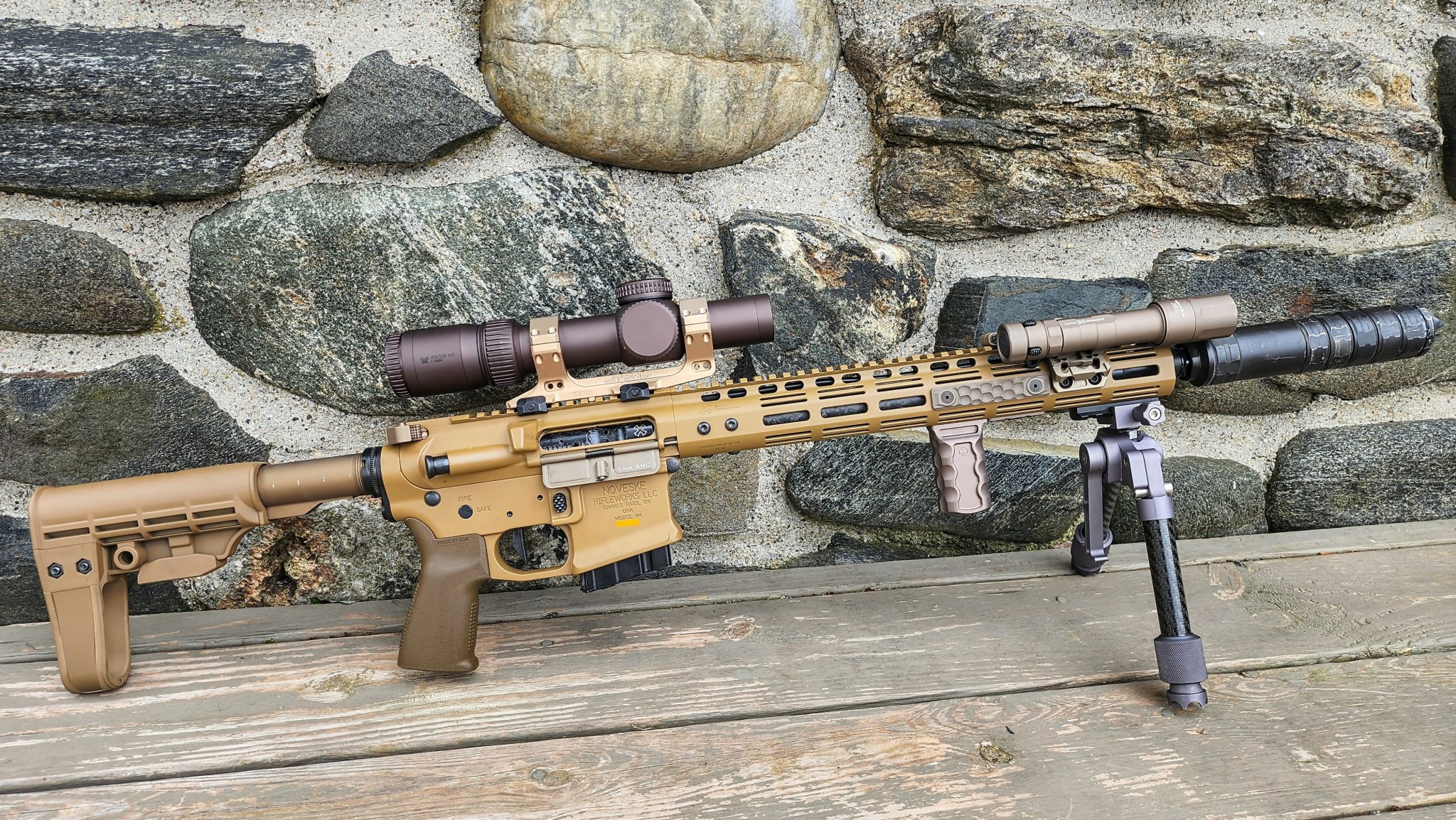

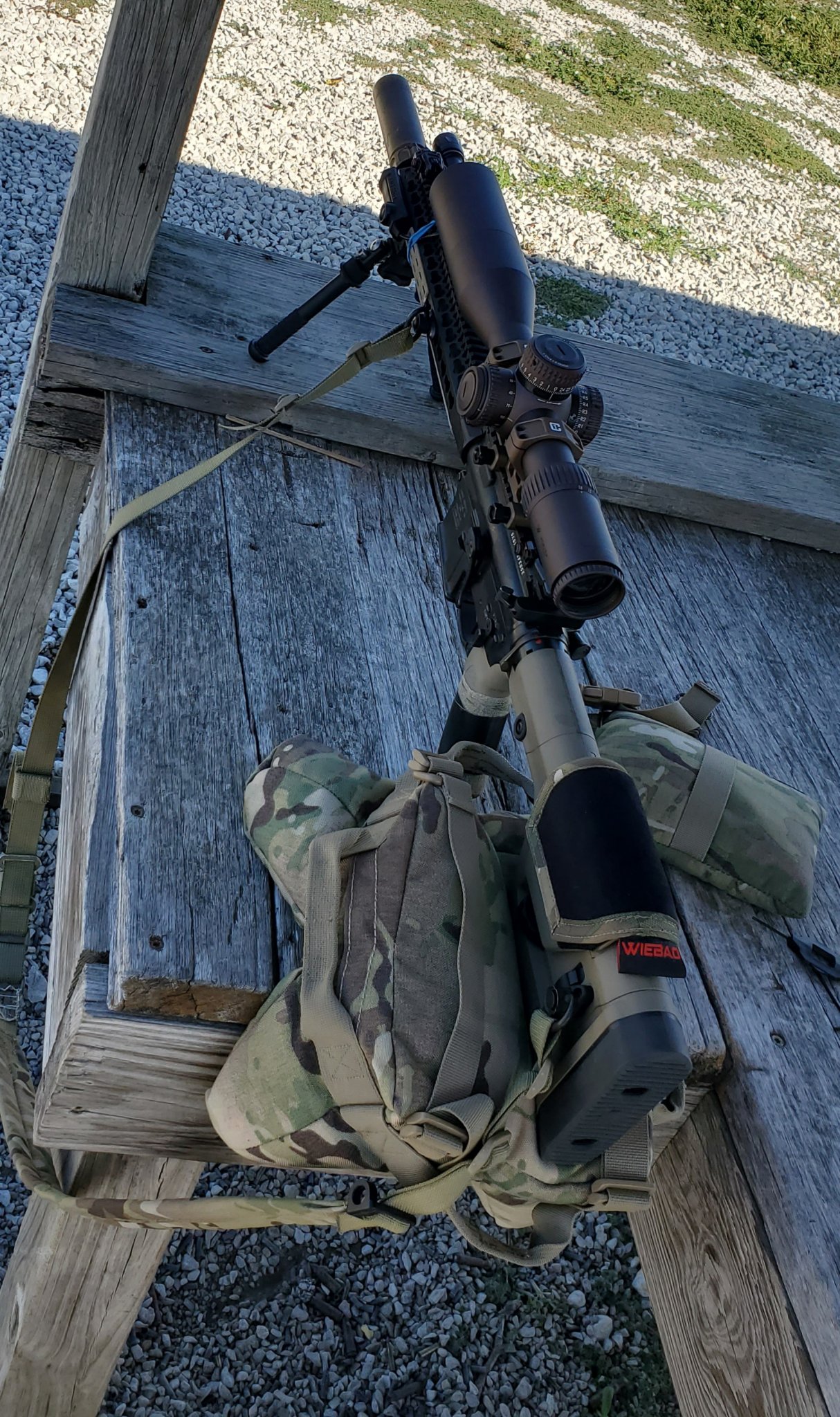

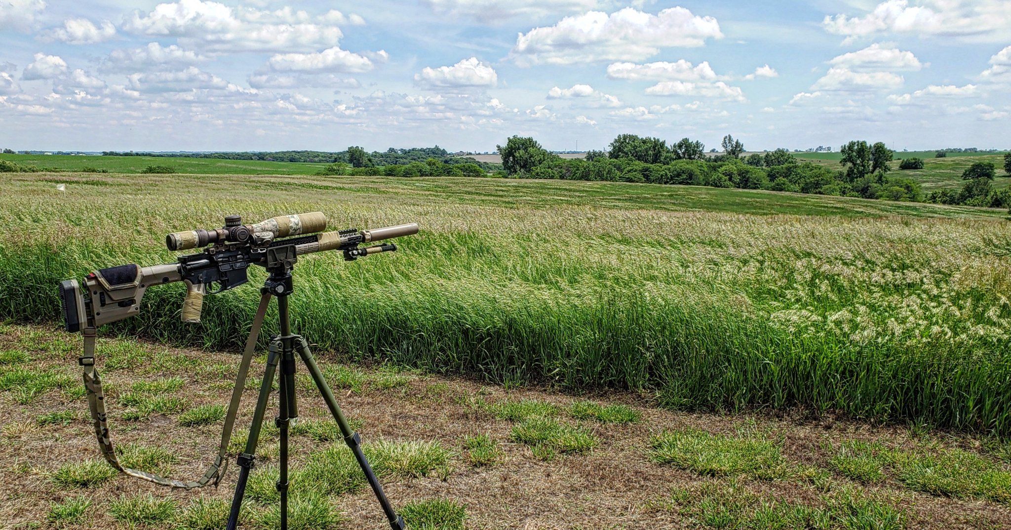

16in Sabre Defence SS/Fluted barrel
Magpul PRS Stock
Geissele SD-C trigger
Gen II Razor 3x18 (MOA) in Badger C1 w/offset Holosun 403GL
Surefire 762RC2
B&T Atlas
Shadowtech CF4 Tripod, GNNXB52DL ballhead and HOG Saddle. *Group was shot off bench with a rear bag using PMC XTAC 77Gr OTM.

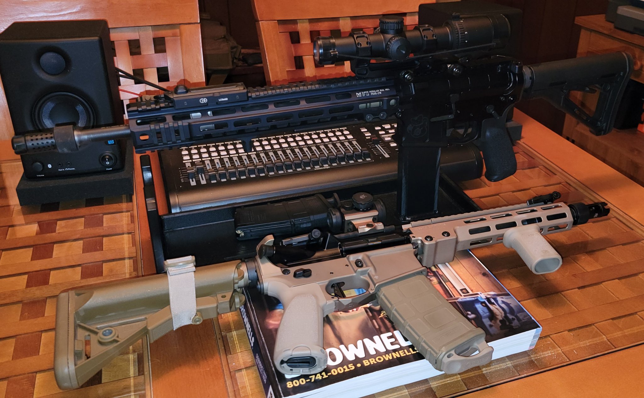

New video is up comparing a piston rifle vs. a DI rifle to see if there's any noticeable volume or sound differences.
Interesting. It seems the piston was more consistent over the five shots and the DI was louder for the first 2 then was noticeably quieter than the piston for the remaining 3.
Did you observe this from the shooter’s perspective?
That was the DI gun being louder (port pop), causing the audio to clip. At the shooter’s ear, the LWRC (piston) is quieter, as the piston vents up near the gas block, not directly at your right ear, like the DI gun.

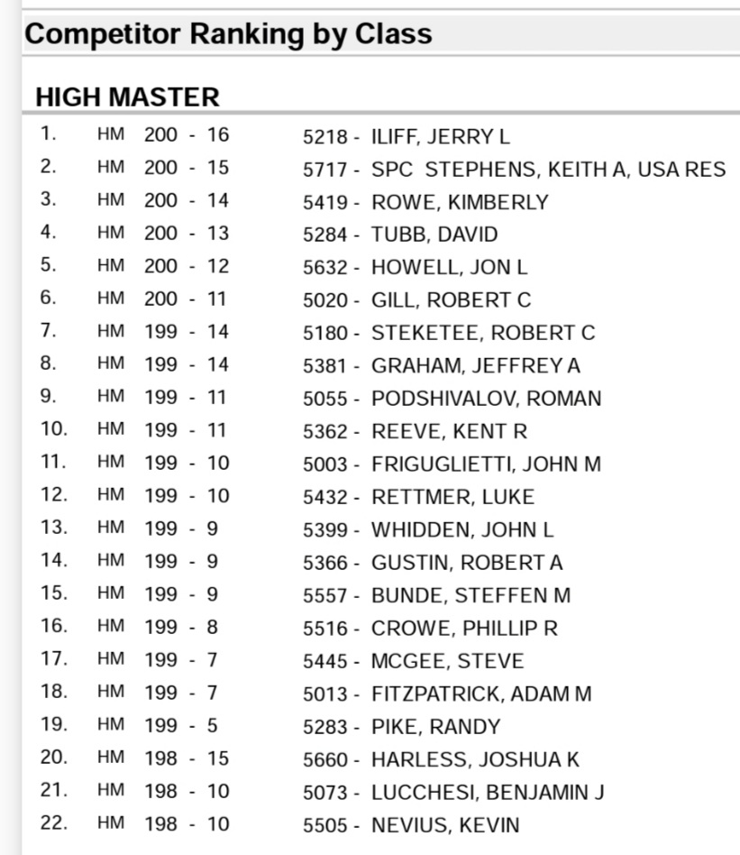

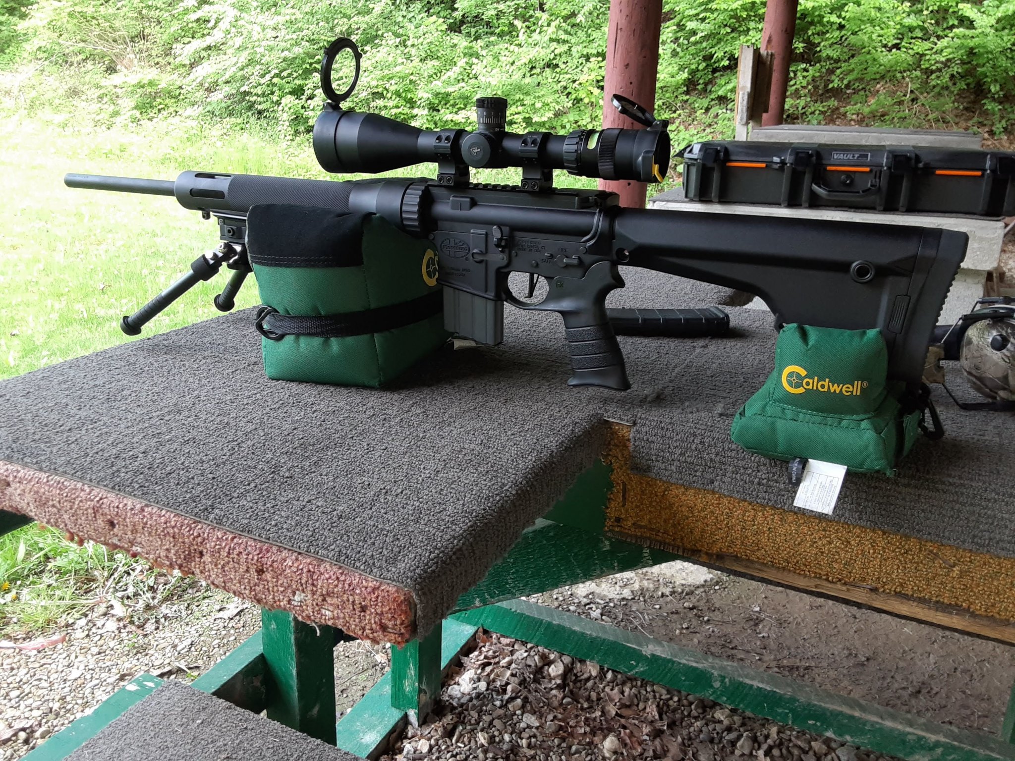

Do you see many people running .308 AR's for Service Rifle?
Mainly in the 1000 yard matches. Former teammate of mine, Keith, was recruited by the US Army Reserve Rifle Team after he won the P100 in 2016. He shot his AR10 at the 1st 1000 yard match at the NRA National at Atterbury in 2018, he did quite well considering the AR10 service rifle is handicapped at 20 inches and 4.5X scope and shooting against the best prone shooters in the country.
Load was with 168 Berger Hybrids.
In 2017 I watched the Interservice at Quantico, a Reserve M14 shooter bested the AR10s in the individual 1000 yards.

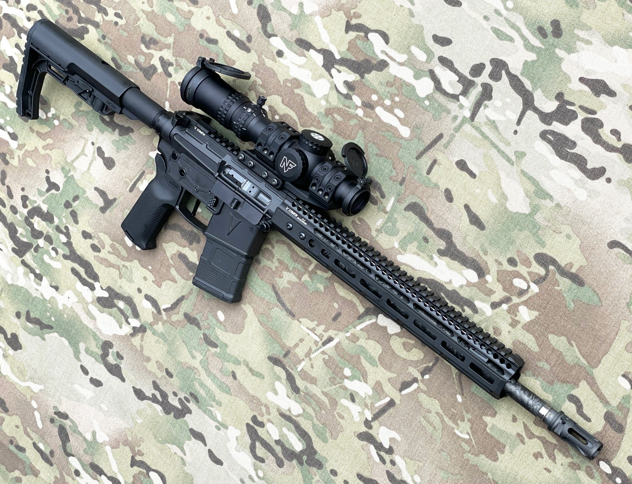

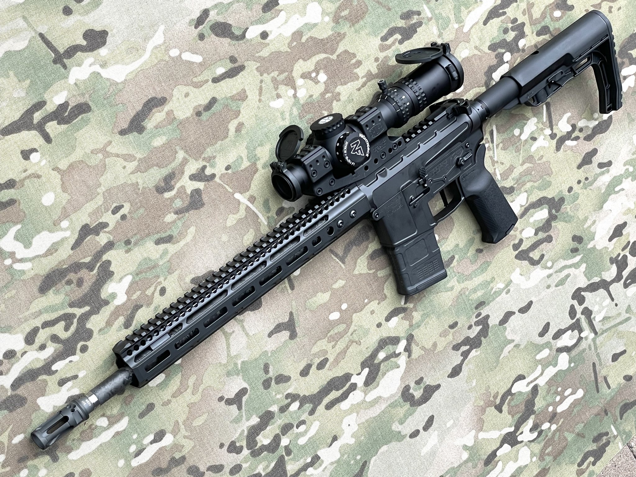

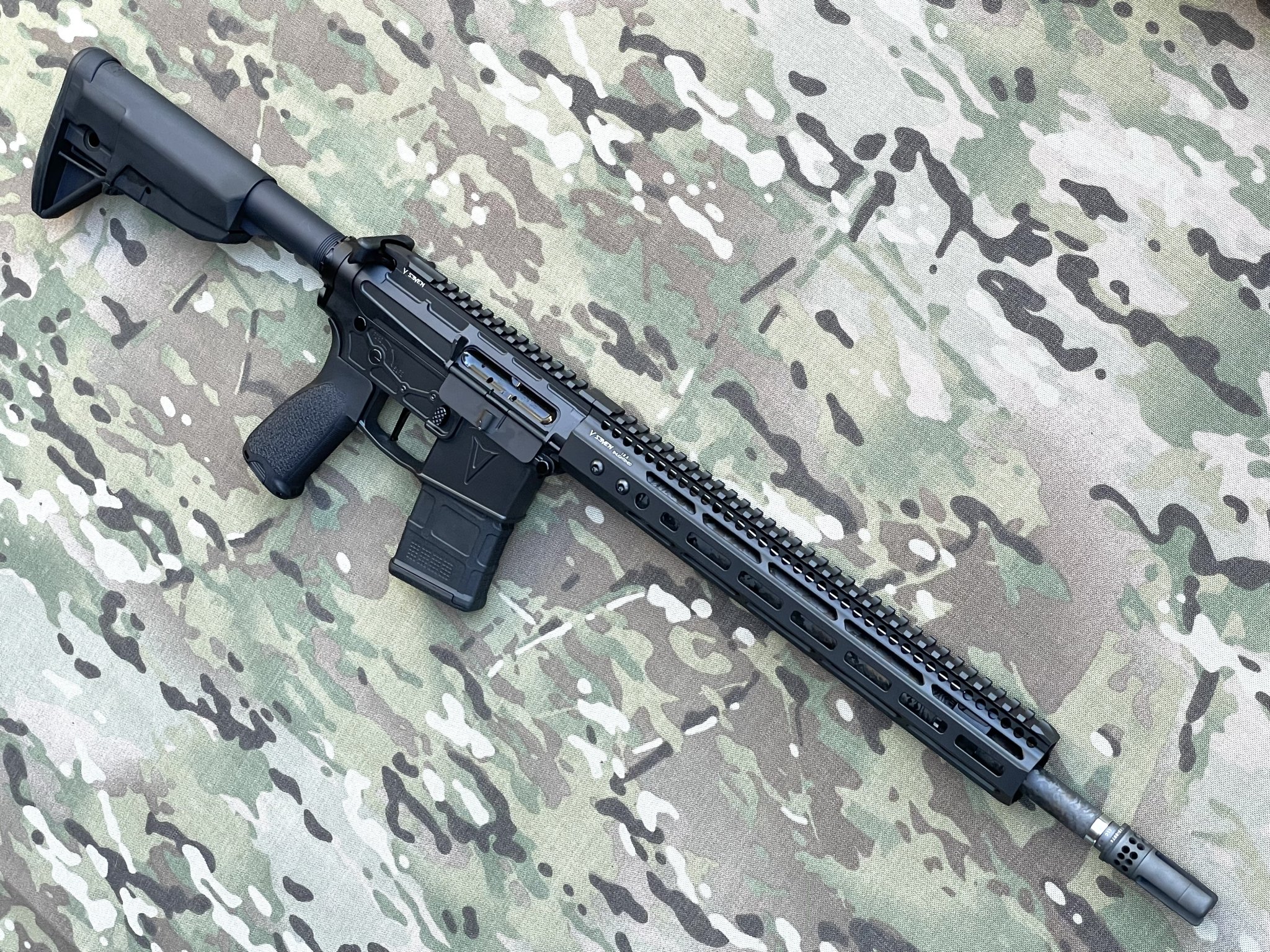

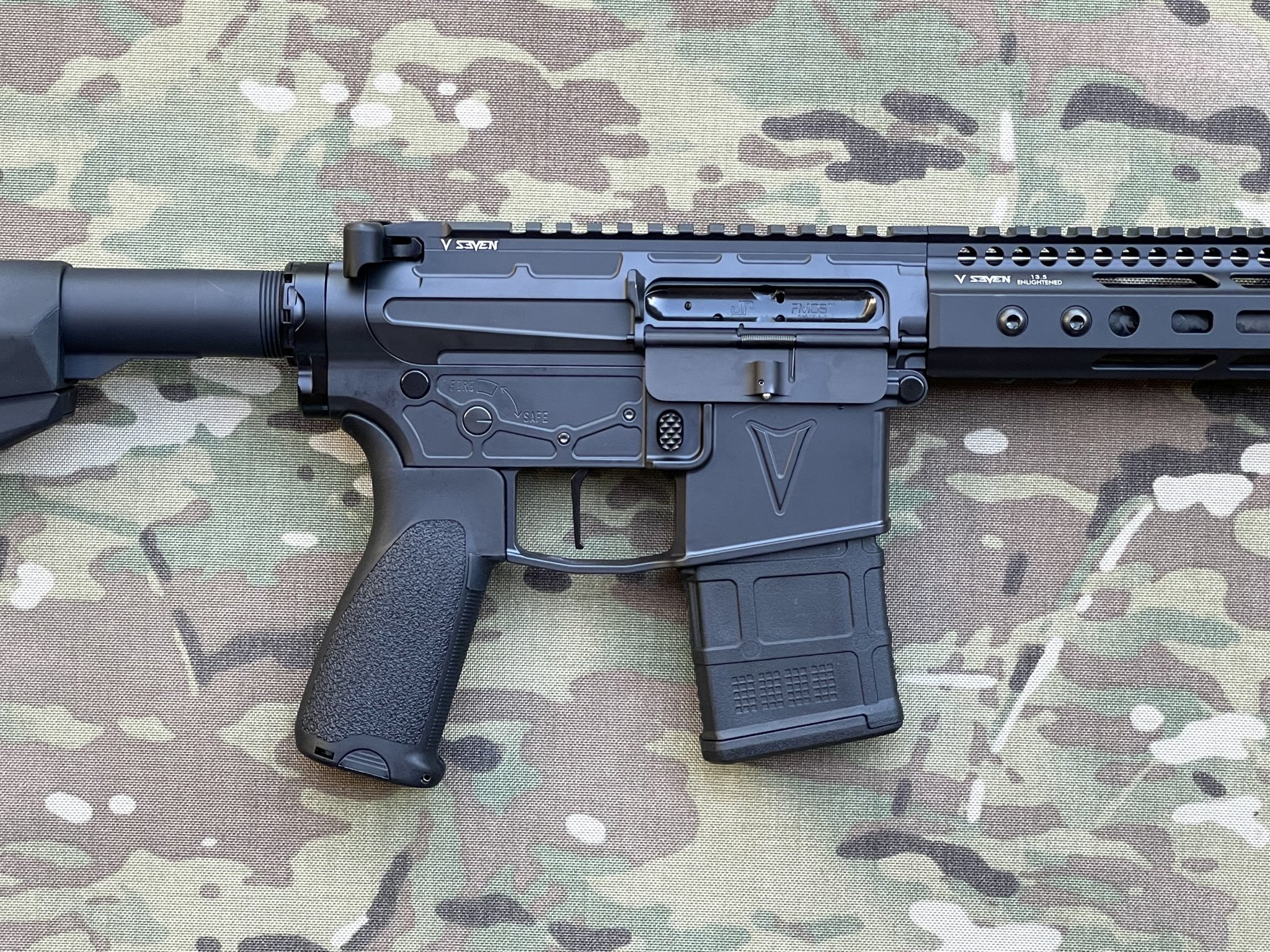

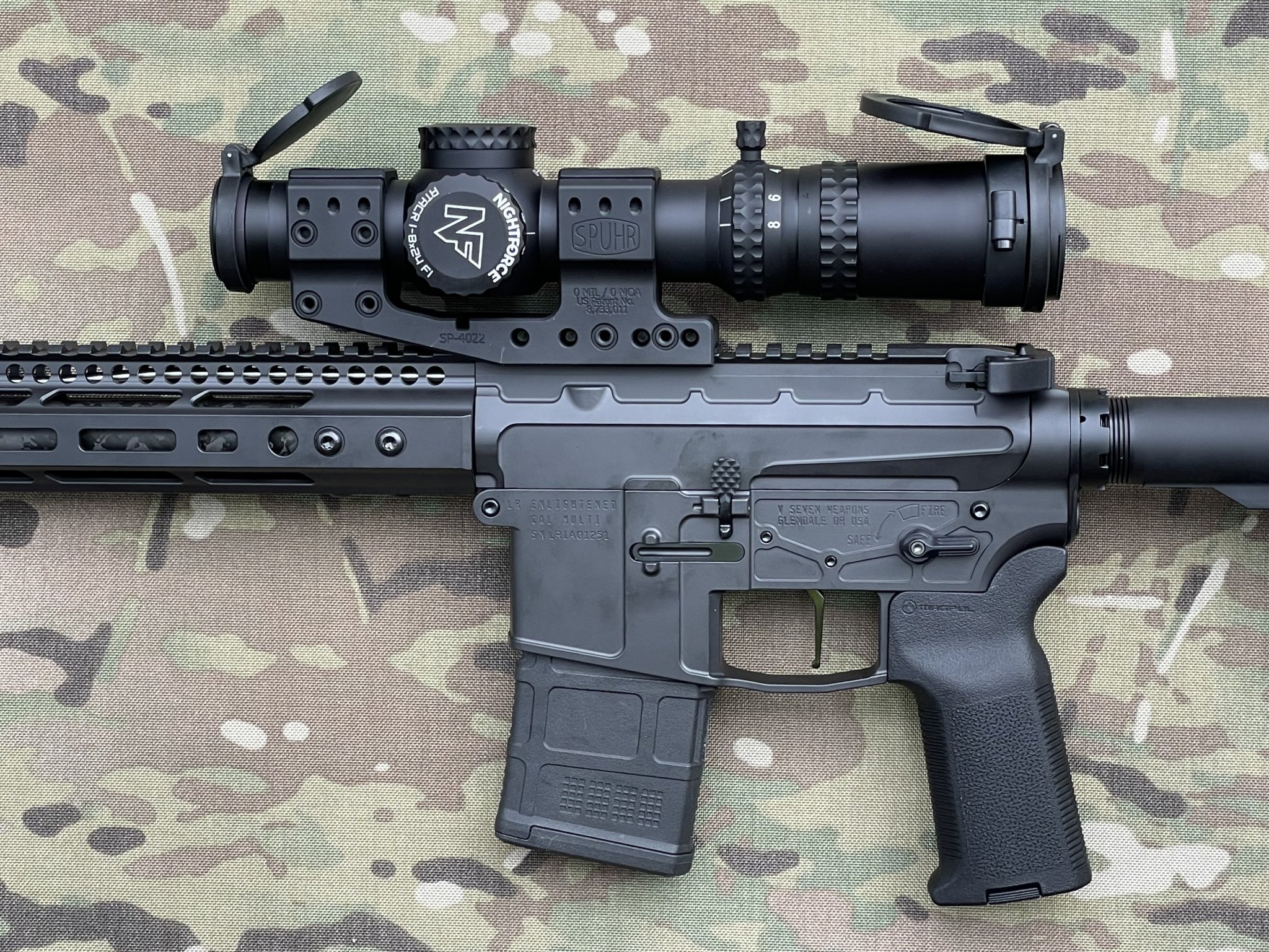

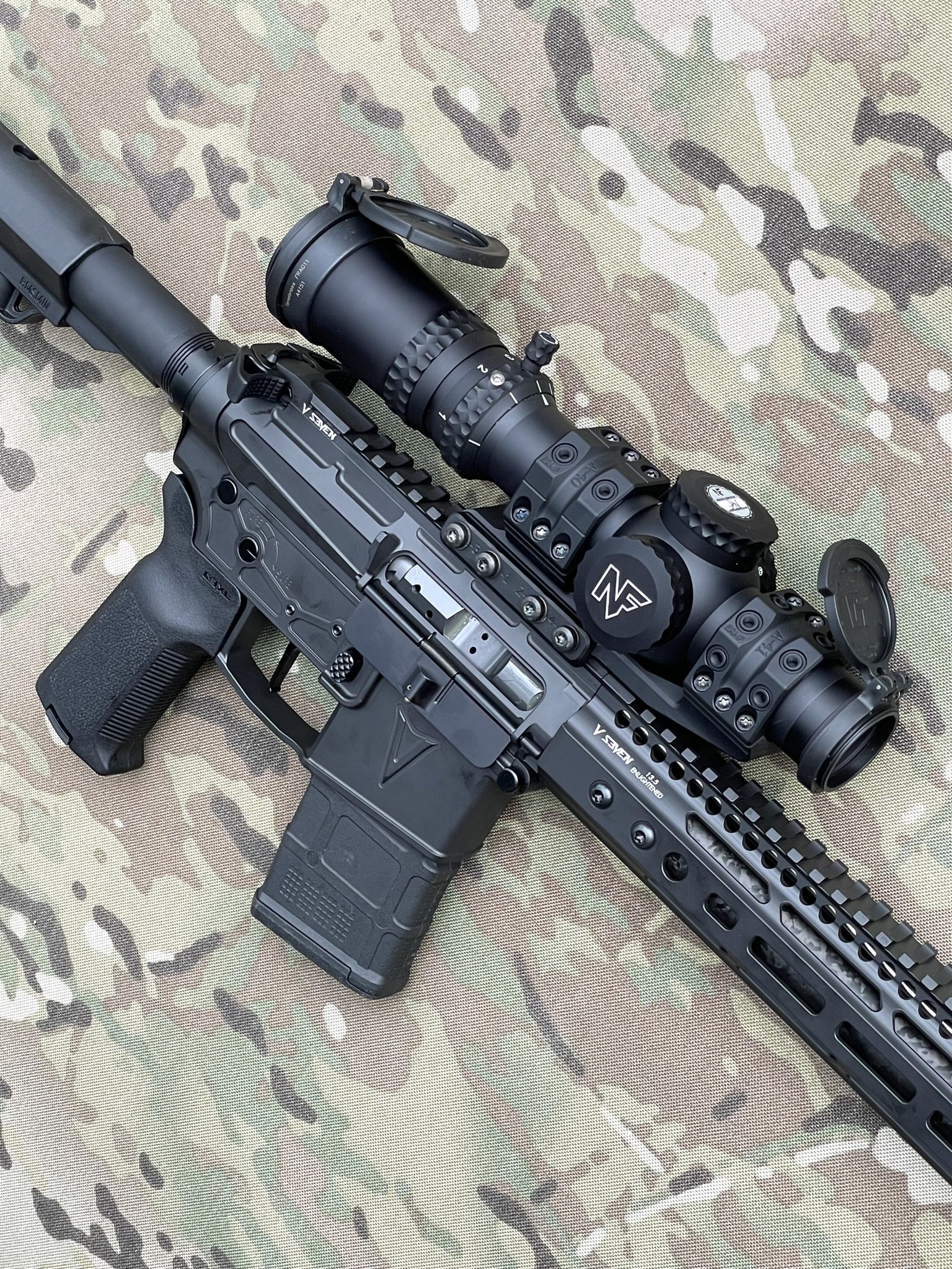

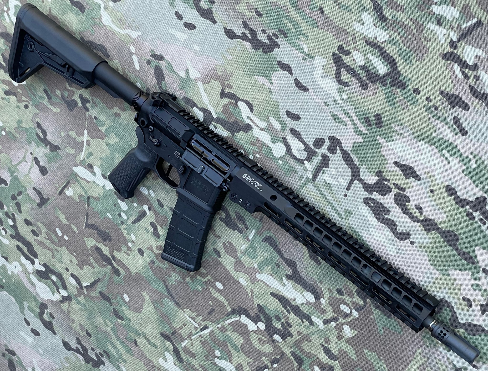

Another Lightweight Recce built up with V7 magic and a Proof 16" .223 Wylde barrel. Other components enhancing the DNA include: TriggerTech Adaptable trigger - set really, really light; JP Enhanced Bolt riding in a Young Mfg. N/M bolt carrier (discontinued), all DLC coated; Newest BCM recoil system - patented; SLR adjustable gas block; SF WarComp; MFT stock; Magpul Pmag; Nightforce ATACR 1-8x24 F1 in Spuhr mount; big, ugly Magpul K2 - size XL - better suited for a bolt gun chassis than an AR'. My guess is the new owner will ask me to swap it out once he realizes it's just not right. And I will, gladly. The gun shot sub-MOA for five at 200 on the very first try with the customer's Berger 73 Match load. Zero stop set.

Sick! Fantastic build!

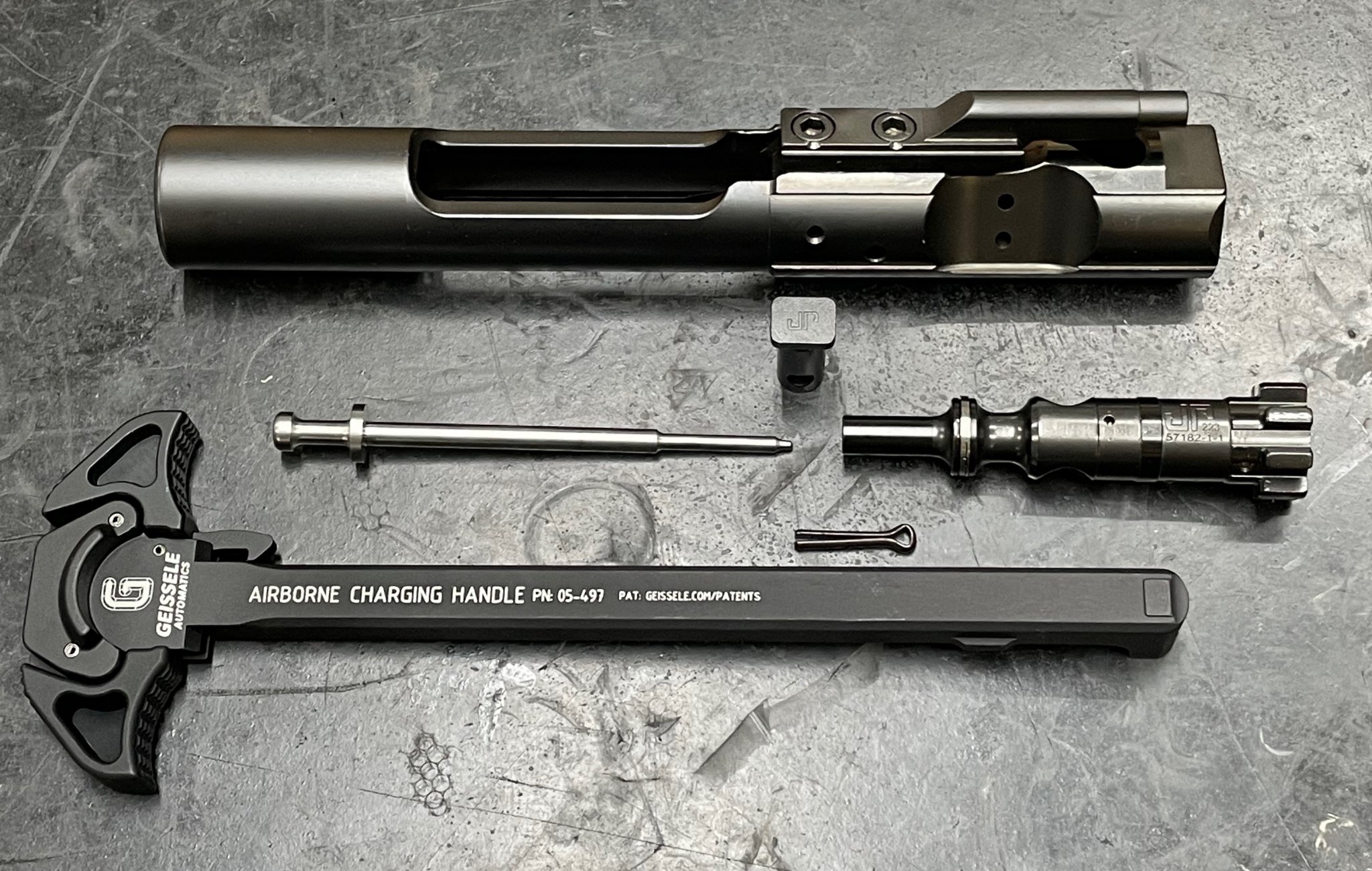

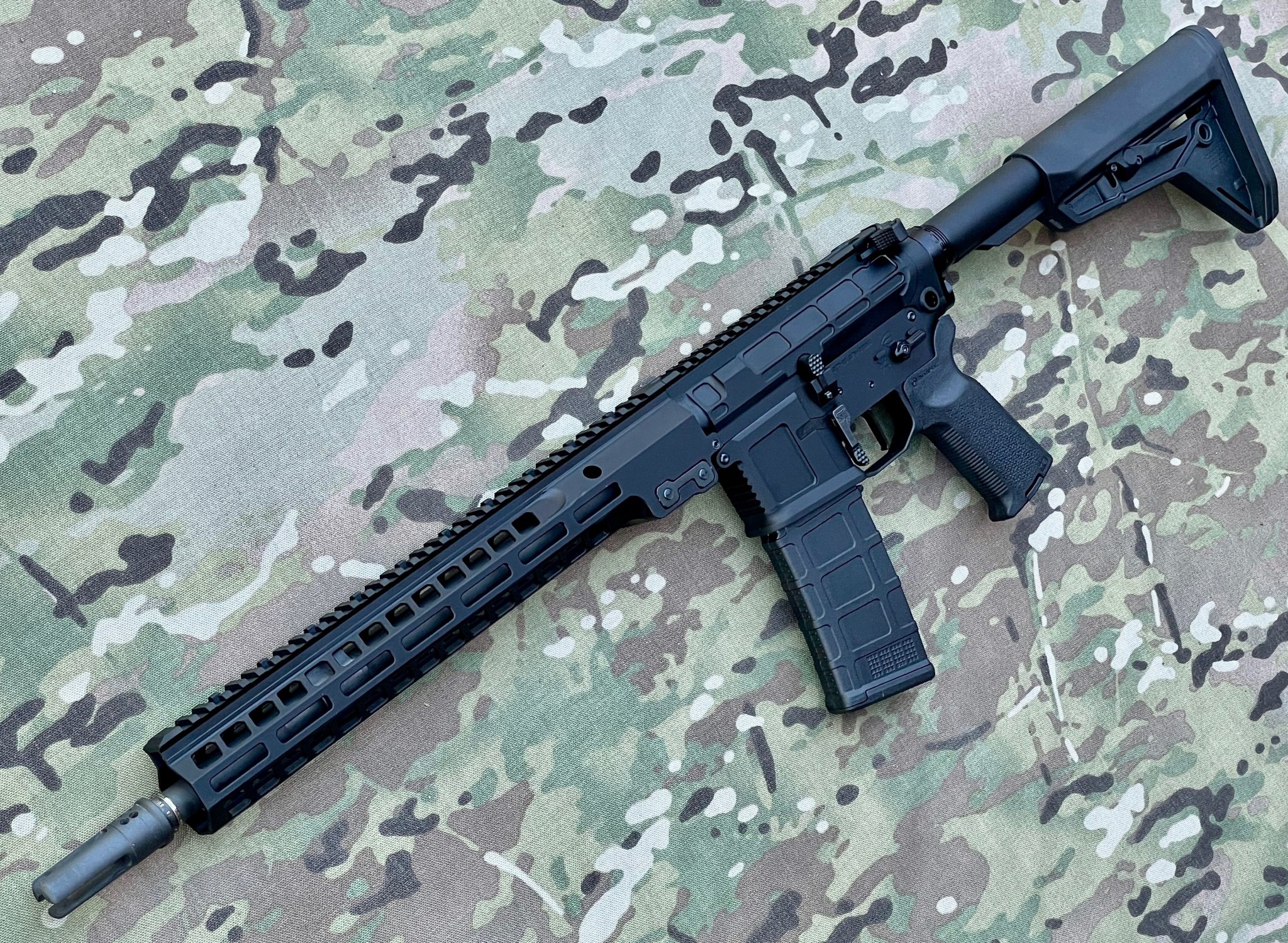

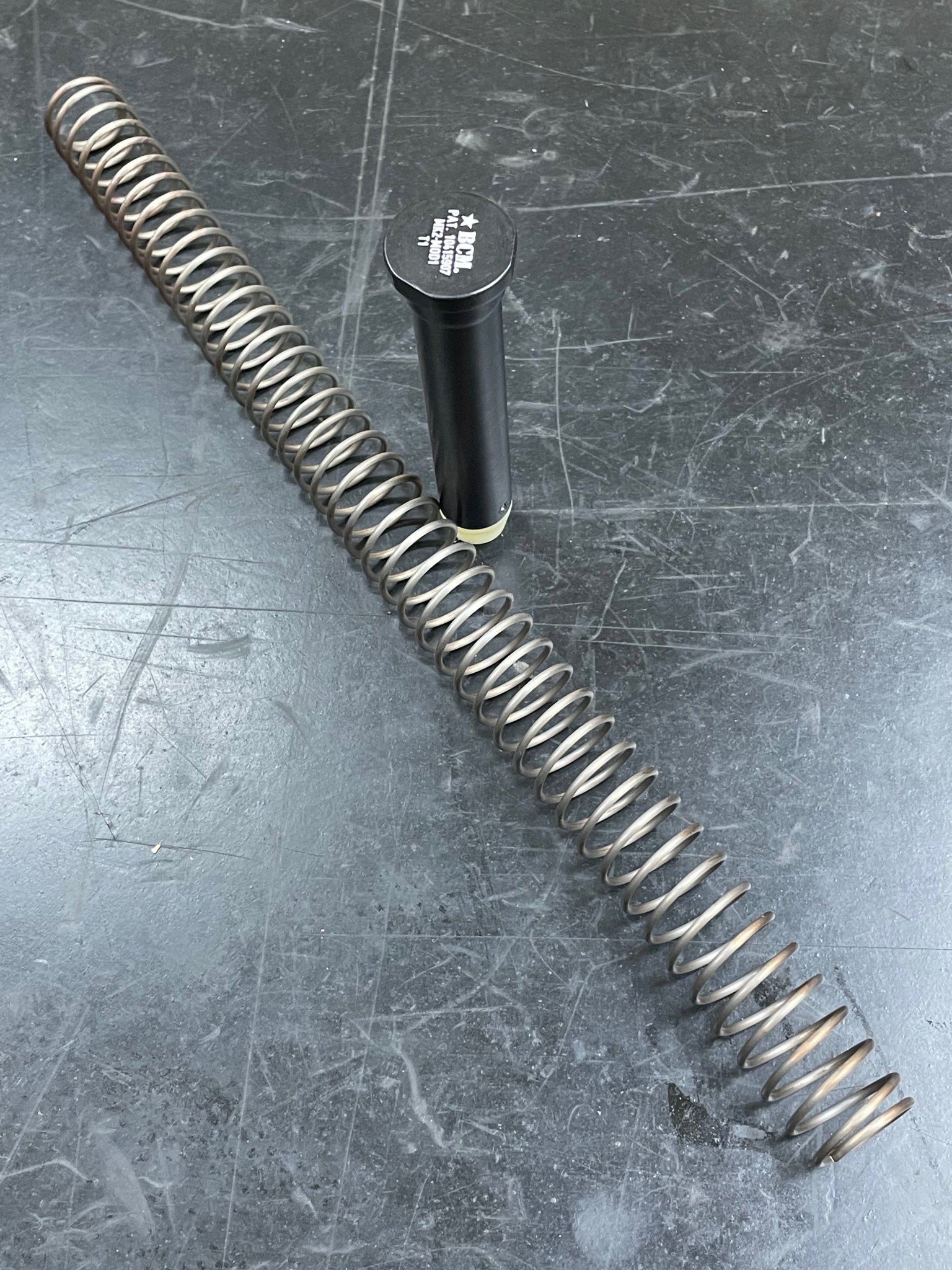

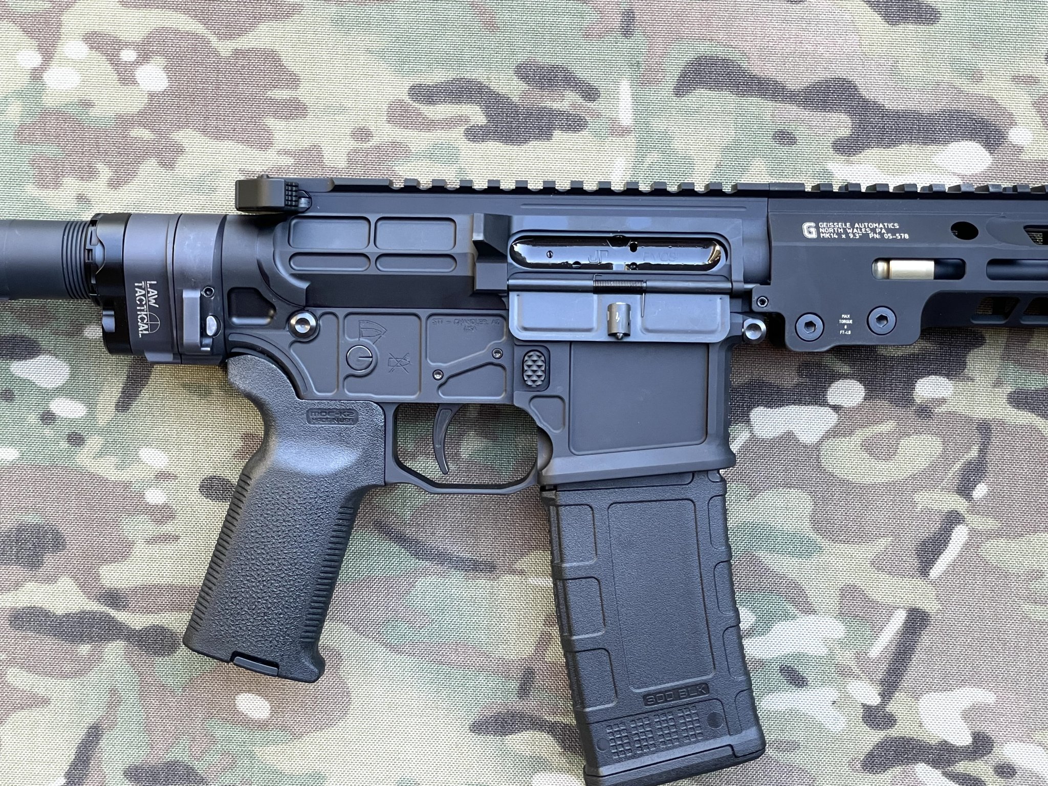

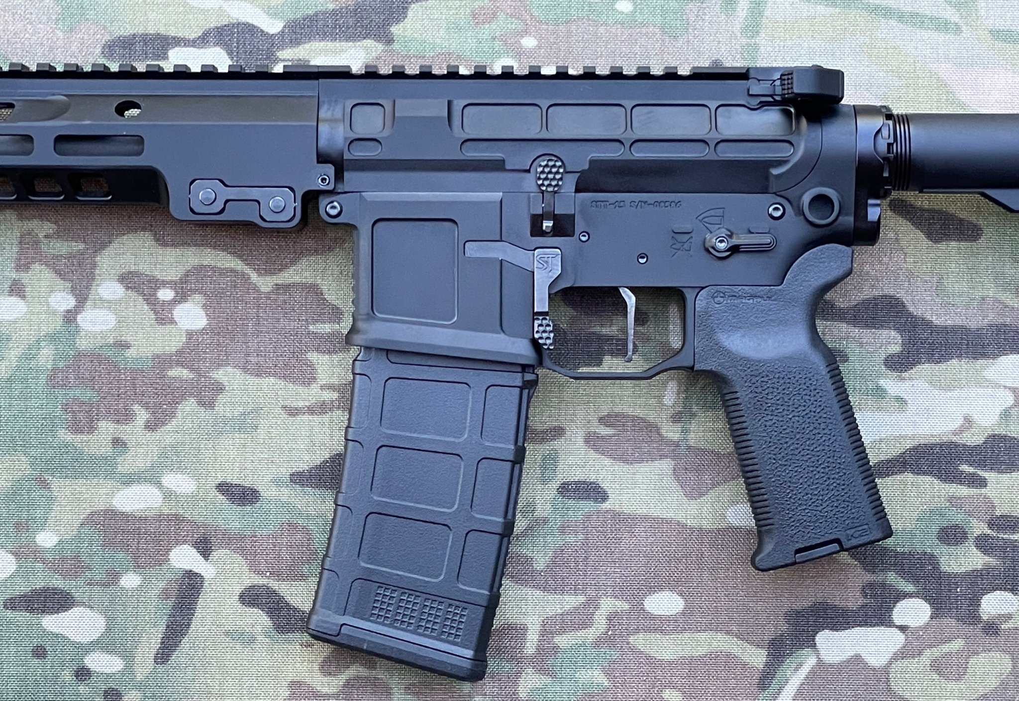

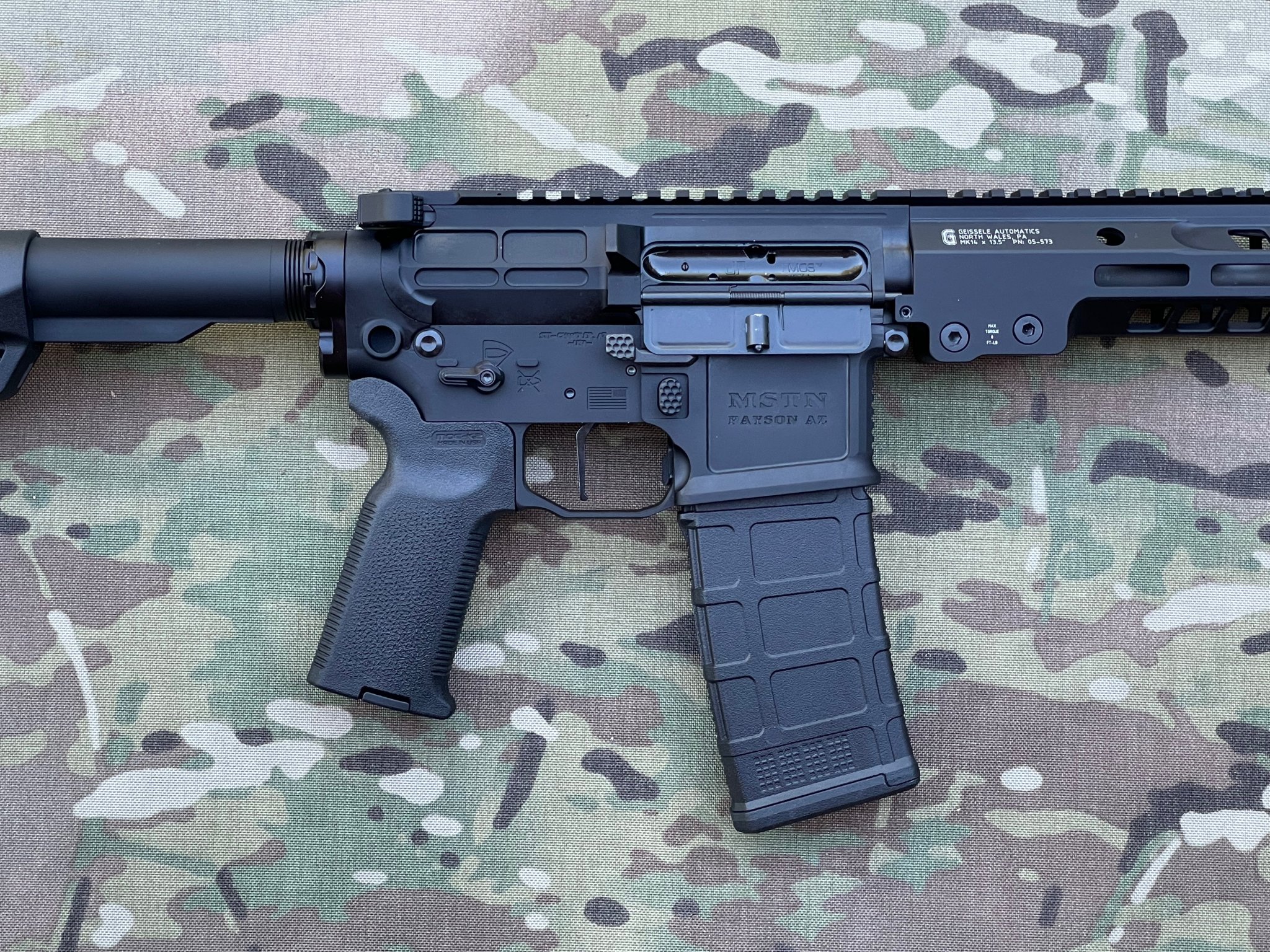

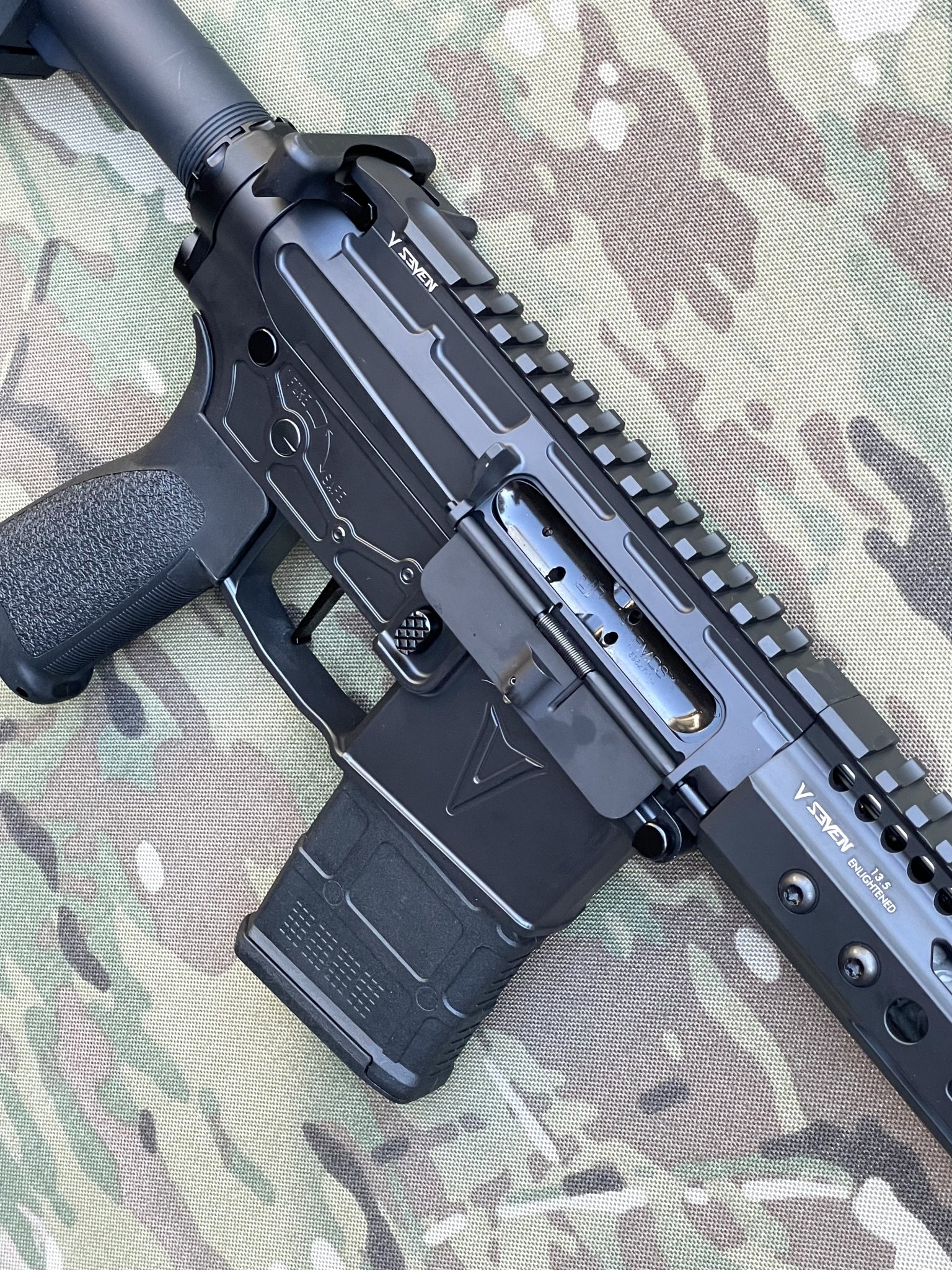

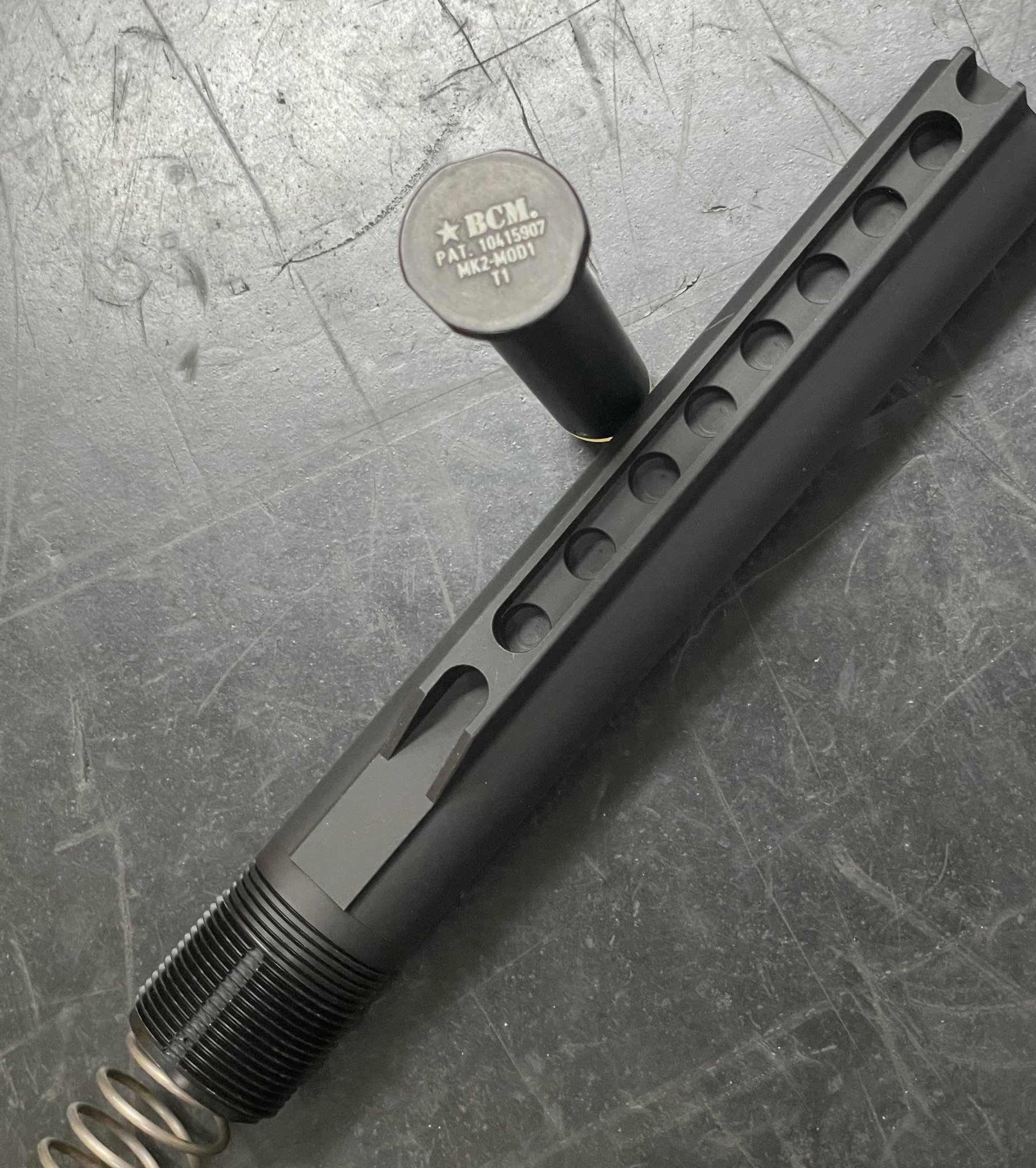

The last AR' blaster you'll ever need - Just over 6 pounds, hard use capable, precision capable, and easy on the eyes. The foundation is the superb SanTan Tactical STT-15 billet ambi receiver set. The key component is a hard-to-get Noveske 14.5" hammer forged, chrome lined, Afghan barrel with mid-length gas system, capable of sub-MOA performance with match grade ammo, yet capable of handling a training schedule that would simply eat up conventional barrels. A Surefire WarComp pinned and welded to the muzzle gives us a 16+" barrel overall length. Barrel feed ramps contoured and polished in the fashion that has worked so well for MSTN over the last 20 years. The moving parts: New, patented BCM MK2 Recoil Mitigation System - Mod 1 - T1, the successor to the Vltor A5 recoil system; JP Full Mass Operating System bolt carrier group with JP Enhanced DLC coated bolt fitted at the optimum 1.4666"; TriggerTech Competition Trigger breaking at an ultra-crisp 3.5 LB on V7 titanium fire control pins; Geissele Airborne Charging Handle; DHD ambi short throw safery selector. Parts that don't move by Dark Hour Defense, V7, and Fortis. Plastic by Magpul.

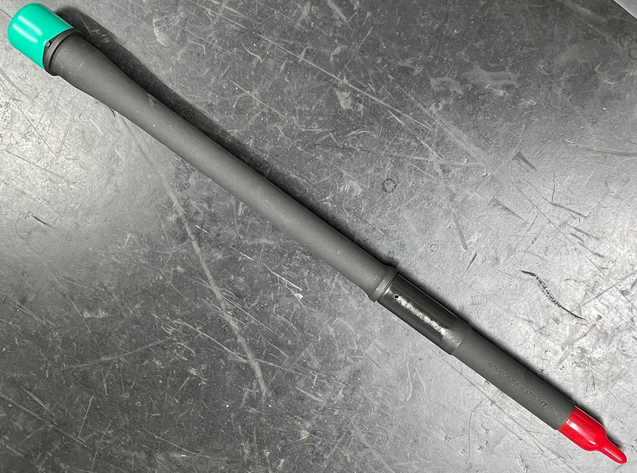

Do you have a pic of the barrel outside/without the handguard.
There are lots of quality gas blocks out there these days. I typically use SLR for everything because it's one stop shopping for both my fixed and adjustable gas blocks, they're visually attractive, and they ship fast. But Badger, PRI, LaRue, and Vltor all produce great stuff.
If you want to cover the front sight base scar, the LaRue LT202 gas block would be my suggestion.
Here is that photo of a Noveske 14.5" Afghan you requested:
