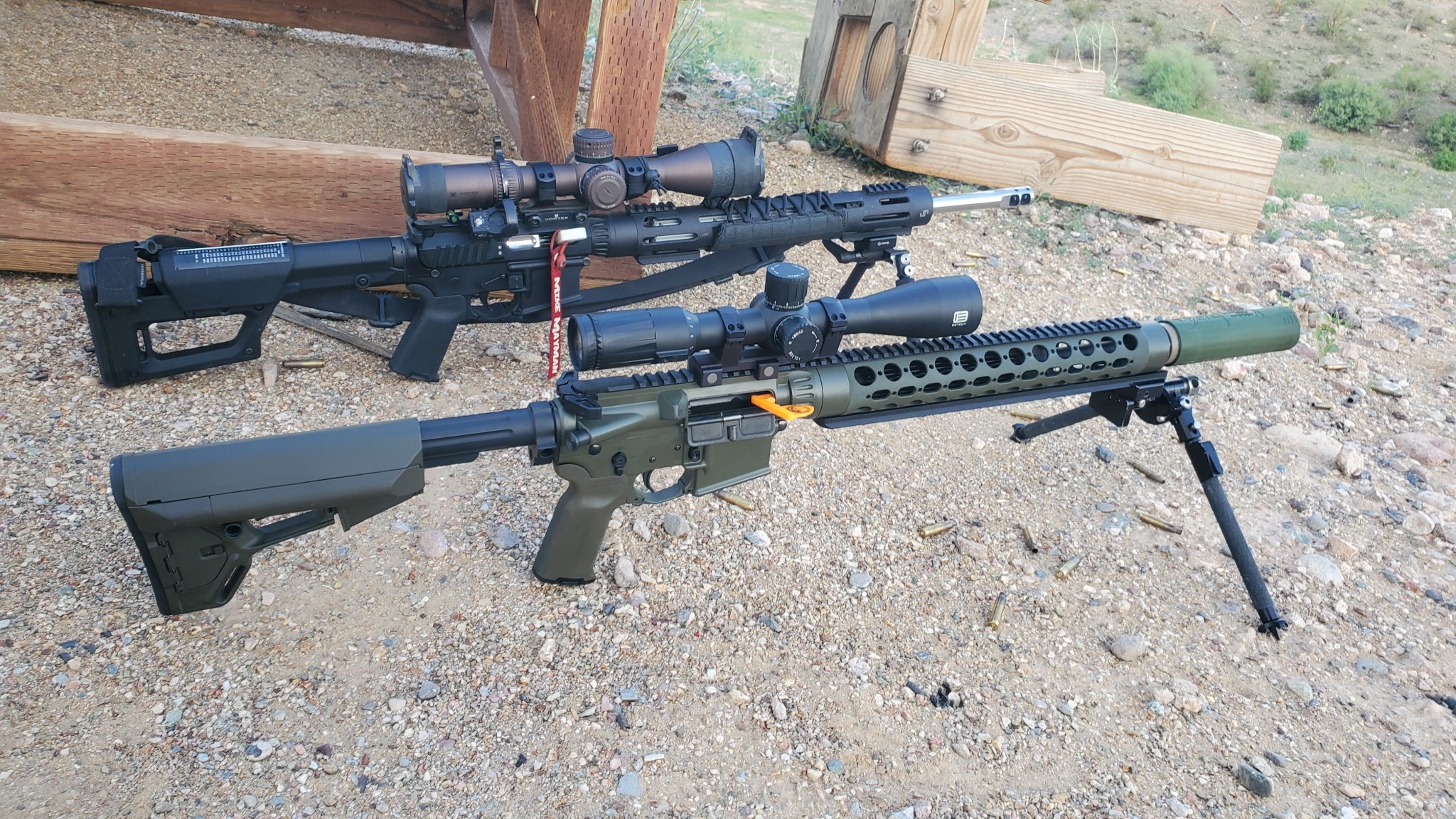

6ARC. Seekins base with JP internals. 18” Proof CF barrel. Huxwrx 7.62 flowthrough can. NF ATACR 4-16. My Steel Safari gas gun.
That's a beautiful rifle, perhaps you can educate me on why people are going with the proof carbon fiber barrels? I understand the lightweight but don't they also burn out faster? Actually what I'm curious about is more of the long range application where people are taking a heavy Tikka Barrel and disposing of it with the stock only wanting the action. I'm not sure what's wrong with the barrel but my heavy barrel looks a lot like the one on my Benelli M4. That's a very nice setup you got going on for sure, what kind of pistol grip is that?
Here I guess?
Holy cow you weren't kidding! 30% lighter than brass? Carbon fiber barrels and no more brass? How lightweight are we going here do we have to shave our body hair like the swim team and wear speedos? I'm probably going to have to draw the line here somewhere. Seriously though thanks for the link
Thank you! Proof CF barrel simply for weight savings, and it really looks cool! I’m not sure I’ve heard about CF barrels shooting out faster. The grip is an ERGO Deluxe Tactical.

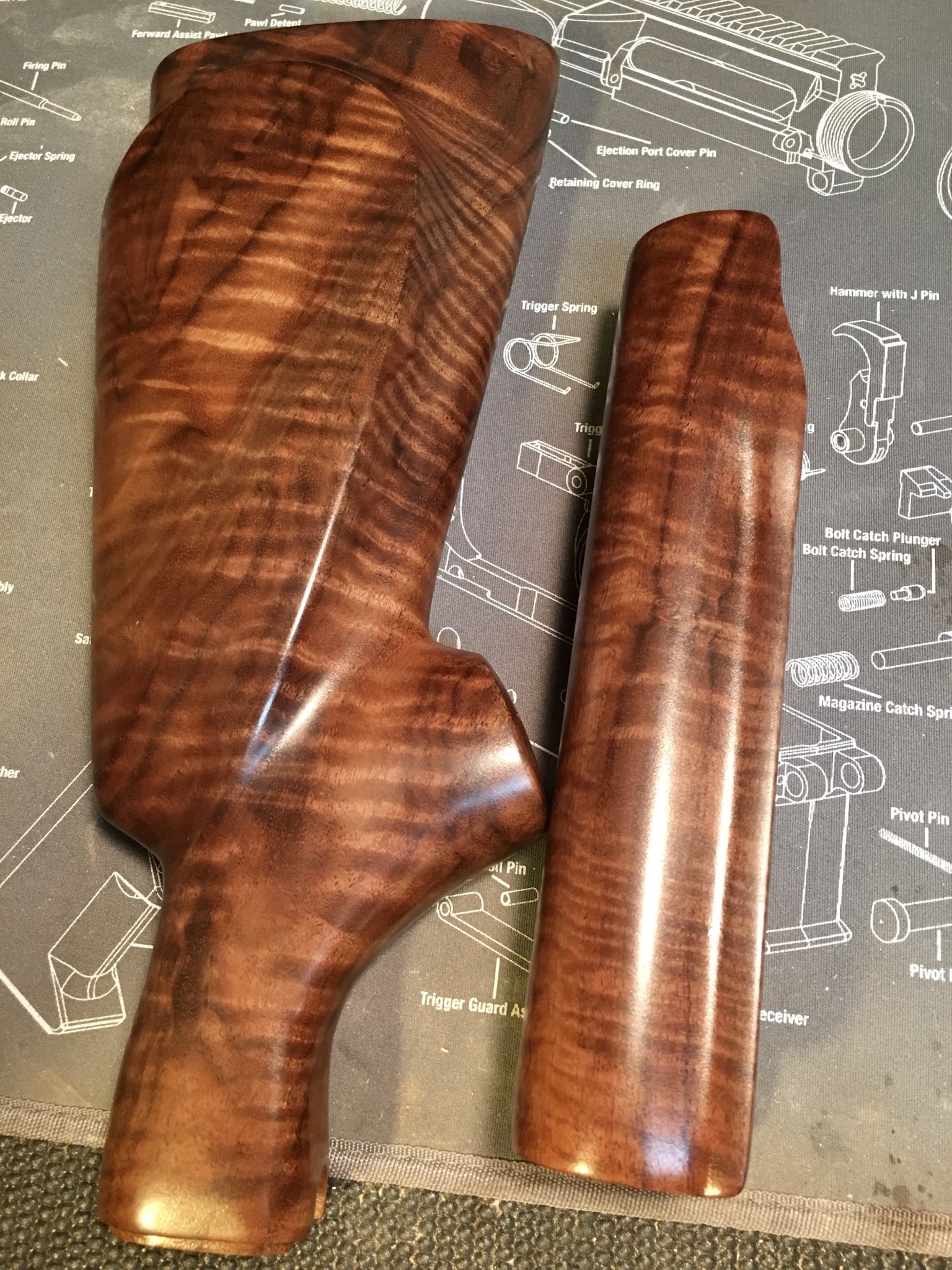

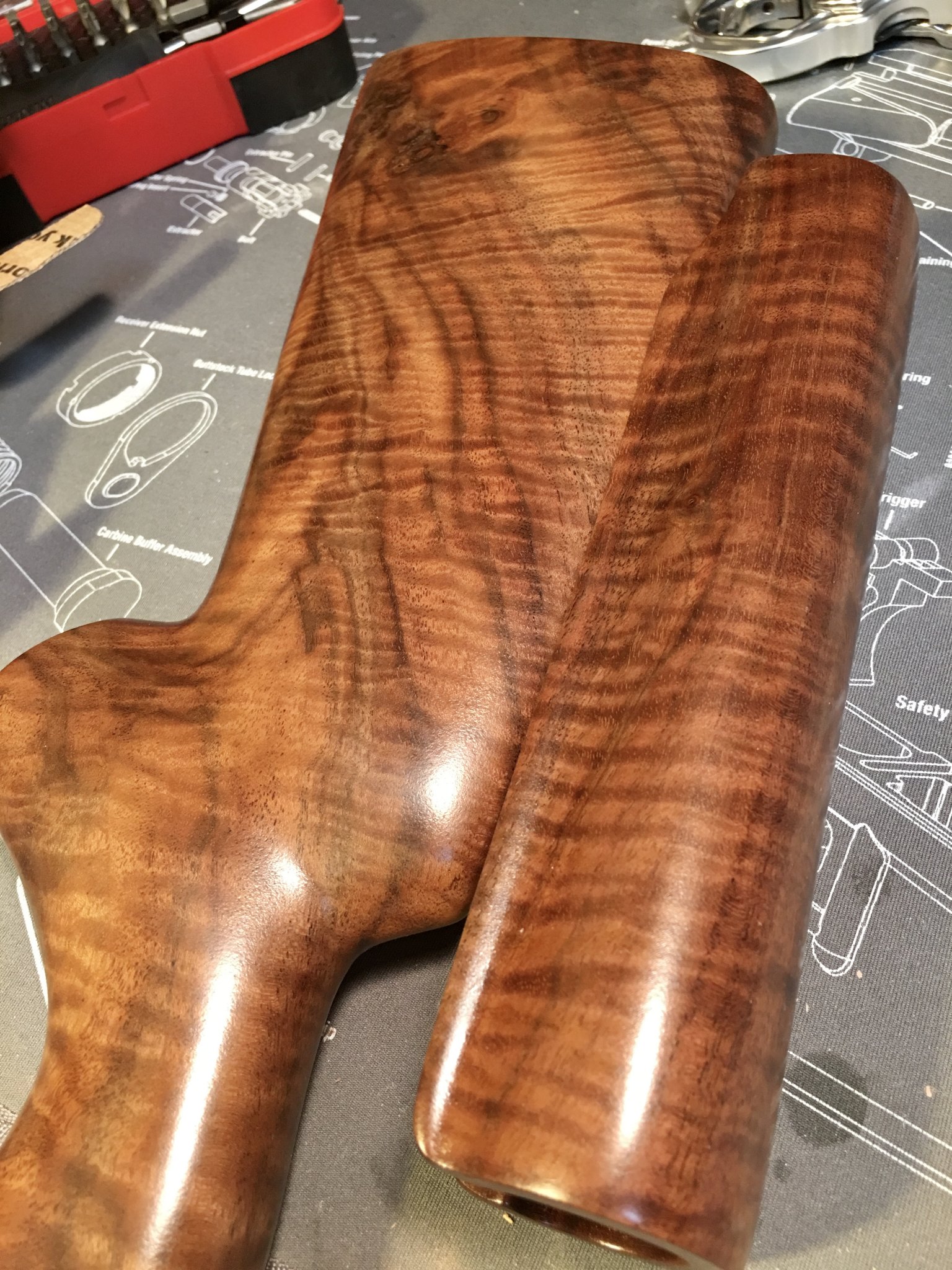

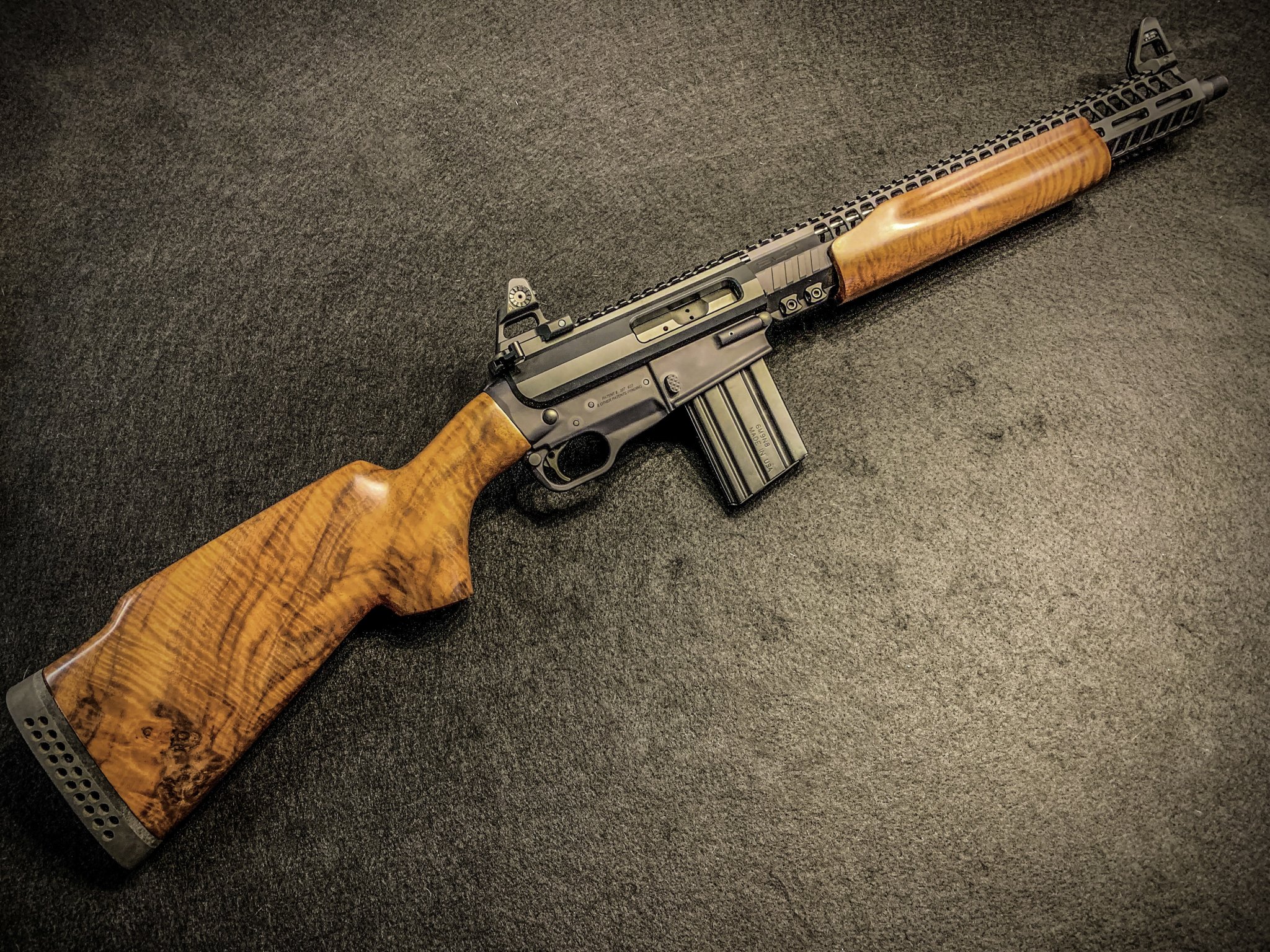

Latest project, scr lower, 16” tromix 450 barrel, claro walnut 870 stock set. Although I love the look of the irons, it needs a scope. Either getting a TT 315 LRH or a March 1.5-15. View attachment 8028877
Really cool build…. Where did you get the furniture? And is it for a Rem 870?
Also, how’d you attach the fore end to the hand guard?

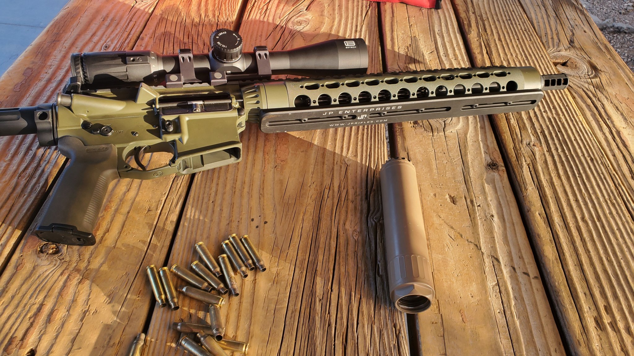

Have some of their .308 loaded for hiking…. Every ounce counts, right?

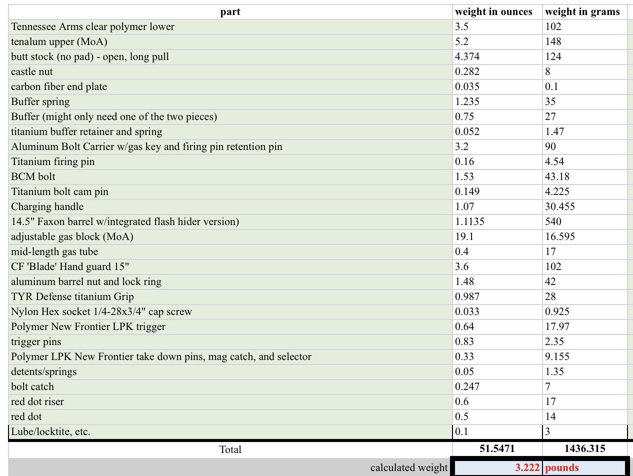

Been waiting for them to produce some commercially available .223 or 5.56mm to get a final load out weight for my uberlight no tax stamp (and rifle-length butt stock) project that I finally ’finished’ last year:
3# 4.4 oz with an empty 10-rd aluminum GI mag:
parts list:
…and yes, it’s actually a shooter!

Yep, it’s 870 furniture…got it off eBay a few years ago.
The forend, I had to open it up a bit, then cut the handguard also. I removed the side rail sections to make it narrower. I was worried if I removed too much material from the wood, it would split after a while due to the recoil. So I ended up cutting the rail instead. It’s epoxied in place. I went back and forth with adding a mechanical fastener to the bottom rail section, but I’ll save that for later in case it breaks free down the road.

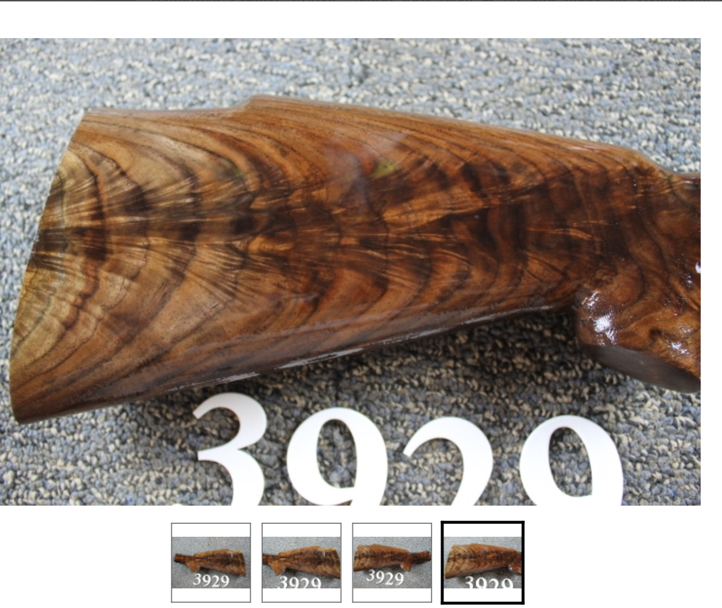

Yeah, I’m thinking get a really small diameter rail and then drill a couple recessed holes for MLOK mounts in the wood “wrap” fore end; maybe with a backer plate on the inside of the wood. Likely holes on the bottom only, with locating tabs on the inside of the wood on the sides. …maybe use a key mod mount instead… Gears are turning inside my cranium now.
Did you have to open up the butt stock at all for the BCG ‘tail’ that comes with that setup?
Edit:
maybe I’ll use a nice presentation set like this, and make heads explode in the AR, as well as the fancy pants shotgun camps! LOL. https://www.shop.macongunstocks.com...nut-SET-3929-Remington-870.htm?productId=1634
edit 2: maybe this one at only 1.5” side-to-side…need to find an 870 and measure the inner dimensions of the fore end. https://bravocompanyusa.com/bcm-kmr-alpha-15-keymod-free-float-handguard/
Reactions: rpoL98

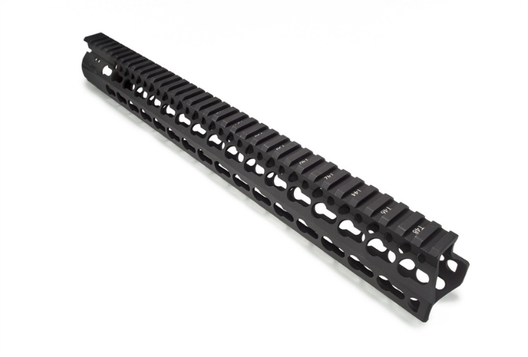

This is the handguard I used, it doesn’t list the OD, but the ID is 1.35”…so I’d guess the OD is close to 1.5”. I removed a little wood from the forend, but didn’t want to make it too thin/brittle like I mentioned. With the rail epoxied in place, it’s surprisingly solid. It flexes less there than the rest of the rail does.
That’s a beautiful piece of wood. I already had the set that I used (on an 870), which never left my safe. So I figured it would get more use on this build. It’s not quite at that level, but it’s still a nice hunk of claro walnut. I don’t remember exactly, but I think it was around $750 or $800 for the buttstock and forend, which needed finished.
As for modifications to the buttstock, the 870 already has a hole through it for the bolt that connects the buttstock to the 870 receiver.
This stock was already opened up to 5/8”, which is the same OD as the buffer tube that the fightlite uses…that may be the case with all 870 stocks, I don’t have a factory one around to check. I’m not 100%, but I believe the buffer system (tube & spring) that fightlite uses is from a Remington 1100/11-87, so those stocks should work as well.
The only real modifications I had to make were simple. The very front of the hole through the stock needed opened up to 3/4” to fit over the lug on the rear of lower. It’s about 1/2” deep…took about a minute with a sanding drum in my dremel.
The other modification was the “plug” that was in the rear of the stock, that only had a 1/4” hole through it, that needed to be opened up to 5/8” so the buffer tube could pass through it. The plug was a 2” long, 1” diameter wood dowel that was in the rear of the buttstock.
The rear part of the buttstock is drilled out to 1” diameter, the plug is was the bolt head bottomed out against to tighten the stock to the 870 receiver. Now, that’s what the nut on the end of the buffer tube bottoms out against.

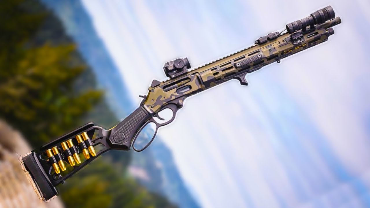

Have you seen some of the Costa Videos on this type weapon system.
He was the first I saw presenting a tactical application lever gun. After Chris Pratt and his Jurassic World Marlin, I see why this trend is not going anywhere.
