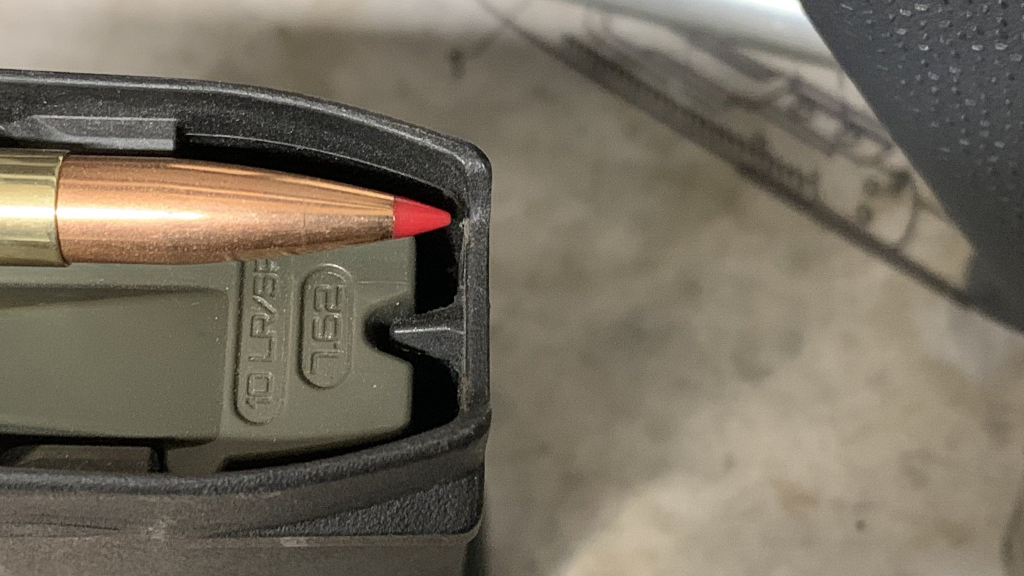

The root of the issue is the bullet point of a 6.5 or smaller bullet with a vld design ride so low when coming up to the chamber that they depend on a chamfer to knock them over into the chamber. That's just piss poor design
It still runs fine seated at 2.85 but it’s not as smooth.
I haven't seen proper feeding from any length in a vld design bullet
Now with a proof barrel which has ever so slightly more chamfer going into the chamber feeds everything fine.

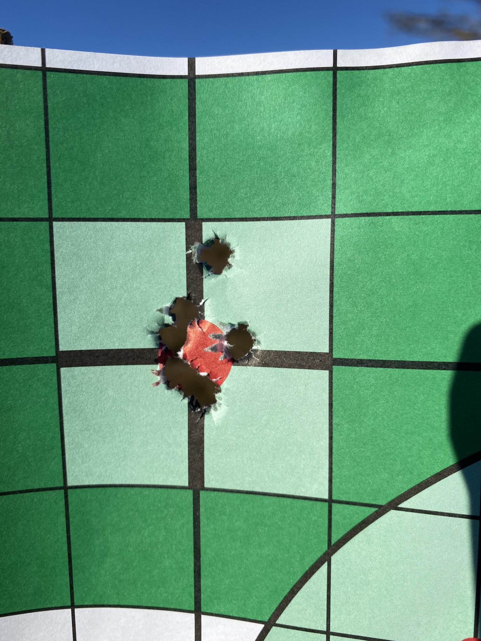

Here’s a 10 round group after my proof 6.5 install. Huge shoutout to Bachelor for hooking me up, btw.

I've tried the 140 & 147 eldm and the polymer tip is easier to ride the chamfer into the chamber, but it is still a man handle event to get it in the chamber in my example

Eldm at 2.780. I never had any issues with my factory barrel, but this is a barrel I chambered myself in 6.5x47. Virtually identical neck/shoulder/bullet relationship to a creed, but with the shoulder being .080 back from a creed, this is a worse situation.
I must say that's far better than what I'm seeing!
I'm thinking the bullet would either be in the chamber or stuck on the nose / chamfer before the shoulder makes it to contact the extension anyway ... So I'm not sure you are any worse off... I need to test some more and see how far my case is from contacting...
Did you end up increasing the chamfer angle into the chamber?
If so...
Able to abandon the prefit design and actually push the barrel back closer to the bolt face? Or did you have to leave more of the case unsupported in comparison?
I'm only running magpul as well.
Curious next time you've got it good and dirty if you notice the marks along the bottom of your chamber where it's riding into the chamber or if something is different in your case?
