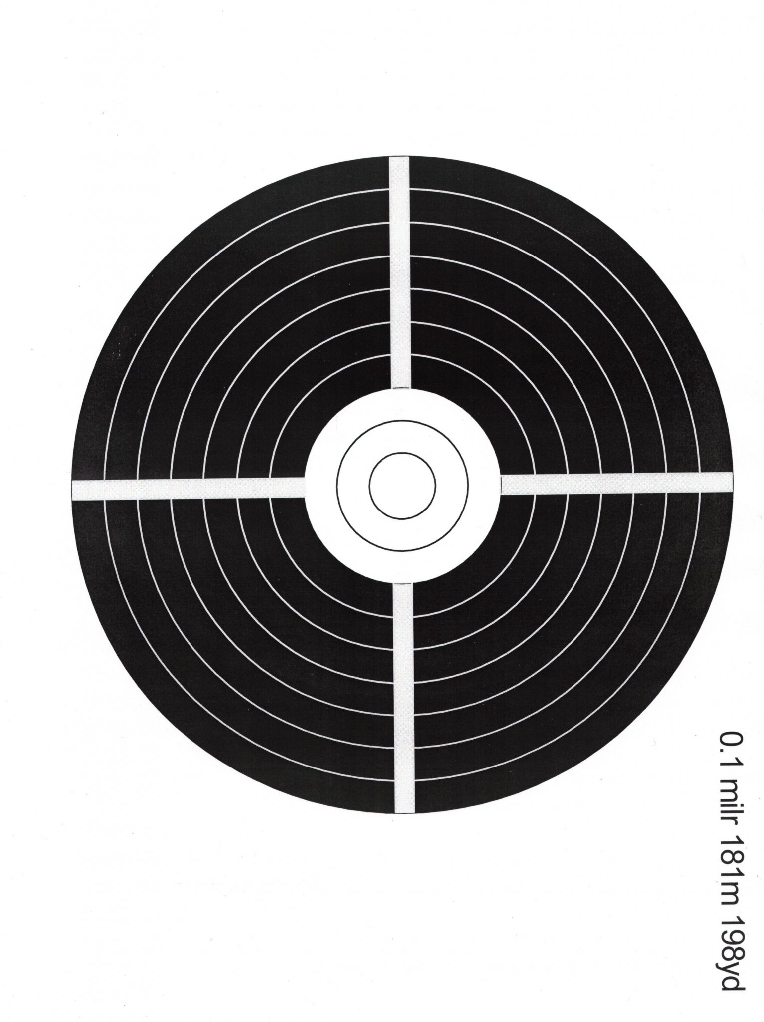

My goal is to see if it is possible to consistently shoot 50 rounds of 22LR into an 0.3mrad diameter disk at 200yd. 0.3mrad=1.03MOA. Acccuracy groups!
There are several advantages to shooting at one target. One is simply accounting, just have to count the hits inside the target area or outside the target area depending on your marksmanship. Second is judging what is a hit by looking at the target rather than measuring. Whether by measurement or eyeball there will be holes, that if you are honest, you just do not know. There have been extensive posts on SH concerning what constitutes the edge of a bullet hole and in my opinion they are mostly fruitless. So I plan on three categories, hits, misses and don't knows. The real advantage may be that with different aim points you have to continually adjust the POA. I presume even with a single POA shooting using a mechanical benchrest in returning the rifle to battery some adjustments are necessary but perhaps less than with both returning to battery and changing the POA. Perhaps not.
The target is shown below.

Do you print those targets or purchase them? Can you share a file or source link please? I like this idea.

A further comment on On-Target software. For my money, and I paid for the software, it is the most precise way to determine the center of a bullet hole relative to the aim point. You scan the target and import the image to the software, then tell the software the location of the aim point and the locations of the centers of the bullet holes. You specify the caliber of the ammunition and the program generates a circle having the appropriate diameter. Next the circles are used to locate the bullet hole center. Because the bullet hole has a ragged edge and may not be even be circular, centering a circle requires interpretation but gives your eye/brain the best conditions. To aid the location the image can be magnified. Better than trying to find a tangent on a ragged edge or tangents on two ragged edges to measure the extreme spread. However, it is laborious locating the center. Knowing the centers of all the bullet holes the software can calculate any of the relevant, and some irrelevant, statics include the ES of the group.
What about accuracy? Precision is one thing but because a measuring instrument produces distances to 1 mil does not mean that is true distance, as I am certain you know. Accuracy requires calibration as well as precision. In On-Target software you tell the software the distance between two points on the scanned target. First you measure a distance on the target. I would say that can be done no better than +/- 0.01" but others have better eyesight or at least use numbers with more significant figures. Then the two points are located on the scanned image and input together with the measured distance. The software can generate stats with, I think at least four significant figures. If the program outputs four significant figures I would say two are truly significant and two are insignificant significant figures.
Finally, and this is really clever, the software can generate targets with multiple bullseyes. If you print one of these targets and scan it after use, the program will automatically determine the offset of the center of the bullet hole from the center of the closest dot. These targets are divided into squares and each square can contain only one bullet hole. Otherwise the programs does not compute statistics but gives a message saying to practice more. :LOL:
Rick

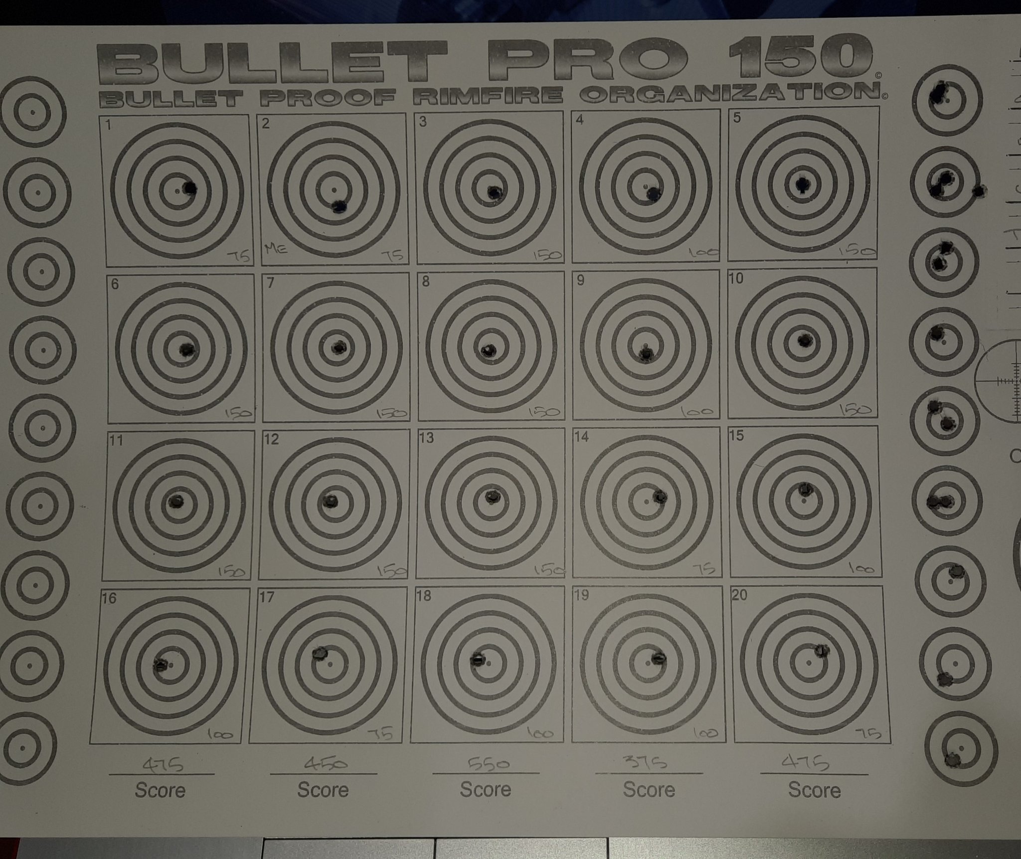

I may like shooting paper better if it had a steel backer to make noise. I prefer targets that react in some way.

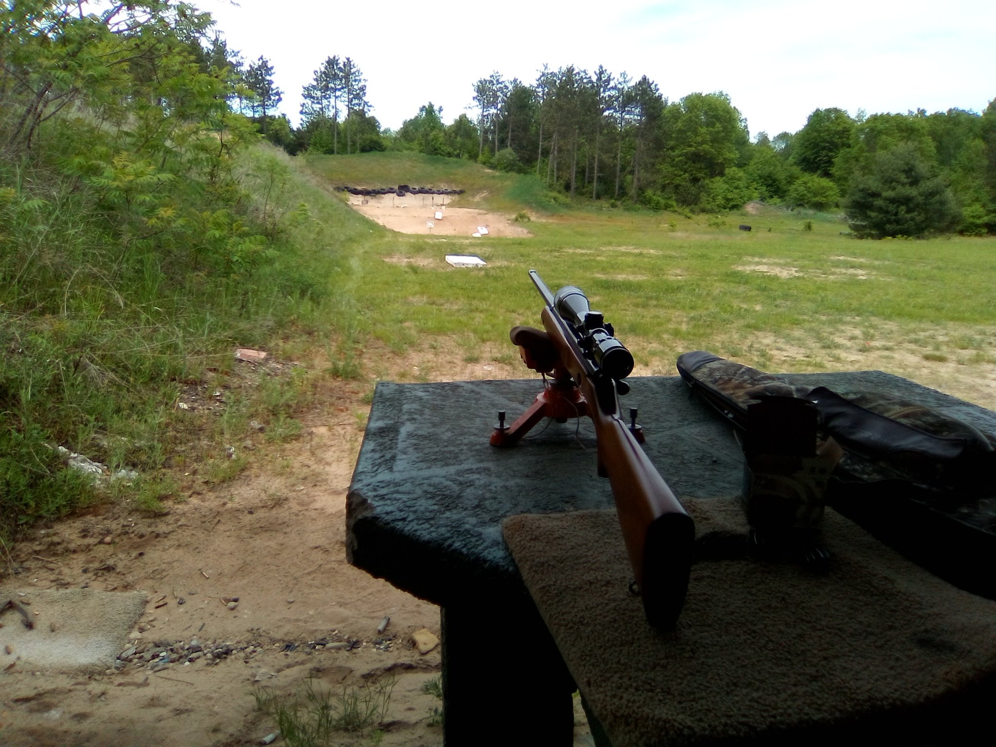

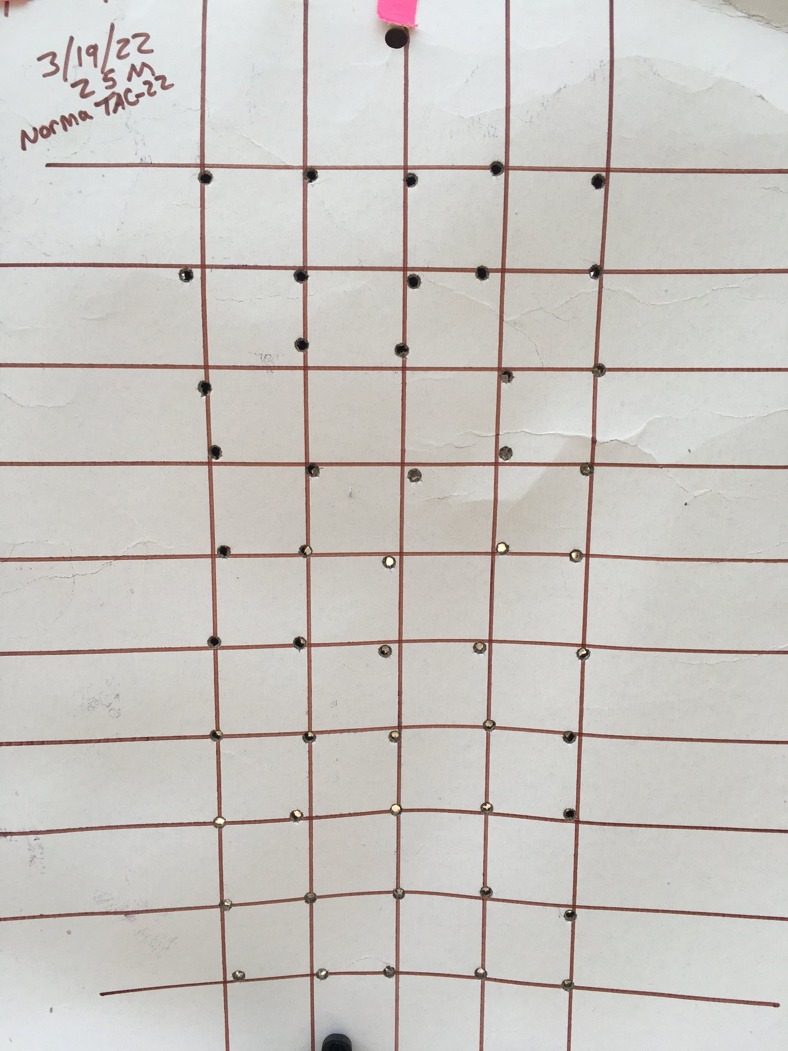

Set up at the 50 yard range for boresighting and the Grid.
AM-JKLX4lkZ2igYPZNpY8lvm7ihijFOFFaUmGhXmXzTrvJHlpJtShuvtmnJPNPYfmUqxEAH-0e4iC15FfDS6E5cq-JV0znWKy3uLf2y-Pdy0XWW-YzMxYjosT1MzANXiW_ZELKbIqLrxwW0Wugcw5rUjj1NL=w364-h600-no

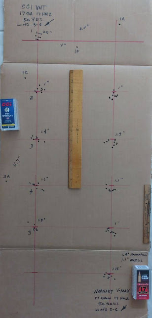

CCI VMax 17 grain ballistic tip 17 hm2
AM-JKLVmc-ocuMPdM8M2z__Z80rXFaByT_pt5gLZeS6Aghp47CInhqVEi1dQ32fkWdRiQBaZwF2Gl1xHSj0uvFn884PlglUeI7KJ9zRmwnHLz6qBBMPp7AdI2Ar-dAIeUF_-W4ssP0bzC_lZ1kTzjg9PyKRD=w356-h475-no
Took 3 sighters (S1, S2 and S3) to adjust the scope,
Then the remianing 47 shots to fill out the Grid.
AM-JKLVm3c4ohT0hllxABMKFQvLoQHs1k97yf5YIGekWo2Fh97pj87nwqLyomG-WQUmArdjXhgaMYen4vT0KjQcGw6NMOQLtva9b0FhNAfBYkVmZ5lD_65ILJRD693zpB-ATIX9zI-FGGPoXlZ3ElsHxDS7h=w450-h643-no
Audible differences in muzzle velocities, visible cartridge problems,
but still about an inch of spread at 50 yards.
It's hunting ammunition.

The reason I've taken to using the Grid for ammunition testing, is my results with groups lied.
Random acts of accuracy that wander around my point of aim aren't proof of consistent results.
When I started measuring group aggregate sizes, I found my overall spread was 2 to three times worse than I thought.
Sure, I had an average group size of 1/2 inch, but the aggregate size was 1.5 inches at 50 yards.
So what if I had a couple of 0.3's, when I also had a couple of 0.7's and they all were in different positions relative to point of aim.

I had a chance to get to the range for about twenty minutes before work, and thought I'd give this a try.
I should say right up front that I have no experience shooting precision, which should be blatantly obvious when you see the pic of the target 🤣
I picked up this rifle a few years back and haven't really spent much time with it. It's a Winchester model 75 made in 1941. 6x18 Bushnell Sportview on top. I'm sure if someone that knew what they were doing shot it, it would produce better results.
I started out shooting at the top left corner to find my zero. That turned out to be an exercise in futility. Once I thought it was close, I started on the top right corner and worked my way down. As I was running out of time, I lost track of which aimpoint I was even shooting.
I'm shooting just budget Federal Automatch from Wally World, and I don't use a rear bag, which is something I need to learn how to do. I honestly don't think I have any kind of correct technique shooting from a bench.
Anyway, here's the pics I took before I packed back up.
I'm looking forward to getting back out there and working on this some more, and improving.
Reactions: obx22
Hadn’t shot in almost two weeks. Went to the range and this was a hasty 16 consecutive rounds at 50y after about 10 rounds off to the side to warm up. The circles are 1/2” and inner is 1/4”.
Out of 16 (16 shots), how would you assess or rate the results? Is a round touching the inner circle a hit or a miss?
I shoot mainly PRS Rimfire and the smallest I’ve shot was a 1/4” piece of steel on a KYL during a match at 50y. Based on my 16 consecutive rounds fired, I would have hit or grazed it 14 times. I rate the results as highly successful on the accuracy potential of the ammo/barrel/conditions/me. I tried to run it at a realistic match pace.

This morning, 455 SOF Lilja at 50 yards
AM-JKLXTCKfB3JnV73_Rip8vp25hvsF0OtuI7nCbSdn_jEF7OhR-qh1E2VH9Rxs8GK4XvcVLnszvrZeUD-ZmdrE284LEZLmOwKZdMiXeECOtiH2hCrbjra9-pLJx2PA6WP_evjdnIbYSMKf-2M1MiFG29Odr=w428-h500-no
Box of CCI VNT and a box of Hornady V-Max
AM-JKLVdBaYndhV4PBoz7pWTwOJ8gEwXBCnvuqABqpLXQsQpItoLwBGftzYZt9F-V7Ua_LYkUT8oD6SGy4UNMag8eAaPg9Vg0OG6bk-HE6Y91Z9y60Wqu1NBJaE3o0nBMp29syds9CRJQrOIfxQc_GN-ojP9=w485-h506-no
Look....1/2 inch 5 shot group at 50 yards....all day long, right?
AM-JKLVUVVqjoZJi0nCxJ67krR7Rccp2_idE--zCT62BBDrZYKy2HLaPCJXS6ie-Z8j7-e-fNjTcHb8dOJah3vlJUzSsX5PvMLik-70pb8o_NJgpztd82CwBaOvXZnkwLr_i11dCwx6OkRWmt6Zq5fx7ebmH=w424-h505-no
Fudge...I forgot, it was a ten shot group
AM-JKLV9FEW_BDcmiDB0AOfgwlC3amiclq7wbV-nb1Pd50mAmiaykGkf2VUkbRUvA_q0D-xwFYWTIPTT4JzXFBW-rt-axj_3_TBEyomE3HEf-V2JyzaeC7PcxOcmTaQC4pGgxTWlA86S8taFi5H0yNSICv_e=w725-h542-no
2 went left and off paper, 3 wandered off down or right
1A, 1B, 1C, 1D and 1F....yuck.
Remember, this is at 50 yards.
5 ten shot groups with CCI VNT alongside 5 ten shot groups of Hornady V-Max
AM-JKLUgsybshd6XgyR1MMAfaugIV8XEbRLwNEC0hBn_d8yFaj58u3PA7DgUeS6rf0ouzHgawZ28rpGcDG0f4F5GF1BhJdFOuncafQofhm3IBsnSovi8Skbm2o04CzRmBbo8C9Lmzp8qVrtAud_I9HZf3m3v=w308-h643-no
CCI VNT...worst bricks of rimfire I've ever bought.
CCI made Hornady V-Max, 2 moa groups at 50 yards...1 inch vertical, 1,4 inch horizontal spread.
Adequate varminting meat spray ammo, center of critter.
Head shots at 25 yards or less.
