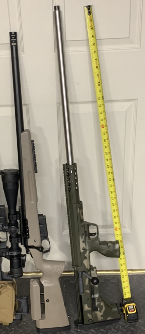

I contacted Silencerco a few weeks back and they said I can use my Hybrid 46 can on my 36” 37XC with no issue. I’m in the slow process of collecting components for it so it’s unfired but hopefully that will change this spring.
Reactions: waveslayer
Yes, and it’s still balancing toward the rear of the rifle.
22” 6 Creed + brake sits next to it for reference.
Reactions: LastShot300

Waiting on a 30” Carbon6 33XC from StraightJacket for my AXMC. Have dies, brass, and 300 OTMs. But only powder I could find was Vihtavouri V20N29. Has anyone tried this powder as a H50BMG substitute in 33XC?

This is @lethalsquirts making multiple impacts at 2 miles with my 33xc in the AI AXSR. I load 123 grains of H50BMG w/ Berger 300 otm's seated at the lands. You can also use Retumbo or N570 successfully, but I found the best accuracy/velocity using H50BMG. I couldn't sell my .375 cheytac fast enough after returning home from this trip to Kansas. At 2 miles, my elevation was just over 10 mils less than that of the cheytac.
Just imagine if you were shooting a good bullet! 😂
