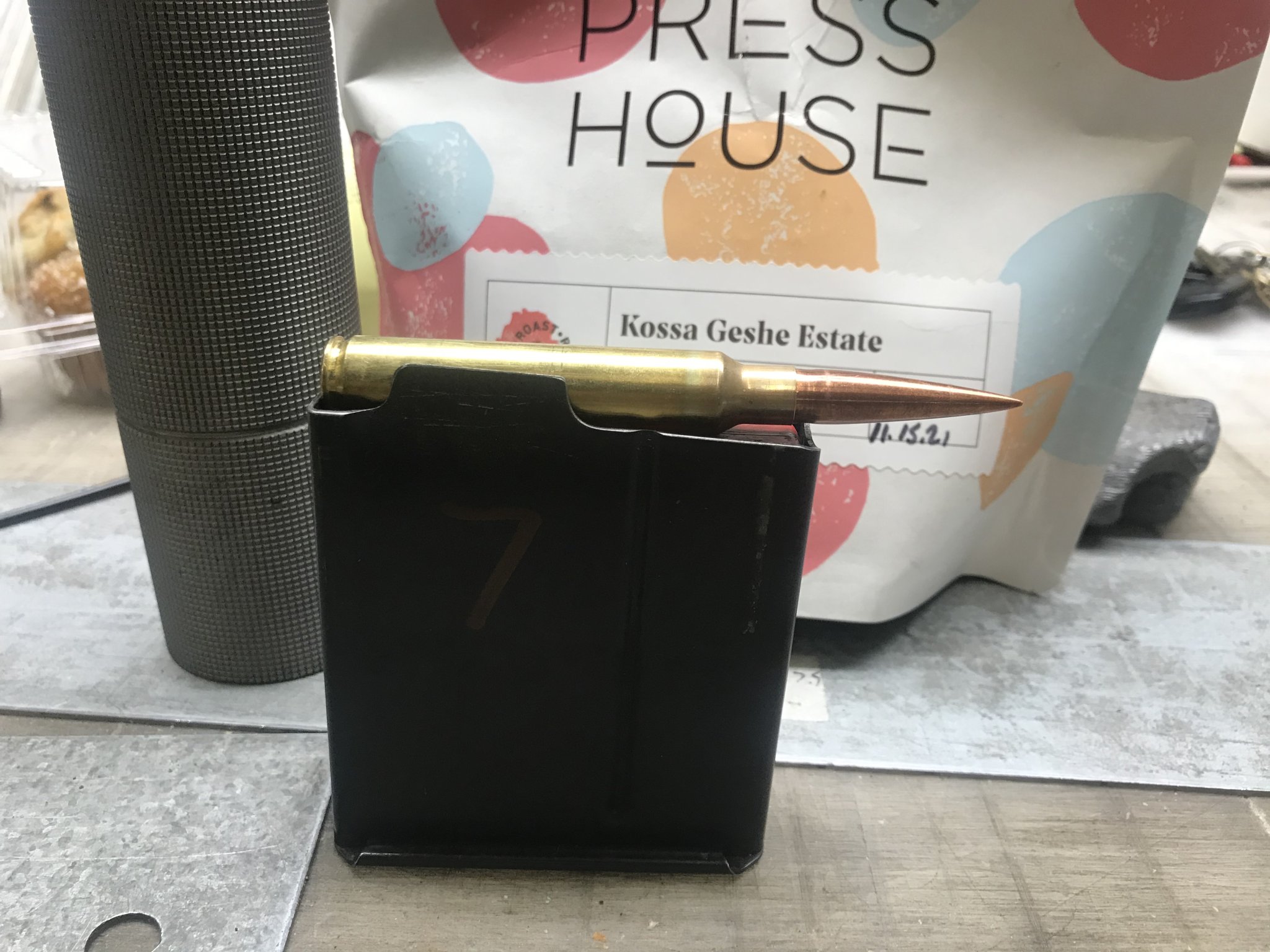

What about the 338 norma? All i know is i want a big bore i can run on a normal long action with lapua BF
Fantastic cartridge but not a powerhouse unless you run the improved version.
Mag feed 250’s and 300’s easily and it’s super easy to get a good load.
It’s about 150 fps behind my 338 edge with 300 OTM’s or 285 solids.
