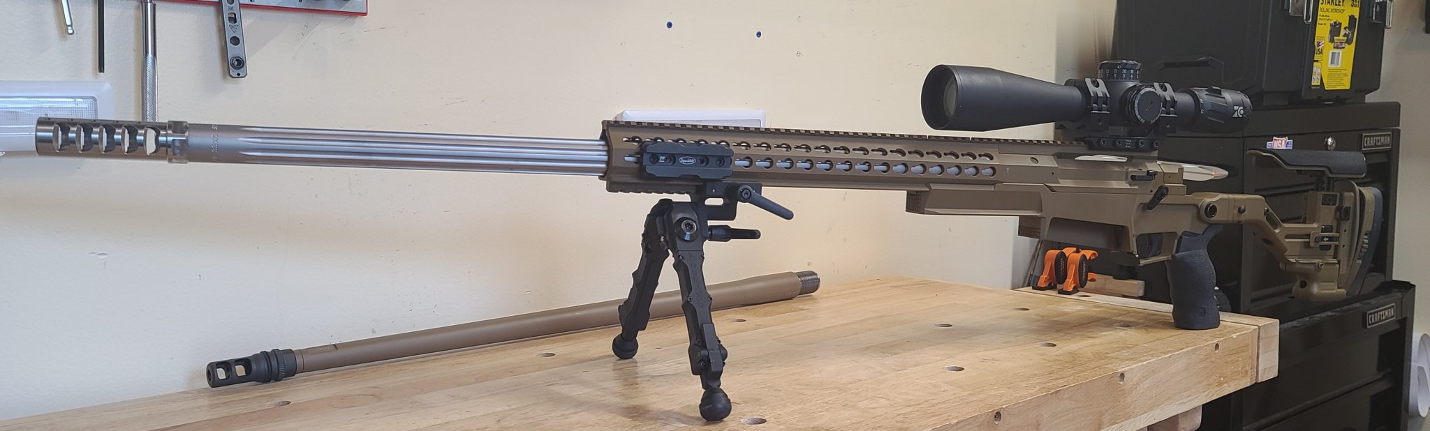

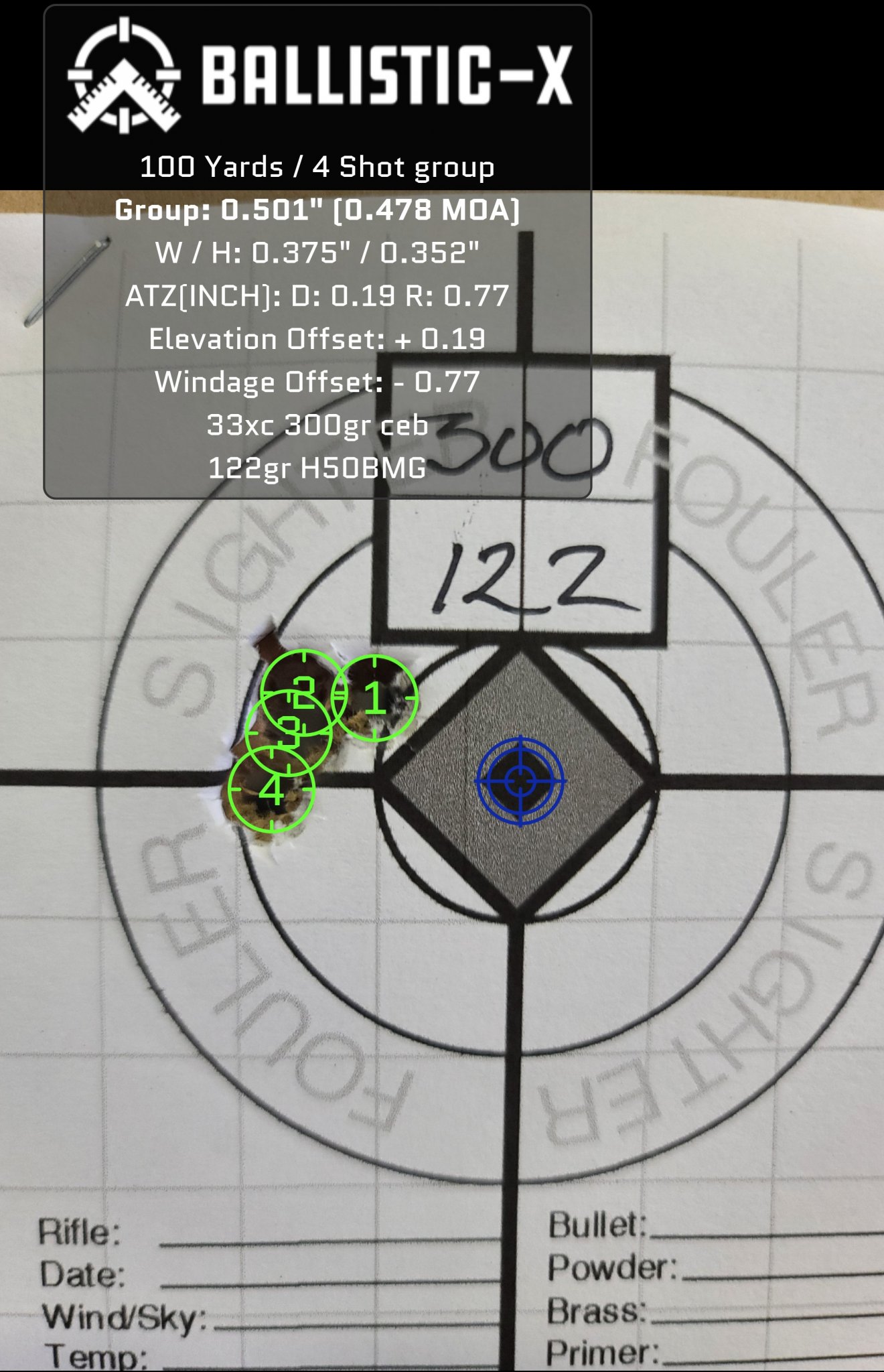

I went with the 1:8 Mod BB finished 30" and it shoots lights out with solids. Only pushing 275gn at 3180fps but have no fire cracking after 100 rounds. Chase did tell me a 34" was probably needed to burn up all the H50BMG but the 30" is even getting a little long IMO for an MRAD. Now if I was doing a 41XC I'd probably go 36" on a dedicated build.

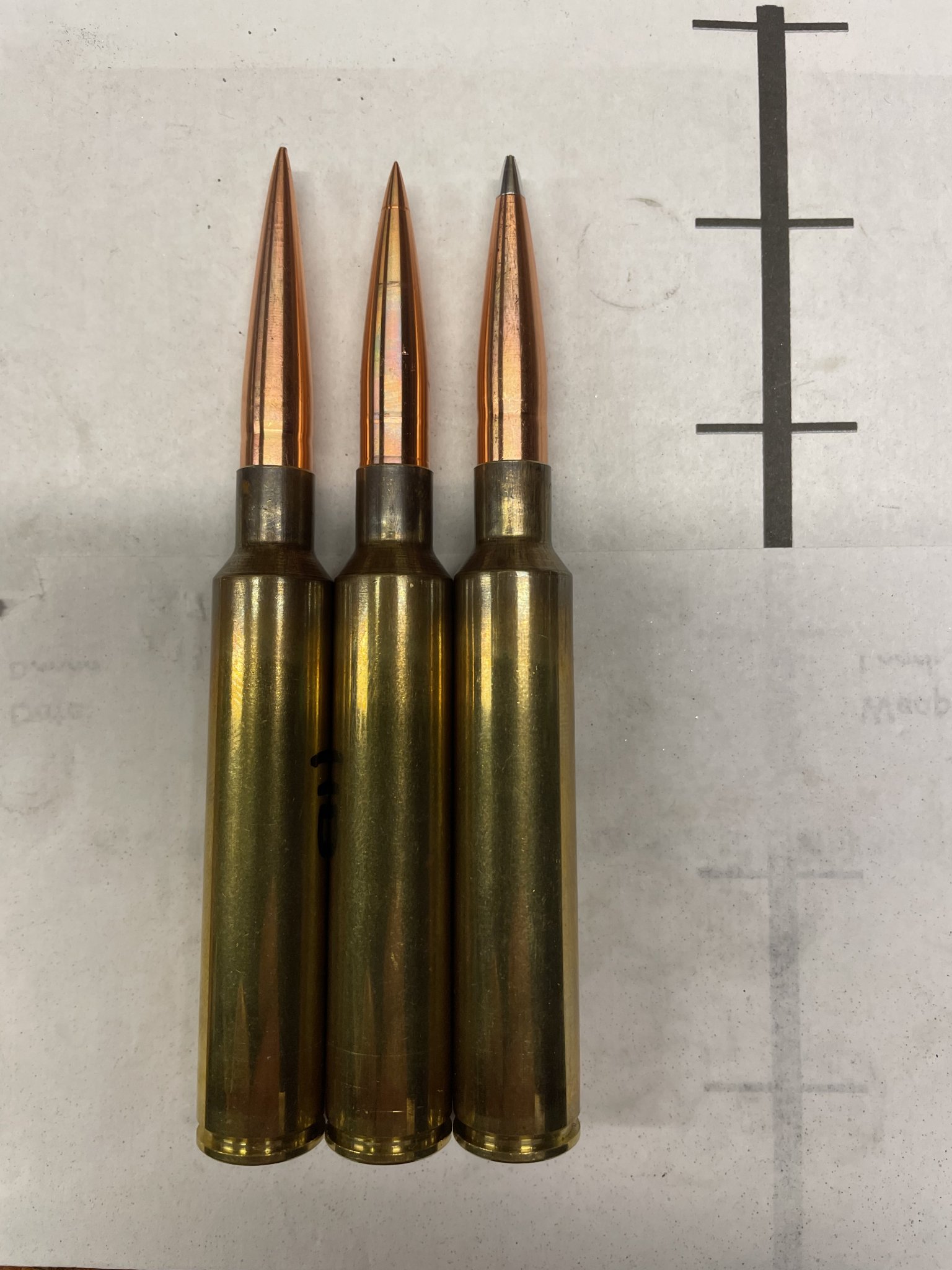

Stay tuned,,,, little Canadian and English teaser
I have high expectations out of this ModBB. Should have it next week., 😉

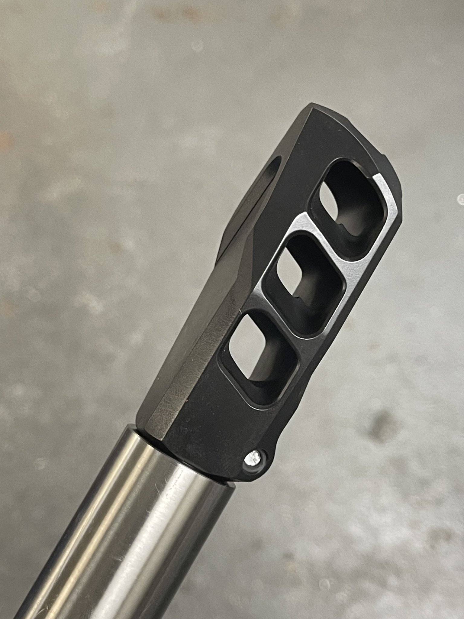

His brake has some odd angles, it is out of the way for the most part. Given where his bipod is don't think he has room on the bottom unless he makes a longer handguard.

First load workup session, this was 122 grains h50 with 300 grain cebs. Think it liked this well enough to do a little more work at 122.
